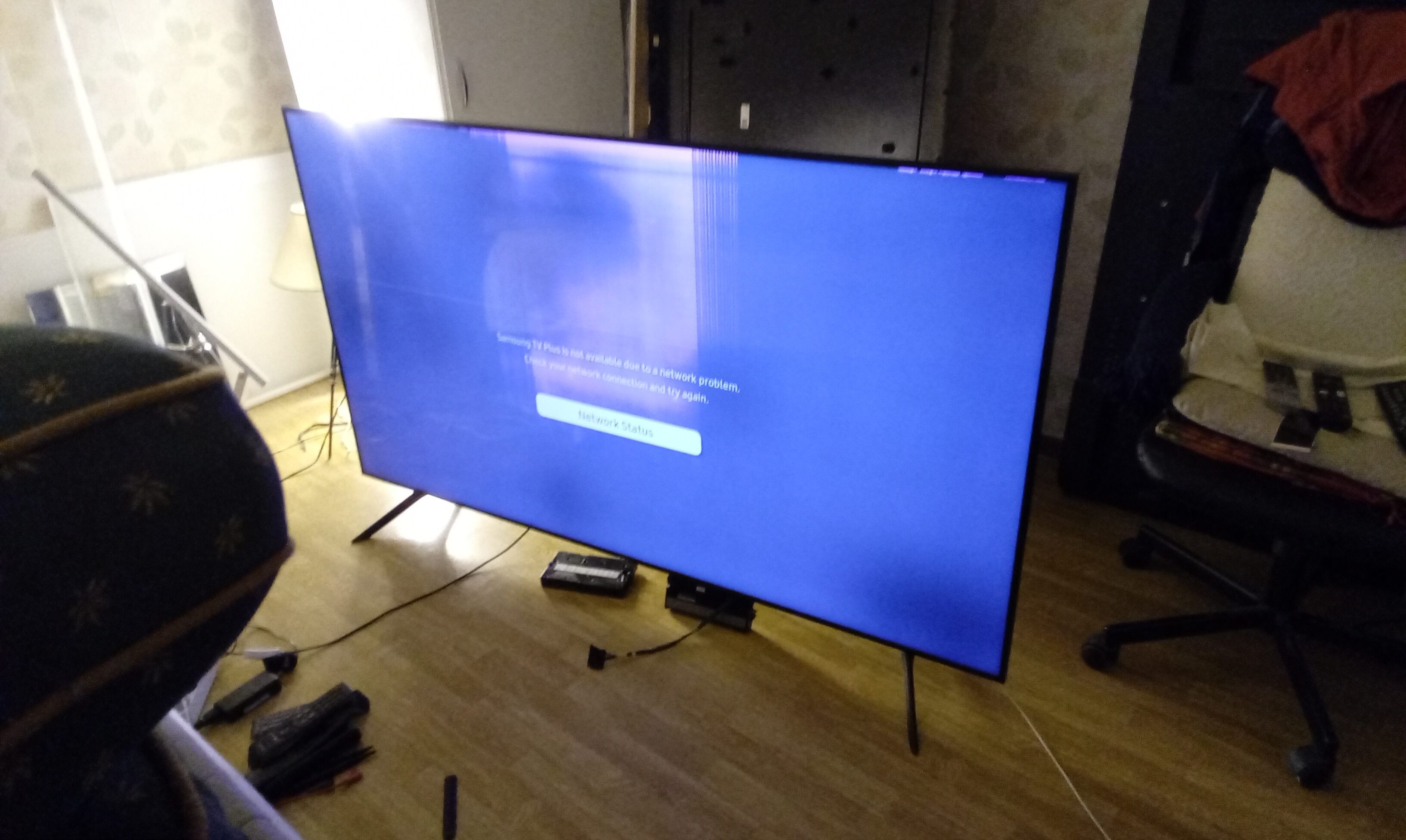

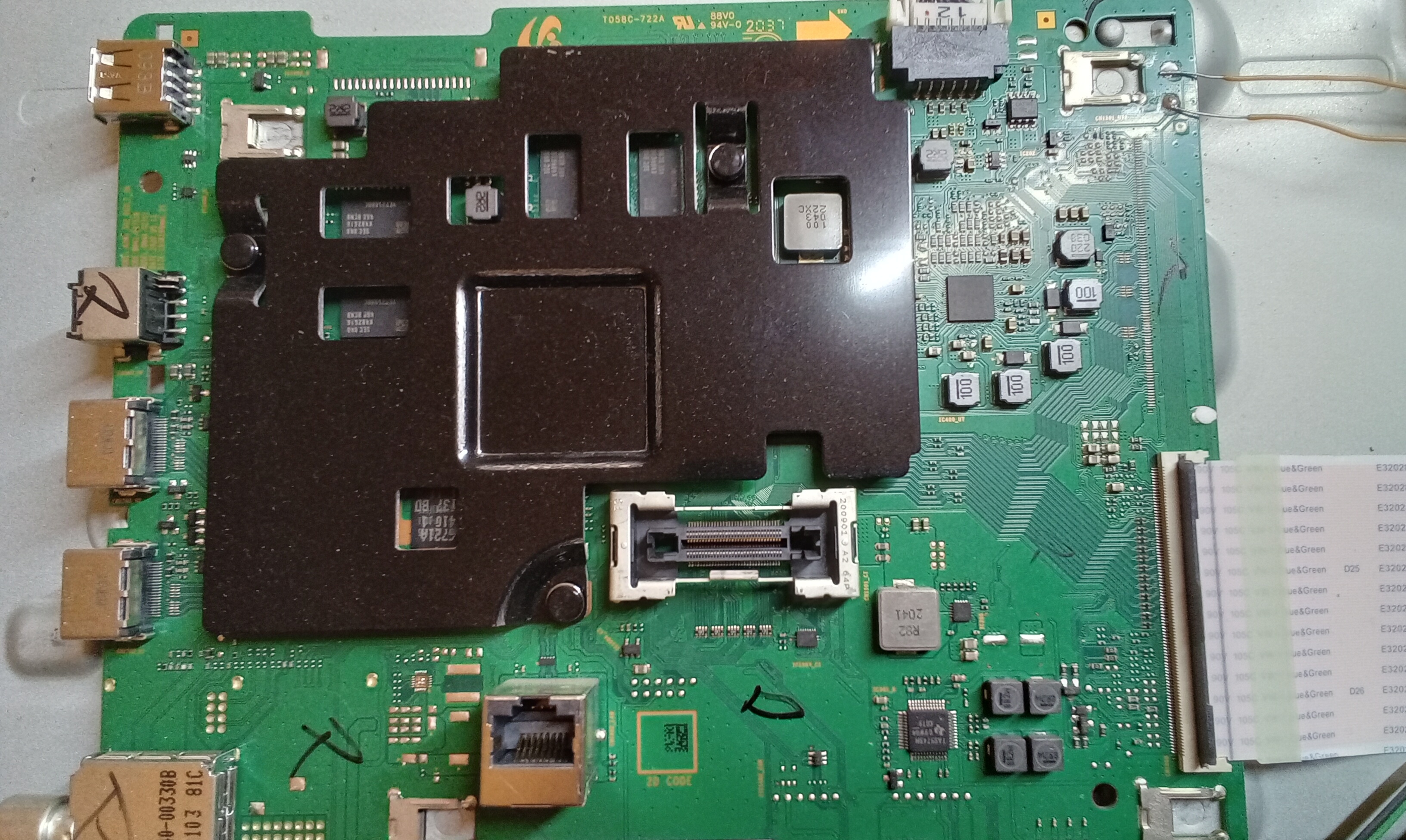

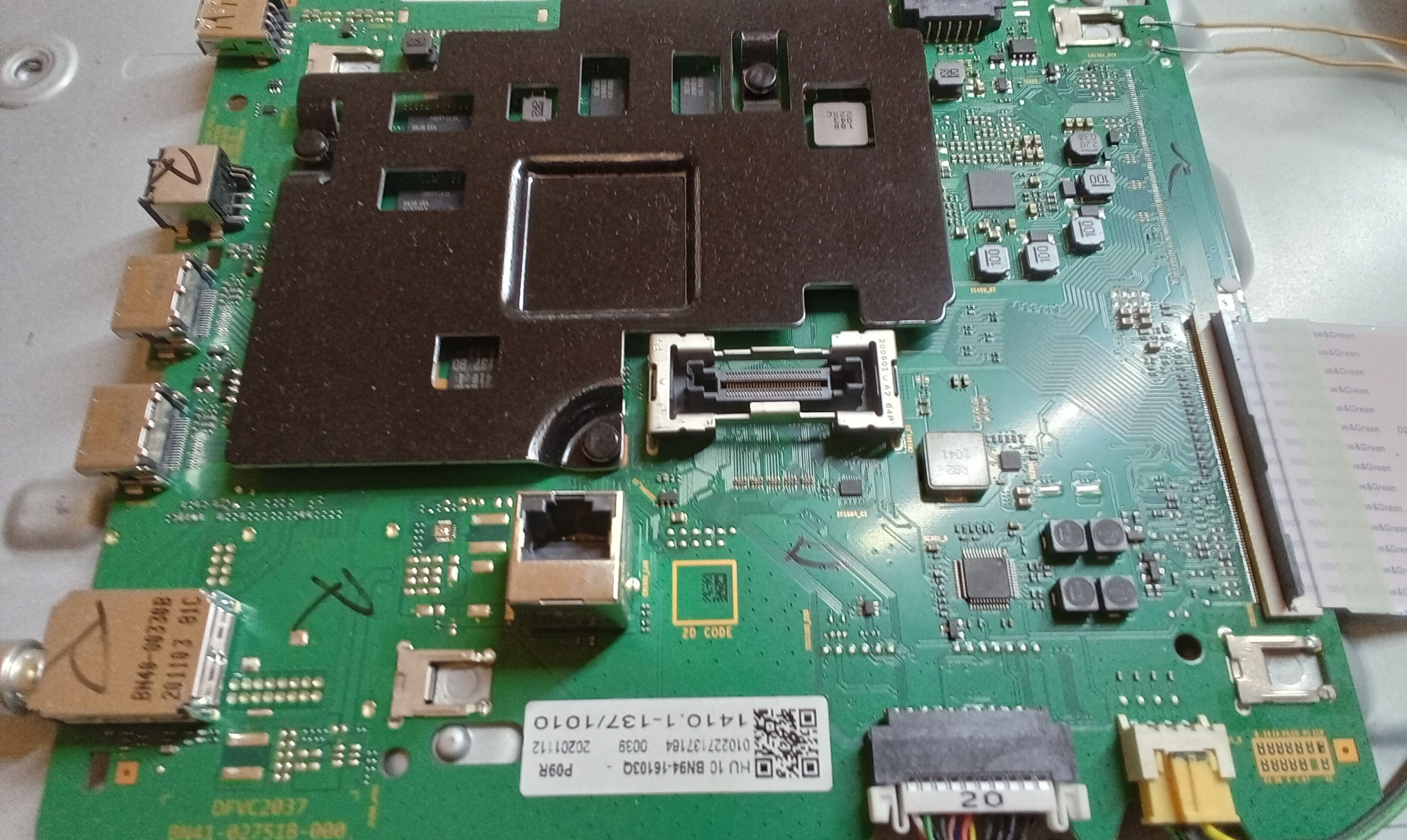

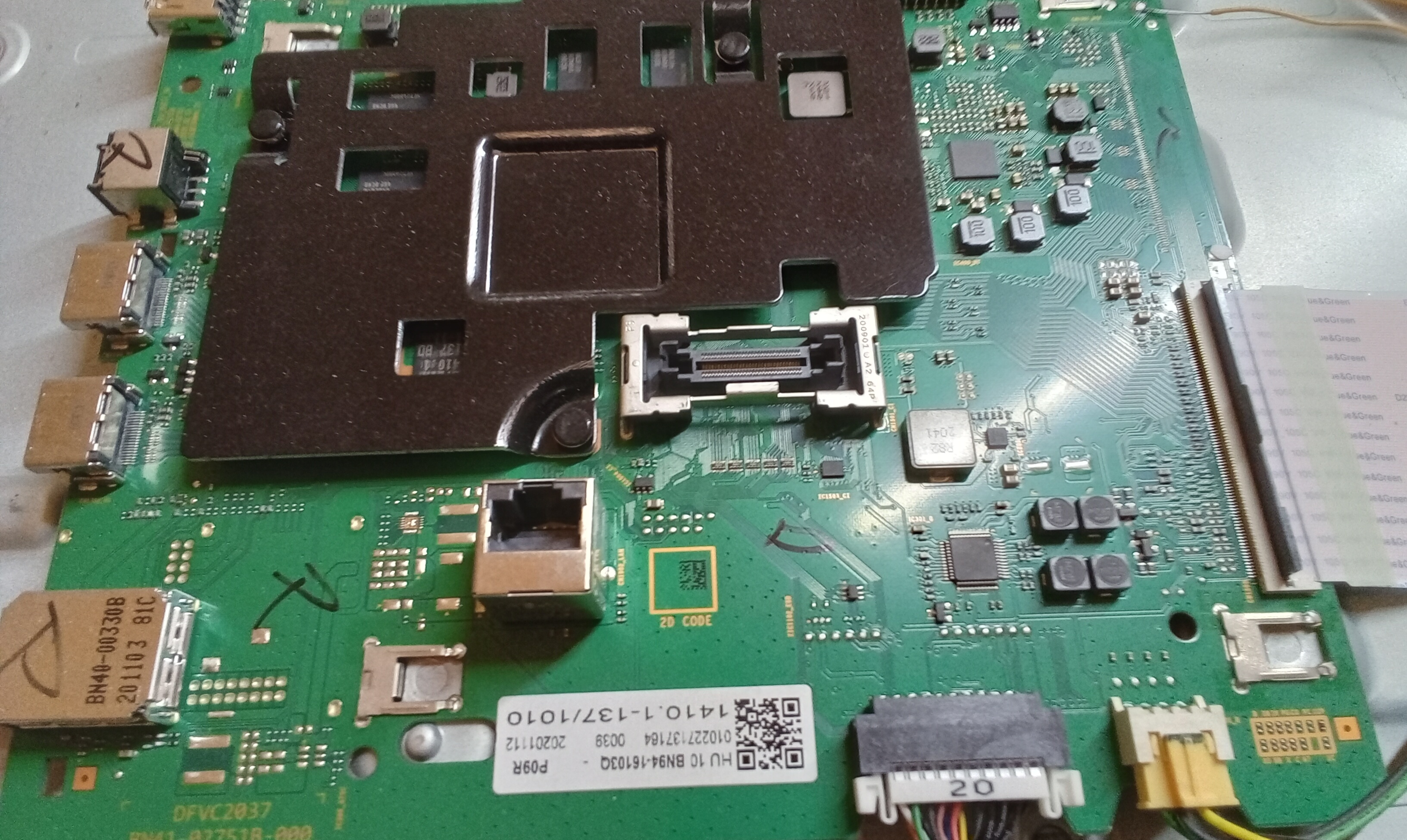

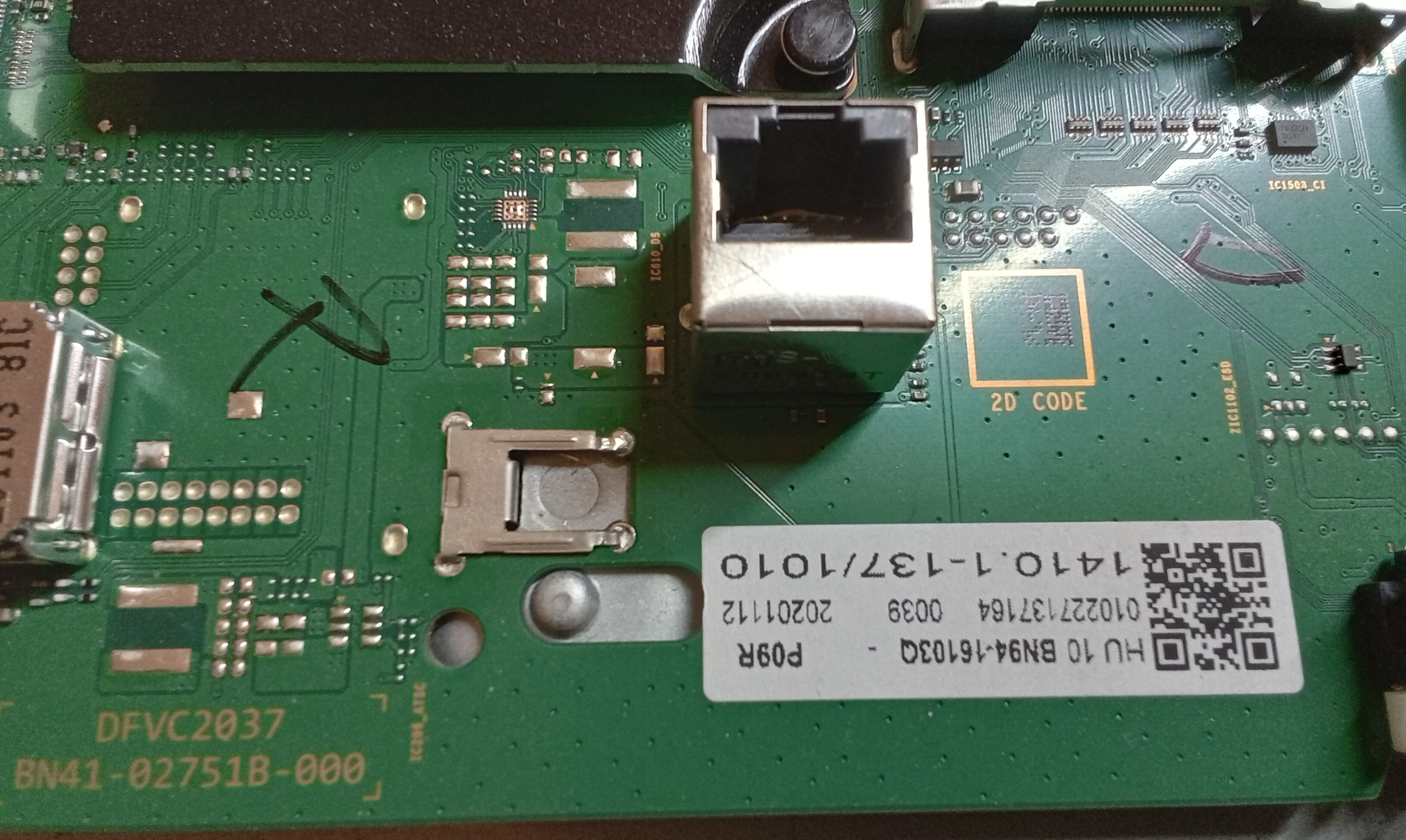

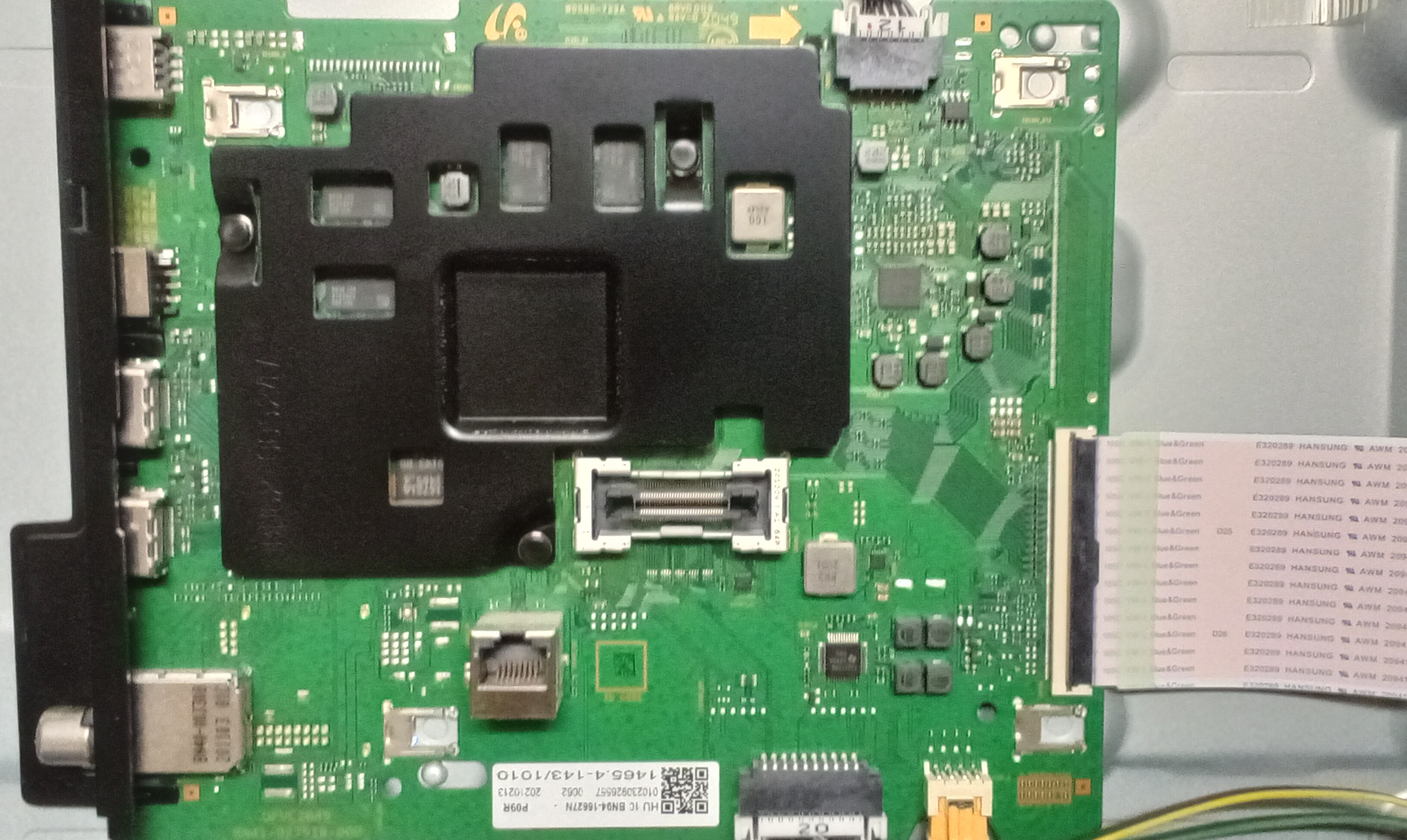

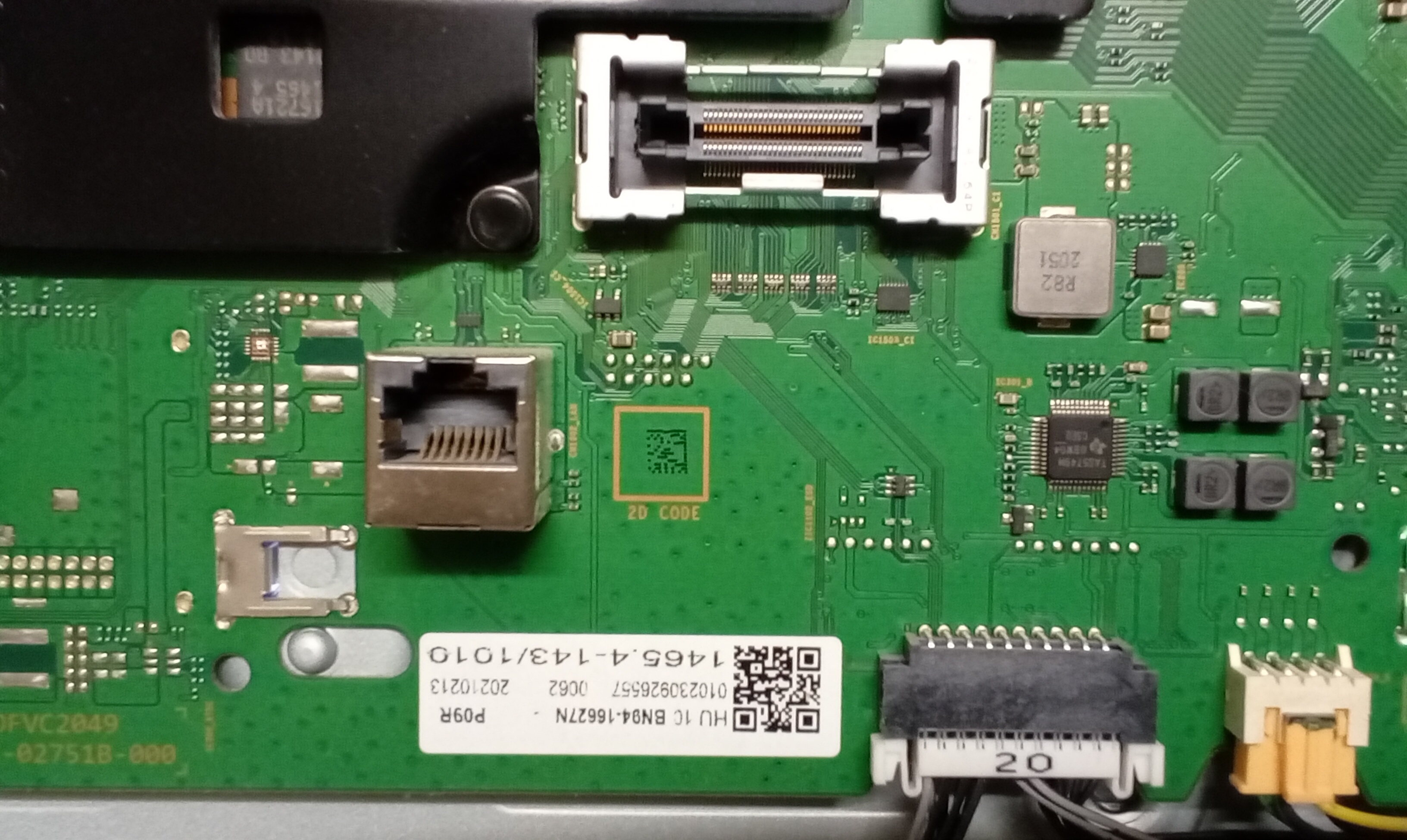

    Hello everyone, hope you have had a lot of sun and a nice summer.
    I wonder and hope that these two Mainboards are compatible because they look like twins. one Native is BN41-02751B.000 and the same thing on the other printed on the circuit but they differ what is on the stick Native BN94-16627N the other BN94-16103q. don't know if the region issue can cause problems
    or maybe it's a dump question or even a settings question for them to fit
    is there anyone here who can help me sort out this question very thanksm

        Did you put it in the TV and try it,what happens

          Hi EazyBone yes i did but the set starts but no pictures the screen remain black i was thinking like plug and play but no
          the boards are almost identical it have to do with programming or maybe a dump but i do not know which chip to programme please if you have any idea just point it to me thank you

            Try this
            with set on, press info, setting[menu] 314 exit, then unplug the ac cord

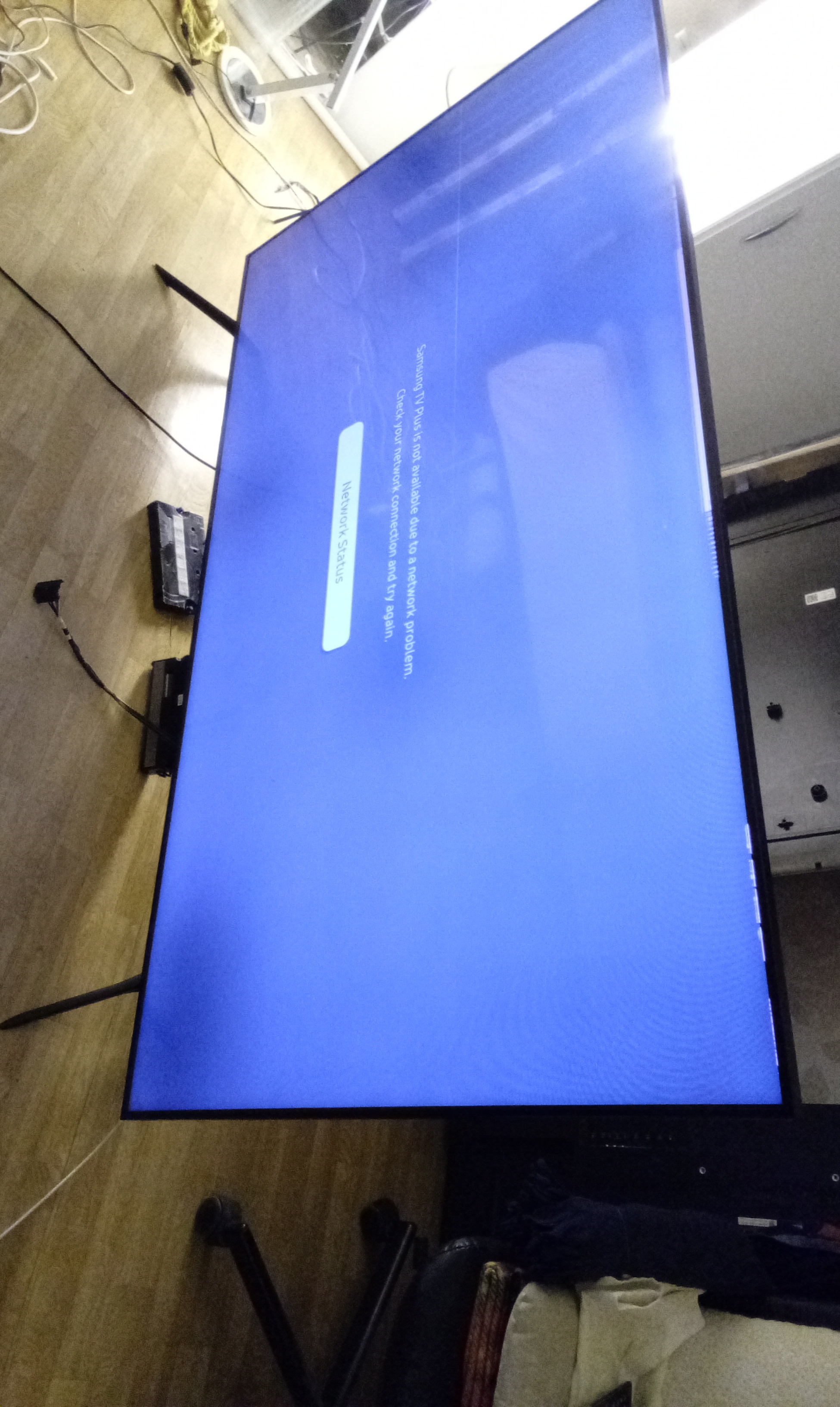

                  Originally posted by EazyBonhee
                  Try this

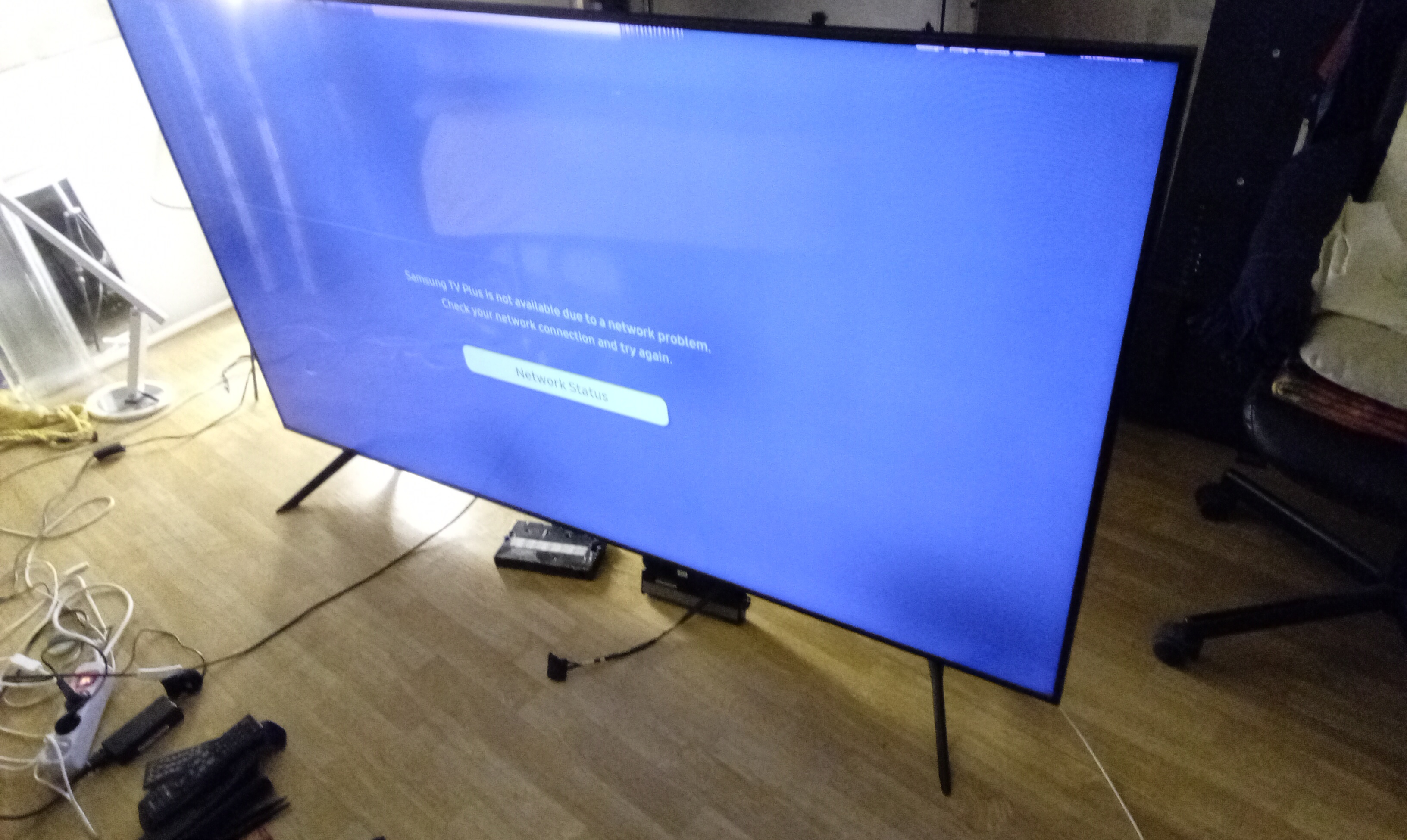

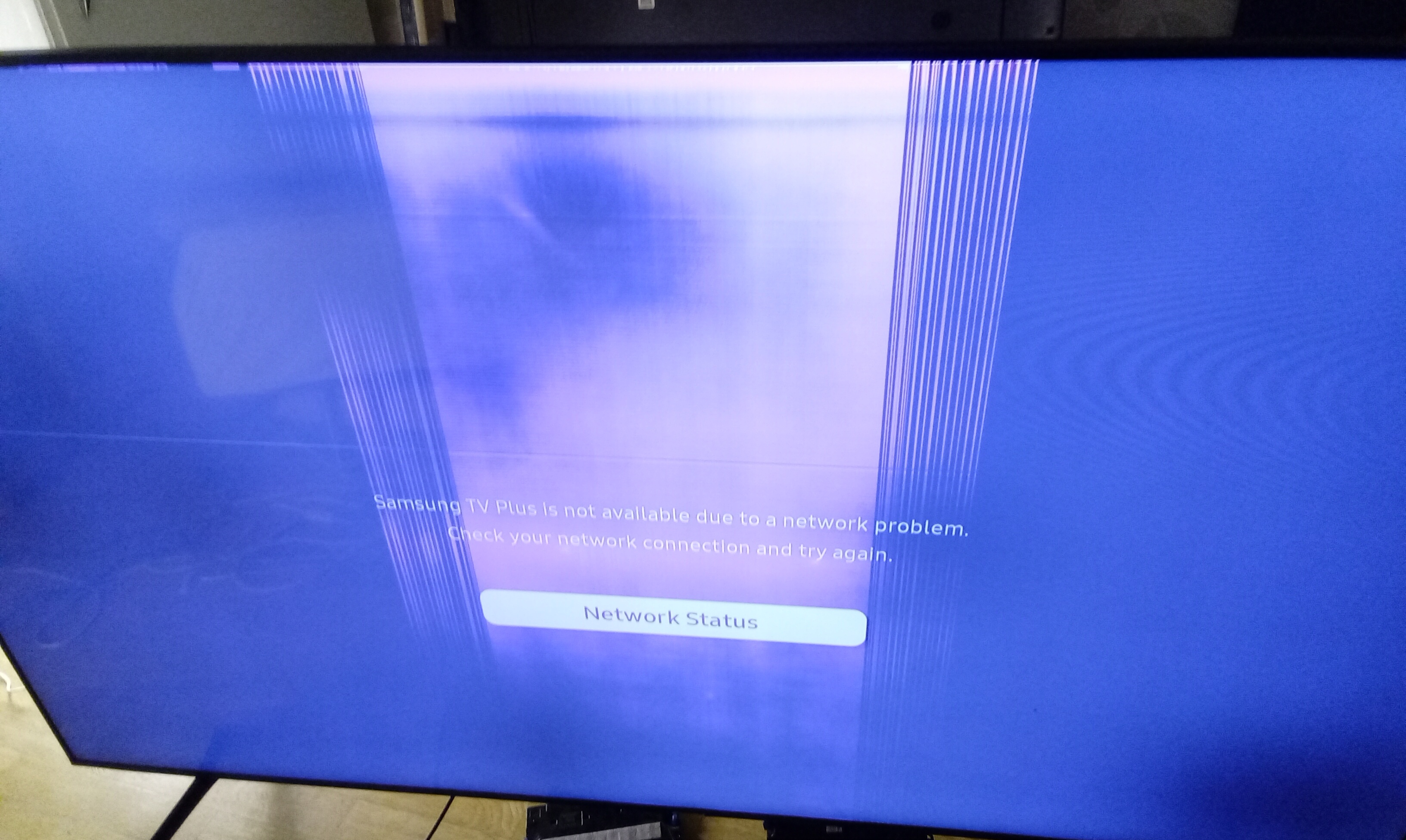

                  Hi again and very sorry for the late answer because i got that Philps 75 beast . i did that test and i get some response not really good but a big step in the front take a look a those pictures first it start very clear and nice with small defect at the upper edje and then as you se

                      before i use the code it was nothing on screen so it is a good progress and everytime i repeat it the pictures get better
                      just when it s starts but after 10mn or so the screen get creasy

                        Hello, now the TV is on a better way the picture and the sound is present, but the picture is very fad, the code you give me did a lot, but it seems that the set needs a little more nice tuning maybe in the TV setting or in the service side don't know I'll take some pictures when I get home
