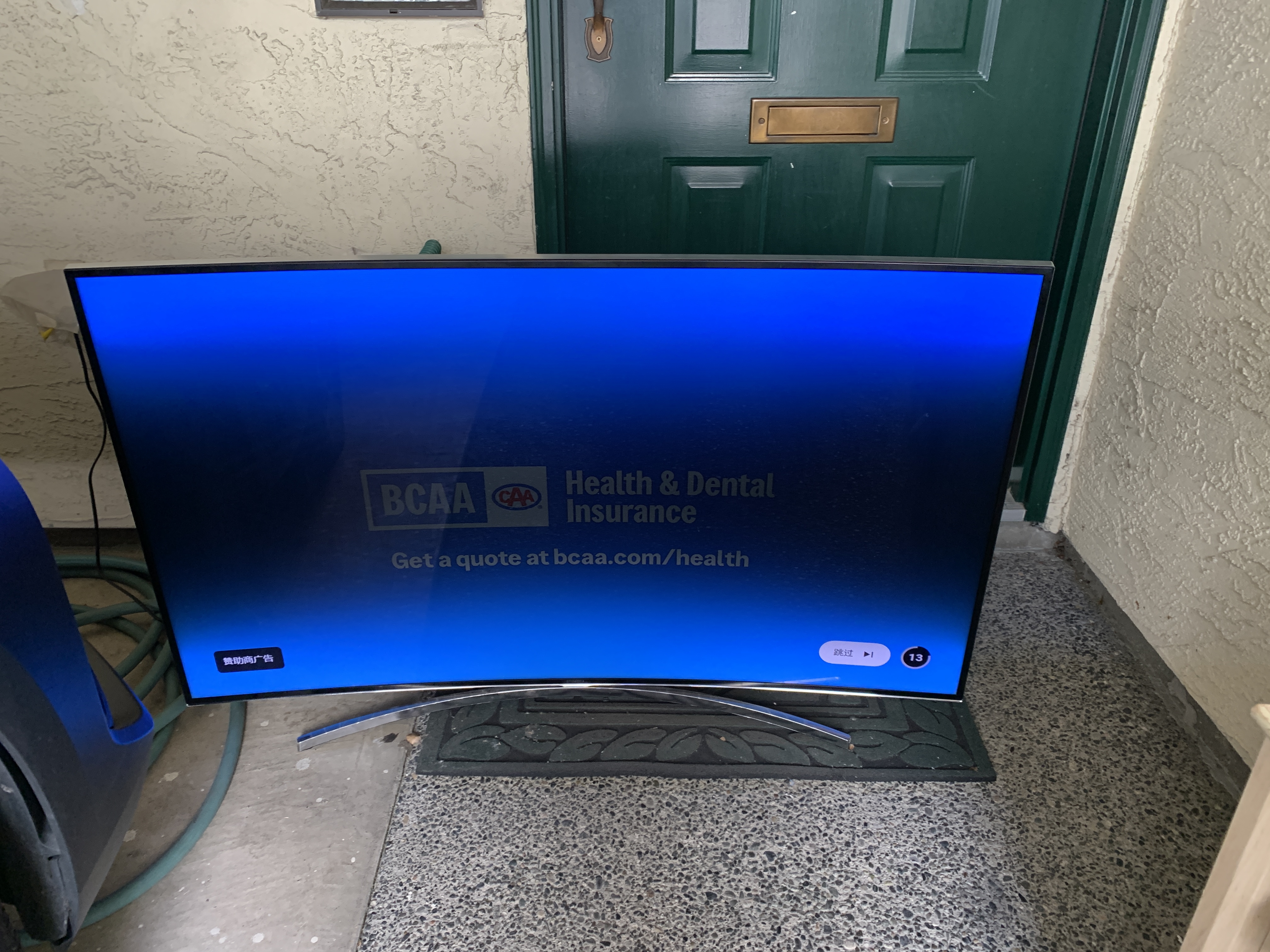

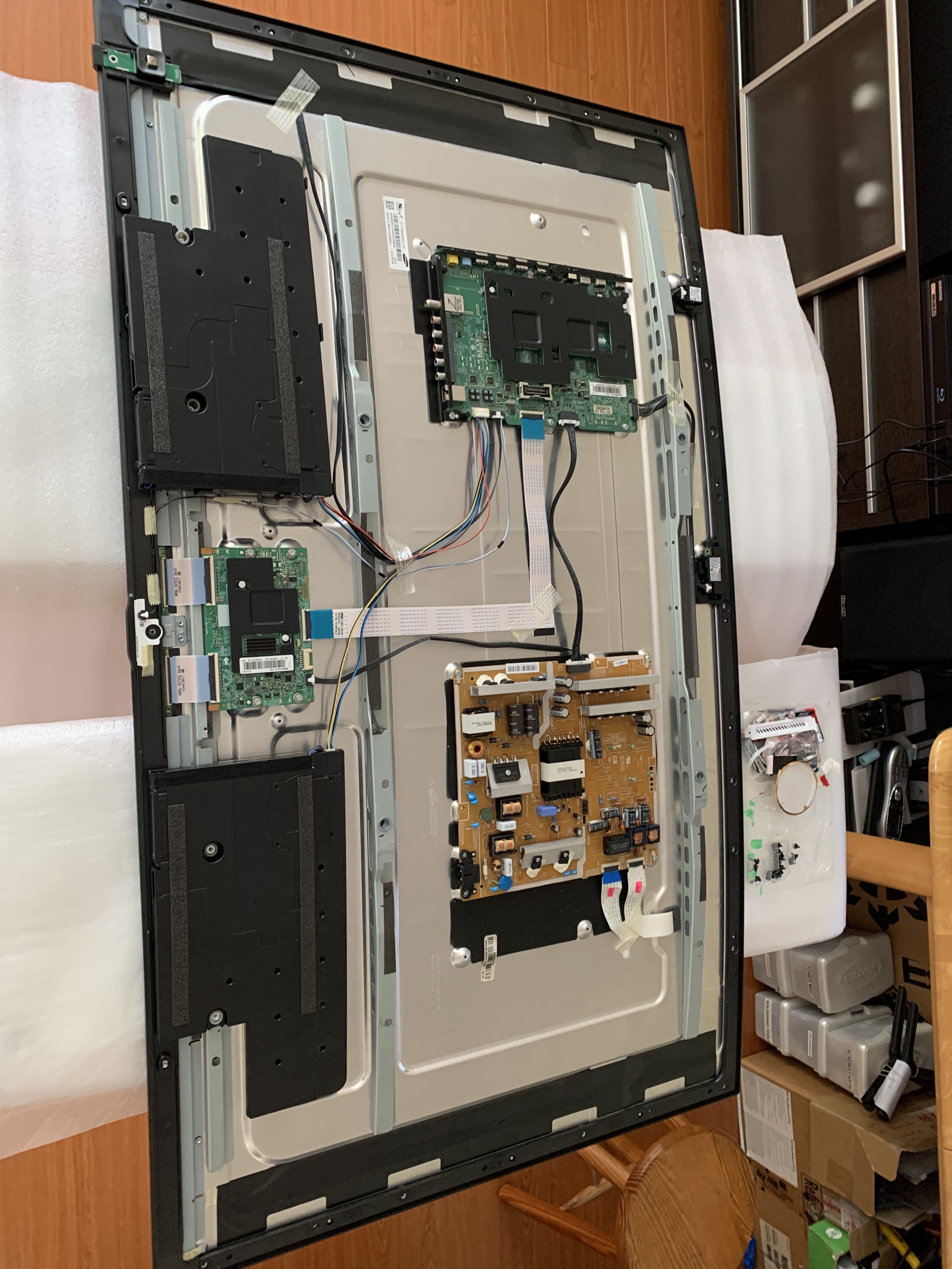

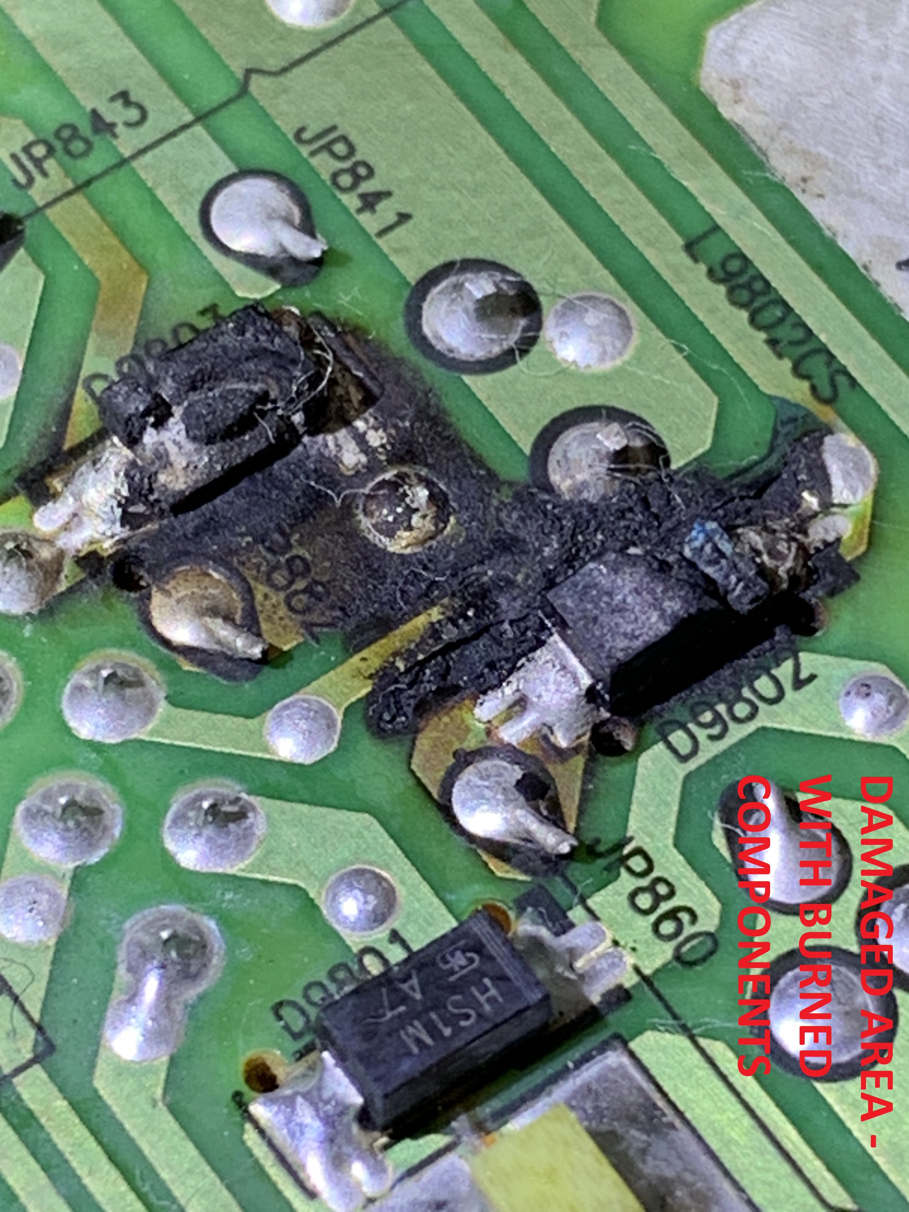

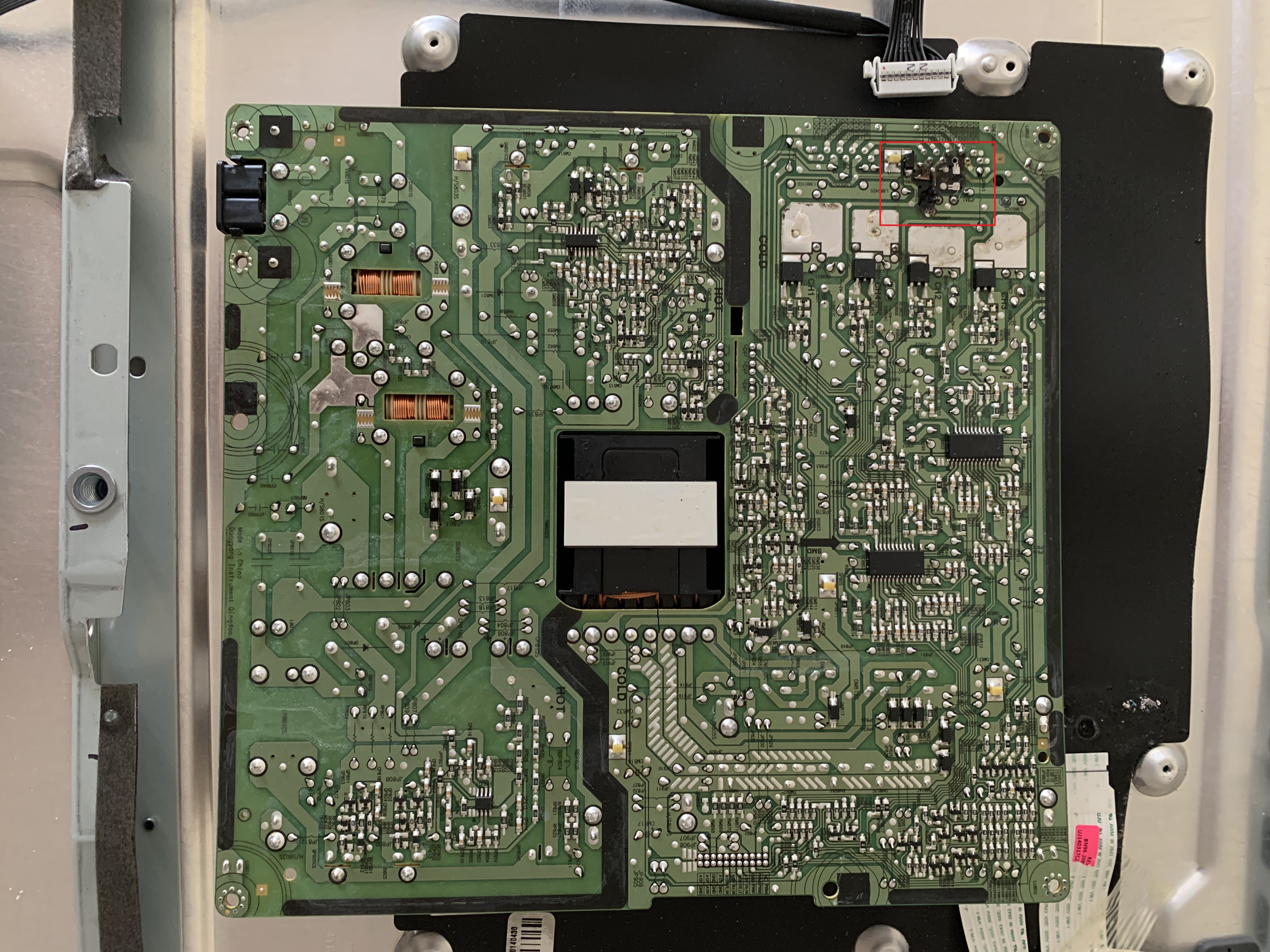

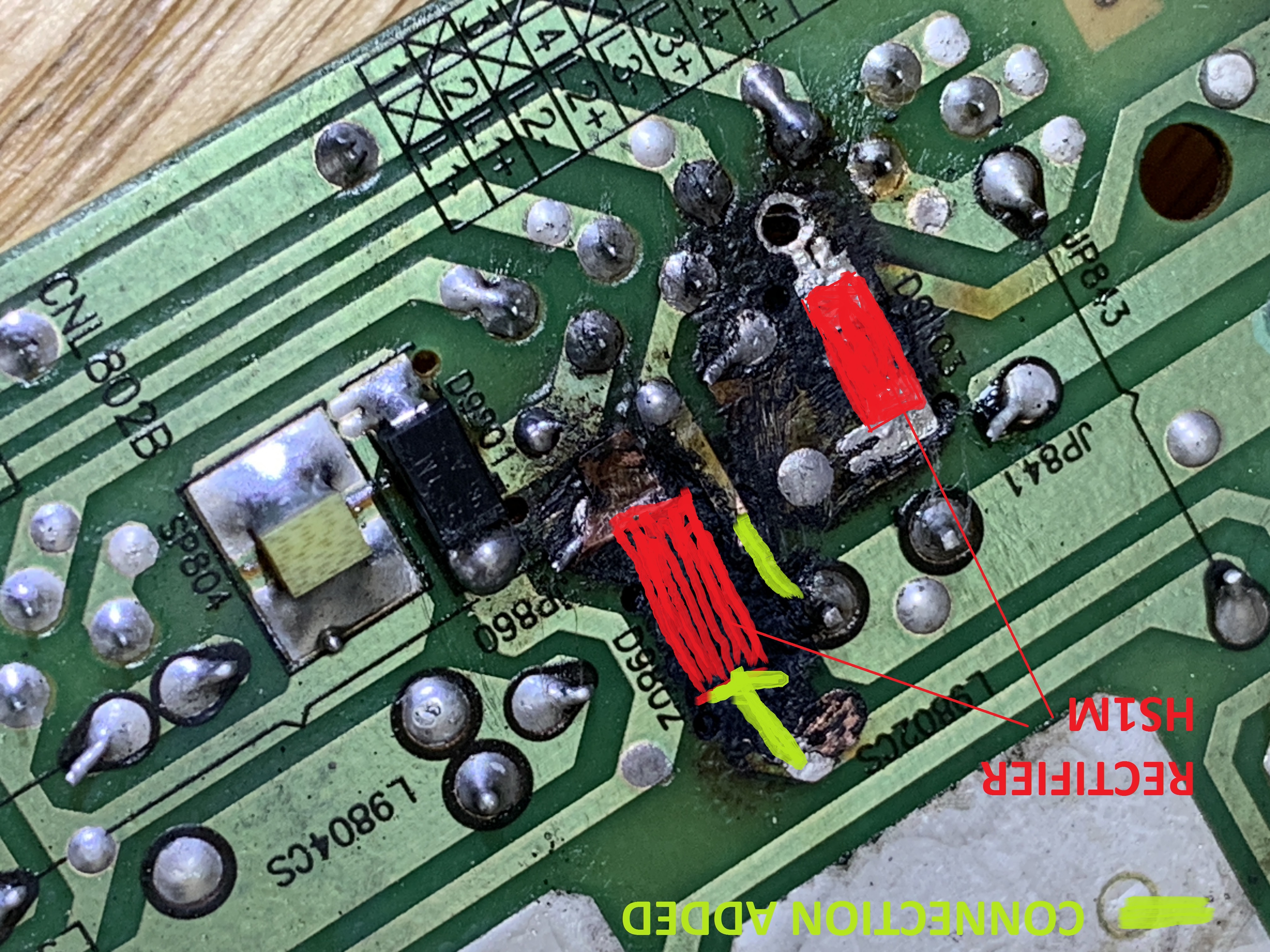

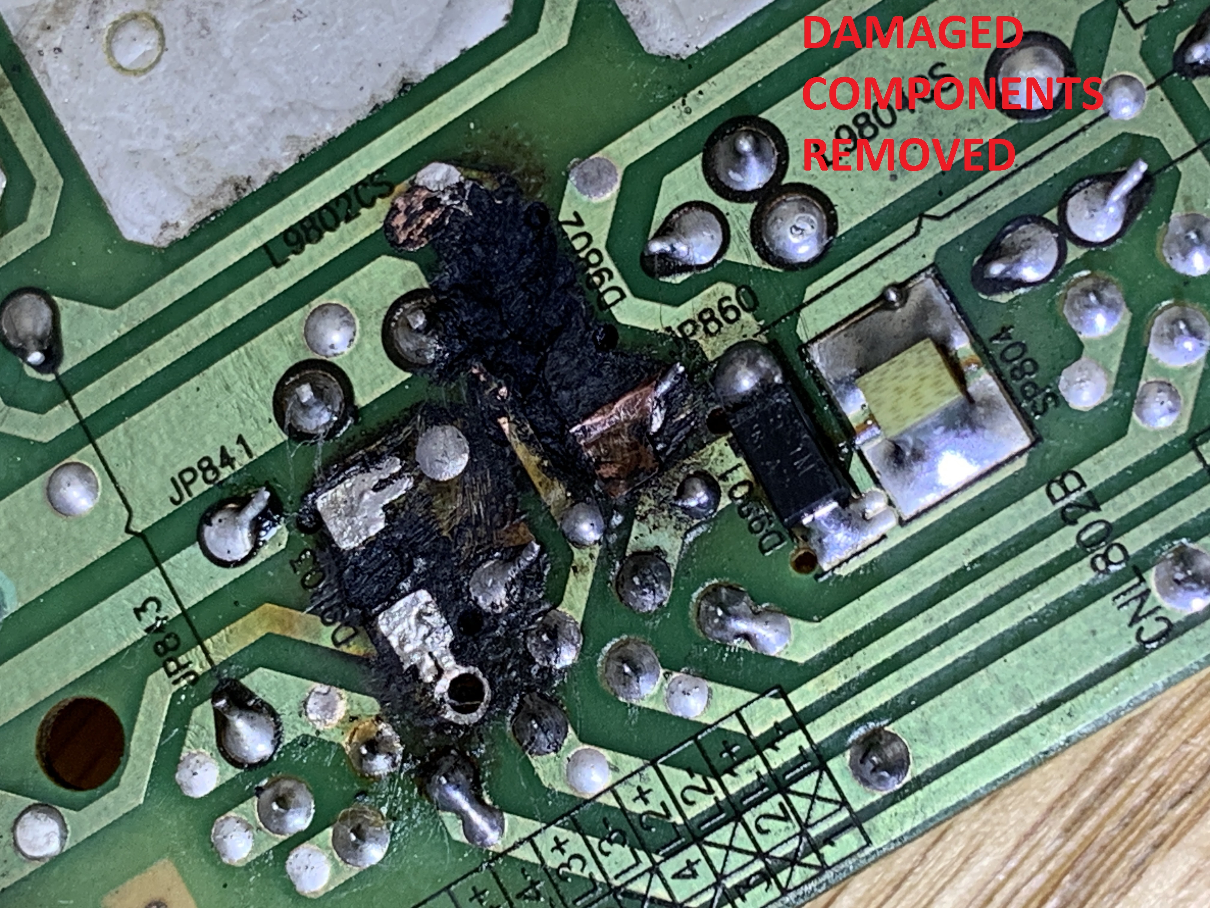

    The TV is dark in the middle half horizontally. At first, I thought that the led strips in the middle were not working. After opening, I found that on the power board at least 2 rectifiers/diodes were burnt/damaged. Therefore, I will try to replace the damaged rectifiers first before checking the led strips. But the burnt area was damaged very badly. With my limited knowledge, I guess the connections may be like that in the attached photo. And the direction of the 2 x rectifier should be the same as the one left nearby. Please help by checking if I am correct or not.

    If anybody has the same power board, please send a photo of the damaged area so that I can follow to fix it.

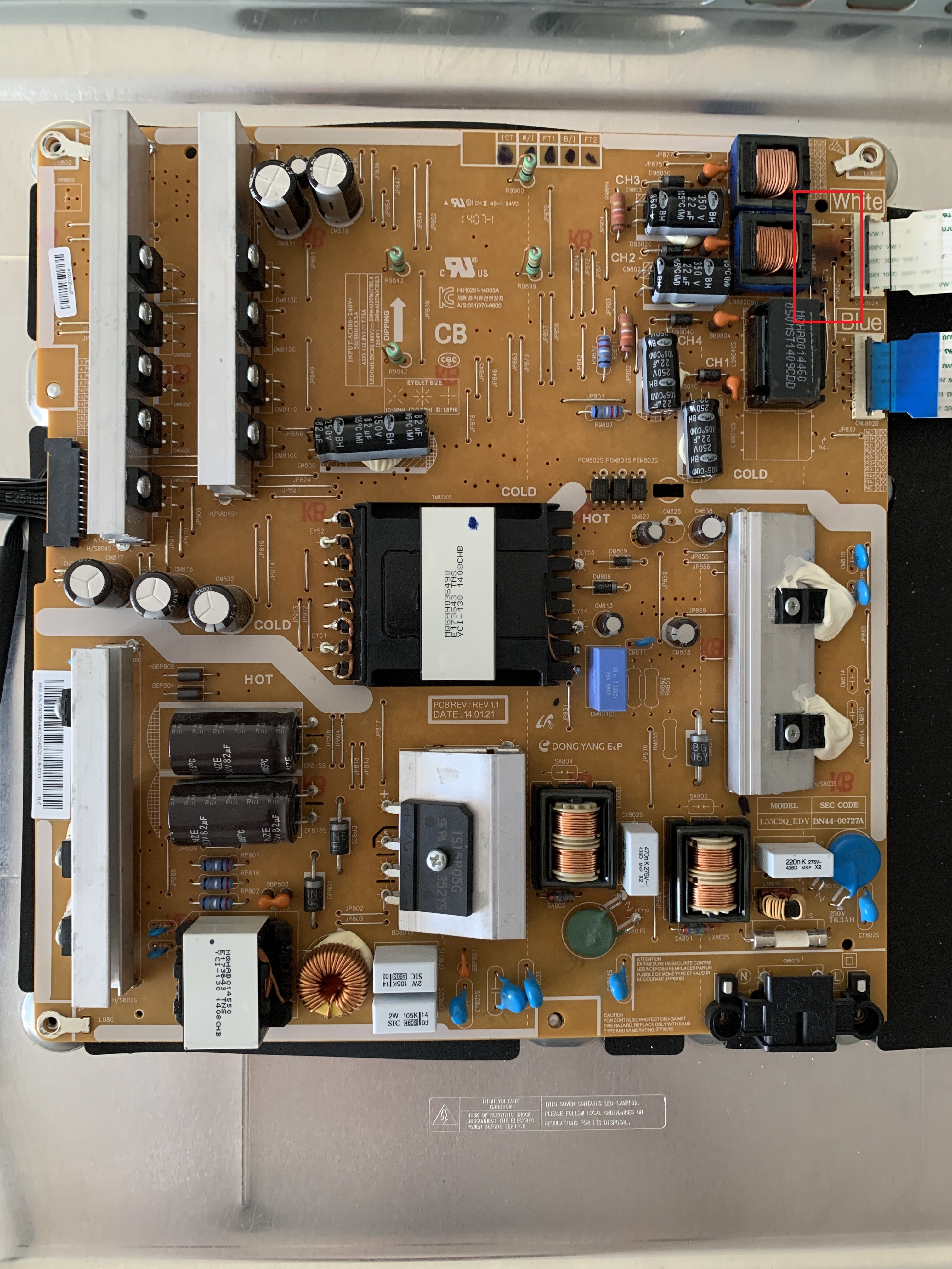

      I found a photo of it.
