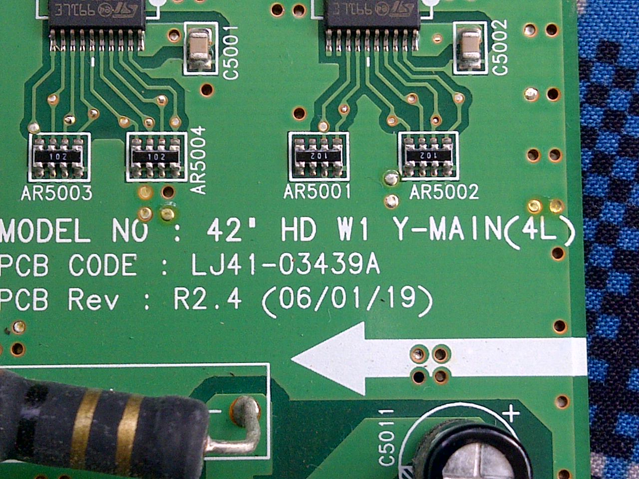

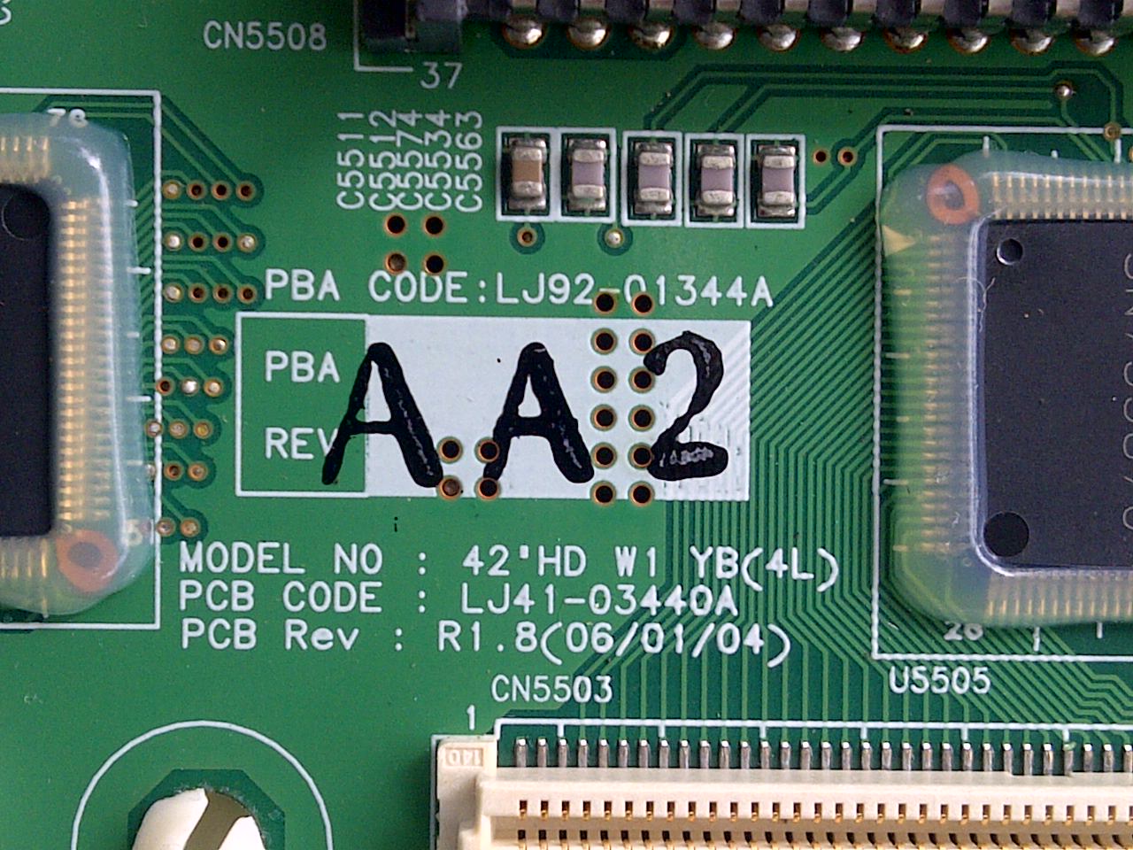

    This is 1 of 2 such units I own. It developed a band (approx 10 cm) at the bottom fairly early in its life but otherwise seemed ok.
    I turned it on last week and there was no picture but sound was normal.
    After reading of similar problems I was motivated to open and examine the set.

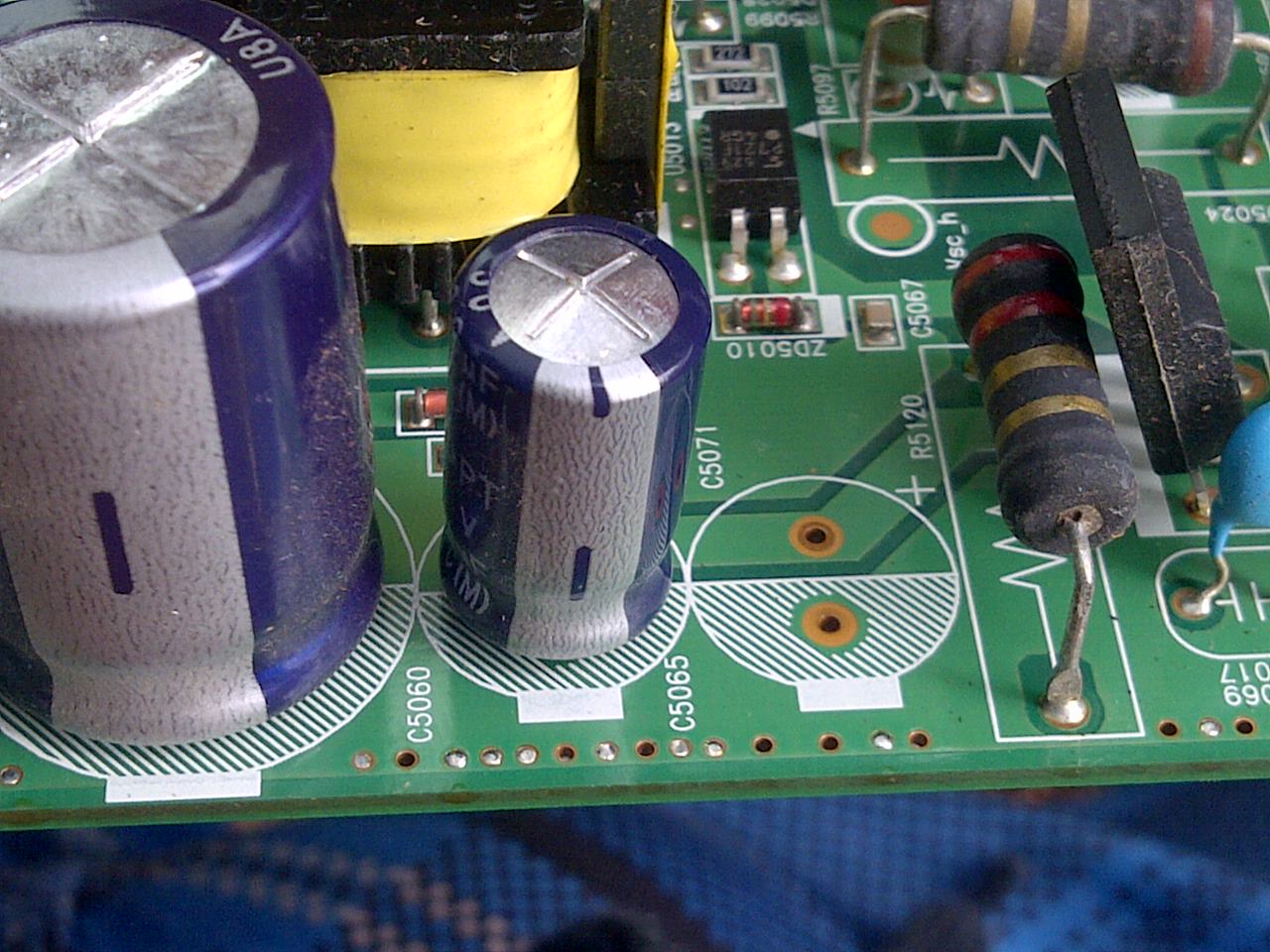

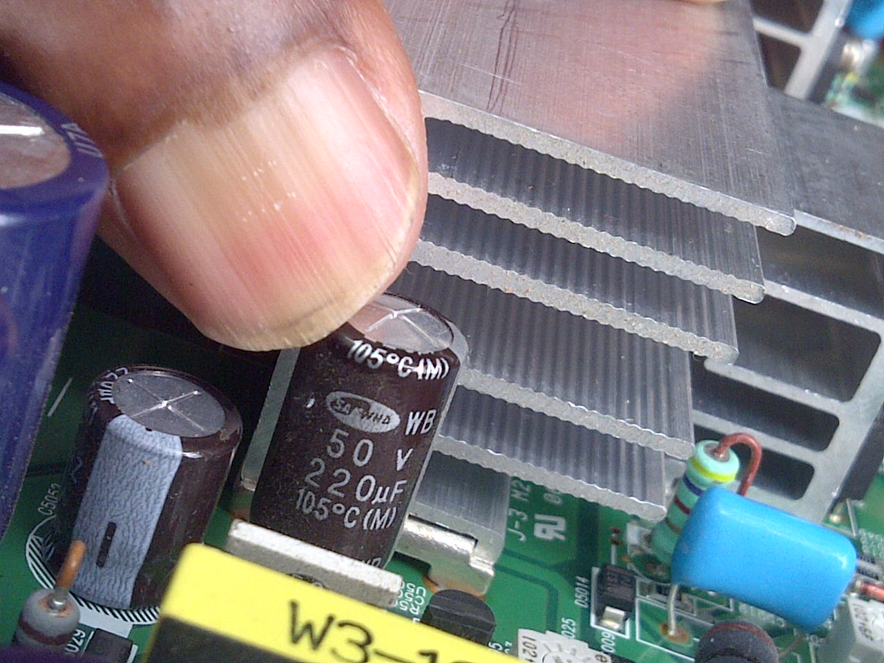

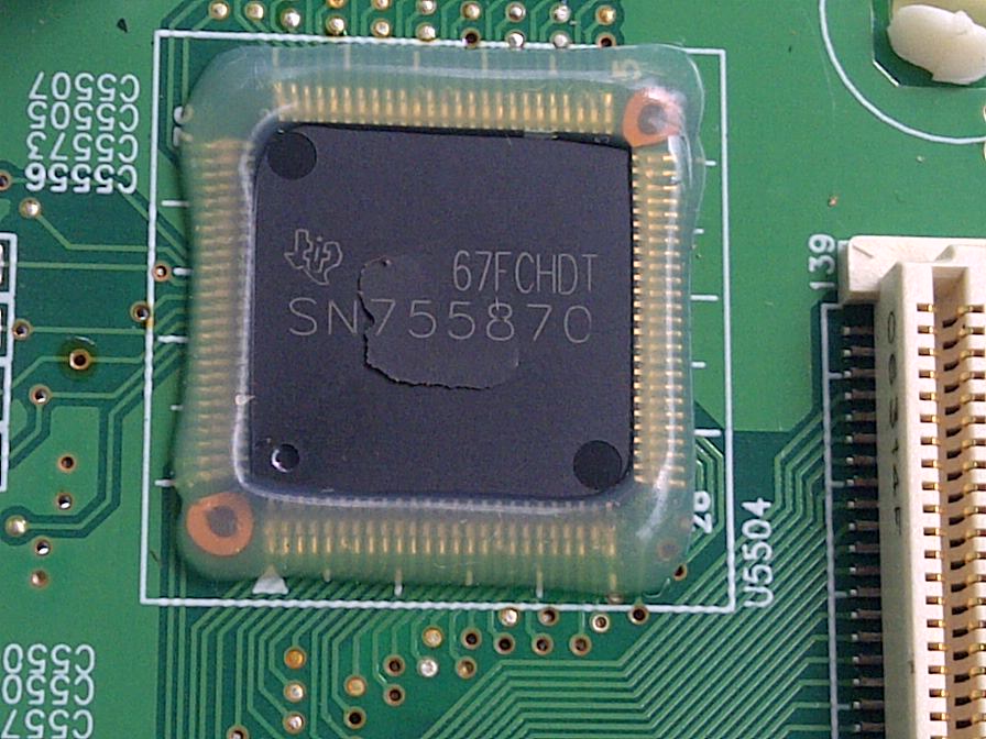

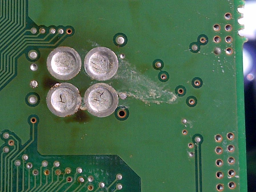

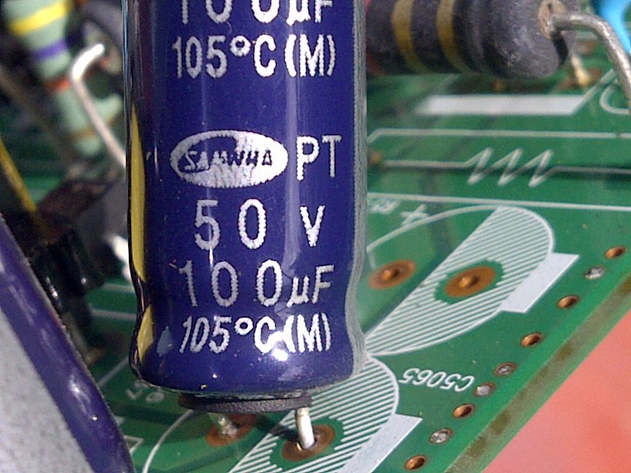

    There is a blown chip on the buffer board as well as 2 bloated capacitors (1 leaked) on the Y-Main board.
    I do not have the level of skill to replace the chip on the buffer even if it is available, so I will be replacing the board.
    Is there any reason to believe the Y-main damage is more extensive than the 2 blown caps observed?

    Re: Samsung HP-S4253 Y-Main and Buffer
    There is a listing on eBay for a buffer and y-main from the same model tv but with different pcb/pba numbers as mine.
    "SAMSUNG HP-S4253 Y-SUS/ BUFFER LJ41-04211A, (LJ92-01393A, LJ41-04212A)"
    Does anyone know if this will work with my unit?
    SAMSUNG HP-S4253 Y-SUS/ BUFFER LJ41-03439A / (LJ92-01344A, LJ41-03440A)
      Ebay vendor informed that the boards will not fit.
      Guess have to get buffer with original number and attempt to repair y-main
        Got replacement buffer and y-main.
        Still no picture!
        Please help
          Either you may have gotten a defective buffer or y-main, or your panel has failed.
            It worked after disconnecting and reseating cables to main and logic boards.
