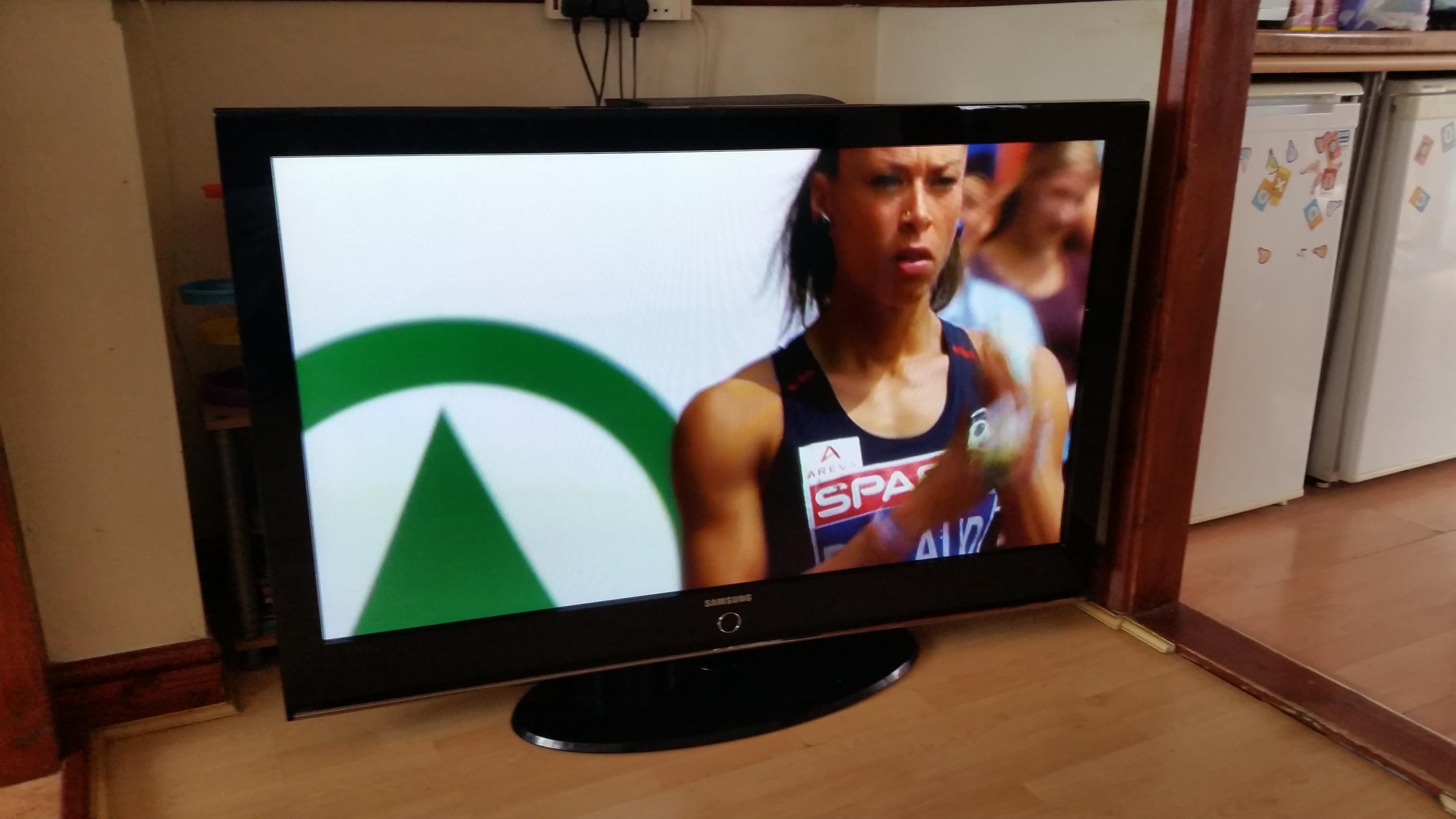

                                      it seemed the ribbon going from the ysus to control board was removed and not put back properly from the previous guy who owned the tv all working at the moment but time for testing
                                      thanks guys for your help
