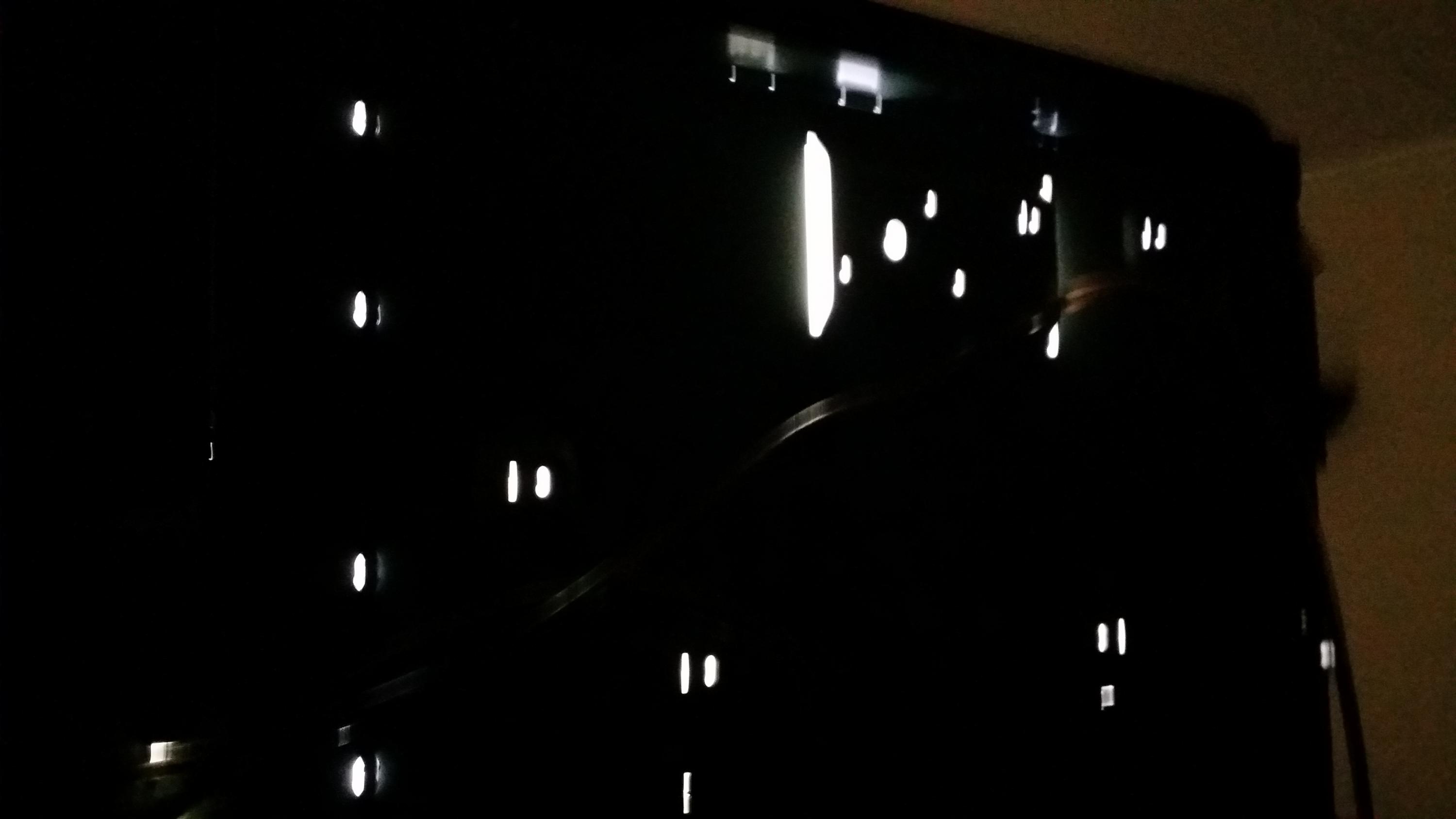

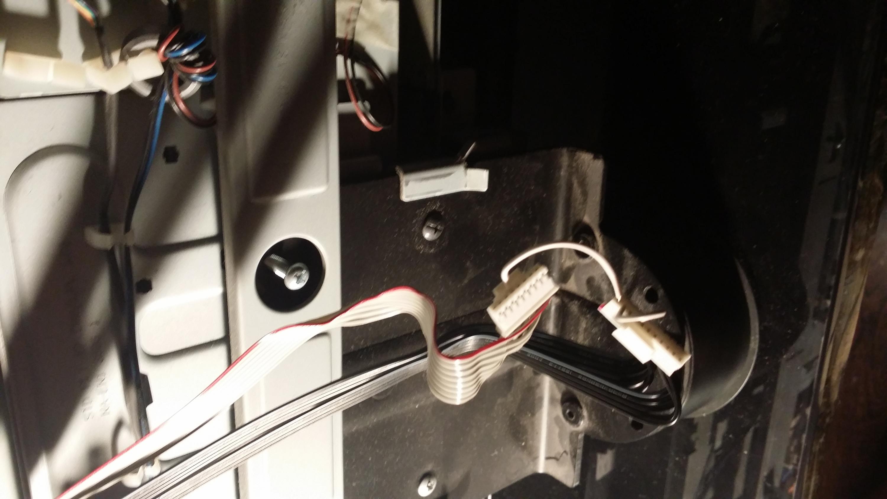

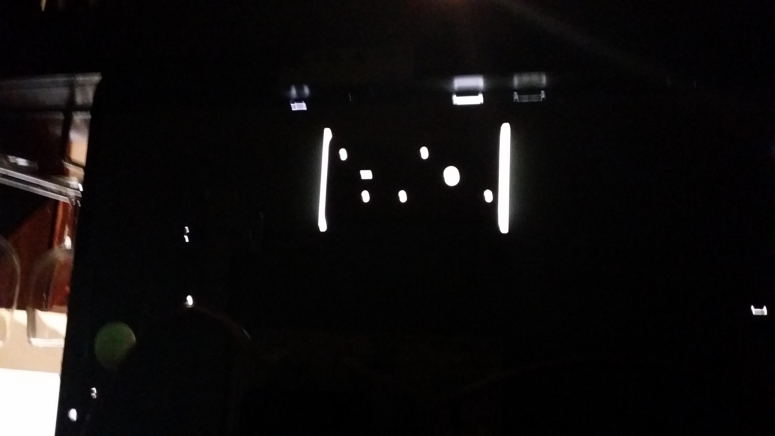

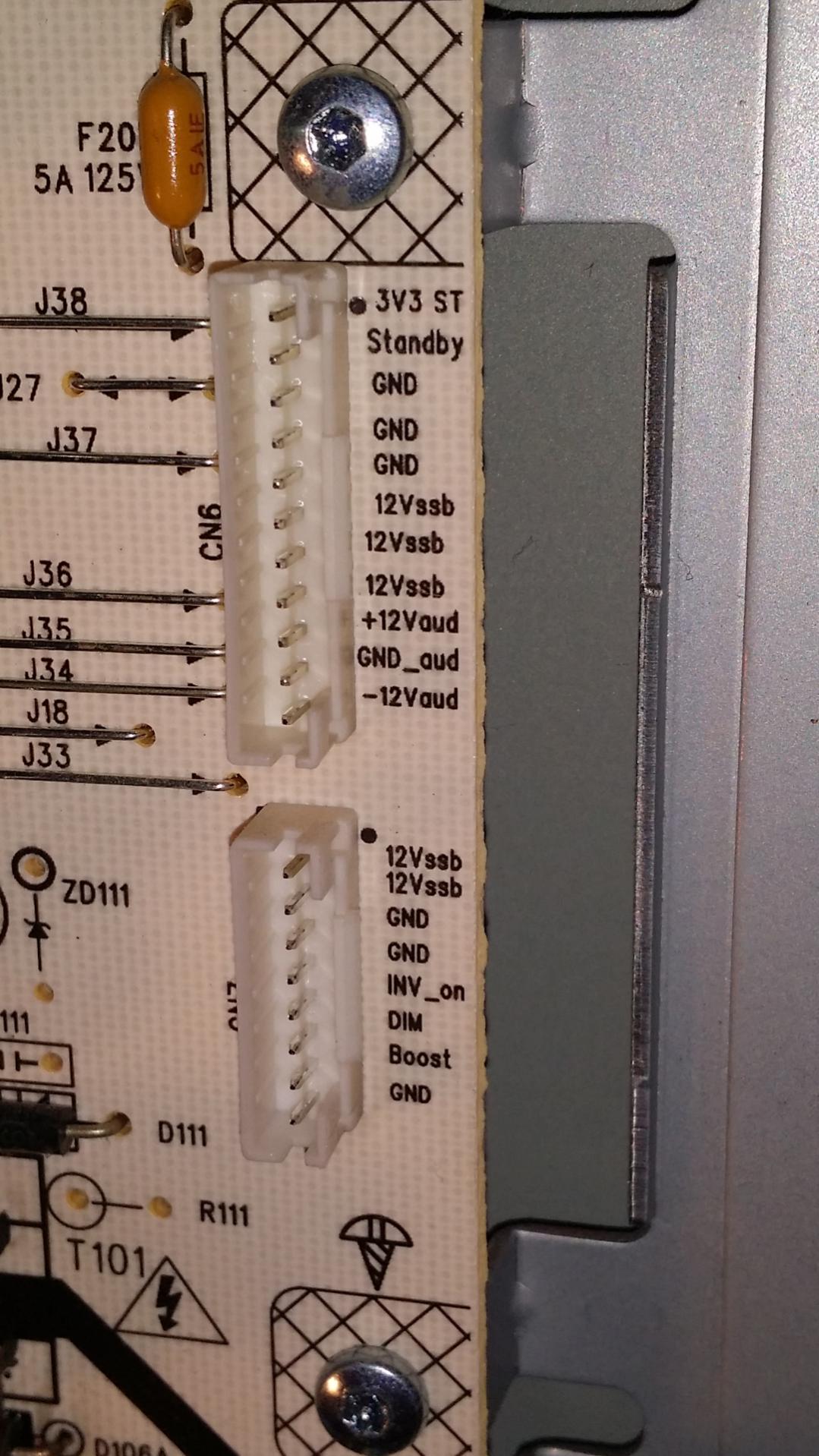

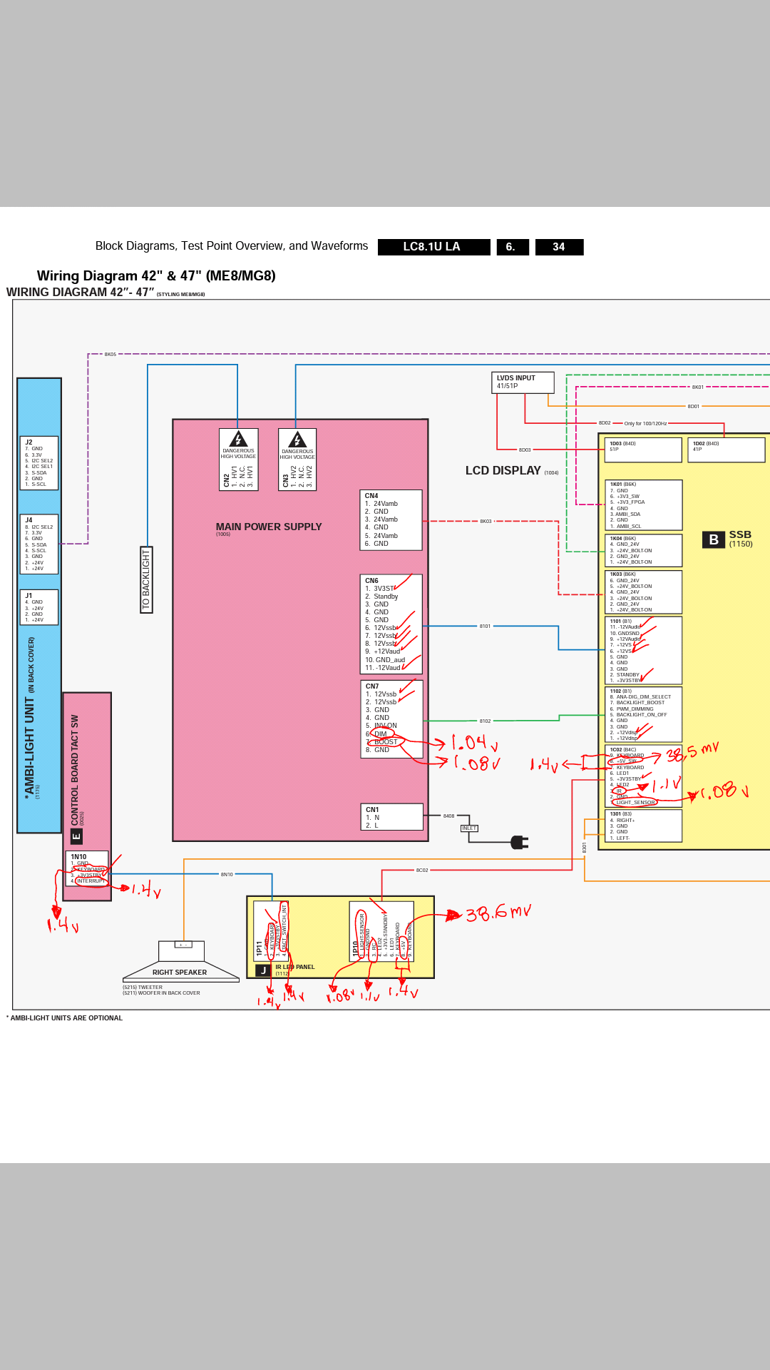

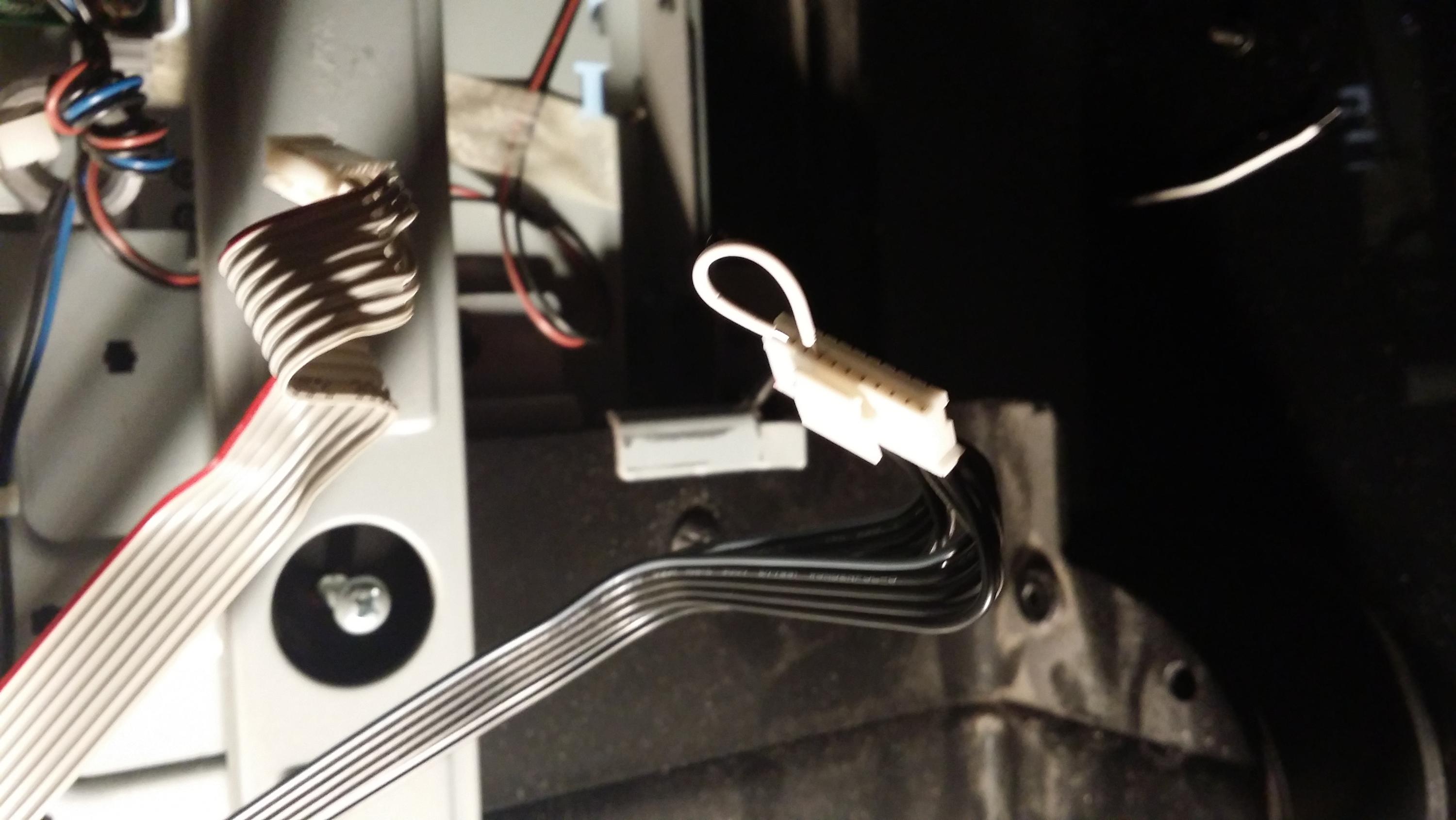

    Philips 42" Model: 42PFL3603D/F7 Won't turn on
    Philips 42"
    Serial No.: YA1A0849 42
    Chasis: Lc8.1U LA
    This tv is giving me a headache, it was working fine until a bad storm hit and now is gone...
    Have replaced two capacitors from power board, replaced the SSB and the Tcom board also, there is not red standby light, have done some tests, look in the pictures, any help will be really appreciated, thanks...
