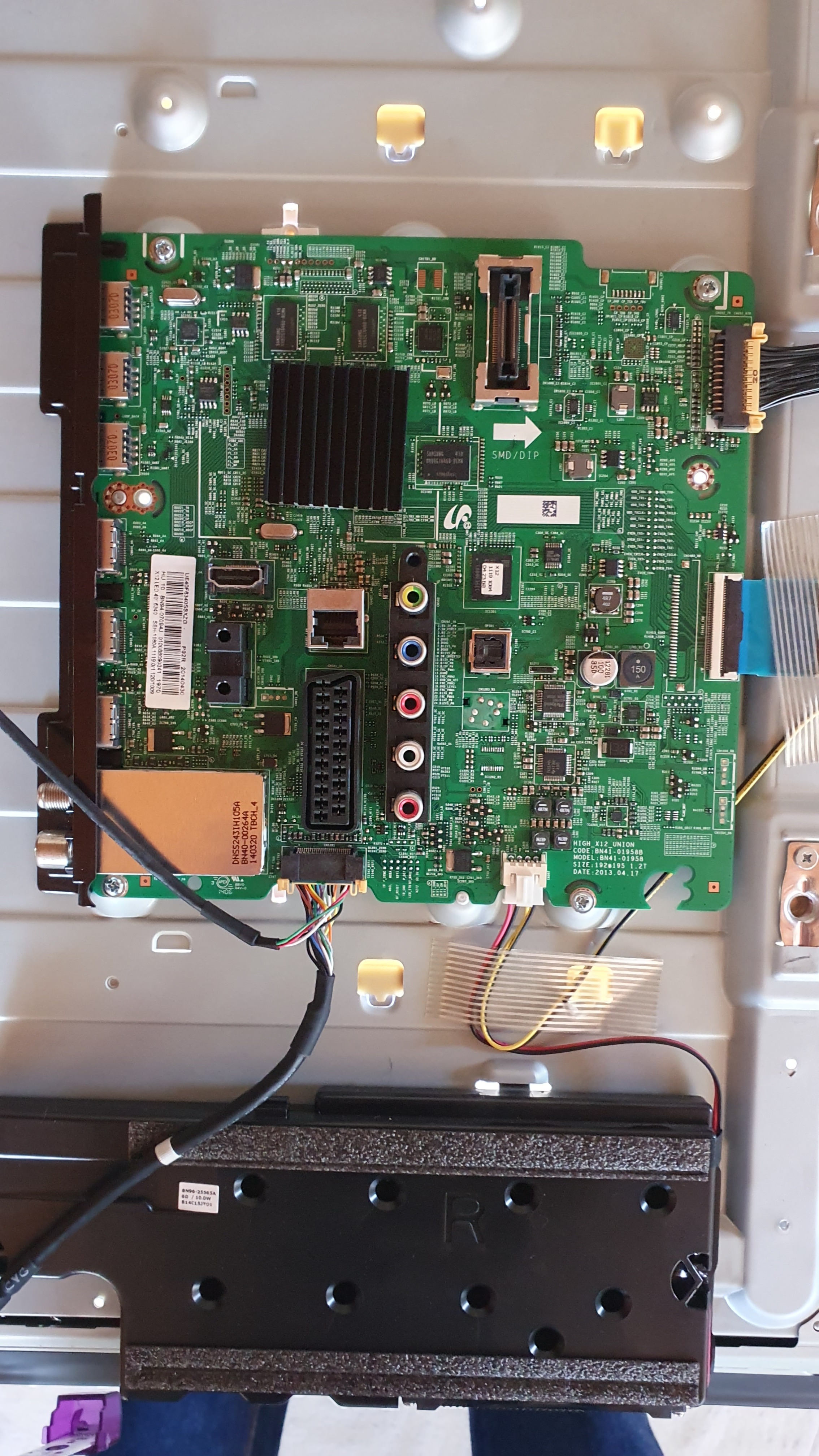

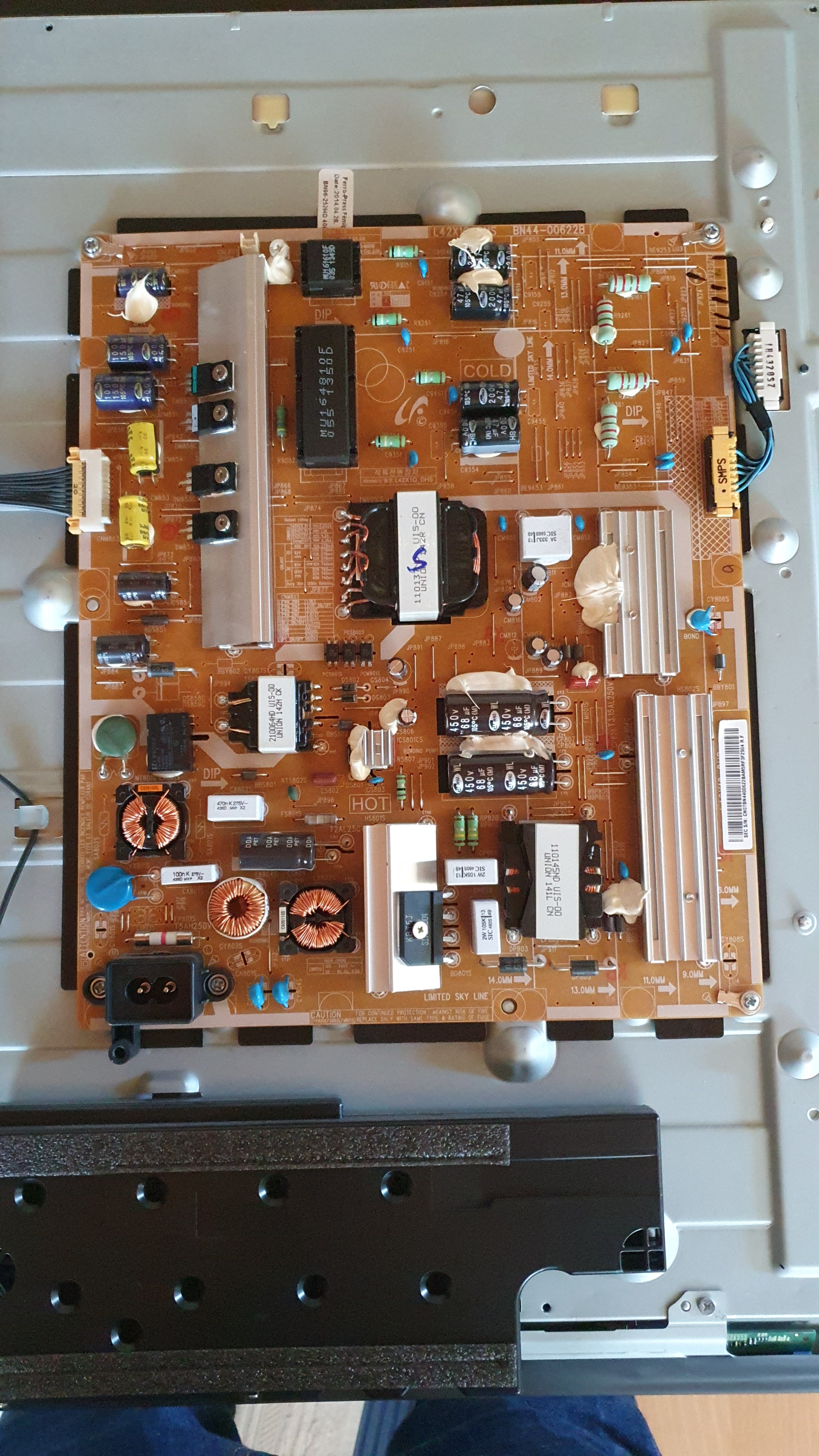

    My Samsung UE40F6340, which I only use occasionally, has recently started turning itself off. It can take a few seconds to a few minutes before it happens. I've checked the auto sleep settings and similar options and found that none of them are enabled. I also unplugged all connected devices, but that didn't change anything. Of course, I also tried a different power outlet, which didn't help either.
    After that, I opened the TV to see if there was any apparent defect, but found nothing. Pictures are attached. Then I disconnected the cable between the power board (right side) and the receiver board (left side). When I did that, the TV didn't turn off. So I assume that the receiver board is sending the shutdown signal.
    Do you have any ideas what could be causing this?​

    The main problem with this chassis is the eMMC.

      Is there a way to confirm that this is the problem? I guess nothing else than replacing the entire board would (possibly) solve the issue?

          Well, if you don't have a programmer for eMMC and you don't know how to transfer native keys to a new eMMC programmed with a working dump, then yes, only a motherboard replacement. For diagnostics, try heating it up a little with a hair dryer at 100 degrees Celsius.

                It might work for diagnostics, but for full operation I still need to change it to a new one.

                  So, how sure are you, without any tests, that it is the eMMC and a change of the receiver board would solve the issue? How big are the odds that the power supply board has an issue and there is a voltage drop that causes the main board to send the "switch off" command?

                        And how sure are you, that it is the eMMC rather than the power board?

                          I tried this today, but it did not help. However, I measured the voltages on the CNM803 while the TV was on.
                          Here are the values:

                          My multimeter did not output a value for 10 ECO_ON/OFF, so I put the dash there. For the PWM signals, I only measured the DC value with the multimeter since I did not have an oscilloscope at hand. The only values that surprise me a little bit are the B13V values for pin 7 and 9 since they are comparably low with 12.3V. Could that be an issue?
                          Are there any other test I can make to confirm if either the mainboard or the power supply board are causing the problems?

                            So youre saying with mainboard unhooked from powerboard you have backlights on and steady, if so that should eliminate backlights and powerbard from fault. That leaves mainboard or panel or a cable in between that is the issue. Maybe check the voltage of the little mlc caps near the emmc chip.
                                    Yes, this is the case. However, what if a voltage drops on the power board and the main board recognizes that corretly and sends the turn off signal. Wouldn't that be possible too?

                                      That test with mainboard unhooked and backlights are on and steady is pretty much a constant and indicates that backlights and powerboard are ok. My guess is mainboard issue, mainboards issues are not easy to deal with even for the pros. Being 40 inches, you might be able to find one for a decent price, if not looks like time to recycle. You can try cleaning the cable ends with a pencil eraser just in case but most likely mainboard is the problem.

                                        It took some time, but I found a spare mainboard, which I have now replaced. The TV seems to work again. Thank you all for your help!
