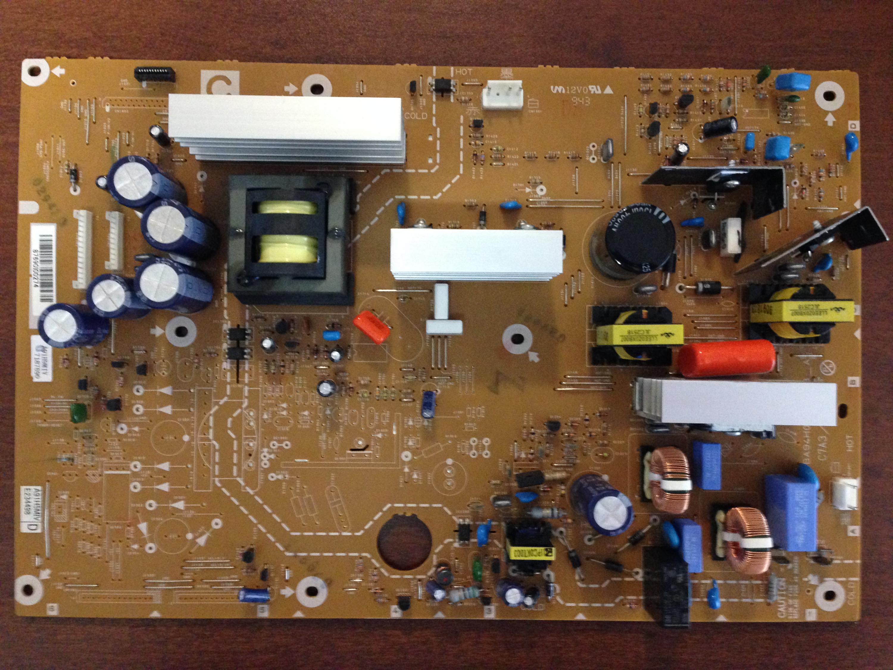

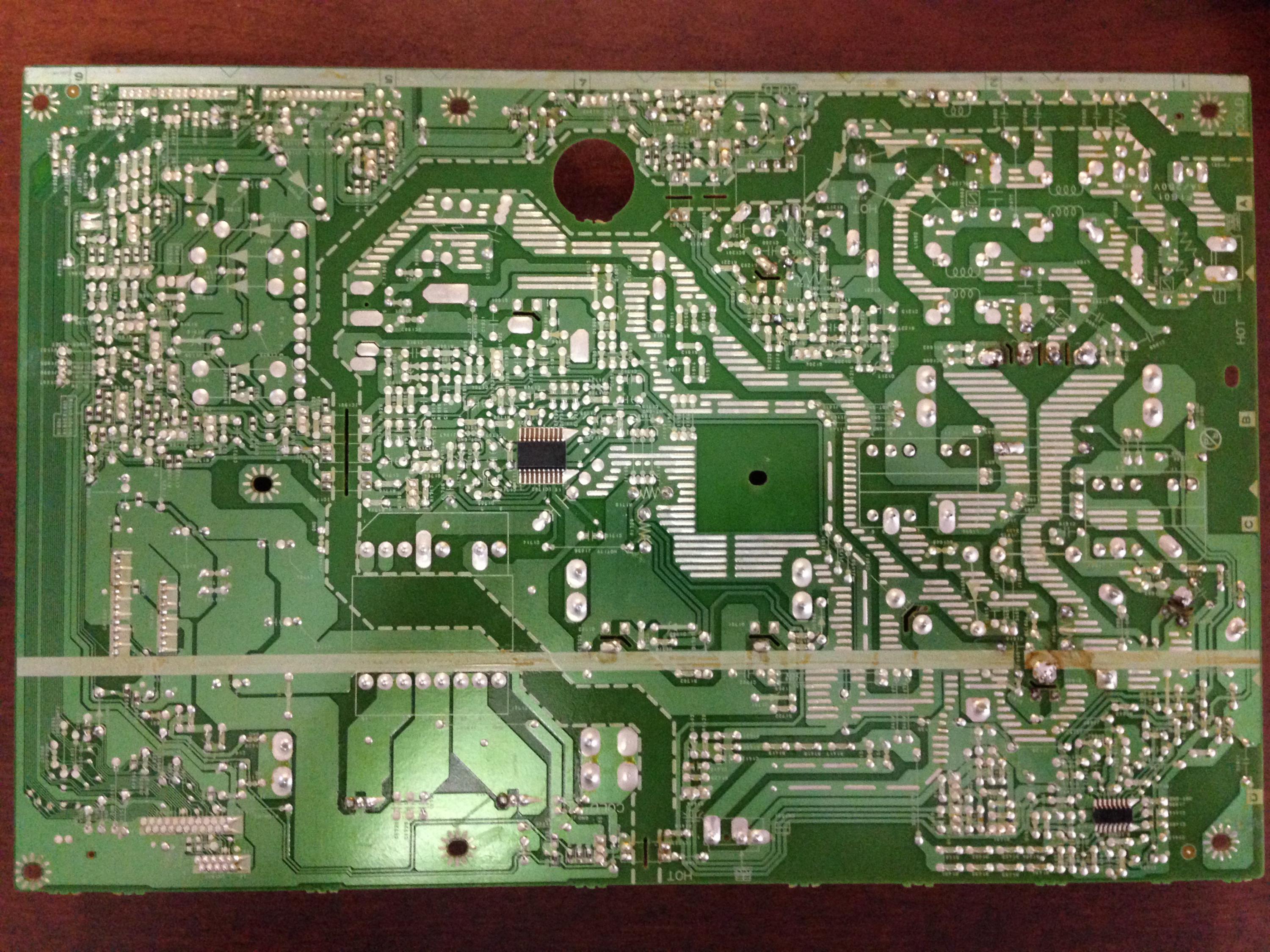

    Re: Phillips 42PFL3704D/F7 - Power Up Issue
    lets see the pictures of the power board front and back,make sure its clear
    • jcm21884
      • Jul 2014
      • 6
      • US
      See attached photos
          Problem Isolation:
          IC 1401 – Texas Instruments UCC28060 -- http://www.ti.com/product/ucc28060
          Pin 9 PWMCNTL: From data sheet: "PWM enable logic output: This open-drain output goes low when HVSEN is within the HVSEN good region and the ZCDA and ZCDB inputs are switching correctly if operating in two-phase mode (see PHB Pin). Otherwise, PWMCNTL is high impedance."
          I found when plugging in the power cord, the Pin 9 voltage to be 5.75 and after 7 seconds dropped slowly to zero.
          I used a 10 ohm resistor to ground at the same time I pressed the power on button and the TV came on.
          I then unsoldered one side of R1439 effectively removing the PWMCNTL to the rest of the circuit. Now the TV operates normally.
          From the description above it appears that this IC is bad because it is not turning on and pulling Pin 9 down. I believe this is an important part of the circuit protection and cannot leave this disconnected.
          Before trying to remove a surface mount IC, I wanted more experienced opinions as to whether this IC bad or there is another issue.
