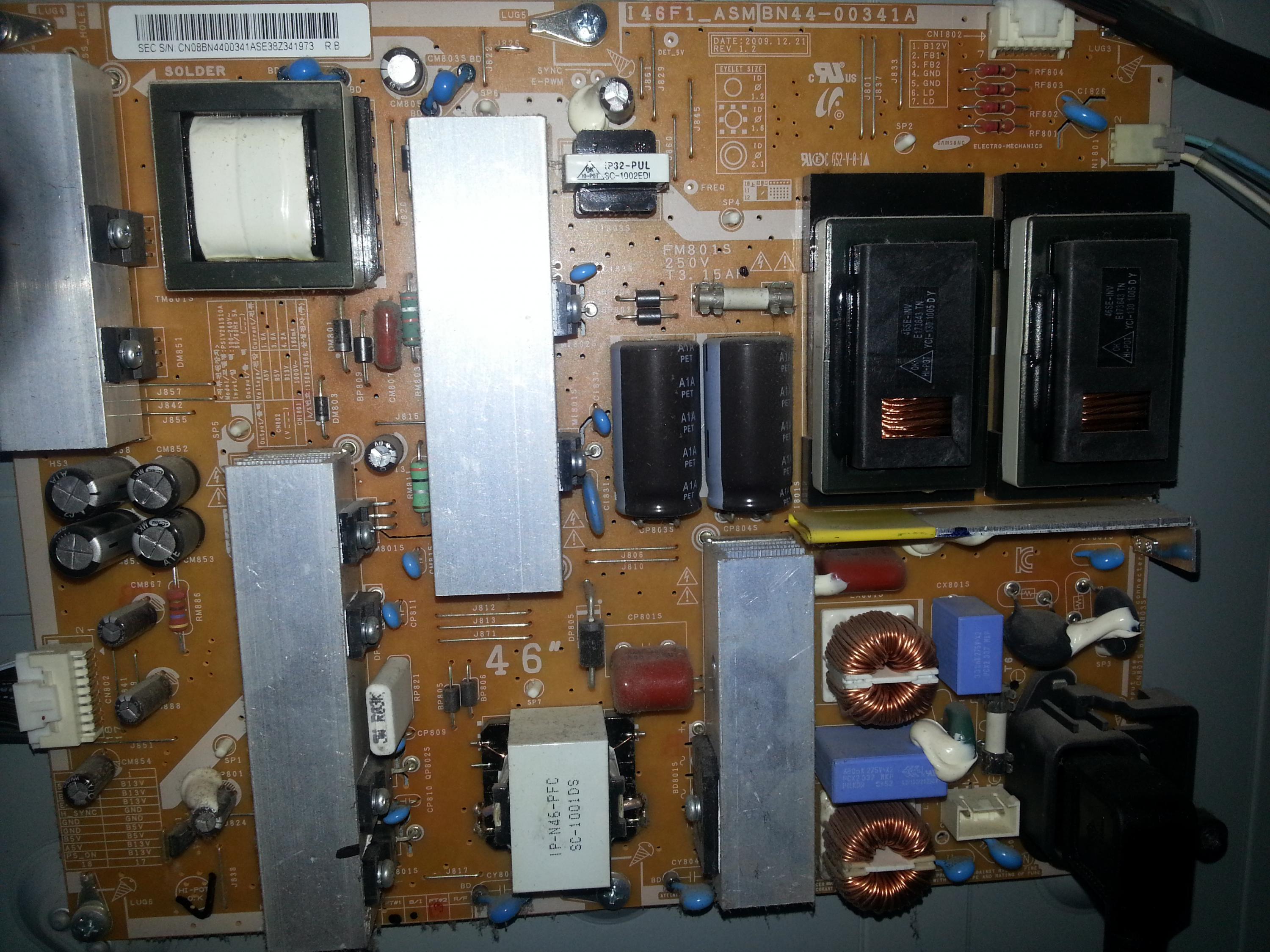

    Hi my samsung tv flickers slightly and appears to have issues with strobe lighting on all inputs done the eco fix but no joy . Ive
    searched online for weeks but I seem to always end up coming back to the "852" fix to cut the wire, alas my inverter board is different ive found a new board for about £80 but I have no idea if this wil resolve my issue and it recurring at a later date , and if this issue is common on this model thanks for your time

    Would you care to share pictures of the parts inside the TV?

      Hope this picture ok many thanks

        OK, do you have a digital multimeter available?

          No sorry my knowledge is rather limited but thanks for replying
            Re: Samsung LE46C650LK
            There isn't anything we can really suggest without one. You would have to get one or pay for a repair.
            You could try swapping the board, but it can be an expensive mistake if diagnosis is wrong.

              Ok i will ask a friend if i can borrow his and will get back to you I did a bit of research it appears that tv maybe an American version thanks again
                Your TV is LE40C650LK
                LE = European
                LN = North American
                LA = South American / Australia&NZ / others

                  Thanks for that. just a quick question if the tv was for a country in Europe other than the uk does the inverter board differ slightly to a uk one.
                    It shouldn't. I haven't seen any instances of that.
