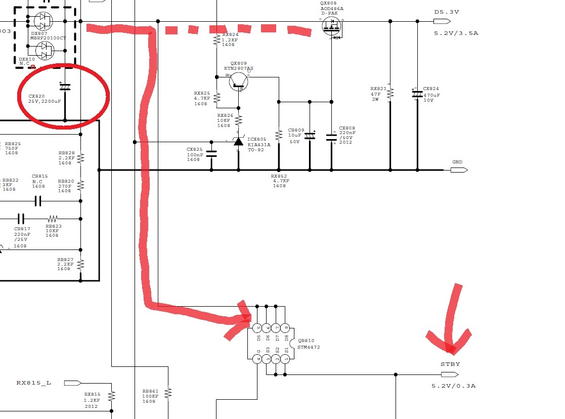

    made a little drawing

          Originally posted by martino View Post
          Yes,I understand that
          What I'm trying to say is that if that cap is shorted(inside cap) it WILL kill the 5volt standby voltage...
          yep yep and 100% agree,thus why I got a new board on weebay and like I said
          in pm,I will give you my old one for free plus other cap
          the time you spent on me is worthy and I thank you,the least I can do;is to give it to you. it's like Pay it Foward movie,doing this = it only can help.

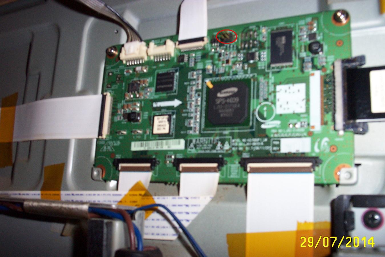

                                I got the new board in despite the smashing of Canada Post it did survive (see pic) the run and look like a brand new board
                                (no heat stain and no yellowish power supply)
                                and I got my voltage where it suppose to be.

                                  any one got a pic of the logic board so I can compare it with mine?
                                  I want to see if CN2008 should have 4 pin sticking out naked,if so it must be a connector of some kind?
                                    #57
                                    Re: Samsung plasma pn50B550t2f wont turn on
                                    That connector is for factory and technician test, jumper pins 3-4 to activate 50Hz test pattern.

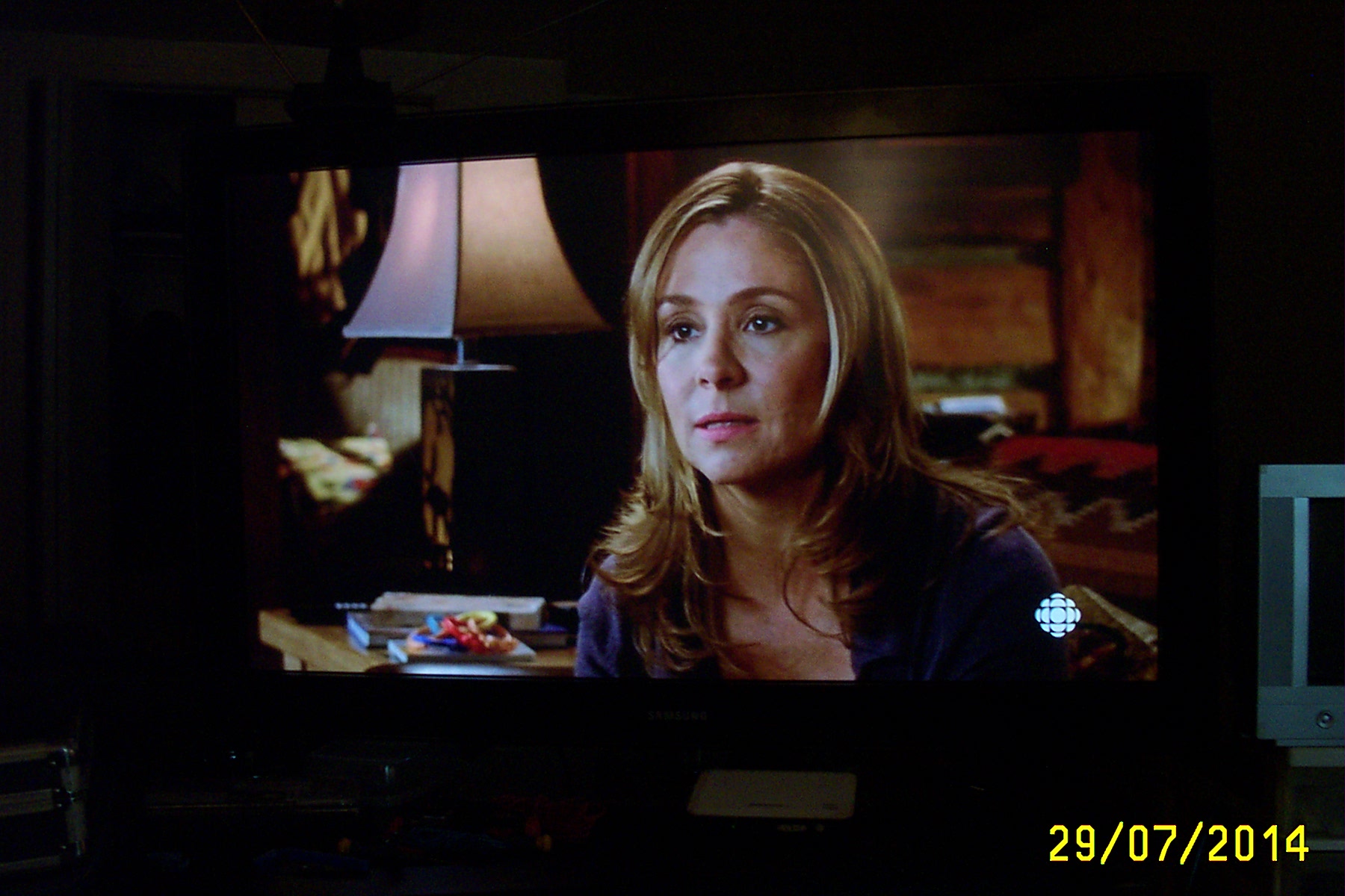

                                          all fix Martino.TV work like a bran new one and for this I thank you a LOT,and all I can say is "Pay it Forward",so read your pm and I'll ship those part for free.
                                          many user of this forum got involve also and to you guys I say thank you;what you did was not useless but very help full thus why it took so long,I'm a truck driver so I had to figure out your complex way of talking.
                                          amazing I got HD TV with "rabbit ear antenna now!!!!!) and I dont intend to give a dime to any TV provider.
                                          no way one should pay to watch commercial.
                                          Thank you all "you made my years" and if I can help in any way;I am stubborn to
