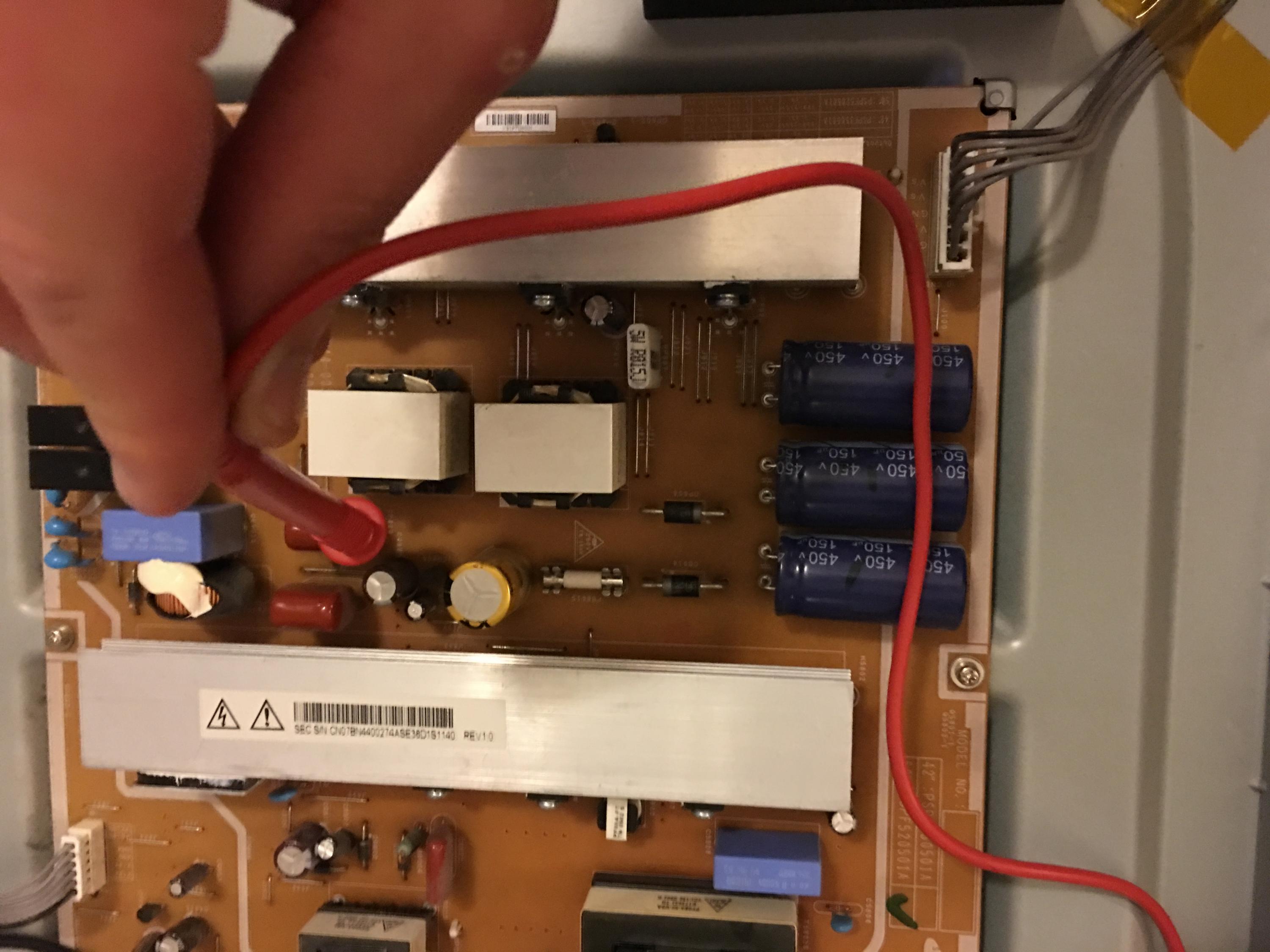

        My TV won't power on. My board is the exact same. There is power until after the first fuse. All fuses check out ok but when the second fuse is tested there is no power. Any thoughts. There is power to somewhere around the red probe. Facet new
          Sorry, I was working from my Iphone and the attachment didn't post. I lose power right around the red probe. Not sure of where to test next.

            take a pic like I did in previous post
            if power plant look like mine; change the entire board it cost 23$ on e-bay or Amazon

              I have power and sound now just don't have a picture. How do I️ figure out which board is bad?

                If you have power and sound then disconnect the cable from the mainboard to the logic (control) board (post #56) and jumper the two pins to see if you have test patterns displayed on the screen.

                  Thank you. The logic board has the blinking light and the main board it is where I️ plug HDM I️ cables in? How do I jumper it? ...very new

                    Remove the cable that goes from the mainboard to the logic control board. On the control board there are 4 pins that stick out. Take an old desktop cd/dvd/hard drive jumper(for setting master or slave) and put it on pins marked 3 &4. If you have colored screens your main board is bad.
