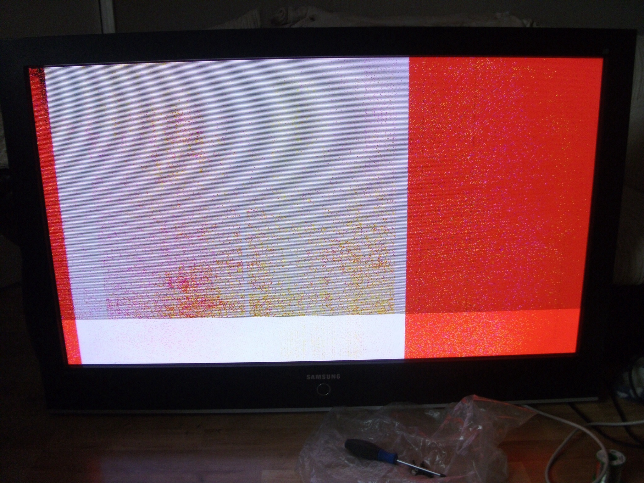

    Samsung ps-50c7hdx/xeu was given to me, it had a blown chip on the upper y buffer board, I have replaced the board and found shorted ziner diodes on the y main board which have now been replaced ( was given the tv in disassembled state so did these repairs before I could power up) when powering up I get very red screen sometimes goes black can't see any menus, not had source connected so can't confirm sound at this stage. Va is fine at 65v but vs states on sticker 202v, I get 201v for a few seconds then when the panel lights up it drops to 188v any ideas are most welcome

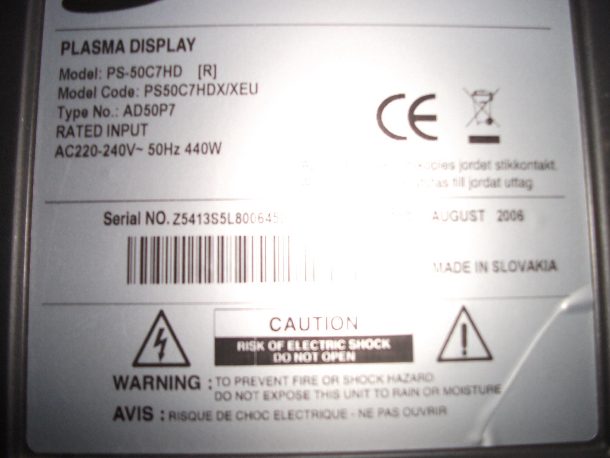

    Model sticker if you guys need other numbers

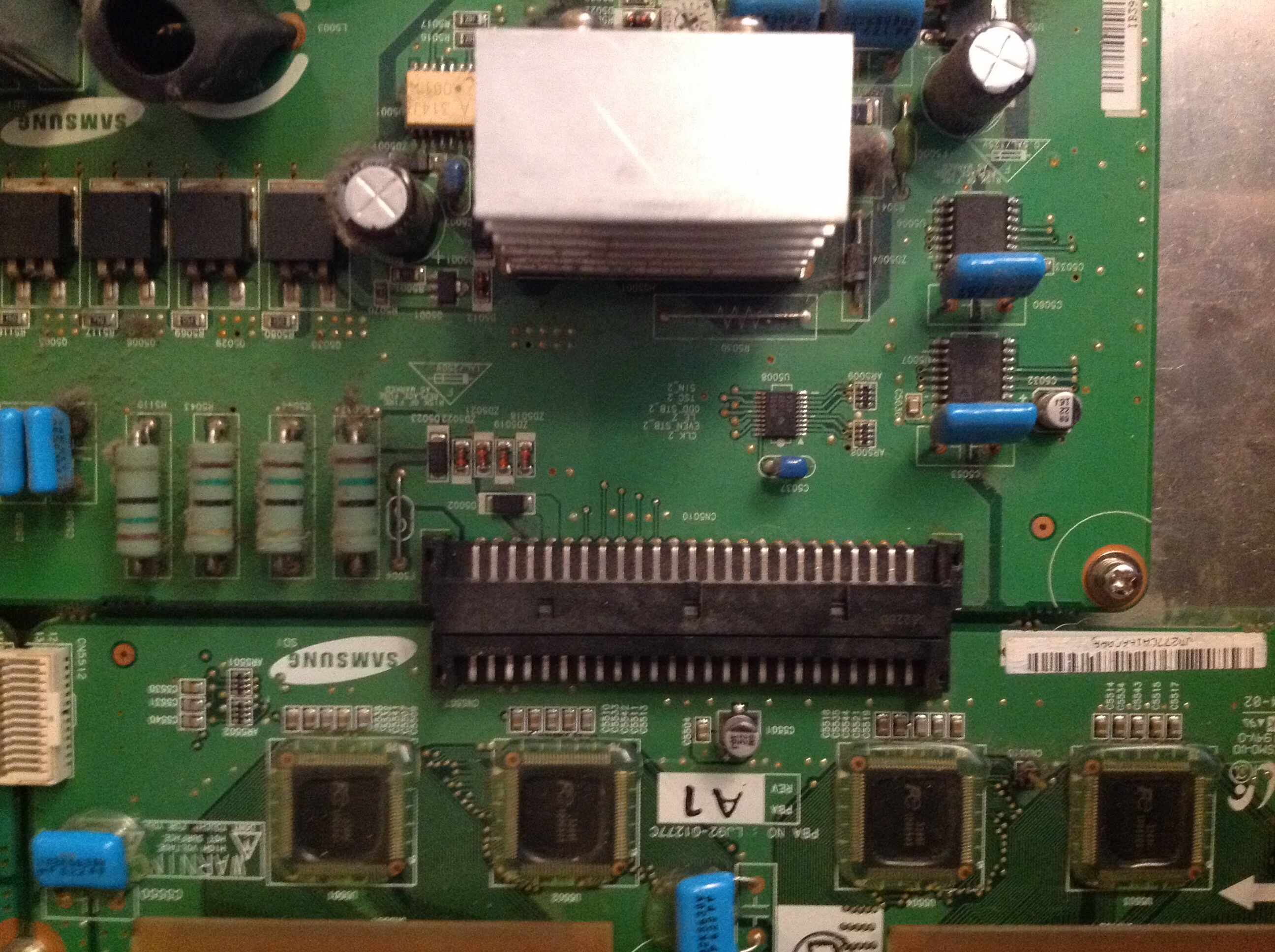

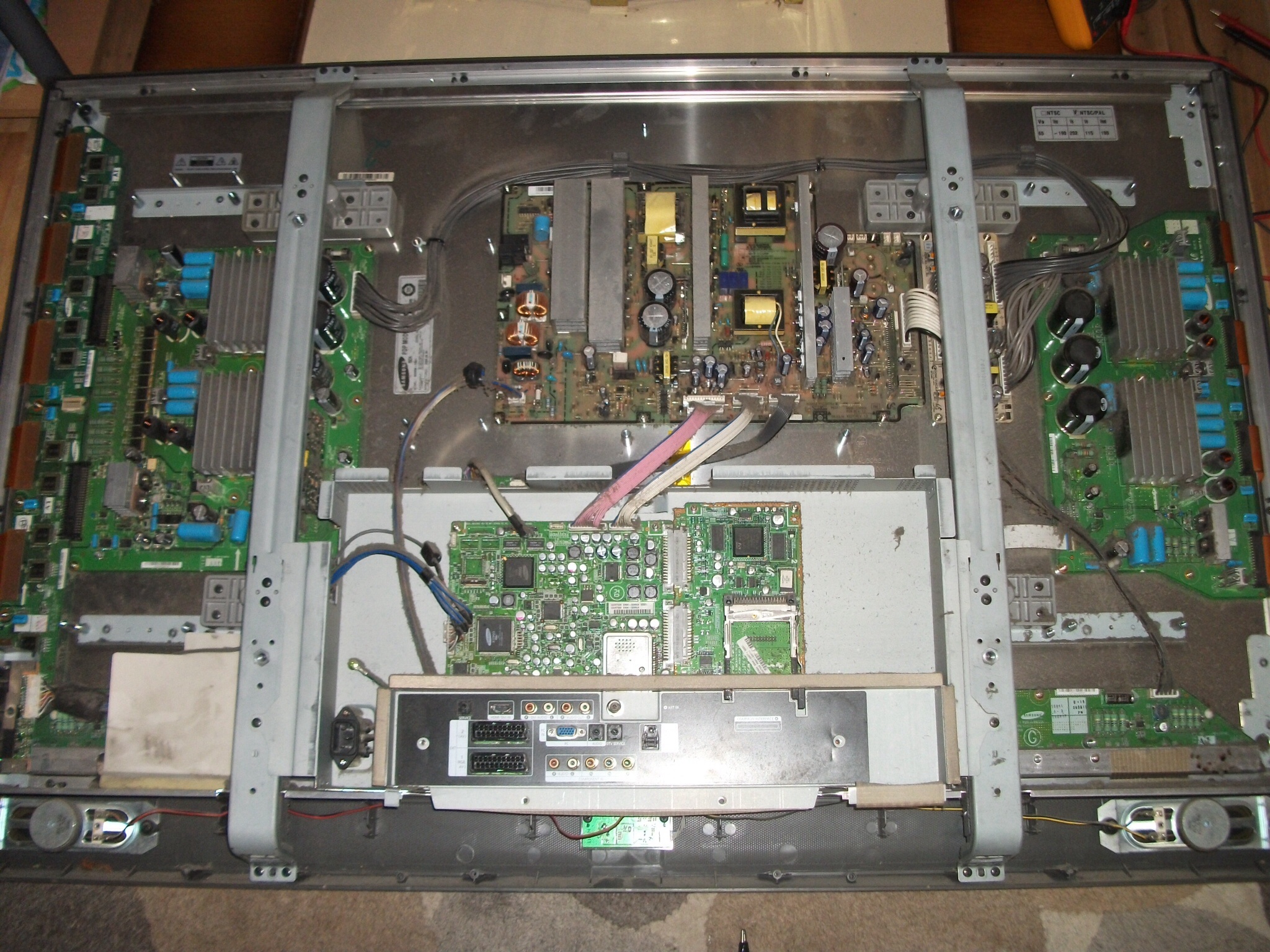

          It looks like your lower buffer may be bad. Can you supply a picture of the Y-buffer and Y-main boards.
          • Andyegerton
            locksmith
            • Jan 2014
            • 17
            • Uk
            Re: Help required samsung plasma ps50-c7hdx
            Here is a picture of the back can get closer later if you need it
              Originally posted by tom66
              Which chip on the buffer did you replace. Tried it with just one buffer?
              Replaced the upper board, both boards were connected in the picture

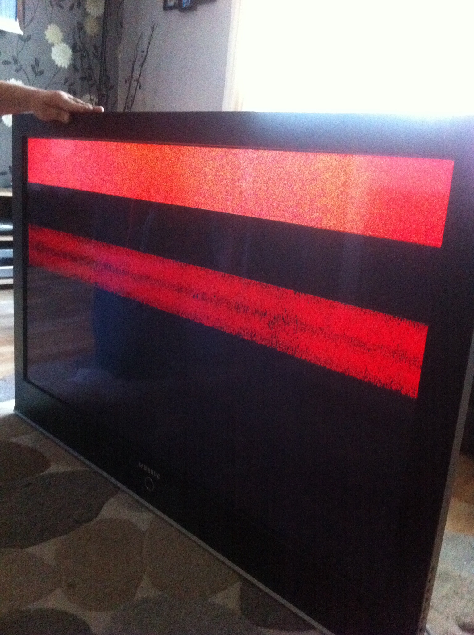

                What do you get on the screen with the LOWER board unplugged from the Y-main, but the upper still in.
                • Andyegerton
                  locksmith
                  • Jan 2014
                  • 17
                  • Uk
                  Here is a picture of what I get seems to be blank unless I press menu or source. Checked voltages and vs is now 201.9. Close enough to 202

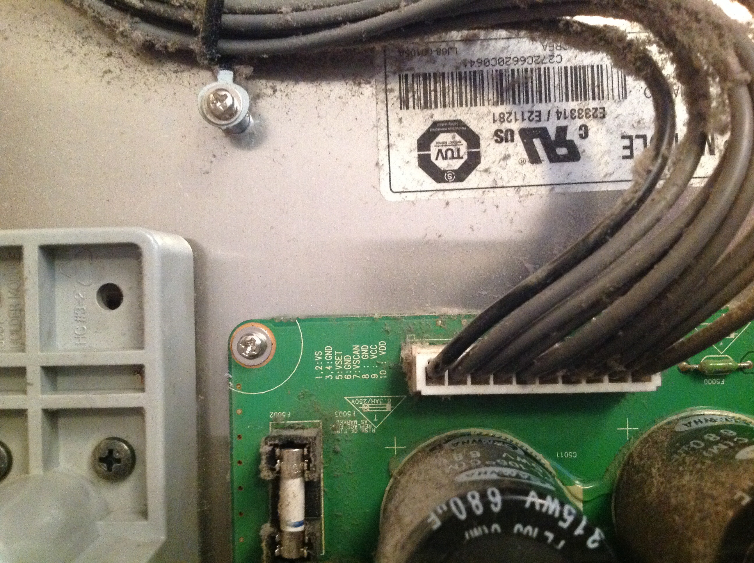

                    Can you attempt to locate the Vsch and Vscan voltages (Vscan may also be called Vsc or -Vsc.) Vsch is tested across the buffer board's negative and positive, as if you were testing it for a short circuit. If unsure post a close picture of the connectors going to each board.

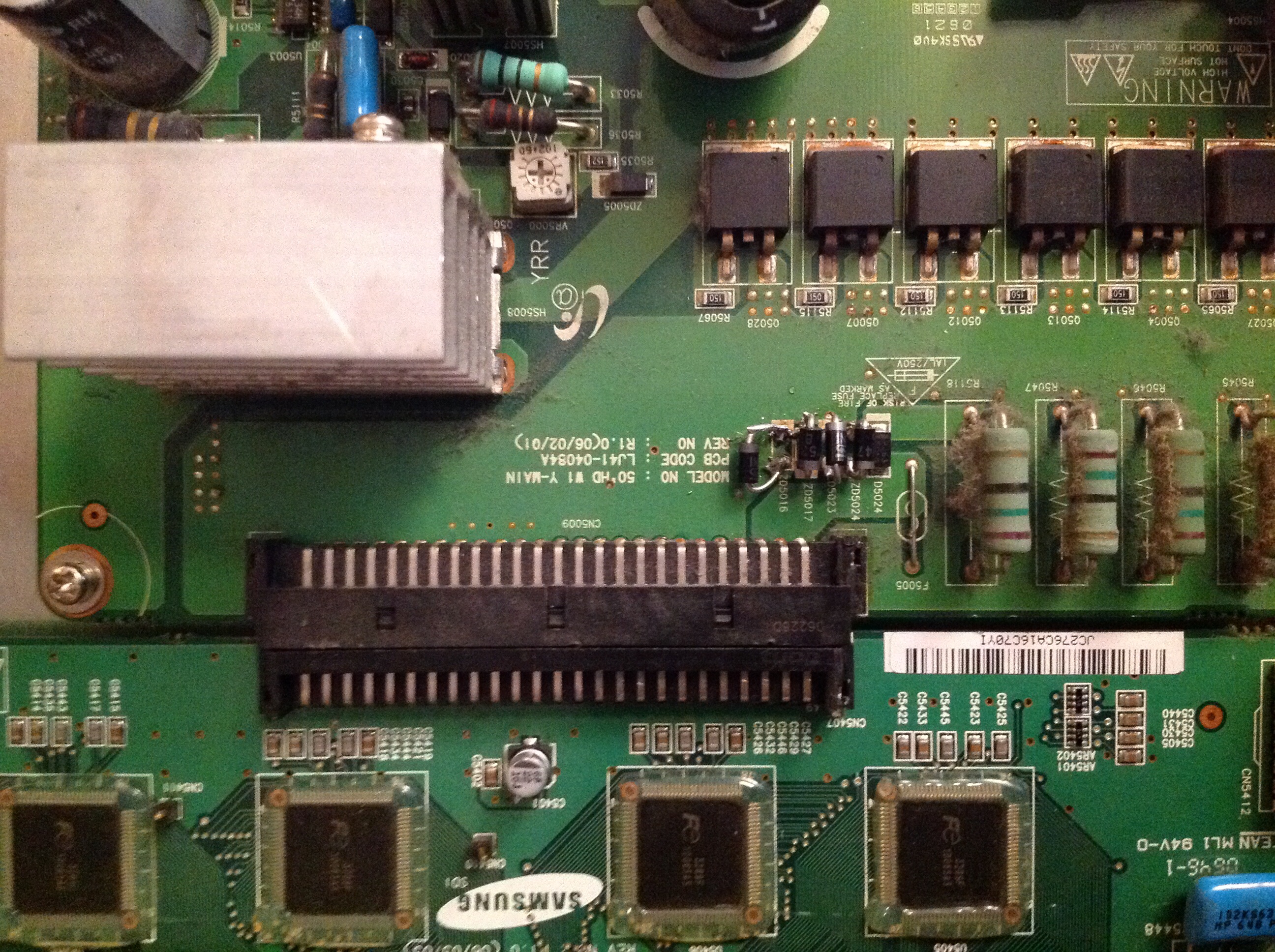

                          Top buffer connection, also shows Zener diodes I replaced
                              Not sure of the test points
                                OK on this connector
                                https://www.badcaps.net/forum/attach...1&d=1404677915
                                Check voltage from top most pin to bottom most pin.

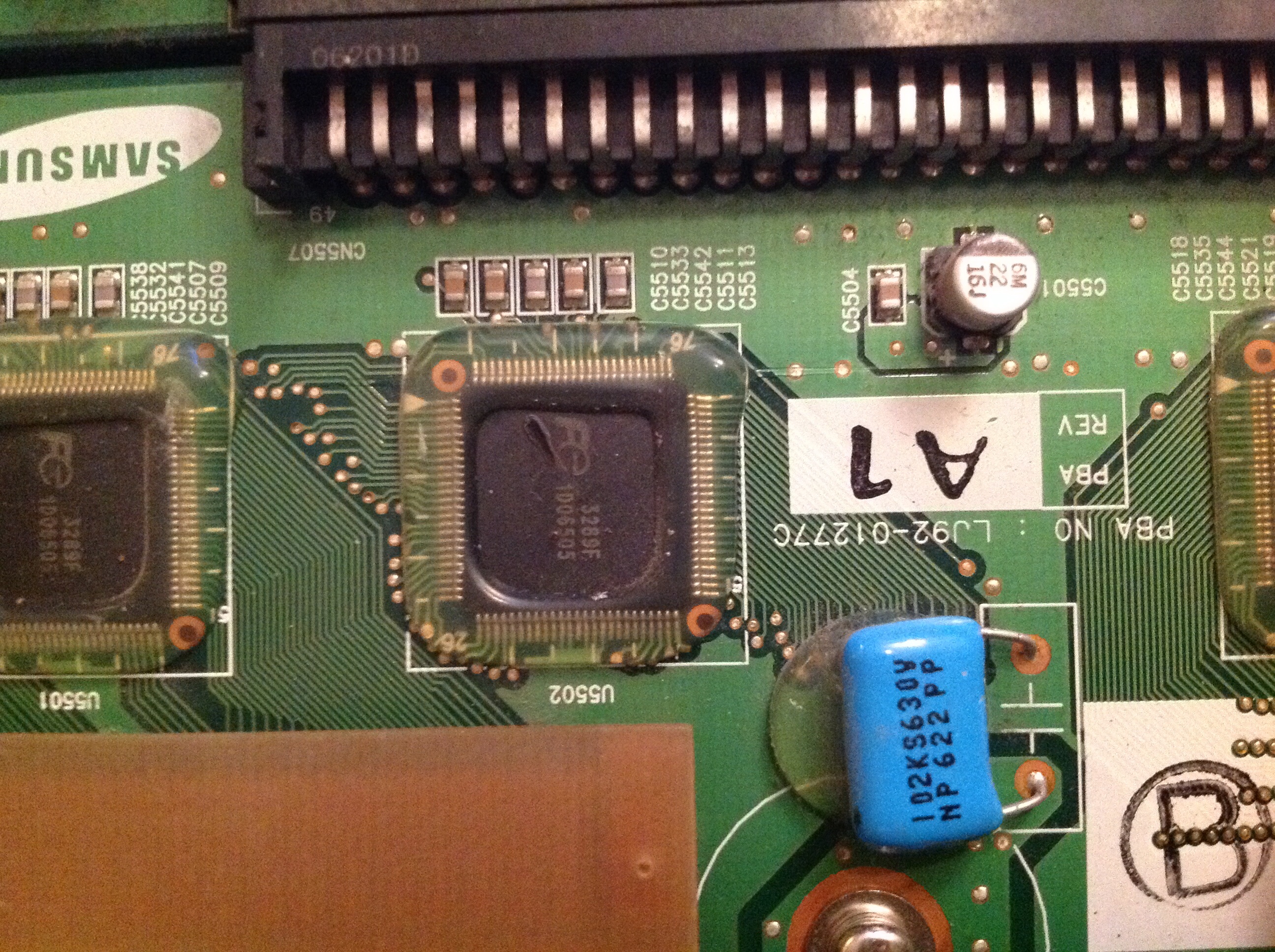

                                      Will swap out the blown chip this weekend, can the y main board be tested without the buffer boards connected?
                                      • Andyegerton
                                        locksmith
                                        • Jan 2014
                                        • 17
                                        • Uk
                                        Anyone know how to get the glue from round the chips on a samsung
