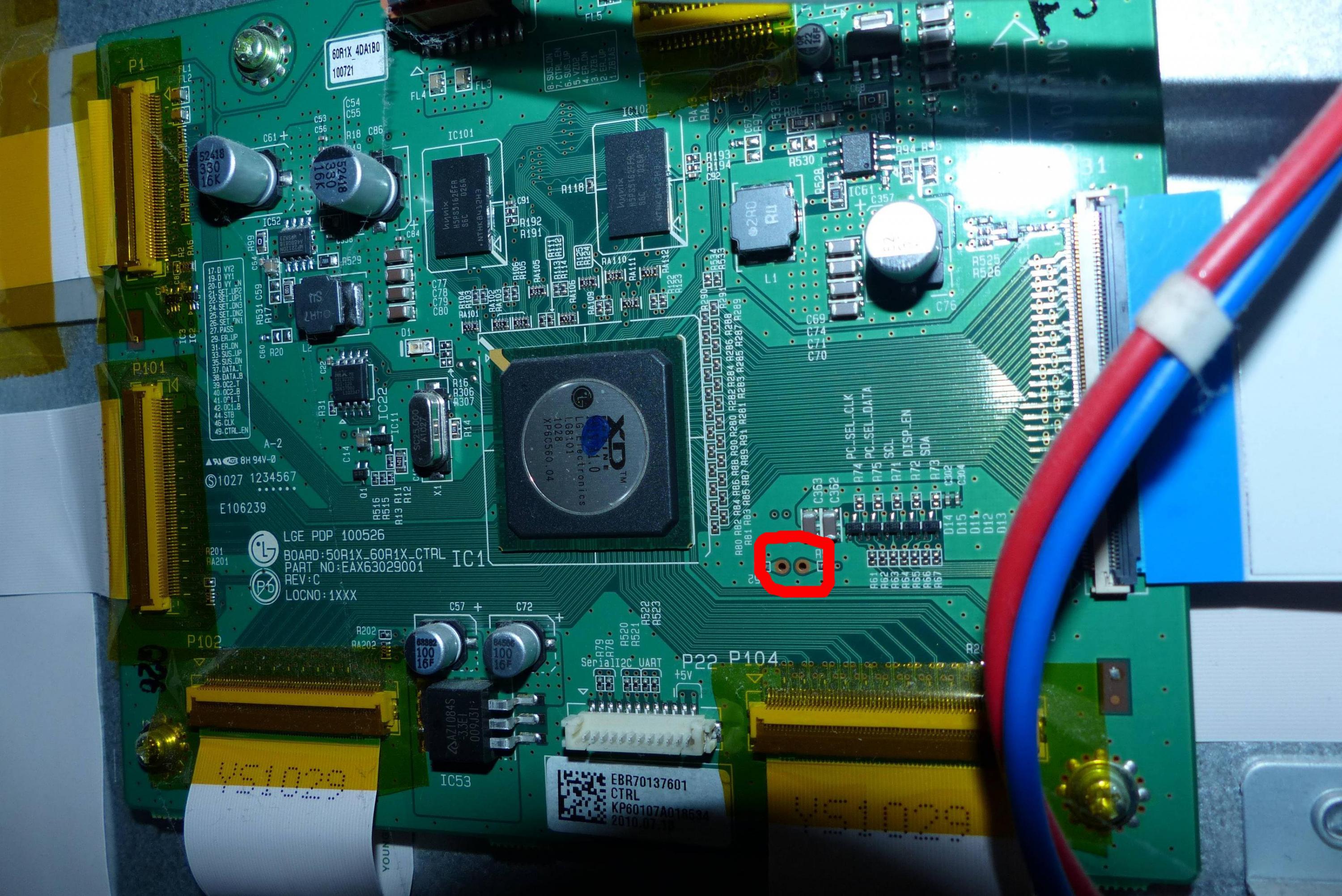

    Can you post a clear picture of the ASIC board (I call it the Control board)? There is one simple test that will check if 3DF/Main Board are faulty.
      Re: Lg 60px950 no picture or sound
      Will this help otherwise I will have to wait until the weekend.
      http://postimg.org/image/yazbbpq0j/
        Yes. Just realised I made this image for a different user so can use that anyway...
        Unplug TV power
        Jumper red holes with wire on the control board
        Unplug the right hand ribbon cable on the control board
        Turn the TV on
        Do you get cycling test patterns?

              I placed the jumper in as instructed. No test patterns. Still the same result of when I turn the TV on the screen flicker on then off and nothing.
