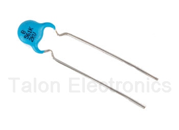

    I need the value for CX3231. It was burnt and shorted. Thanks

    Myabe post the chassis number and a picture of the chassis, it might be easer to locate that way.
    If its a GX chassis and the cap is off the collector of the horz. output it is 560pf at 2kv

      It's an Agua GX chassis and the cap is a little blue one in parrallel with a bigger that comes off the horiz. output.

        Can you see any markings on the old cap, IE: 561
        This should be the right value
