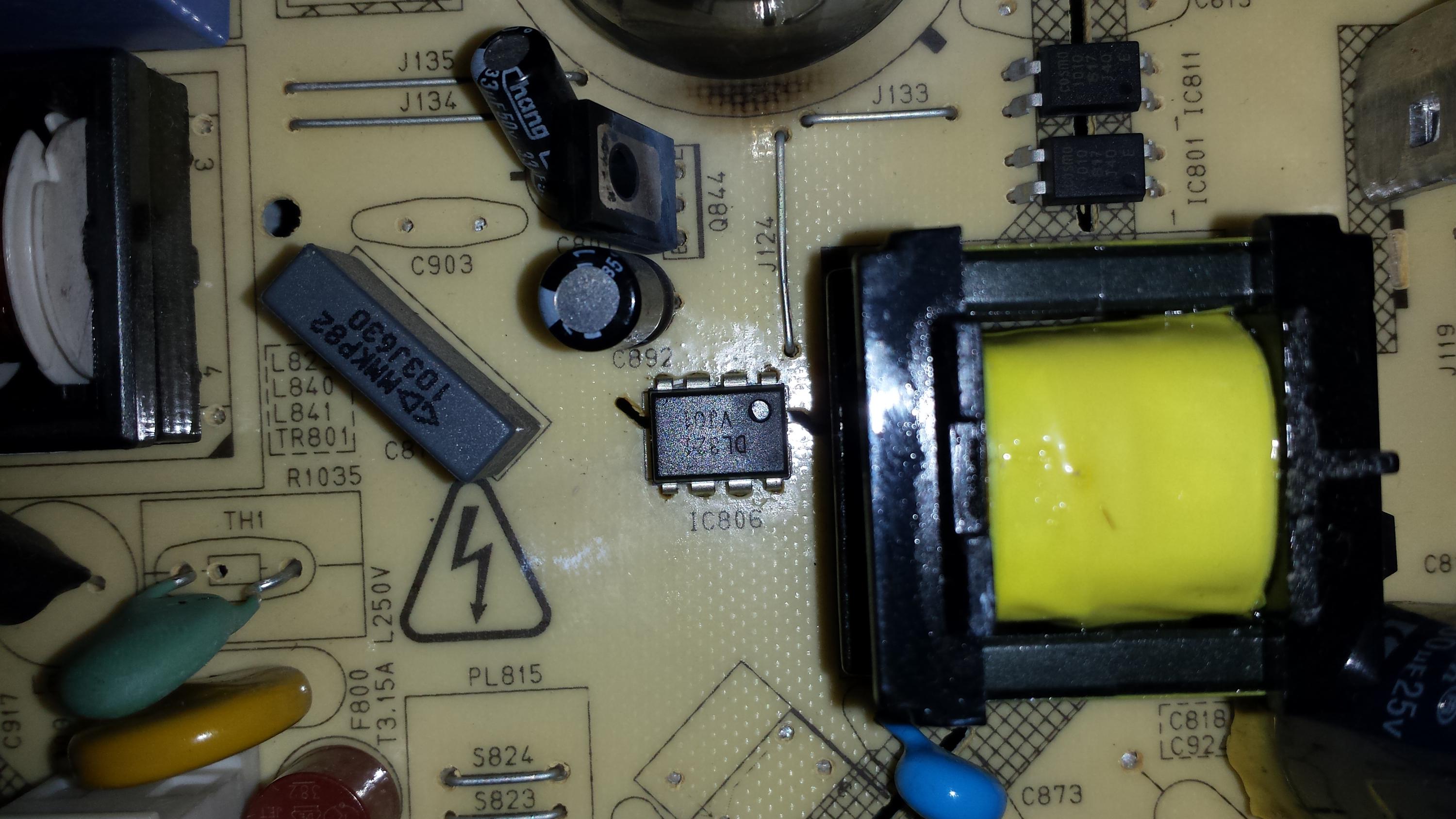

    hi guys ive got a neon lc32 with a vestal 17pw26_4 v1 board in it .
    the problem i have is the boards dead no life in it at all
    there was 2 caps bulging so removed them and replaced with no but didnt solve issue
    in 1st image ic806 was blown on 1 of the pins i removed it and replaced that aswell ...as u can see the big cap above has black soot on it wich i think is from ic806 blowing ,but took a closer look and the transister q844 looks burnt aswel
    could that be the problem of the board being dead
    cheers guys

    Check Q814,Q815 for shorts too.

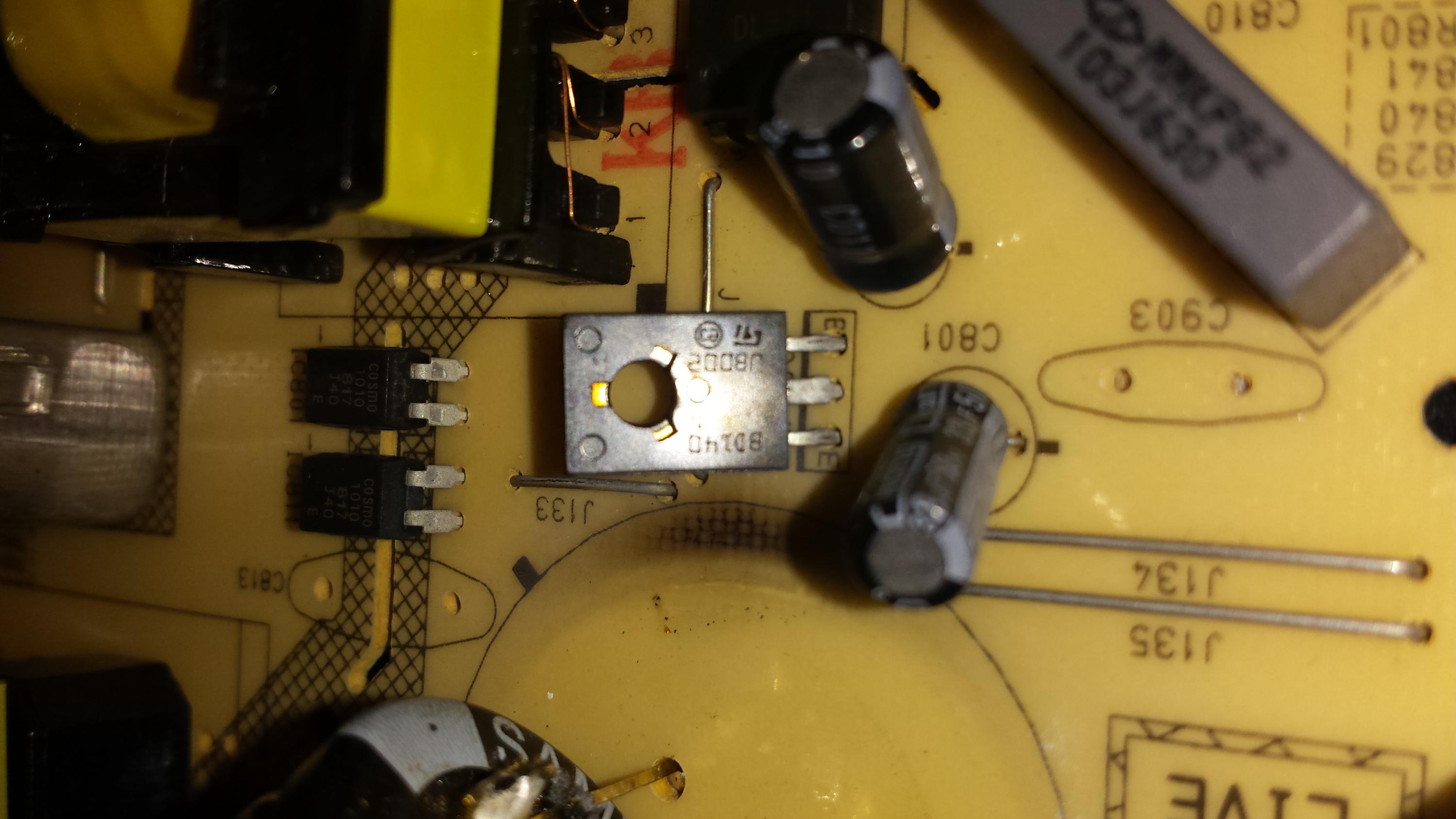

              did u mean q813 and q814 as cant fine q815
                Re: neon lc32 vestal 17pw26_4 v1
                Yeah sorry.... The two ones on heatsink next to each other.

                  just tested on my dmm and both showed a reading of 010 dont now if thats right or not
                    That is probably shorted; remove them to confirm the diagnosis.
