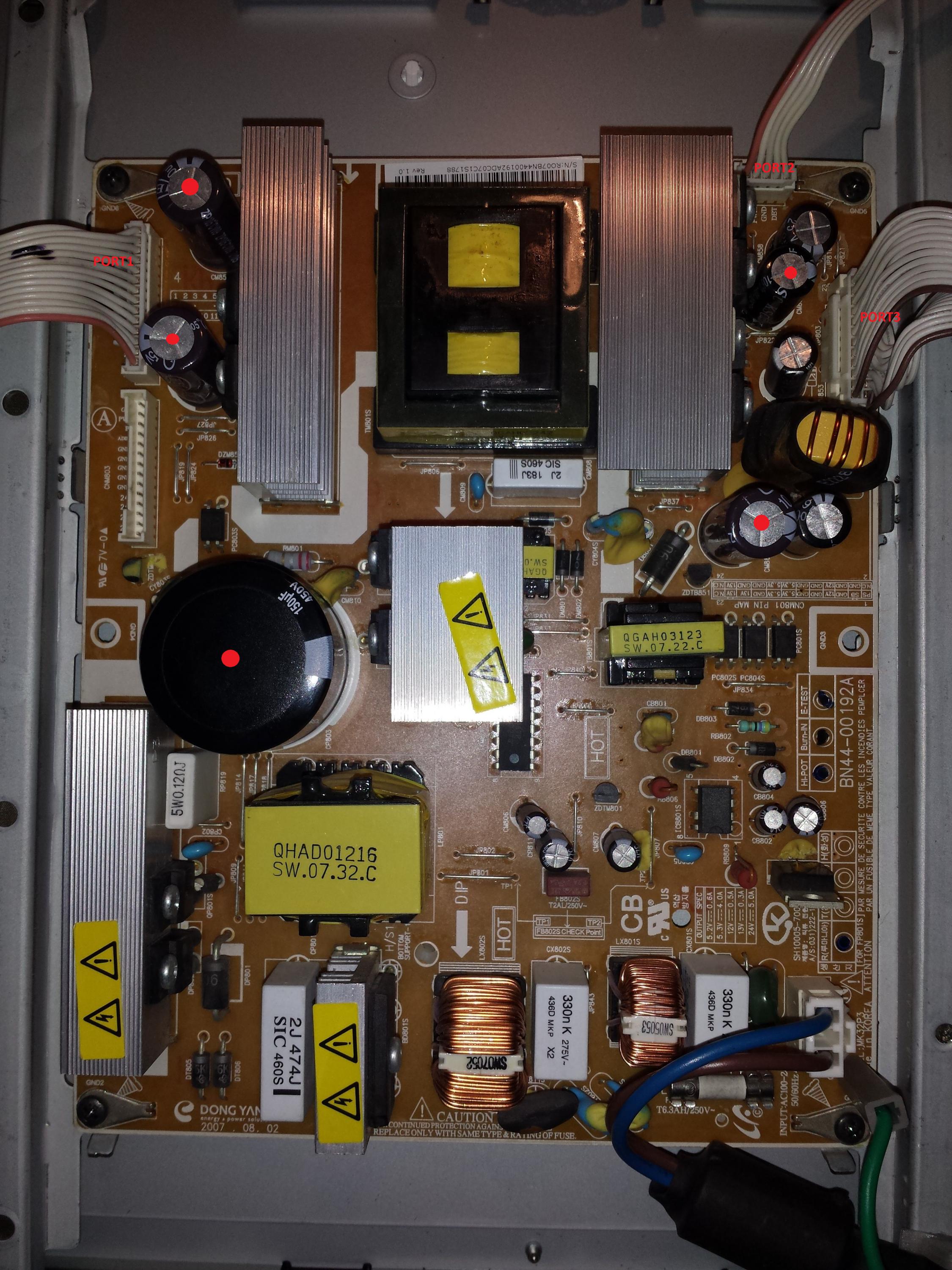

    I'm having problems with my TV (Samsung LE26R88BD). Currently it will not turn on at all, previously on some occasions it would not turn on. Usually to get it fix I had to disconnect it from power outlet for few days.
    When the TV is not turning on (in standby mode) the red "infrared indicator" led is on and as soon as I press any button on the remote it goes off, but at the same time it blinks when I press any other button on the remote so it acts like the TV would be turned on. In this state TV will not respond to the buttons on the front panel, like for example power button.
    I've replaced few capacitors already (marked red on the attached picture) and measured voltages on the PSU board, noticed that voltages are fluctuating on most of the pins:

    I have only a standard multimeter at home, but please let me know what else can I check to pinpoint the issue.

      unplug mainboard,recheck voltage on psu,is the 5volt still fluctuating?

        First thing to do remove all those glue and then inspect all the component legs to see if they are damaged by the glue.
