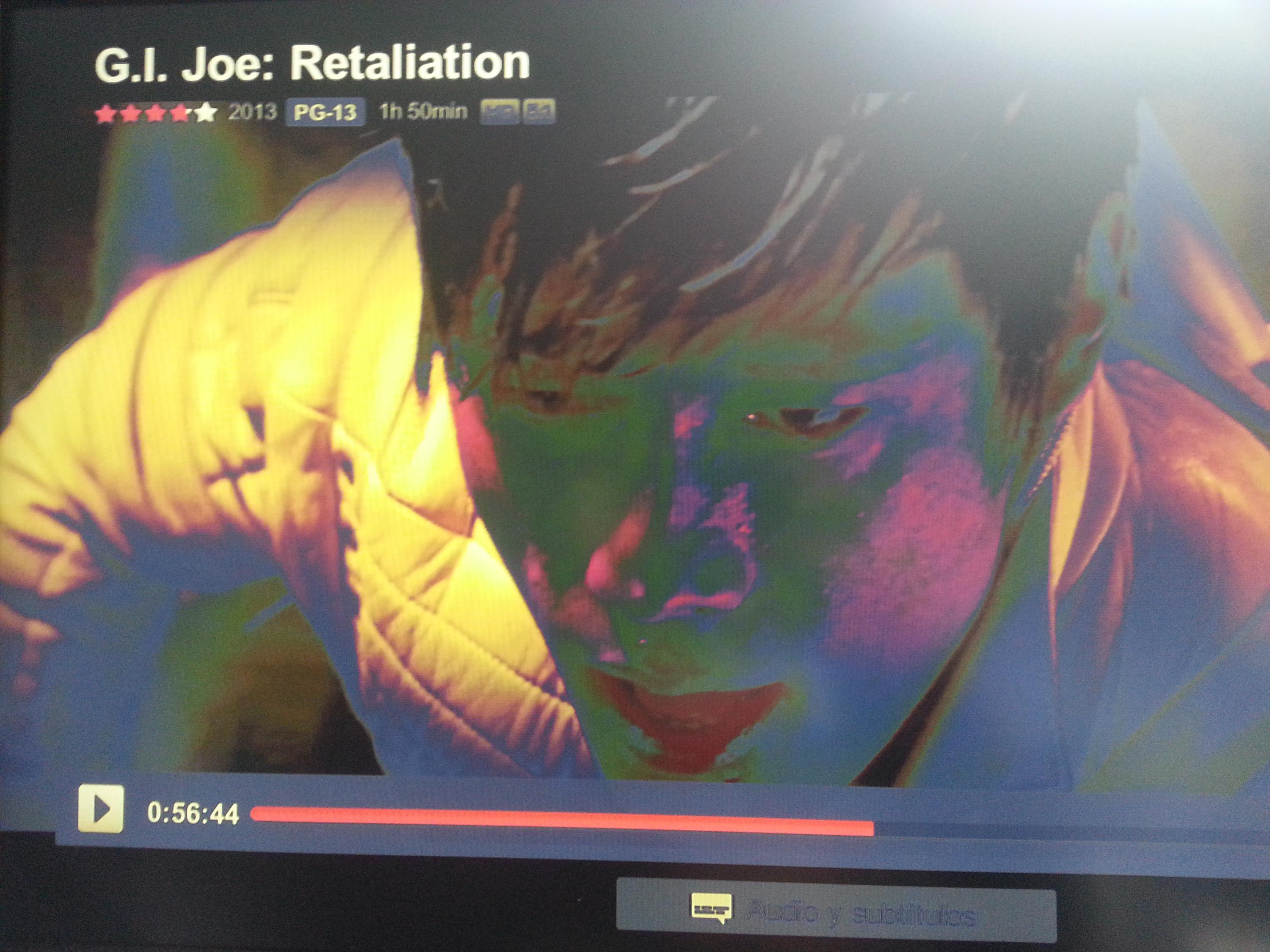

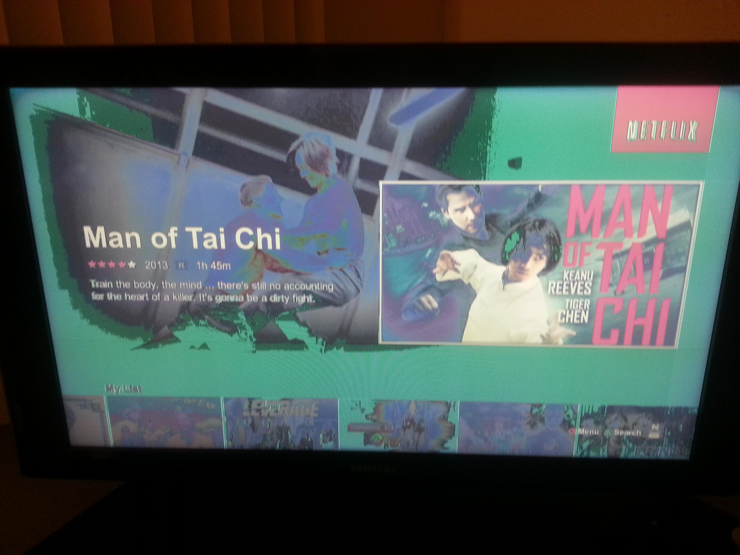

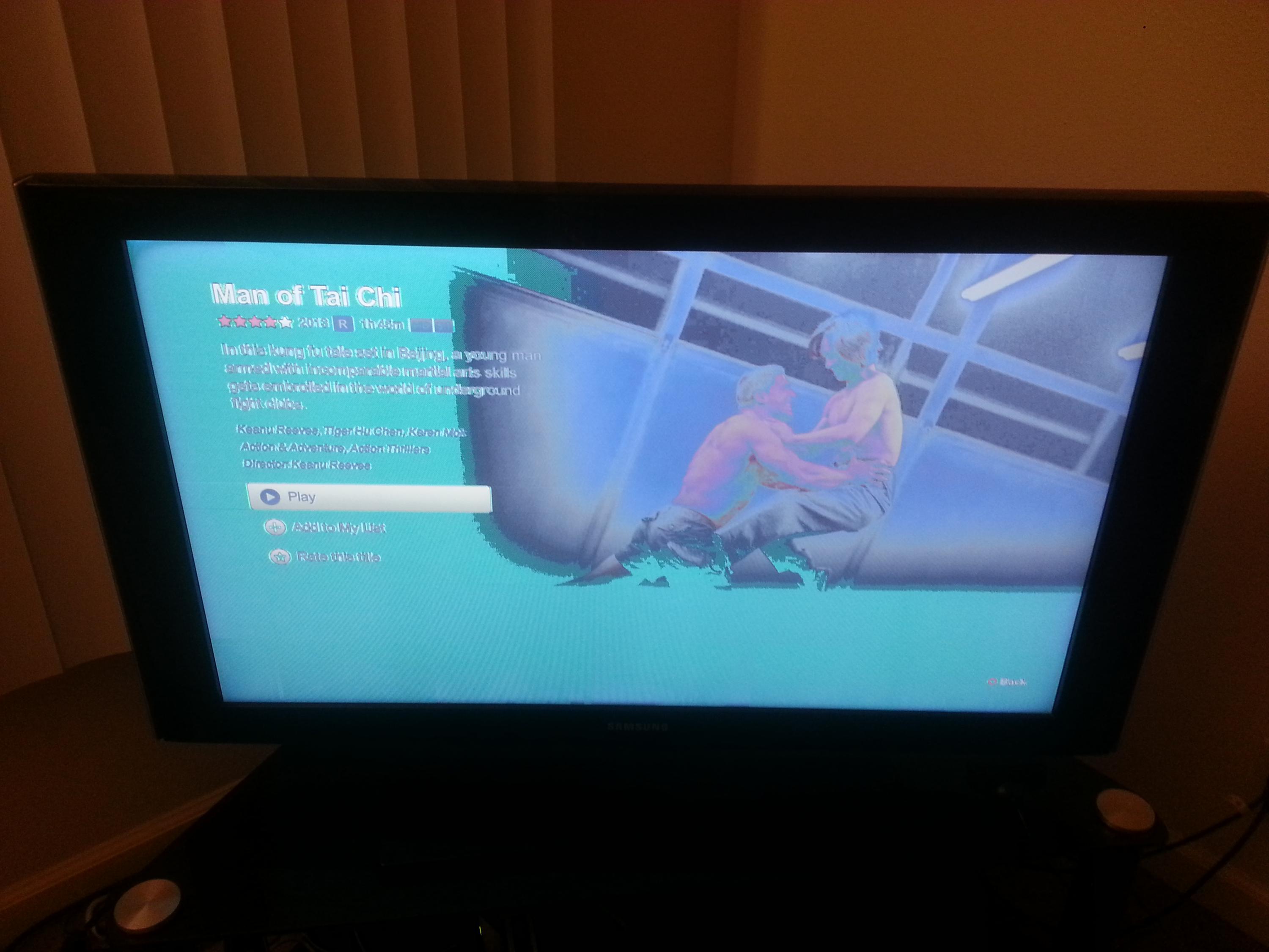

    I am trying to troubleshoot a Samsung LN40A530P1FXZA that displays bad coloring. I attached a couple of photos taken with a phone. I am wondering if this is due to a bad TCON, Mainboard or LCD screen. By the way this is a great board, some of the threads, especially the best dumpster finds, are hilarious. Thanks!
    Re: Samsung LN40A530P
    I just fixed one like this, 37" Sony but I'll bet it's the same fault, gamma IC failure. Post a picture of your T-con. You will need some decent soldering skills to replace the IC or you can replace the T-con outright or get it repaired by a repair service company.
      if this is the T-CON board used in his TV, then it is proably another failed AS15 GAMMA IC.

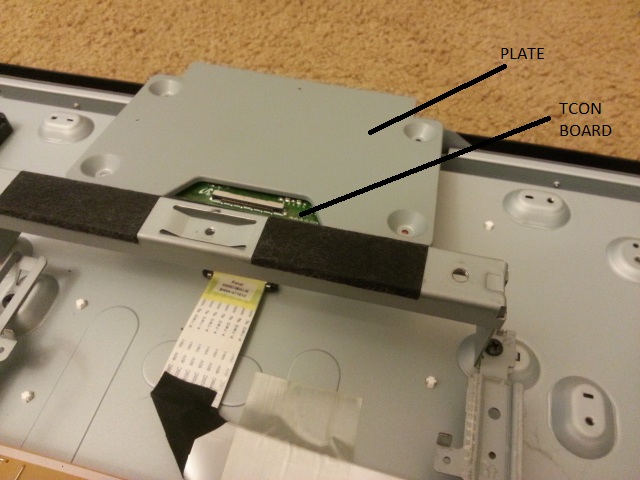

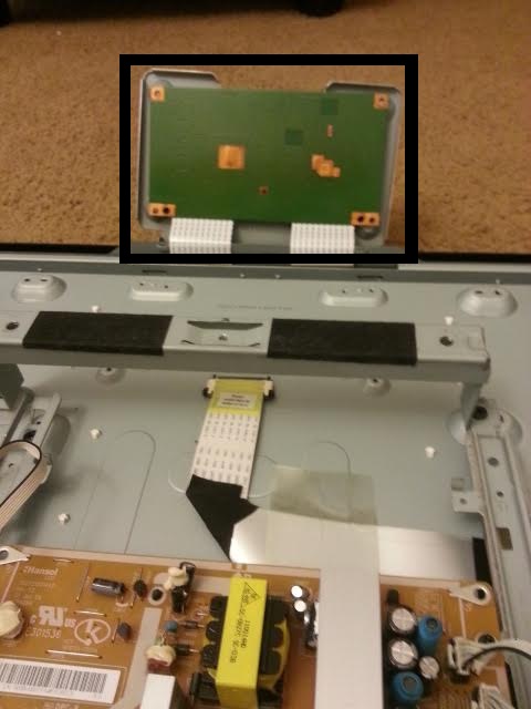

          I wanted to take a picture of the TCON board but the plate on top appears stuck to the board! Here's a couple of photos.
          Solder or whatever else they use on the board, must somehow melted and glued the board to the plate. What do you think?
            There are thermal pads under there which use a light glue. Remove the board from the TV and apply firm, but gentle pressure to the edges of the board to separate it from the thermal pads.

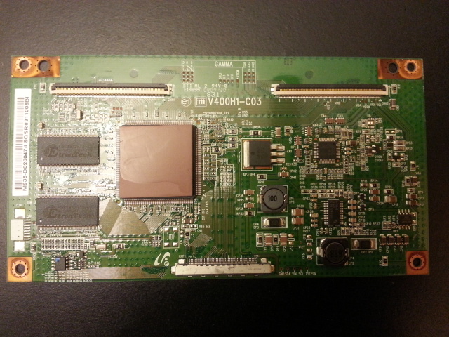

              Here's a snap of the TCON board.
                Top of the board - See the box marked GAMMA...

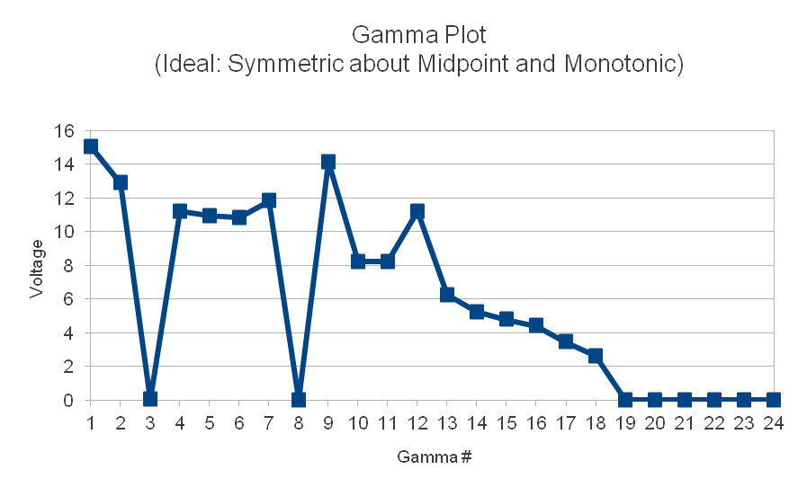

                You need to install the board in the TV and connect it up. Screw the board down, but leave the metal shield off for now. Power up the TV so yuou can see the fault on the screen. Use a digital multimeter to check each GAMMA voltage. Report each voltage for each gamma number.
                Use the red probe on the test point, place the black probe on the TV's chassis, and use the DC 20V scale (if your meter autoranges just use DC volts; most cheaper multimeters do not autorange.)
                  I did not have a multimeter handy and had to get one from work. I got the following V readings:
                  1 15.04
                  2 12.87
                  3 0.02
                  4 11.21
                  5 10.92
                  6 10.84
                  7 11.82
                  8 0
                  9 14.14
                  10 8.22
                  11 11.19
                  12 6.25
                  13 5.22
                  14 4.78
                  15 4.39
                  16 3.45
                  17 2.61
                  DRL1 3.28
                  DE1 0.78
                  STV 0
                  CKV 1.82
                  VSCW 6.80
                  v11 of your spreadsheet gives the attached gamma plot.
                    Yep, that is a bad gamma IC. You posted within about 5 minutes of the other guy who also had a bad gamma IC. Replace the IC marked AS15, or replace the T-con board.

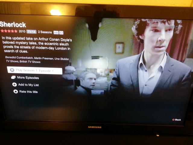

                            I replaced the old TCON board with a new one I got off of ebay. Attached is photo with the new board. The picture quality has definitely improved. The TV is almost OK on a high brightness(80/100), lower contrast(75/100) setting.
                              Repeat the gamma voltage test. If the voltages are still bad you received a bad board (which seems very common as sellers don't test their boards. These boards have about a 10,000 hour lifespan.)

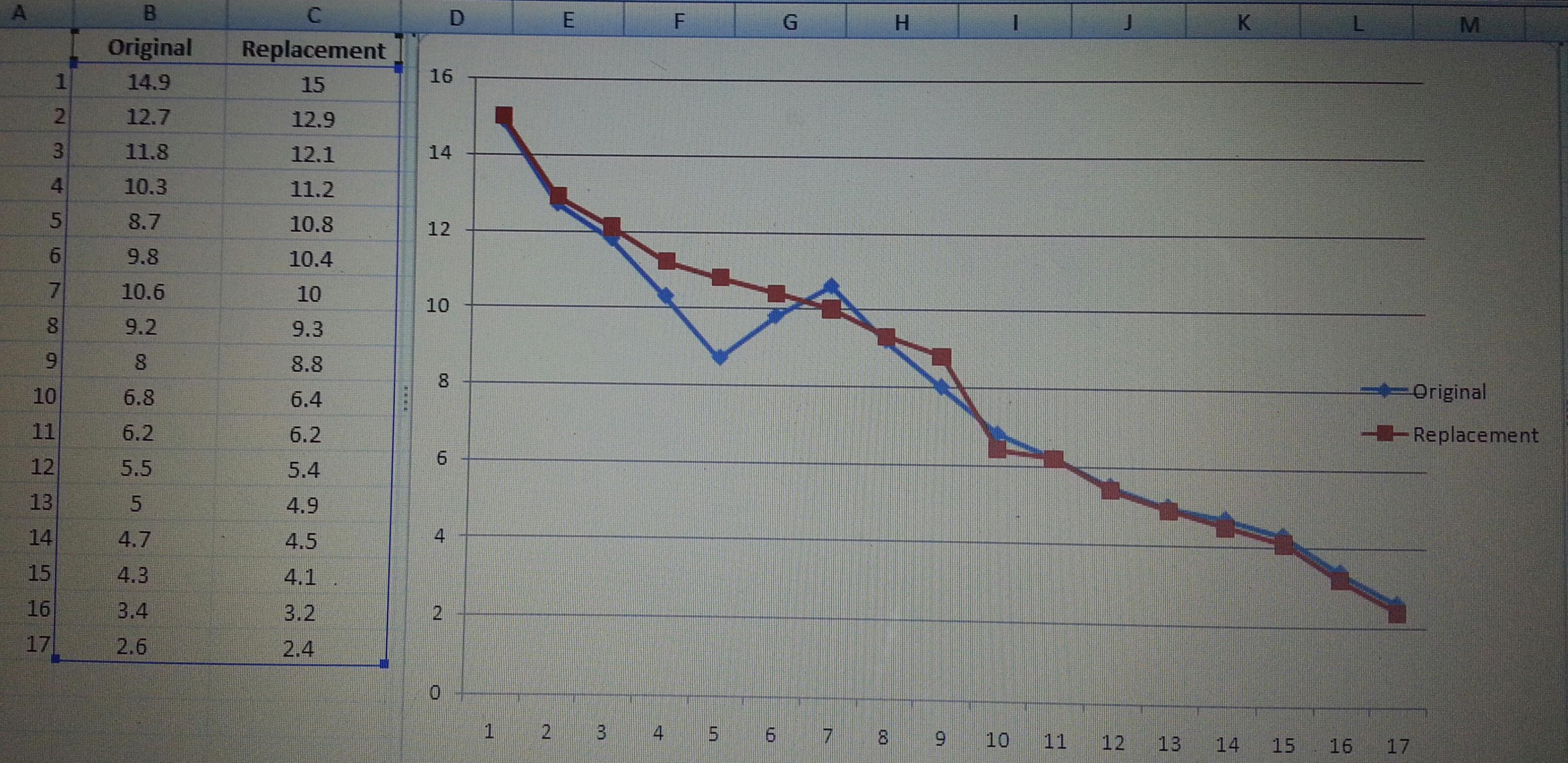

                                The readings with the new TCON are monotonically decreasing:

                                Here's the gamma check excel with the values entered.
                                  They are still bad. Volt 1 should start at 15V and Volt 2 should be closer to Volt 1 than it is. Also, the curve is not symmetric. The spreadsheet can't detect all faults.

                                    I'm really shocked that we both have the same problem and same tcon board(v400H1-C03). I also buy a replacement on the internet with exactly the same results (the tv improve the image but not totally).I did the test and these are the results
                                    oem replacement
                                    1 14.9 15
                                    2 12.7 12.9
                                    3 11.8 12.1
                                    4 10.3 11.2
                                    5 8.7 10.8
                                    6 9.8 10.4
                                    7 10.6 10
                                    8 9.2 9.3
                                    9 8 8.8
                                    10 6.8 6.4
                                    11 6.2 6.2
                                    12 5.5 5.4
                                    13 5 4.9
                                    14 4.7 4.5
                                    15 4.3 4.1
                                    16 3.4 3.2
                                    17 2.6 2.4
                                    The new replacement seems to be bad, I already ordered a new tcon from other source, I let you knows if this resolve the issue.
