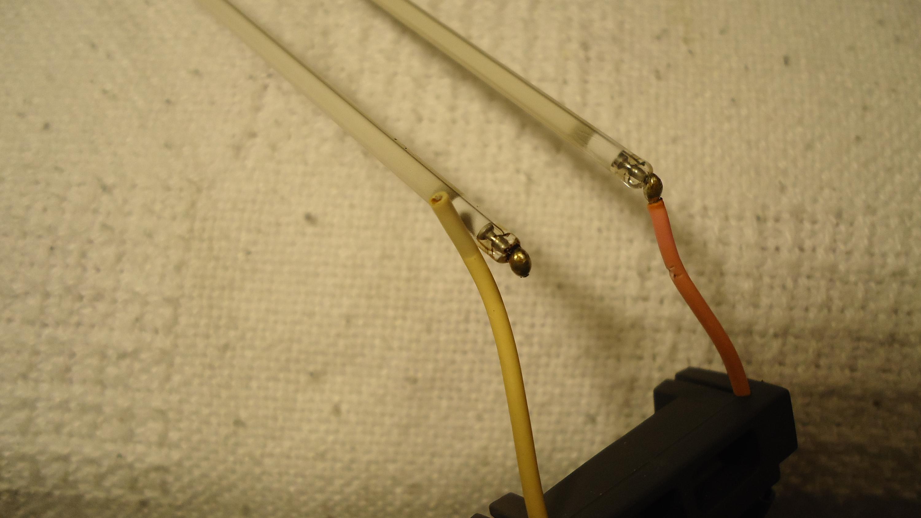

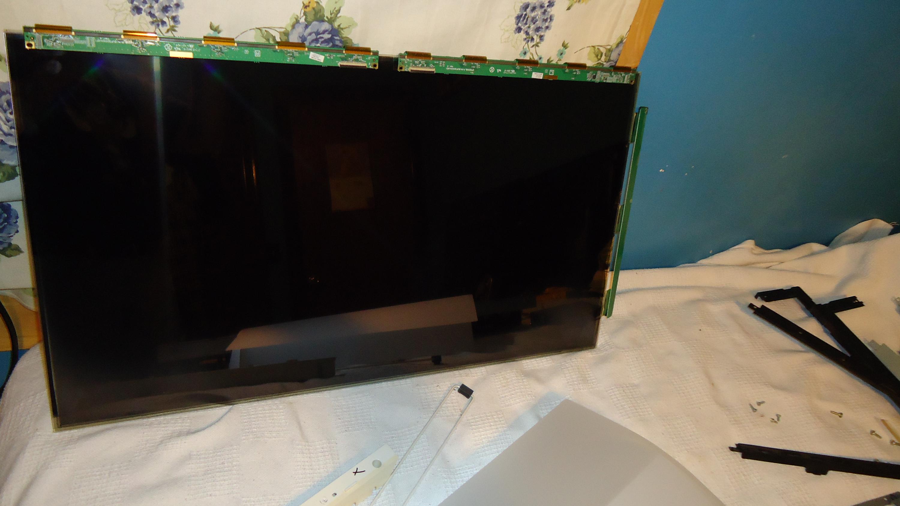

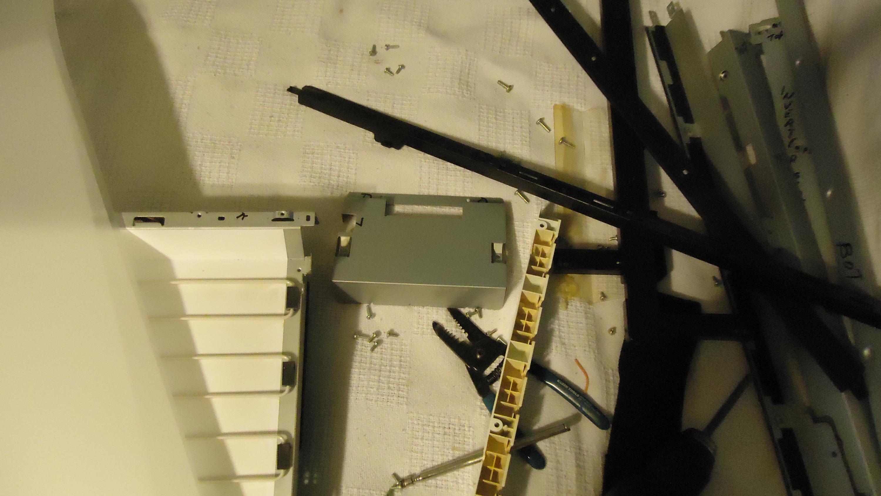

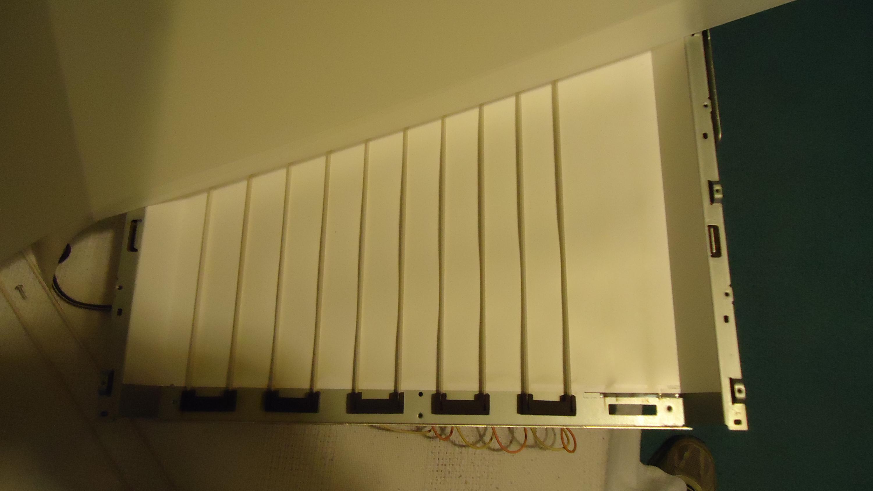

    After reading up on these cheap sets I thought it was time to take one apart and find the real problem. The 2 seconds to black problem.

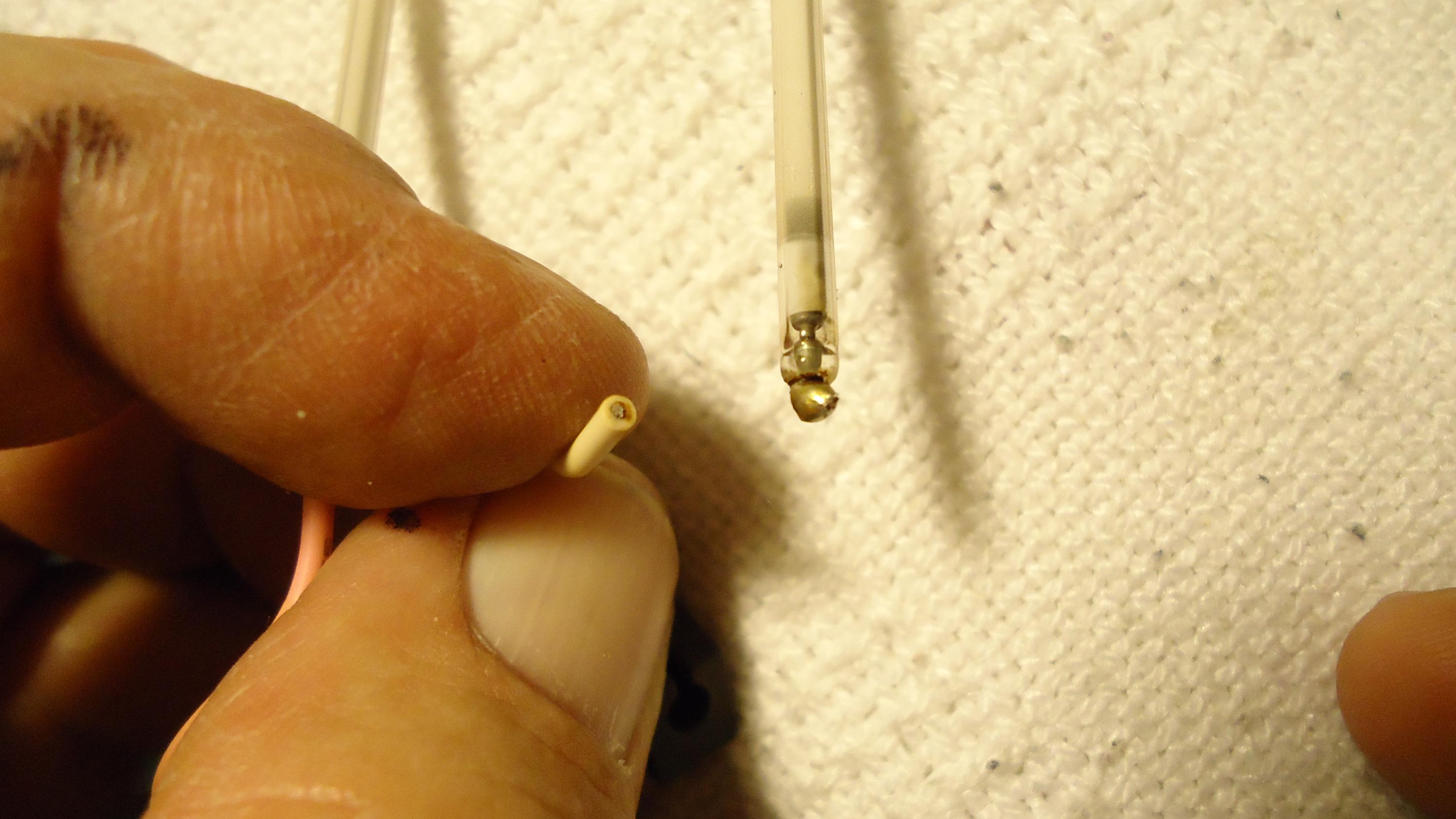

    The solder on the lamp was broken soldered it together and tv works good. I will never buy another one like this .

      The tubes are u shape and will snap very easy.

        nice post and pics showing the fix. i have the 37" model and the 2 wires going to the ccfl's were touching and burnt together causing a short. all around it is just a crappy setup i guess you get what you pay for...mine was free and an easy fix so i wasn't out anything.
