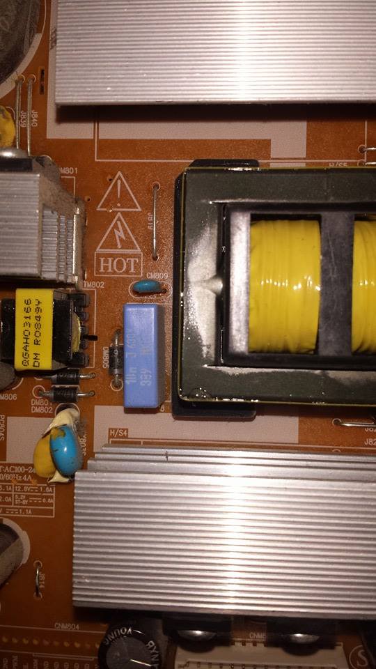

                    Re: Samsung le32a457
                    Replace CM808 the 18nF 630V capacitor. It has caused issues like this before.
                          Looks like CPC do NOT stock the req'd part which is annoying.
                          Please confirm value of CM808 in your board?

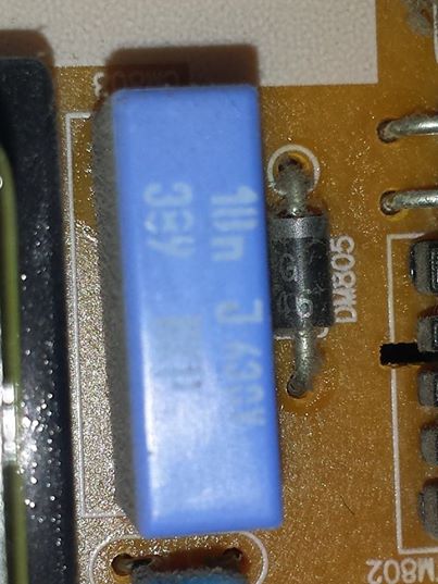

                            i cant find a CM808 only CM809
                              Should be a small box capacitor about 1" long near the yellow transformer.
                              • sordids999
                                • May 2013
                                • 2161
                                • uk
                                Found it sorry it has 10n J 630v 389 MKP
                                  Are you sure that is not a dodgy 18n print? Hard to tell....
                                        22nF is a lot easier to get hold of; if you want, you can try that first. Make sure it works on all modes and all brightnesses. 18nF could be penny pinching by Samsung or maybe it's important for matching the transformer, I do not know. The schematic says 18nF.
