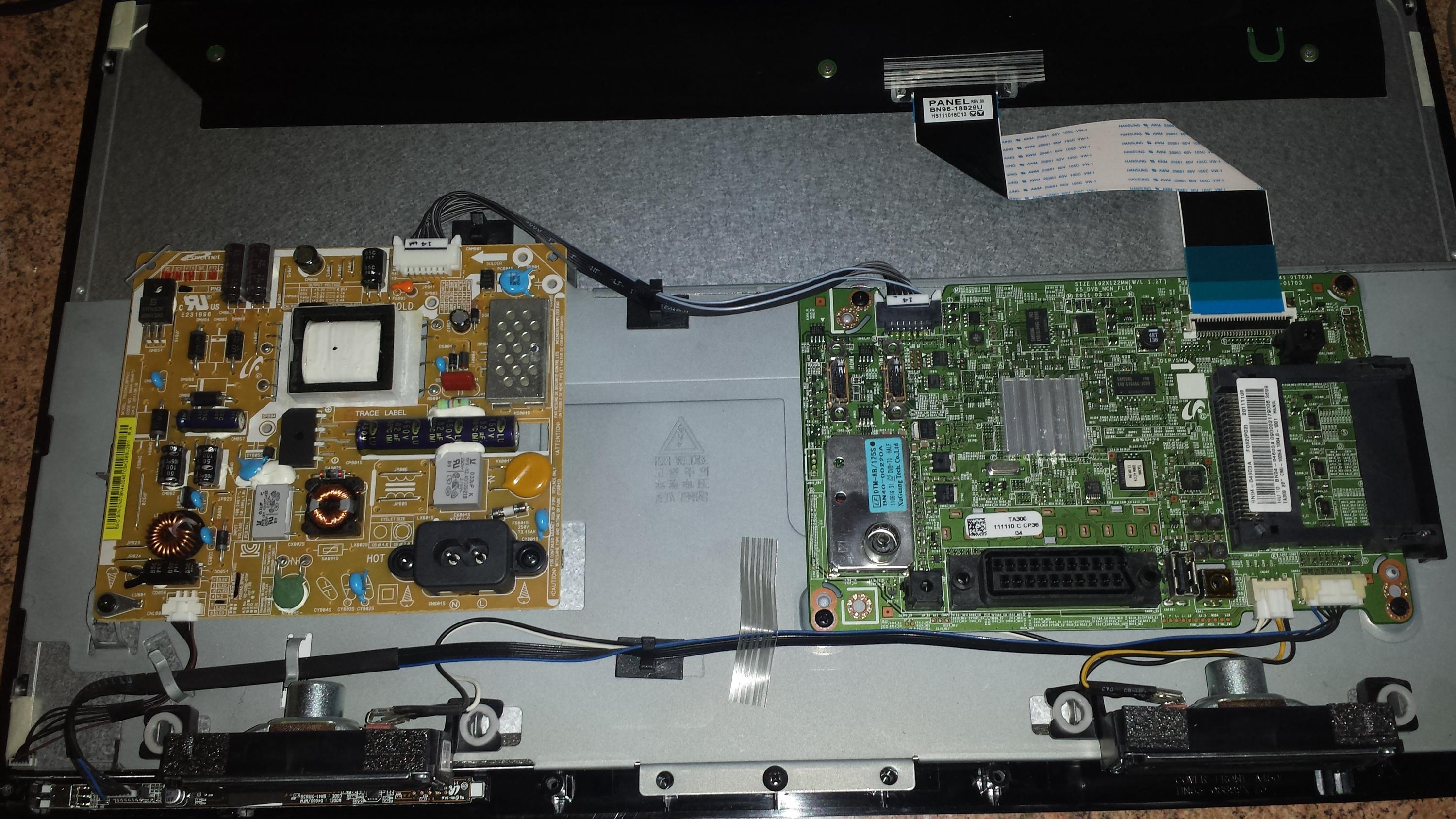

Samsung lt22a300
  • sordids999
    • May 2013
    • 2161
    • uk
    Samsung lt22a300
    Totally dead can't even measure voltages fluctuating all over the place
    Any ideas
    Re: Samsung lt22a300
    Check for shorted diodes. I have one of these here, but no LED power cable or LVDS cable... good power board, screen and main board I believe.
    • sordids999
      • May 2013
      • 2161
      • uk

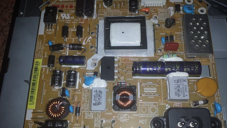

      Found one shorted number SR315A SHS OFI
        I would try replacing that then. If you ever get a smashed one of these let me know if you have the ribbons/cables left over.
        • sordids999
          • May 2013
          • 2161
          • uk
          Looking as we speak
            Actually just dug my power board out... same diode is bad.. hmm!
            I guess it's a common failure. Never checked the board properly, got the TV for about £10 off a friend of a friend whose "tech" had looked at it.

              what diode is it m8 looked on cpc but....
                3A 150V schottky,
                https://cdn.badcaps-static.com/pdfs/...ec4595154b.pdf
                CPC don't stock it (or a suitable replacement), closest is UF5402 but it will run hotter. Hard part to sub for. Might have to borrow a diode from another board.
                    Alternative, it's a bit of a bodge, but you could solder two readily found 100V diodes together, e.g.
                    http://cpc.farnell.com/vishay-genera...20This%20Range
                    Keep leads long for best heatsinking.
                        all done and working again just need to monitor now
                          seems I have the same problem with my lt22a300 samsung.
                          I couldnt find a SR315A and tried you suggestion, but instead I used a IN5408 diode. Although the TV switched ON again, the diode didn't last long. I think the trick is the switch timing of the schottky, that is much faster than teh normal diode. I have to find a SR315 schottky to repeat the test. I'm pretty sure the SR315 is the problem.
                              Thank for the adequate response.
                              Today I gave it a really Q&D try... . I happened to have a STPS30150CW dual schottky (TO-247). (I know 15Amps per diode is really overdone). For the test I only used one diode and had to do some changes on the PCB, but this solved the problem! IMHO it really needs to be a schottky in this SMPS, as is has to have a high switching capability. Still need to order the SR315.
                                  CM855 1200uF 10V can cause no picture flashing standby led
                                    I confirm, I've just replaced it with a 1500uF 16V capacitor (JB JRG) and tv went back to normal (used to have no power to the screen at all + standby led working normally)
