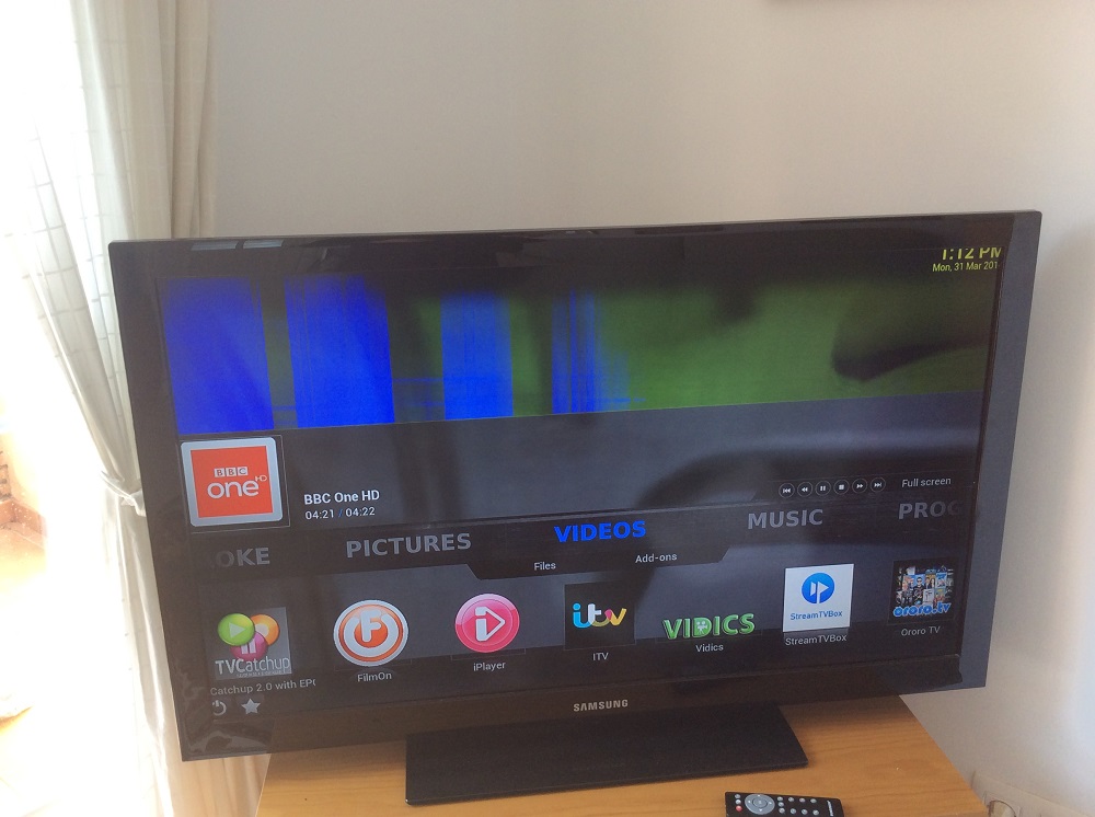

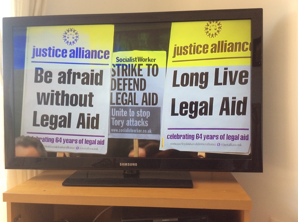

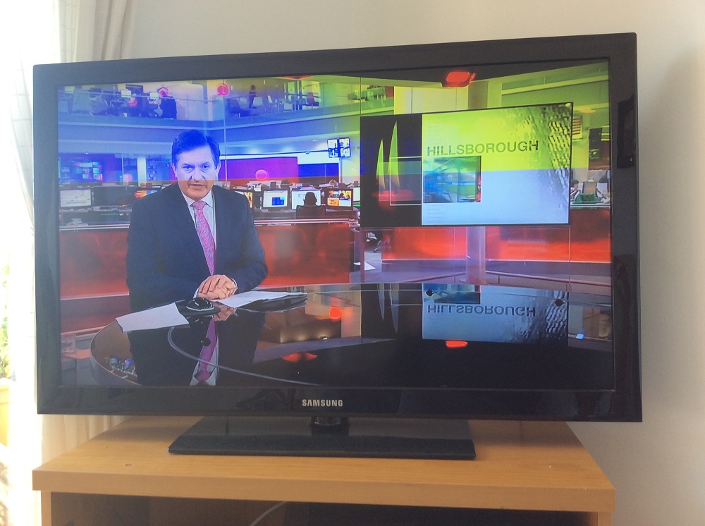

    Hi.
    Really hoping someone can help or at least point me in the right direction. This is a 40" Samsung LCD LE40D503, just over 2 years old and out of guarantee. This translucent horizontal band has appeared on the top third of the screen, it seems to change color depending on the background picture, the band is made up from vertical lines.
    I haven't removed the back as yet and was just wondering if by looking at the attached pictures it could possibly be repaired or be a write off (hope not )
    Twisting the screen or pressing the surround does not make a difference. Could it possibly be T-CON
    Any help and advice will be most welcome.

    I think that's ANOTHER bad LCD panel. Sigh.

      Re: Samsung LCD LE40D503 Horizontal Bar
      Hi Tom66
      Thanks a lot for your quick reply, so I guess its a write off then? Is there anything I can try just in case it may be something else? Or is it hey ho hey ho, its off to the tip we go!
      Thanks again
        You can try a tab shim. Here is a different fault but the root cause may be similar:
        https://www.youtube.com/watch?v=purk_SyiT44
        Of course you can try a t-con board but I would be very surprised if it fixed it. But they will probably be cheap for such a new TV (2011.) The D-series Samsungs (32", 40", 46", 55") have terrible panel issues which are popping up recently. It's terrible, you spend a lot on a Samsung and you'd expect reliability, right...? Especially not the most critical part of the TV to go bad? Haha says Samsung, nope!

                    Is the fix in that video fix only for vertical line problems or does it possibly cover the horizontal lines in the original post 1 photos as well?
                    Also, is this only a fix for intermittent problems that flicker when the screen is tapped? My problem looks solid, again as posted in the original photos.
