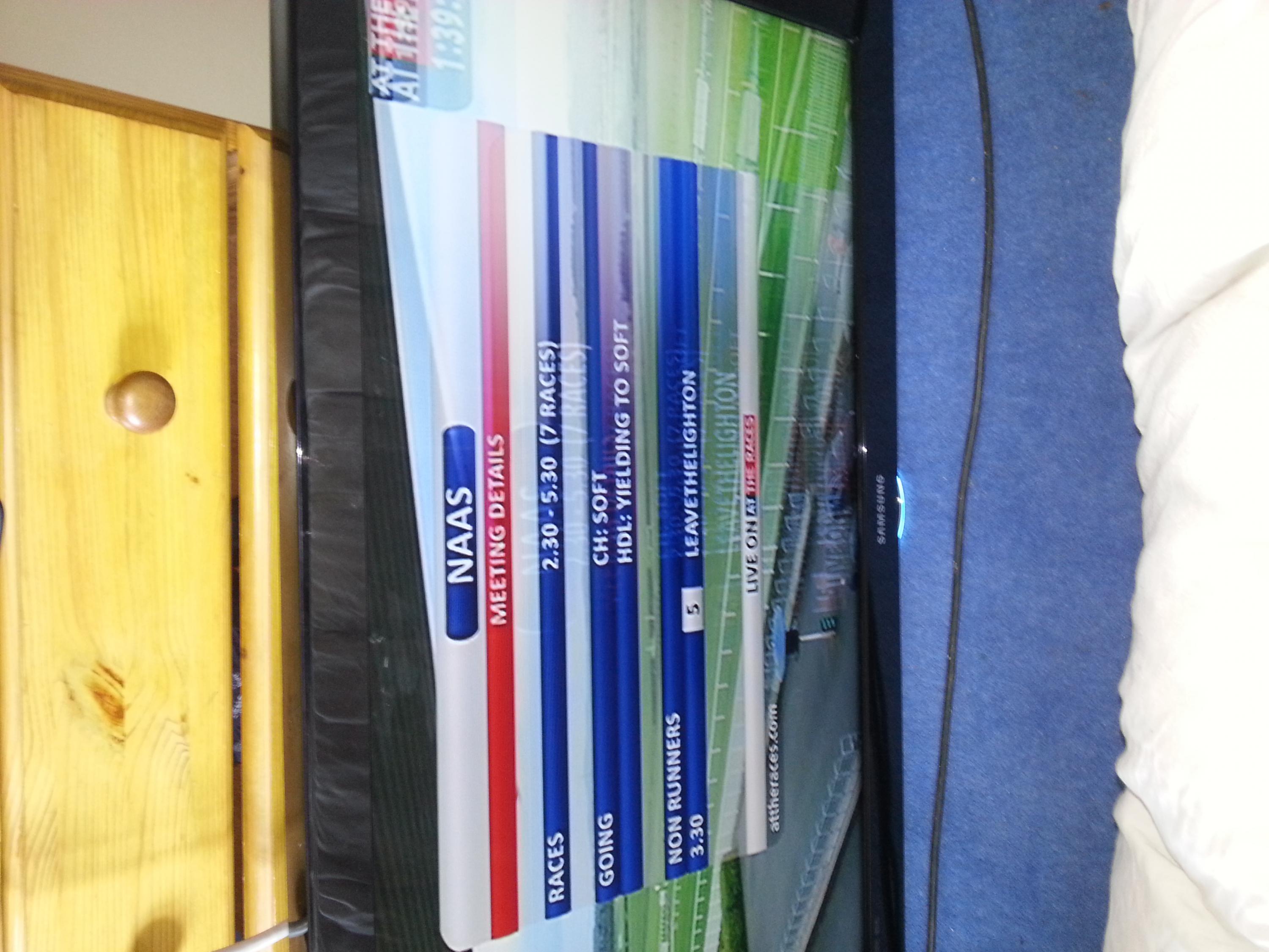

    i been given the above tv with a picture problem on rightside
    as seen in pic hopefully
    after reading alot seems quite a few had same fault
    tcon board mayb? was hoping u guys would have an idea of what to test & where i can get lvds cables to check that 1st
    thnx
    Re: samsung le40f86bd
    Tab bond fault, almost certainly. Sometimes fixable, but in general for these models, the success rate is low (maybe 50%.)

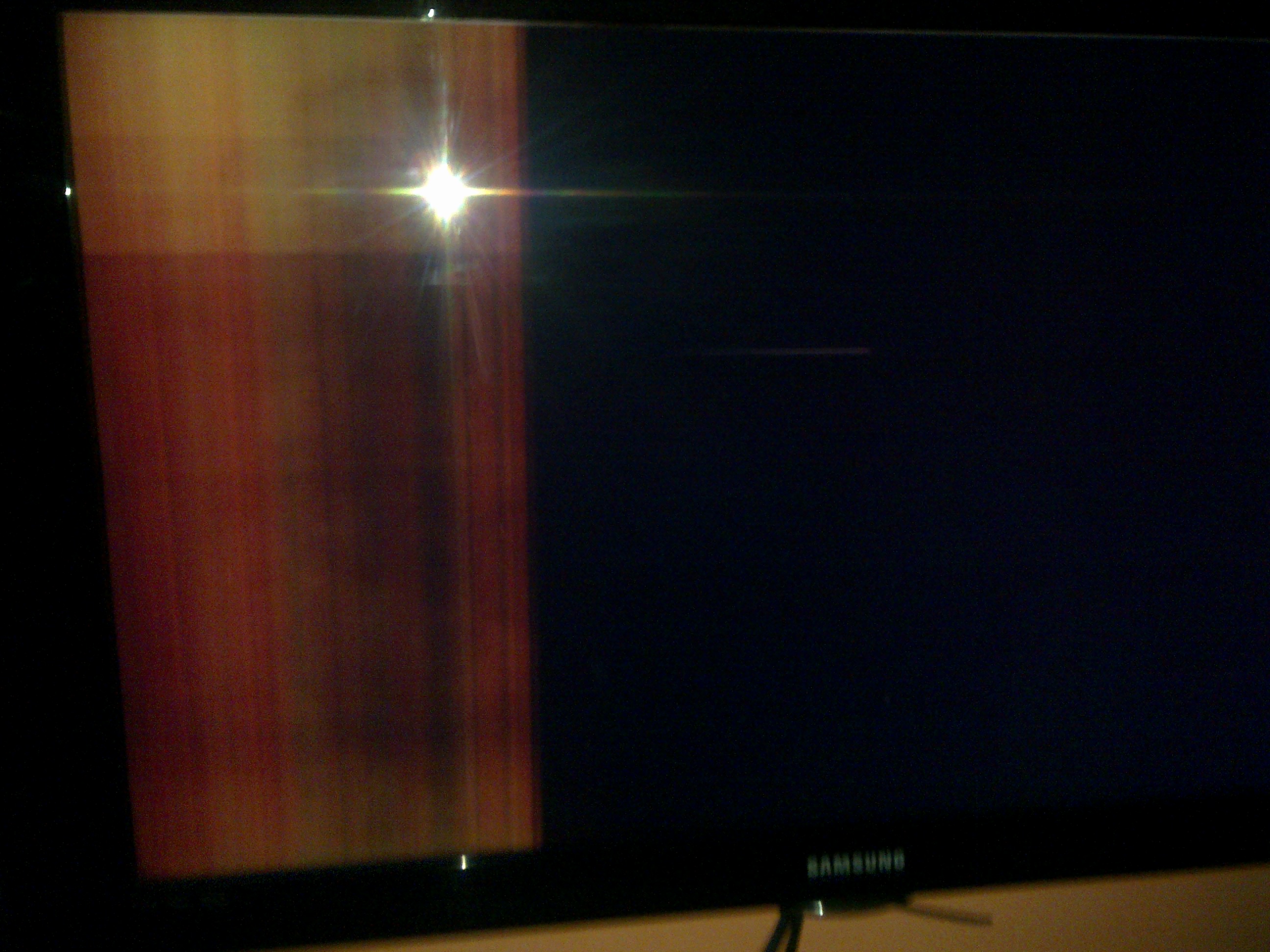

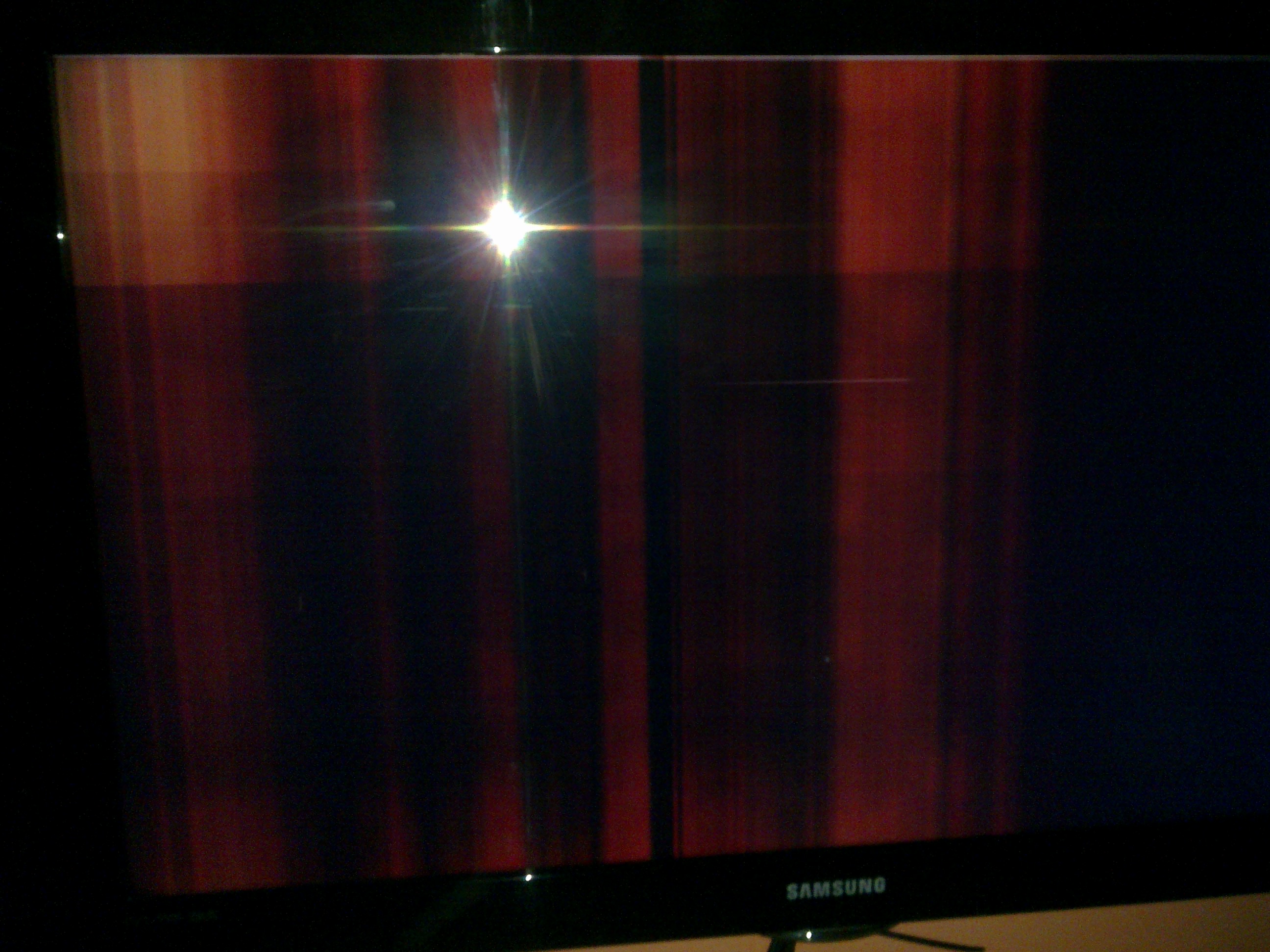

            update....
            screen is working fine well chuffed!!!!!!!!!!
            however if i put tv in standby for 2 hours or more & turn back on get wats shown in pics.... but if i unplug power & back in starts fine
            i have had on for 4 days runnin 24/7 & perfect
            any ideas? thnx
              The tab bond is failing permanently. Nothing can repair it unfortunately. As I said, the success rate with these panels is low.
                  Cooling down and warming up, you'll probably find the trick stops working after a few days/weeks.
                  I have had several sets with tab faults.
                  In my experience you can either fix them permanently (about 50% of the time) or temporarily (the other 50%.) If the fault (or a similar one) comes back, it's probably not going to be a permanent fix. However, if it holds for about a month, like one I had before did, then it's probably going to last for a very long time.
                    ok so if i left on 24/7 how long u reacon last ? & if i unplug when shows like pic how long u think that trick will work?
                    thnx
                      I've heard of them lasting around a month, maybe two if you're lucky, but there's no way to be certain.
