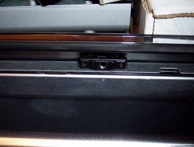

                Yeah, my description probably wasn't the greatest either. Here's a shot of one of the clips. Are these the only thing holding the bezel on? I guess once that's off I'll find the rest of the stuff you're talking about, but like I say, I'll probably tackle it in the morning.

                  Keep in mind I have a D series and can't compare it to yours as I don't have one. But if there are two of these, one per side about halfway up then a little pressure away from the screen and the bezel will pop right off. I also had two screws under the mount which prevented me from removingthe bezel with the stand attached.
                  But I thought you were further along. These are the clips I was referring to - under the frame, which is under the bezel.

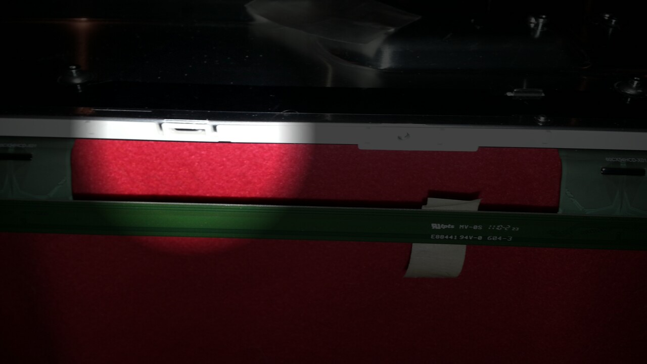

                        There are clips around the edge on mine, but I'm wondering how I need to approach things to safely get to the light strips. It's got those two fragile looking long thin PCBs hanging off the bottom which connect to the T-con board. Do I lay it face down, unsnap all the clips and lift the bulk of it away from the glass/screen part?

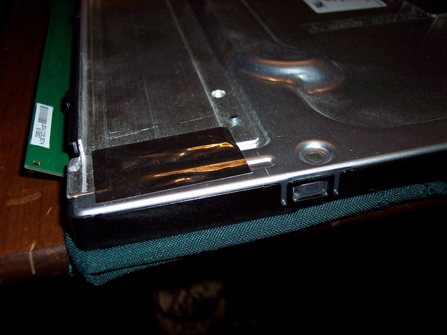

                        <EDIT> freakaftr8's instructions are now making a bit more sense to me, but I can't tell if he's still got the panel face-up at the point I'm at now.
                          #32
                          Re: Dead Samsung 46" LED (model UN46C6300SFXZA)
                          yes you should be face up now. Tape the carriers (the two delicate boards connected to the LCD to the screen after you flip it around).
                            Then of course start removing the 1000 (exaggeration) or so screws from the metal frame surrounding the LCD panel but remove the black bezel first that's clipped in.
                              Actually let me clarify.. Everything needs to be free and clear from the panel as in the panel should be ready to lift out when you tape the carriers to the screen.

                                  Well, I don't know if this is good news or bad for me, but I appear to have two hundred and fifty-six nice healthy white lights. I probed each and every one with 3.3VDC through a 470ohm resistor.
                                  So who's the suspect now, the PSU board?
                                  BTW, ShopJimmy finally got back with me and said the same thing about unplugging CN201 from the main to see if the lights worked, and that it was the power board if not.
                                  Let me know what to do, and again, you guys help has been awesome.

                                    When I pulled my strip again tonight to look for an open led I found all leds to be lighting. Scratched my head for a minute then devised a new test. Instead of putting the leads on either side of the led I put one on the NEXT led just across the small gap between them since they are in series. This way I could test the led AND the connection between them. Sure enough I had a dead spot between two leds.
                                    Had what looked like corrosion or contamination of some sort. May have happened when I had the strip pulled from an earlier repair but can't say for sure. One of those leds also happened to be dim so I replaced it and wired in a jumper.
                                    You could have got a faulty PS wouldn't be the first time. I would try another before going back in the panel and double checking the leds.
