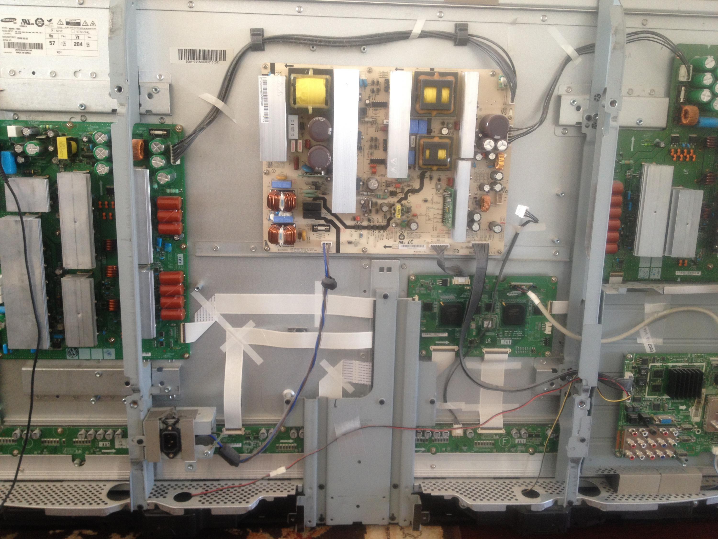

    The TV can be turned on or turned off by remote but not pictures or lights on the screen. All the voltages are OK on the power supply. The y-main board does not function, however, all the fuses and transistors are good.

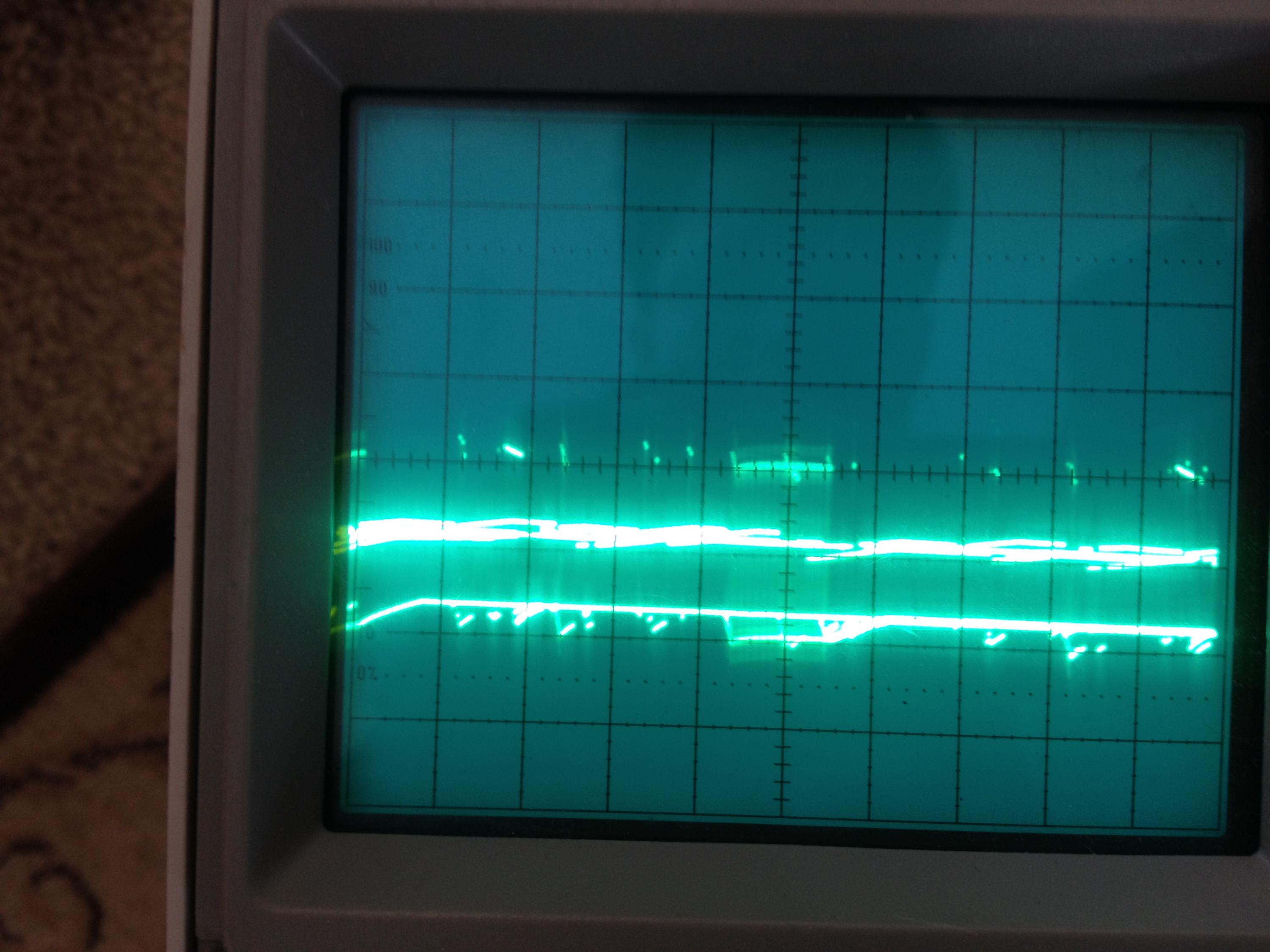

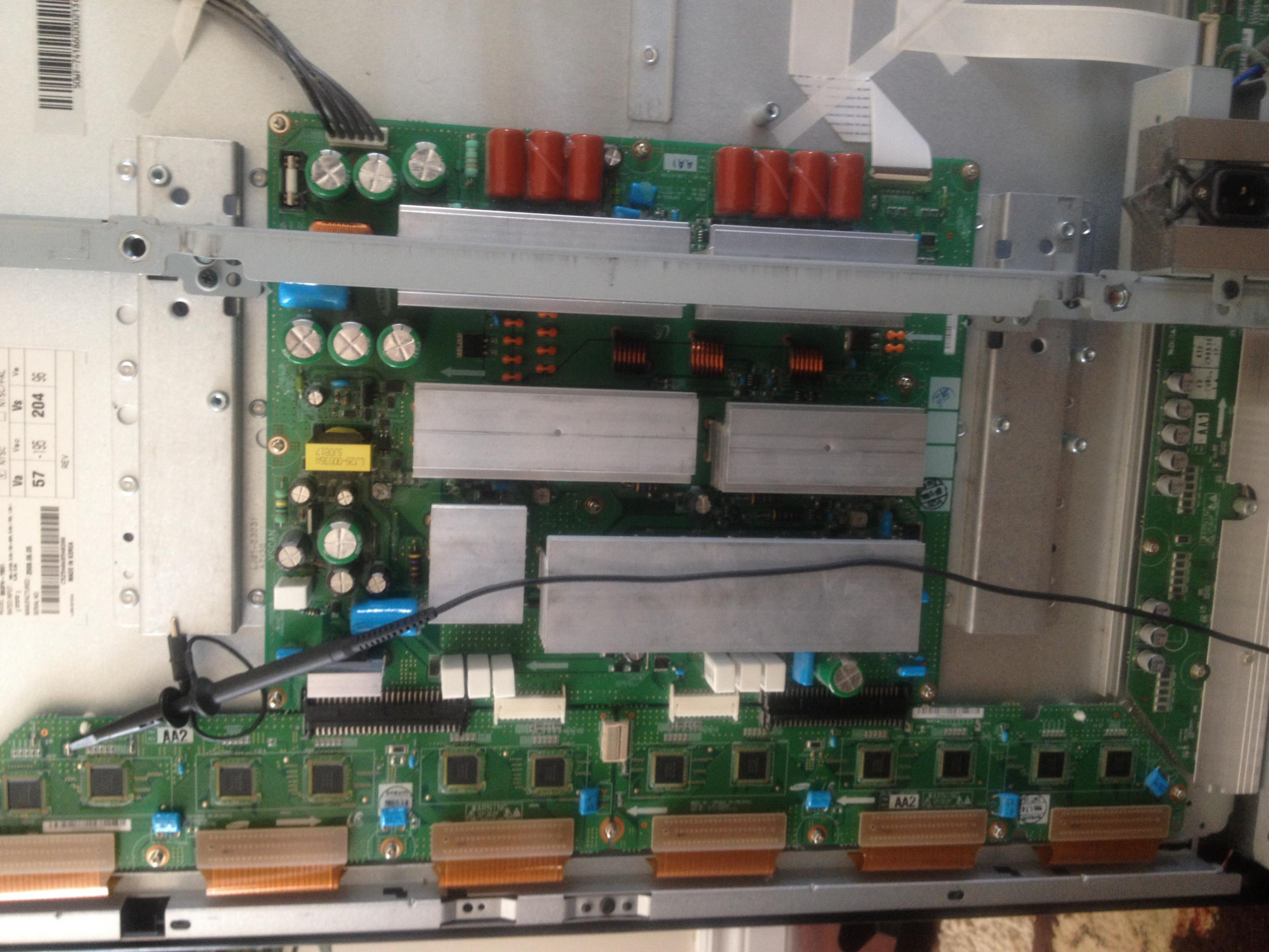

    I tested the test point on the y-buffer. There is only 0-110V waveform.
