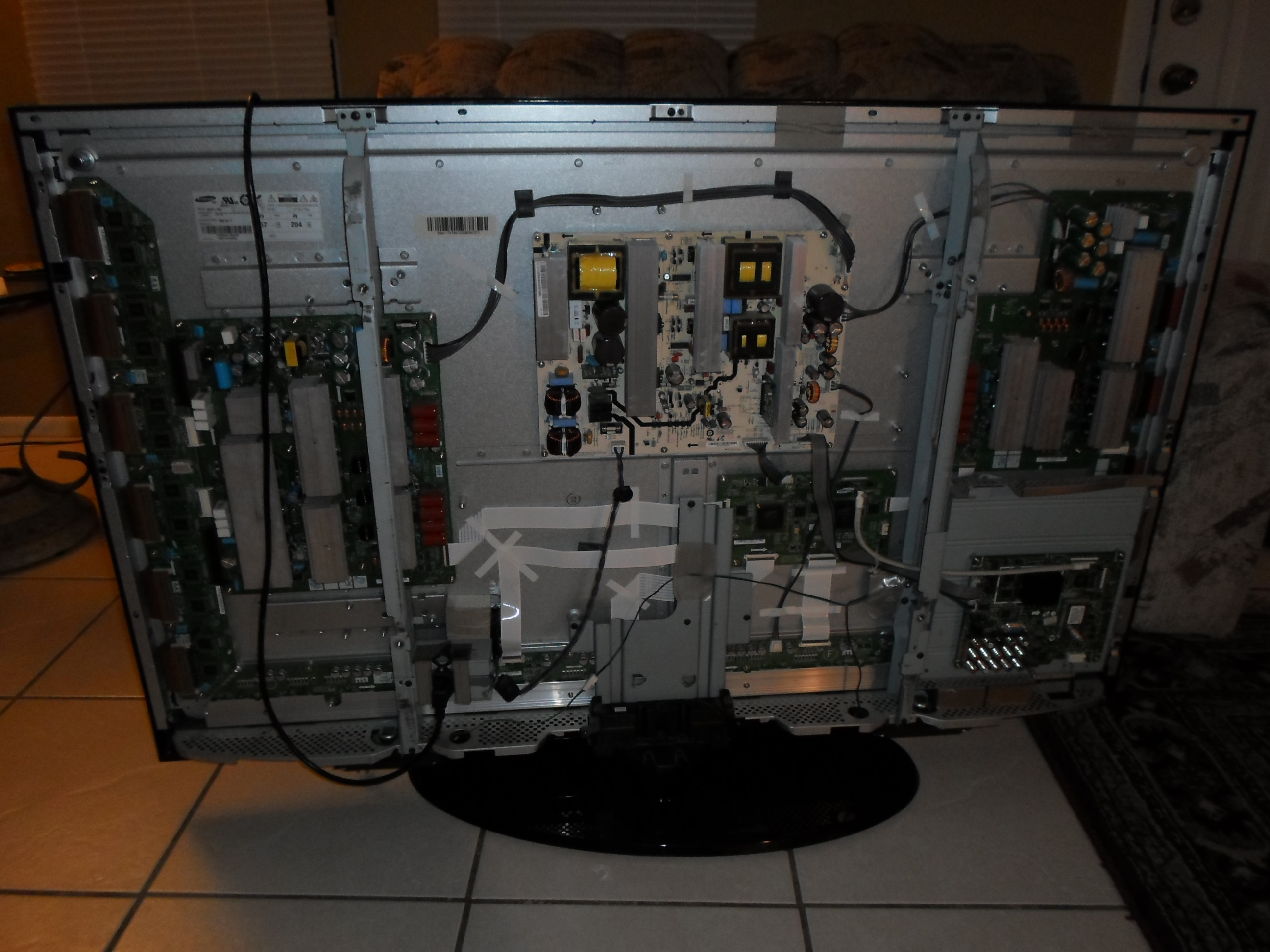

    This TV had the symptom of cycling on and off like the last one of these models I got.
    I replaced a faulty cap on the main board and the TV now comes on with sound, however there is no picture and no screen glow.
    The owner just described the cycling issue that got worse until it took 2 hours to finally come on.
    I have good Va and Vs voltage at the Y and Z main. No blown fuses or anything. What can I test next? I tried the test pattern test and no glow and picture. I don't see any crack in the screen or anything from possible damage in transport.
    Thanks!
  • kevinm34232
    • May 2012
    • 1884
    Re: Samsung PN50A510P3FXZA Plasma
    Here's a quick overview of the layout. Is there a chance something bad on Y-Main yet still have good voltages and no shutdown?

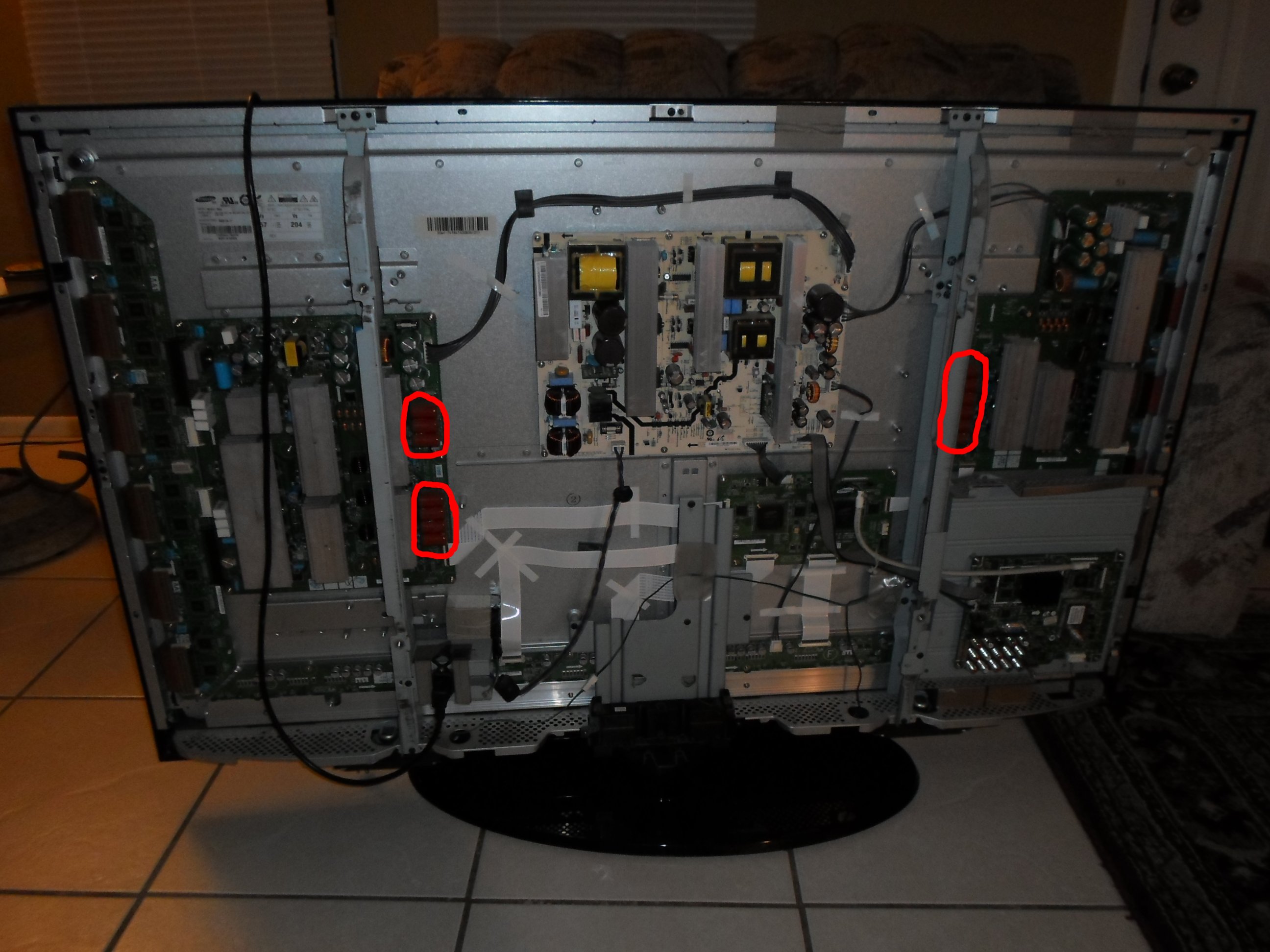

          Check voltage across these capacitors on X- and Y-main board. Only need to check one of each group.
          Should be 65~135V. A little higher or lower may be OK.
          If it tests low on Y-main/X-main: check +15V fuse
          If it tests high on either board: bad X-/Y-main
          • kevinm34232
            • May 2012
            • 1884
            Tom I get about 108V across these caps.
              Hmm, bad buffer board or panel then.
