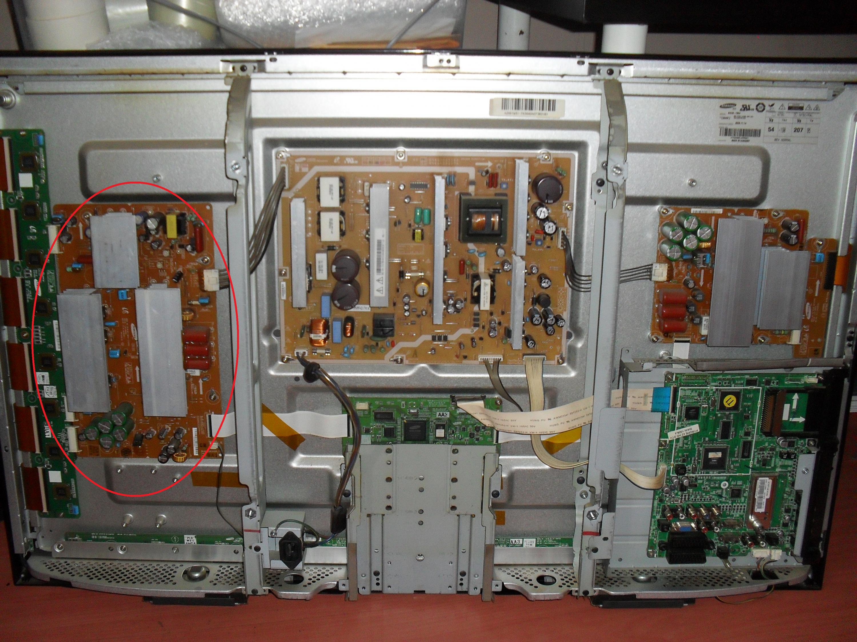

    hi there guys i got a problem with my Samsung 42" plasma (PS42A457P1DXXU) the PSU that is in it is BN44-00206A, when you power on the tv without tryin to switch it on it trys to go on automatically but the red LED power light just flashes a few times then you hear some clicking then shuts back off again then trys to boot up again in a continuous loop , anybody else had same problem or can shed some light on this ? thanks

    Check cold joints on power board. Isolate X-main and Y-main boards. Failing that, consider main board issue. Try test pattern jumper.

      im not sure how to do any of that Tom66
        Re: Ticking with PS42A457P1DXXU 42" Samsung Plasma
        Cold joints -- Inspect power board for solder joints which look dry, cracked, broken, fractured or intermittent.
        Isolate X-/Y-main -- Unplug the X- and Y-main power cables from power board, then check if set still clicks. Try with one board at a time. Only change power connections with power OFF.
        Test pattern jumper -- more involved: https://www.badcaps.net/forum/showpo...61&postcount=2

          hi Tom66 did what you said and have attached a picture and circled the board that is causing the issue
            Y-main then. I'd try sourcing a replacement. Repair may be difficult unless you have component testing skills and SMD rework ability.

                Tom66 the PCB number on that board is LJ41-00604A, cant seem to find any on ebay, is it really that difficult to epair this board ?
                  Try looking for LJ92 number. I have never repaired one of these boards but would imagine the cost of IGBTs from China + associated parts will likely exceed £30.

                    Hi Tom i found PBA number which was LJ92-01483B, would this part do ?http://www.ebay.co.uk/itm/SAMSUNG-LJ...item4d01cdb6da although seller hasnt listed Rev. no. mine says rev number is BA2

                      or this one from the states which is £20 or so cheaper http://www.ebay.co.uk/itm/SAMSUNG-LJ...item4d01cdb6da
                        I'd go with the 2nd one. Remember to factor in import charges - and check sites other than ebay.

                          Check other part number BN96-08876A new boards on eBay uk Flocko

                                Sorry should have read BN96-08875A for YSus BN96-0876A X Sus Flocko

                                    AFAIK, not important for these models.

                                      ok Tom thanks, will order one and see how it goes.
