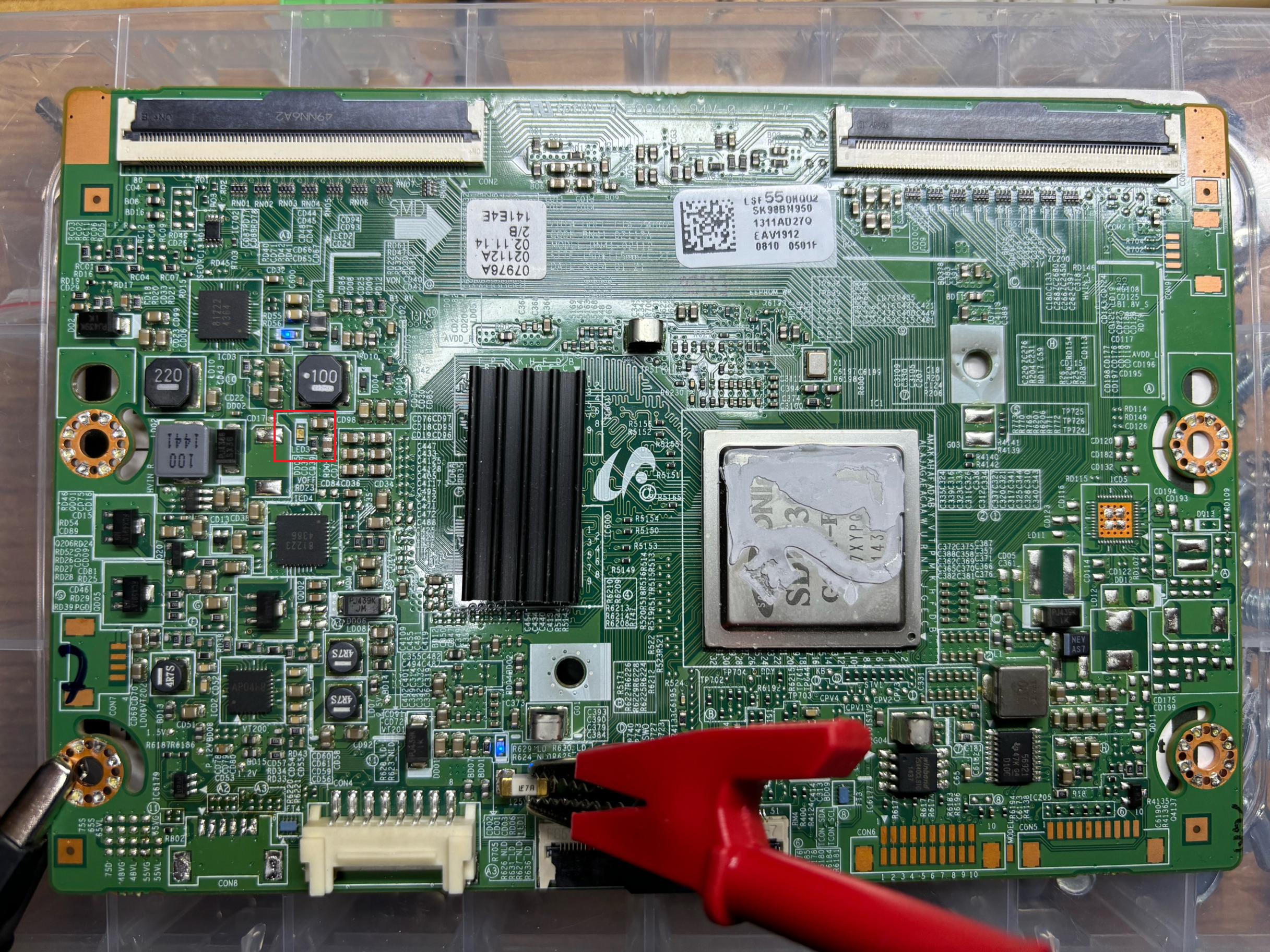

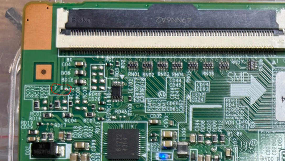

    I'm facing a issue... hope you could help me. I have a T-CON board BN41-02112A from Samsung 55inch Curve TV.
    I have just only 2 status blue LEDs ON since LED3 is off. I have tried to test some test points but VON is NOT OK very close to 0V. Is there someone that can help me on the debugging the issue? I'm supplying the board from an external 12V voltage source. ​

    Without the panel, 3 led will not light up.

          Place a jumper on T-con F_R< --------->F_L, disconnect the cables going to the panel one by one and check the non-working side.

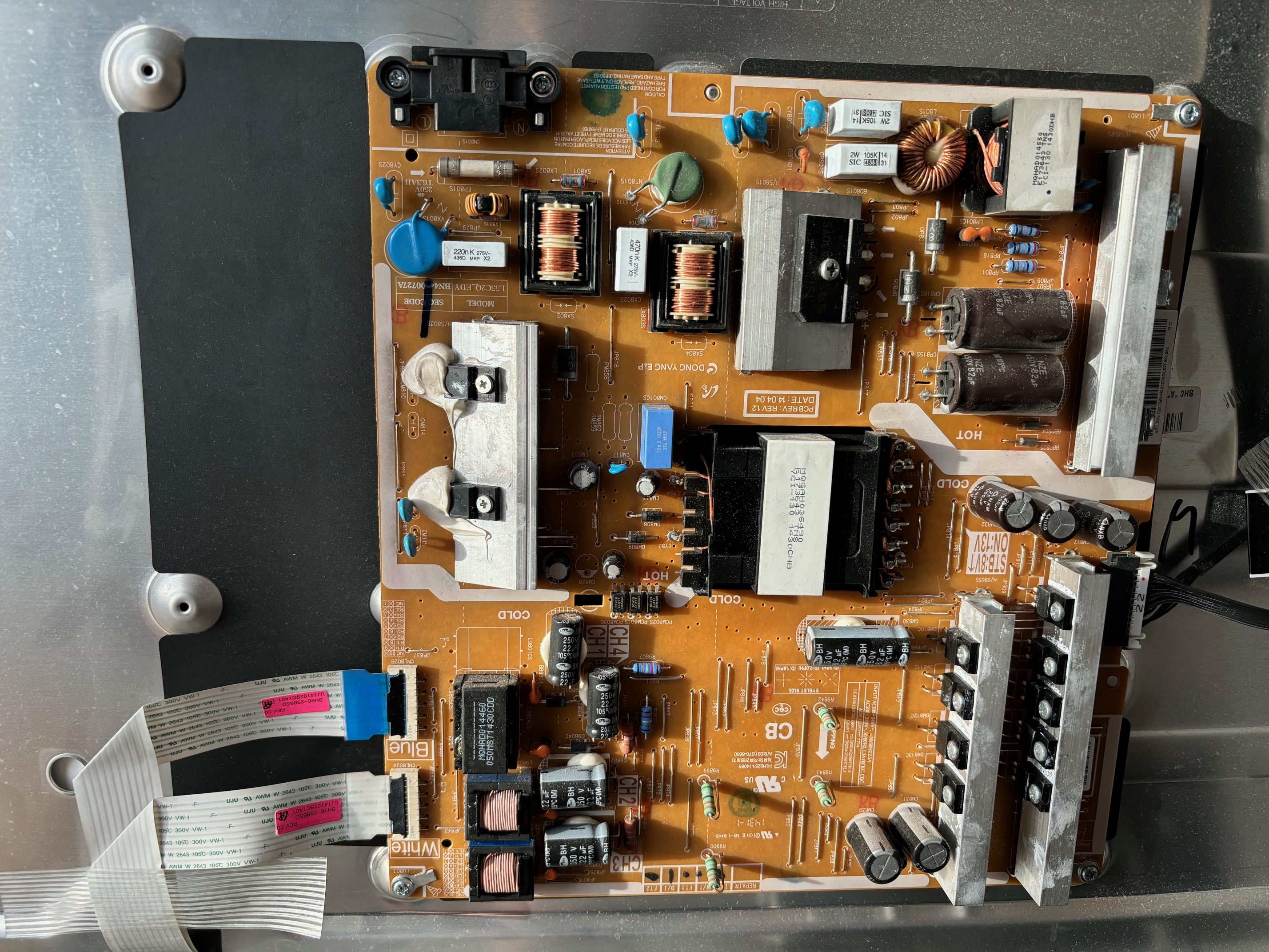

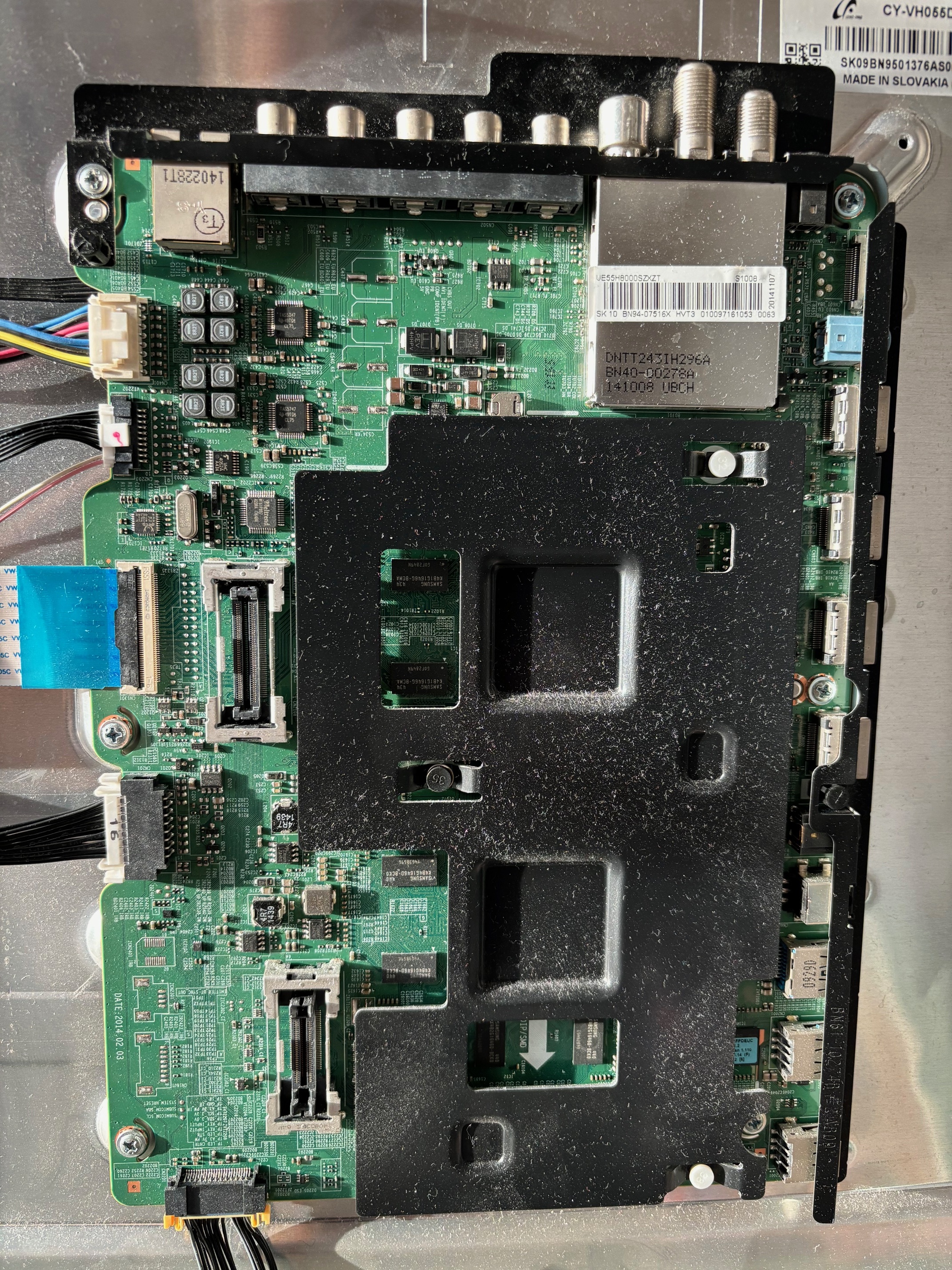

                      the other boards attached

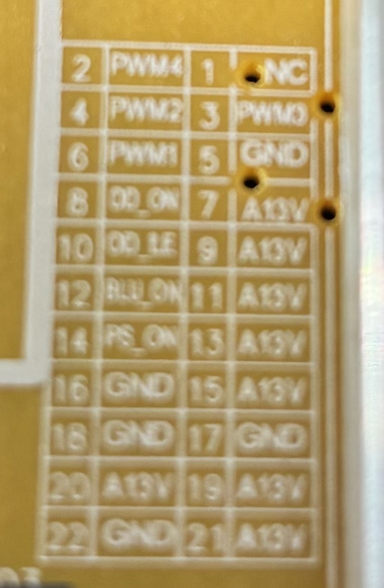

                                  Originally posted by Diah
                                  yes its ok, but what about other V the PSU generated... list them over here with pin name
                                  see attached picture too
                                  2 3.26V 1 0V
                                  4 3.26V 3 3.25V
                                  6 3.26V 5 0V
                                  8 3.07V 7 12.83V
                                  10 3.16V 9 12.83V
                                  12 4.81V 11 12.83V
                                  14 3.3V 13 12.83V
                                  16 0V 15 12.83V
                                  18 0V 17 0V
                                  20 12.83V 19 12.83V
                                  22 0V 21 12.83V
                                    2 3.26V 1 0V
                                    4 3.26V 3 3.25V
                                    6 3.26V 5 0V
                                    8 3.07V 7 12.83V
                                    10 3.16V 9 12.83V
                                    12 4.81V 11 12.83V
                                    14 3.3V 13 12.83V
                                    16 0V 15 12.83V
                                    18 0V 17 0V
                                    20 12.83V 19 12.83V
                                    22 0V 21 12.83V
                                    Why do you need these voltages now, your 3 LED on the t-con is not lit, put a jumper and check your panel by disconnecting different cables.
