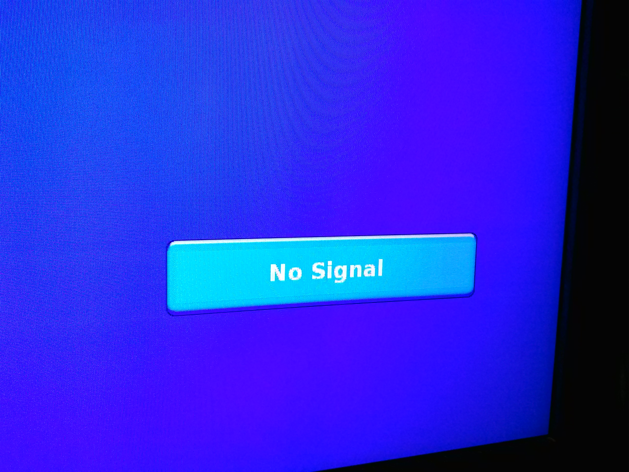

    Hi all I picked up this TV last night it appears the picture is a bit fuzzy and has ghosting or convergence issues what do you think it could be? i have not opened the TV yet

    I don't see anything particularly wrong with that image.

      Re: Proscan 40' LD45Q shadow image
      if u look at the bar hat says no signal u can see instead of it being a full blue bar it has white outline on top and black outline on bottom like its misaligned
        This is a joke? Is a normal shadow graphic effect.
          That is just a fake 3D effect. Stylistic choice. I don't see any fault there.

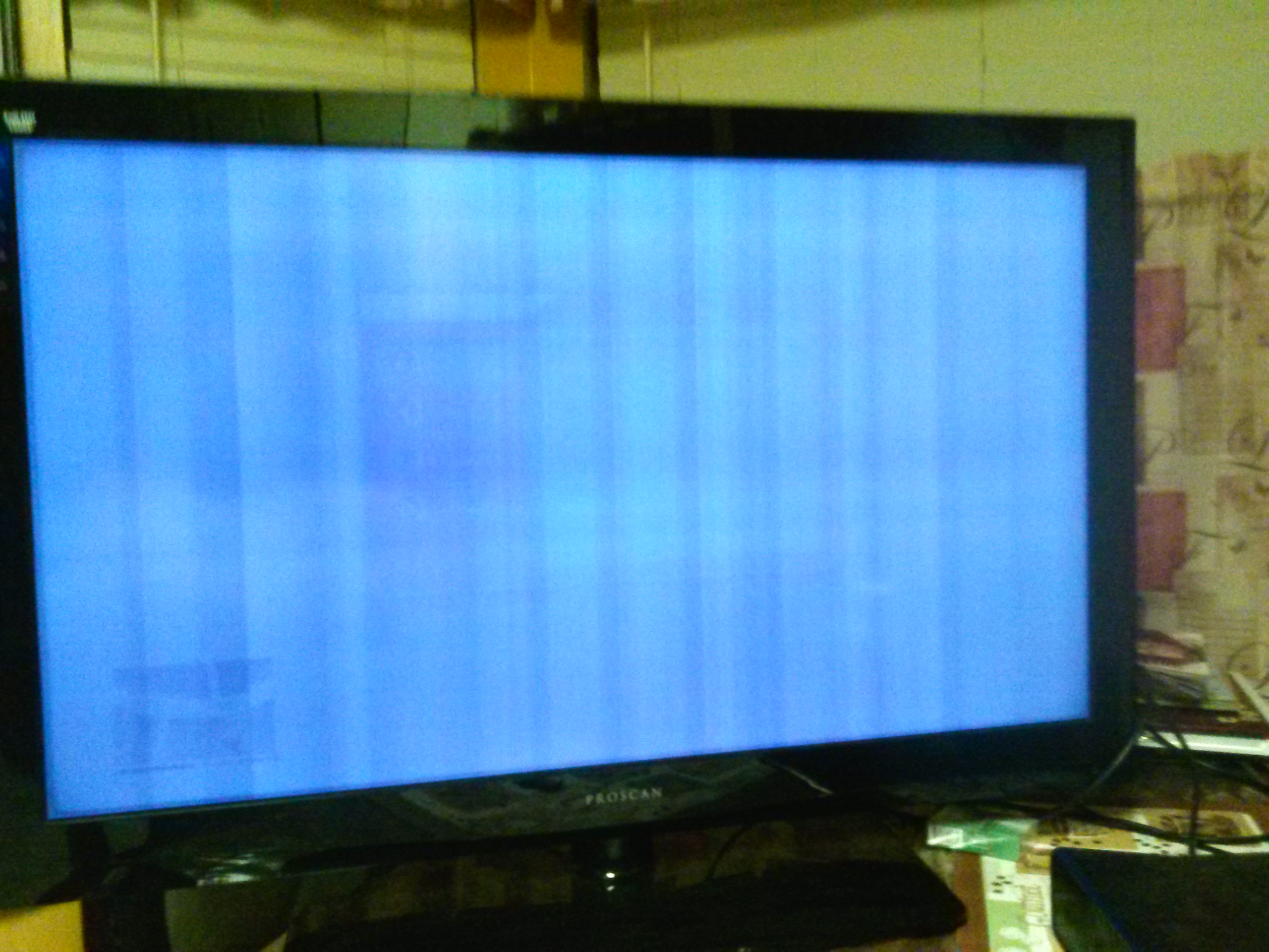

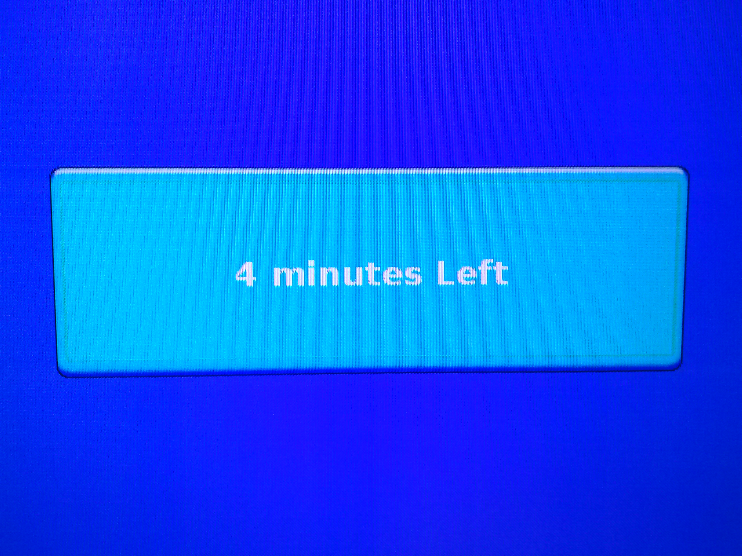

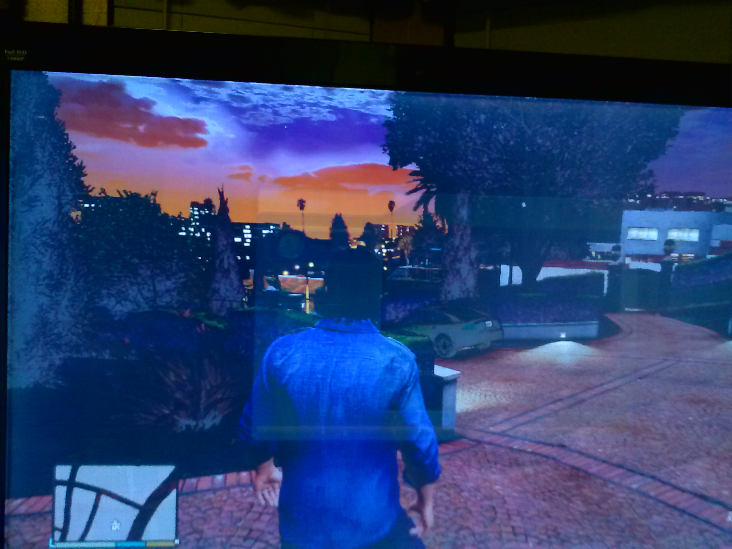

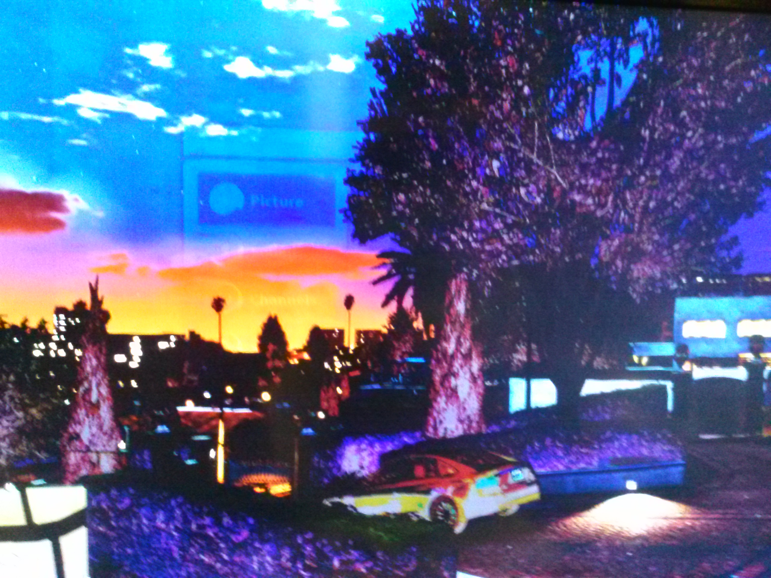

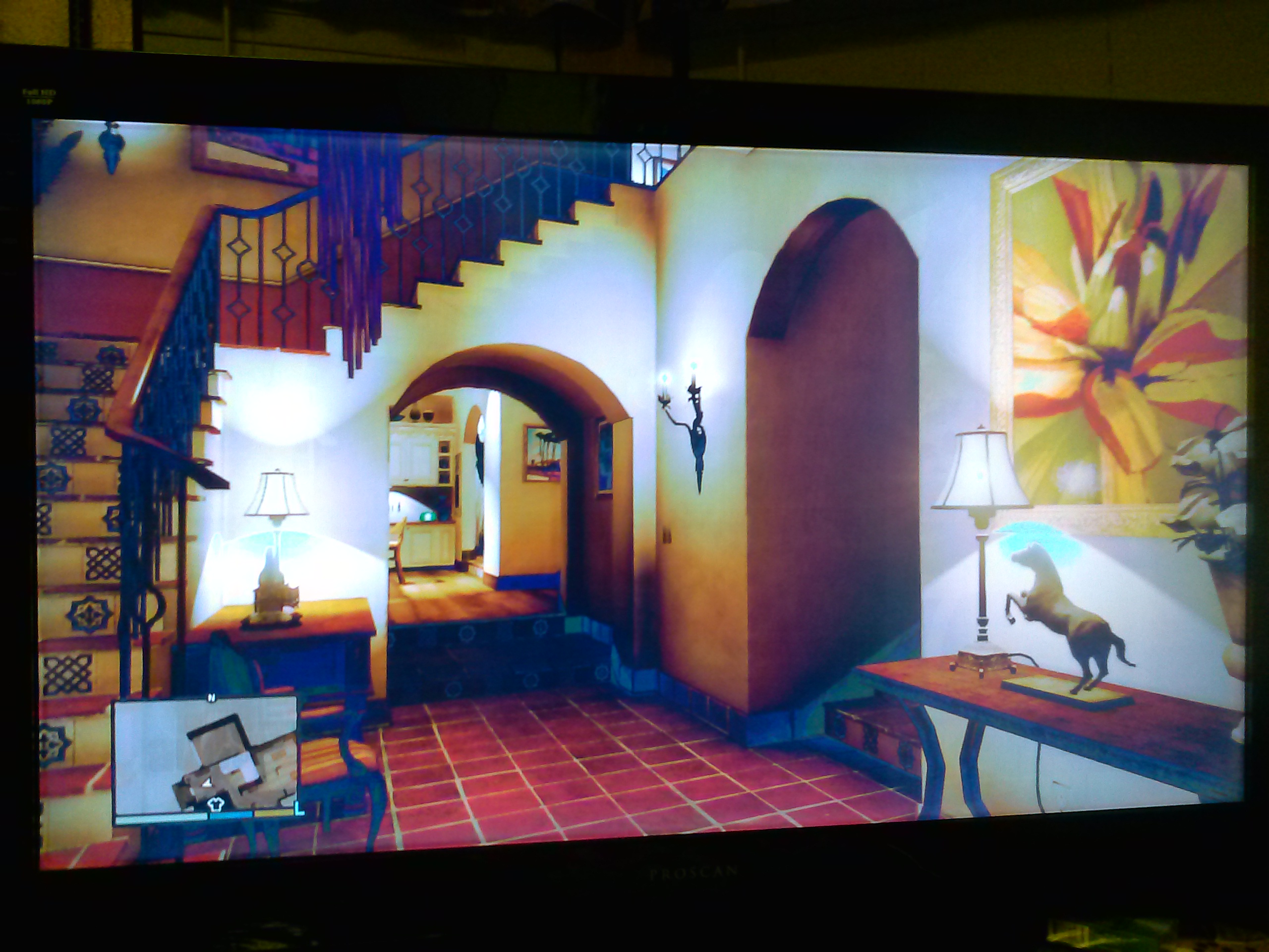

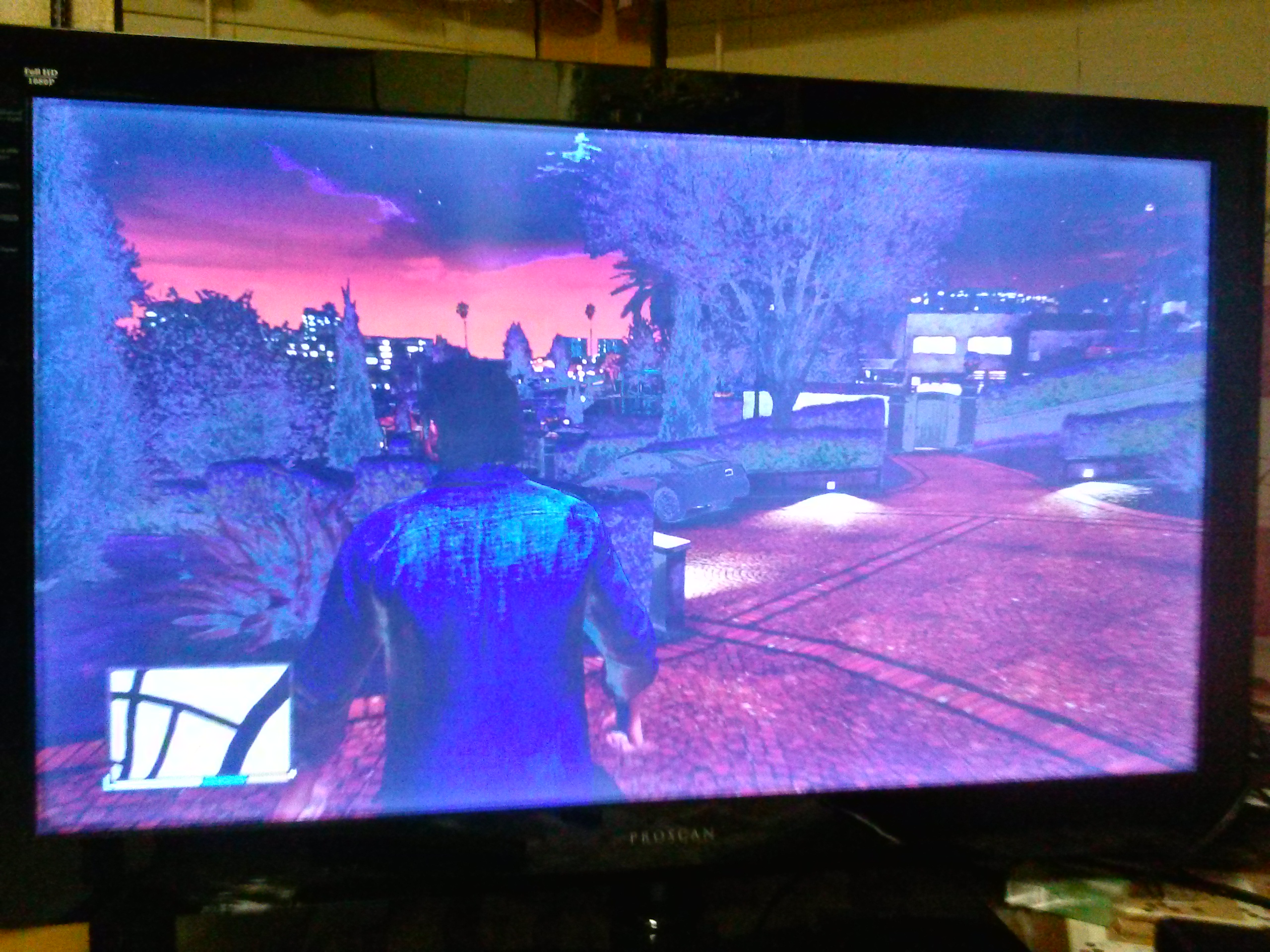

              ok so i finally got around to checking the video on the tv and im not liking what i see.. im thinking bad panel but i could be wrong.. pic 1 vertical lines pic 2 colors are all wrong almost like negative effect pic 3 ghosting from menu evident pic 4&5 blacks are blue color are all wrong
              so what u guys think?

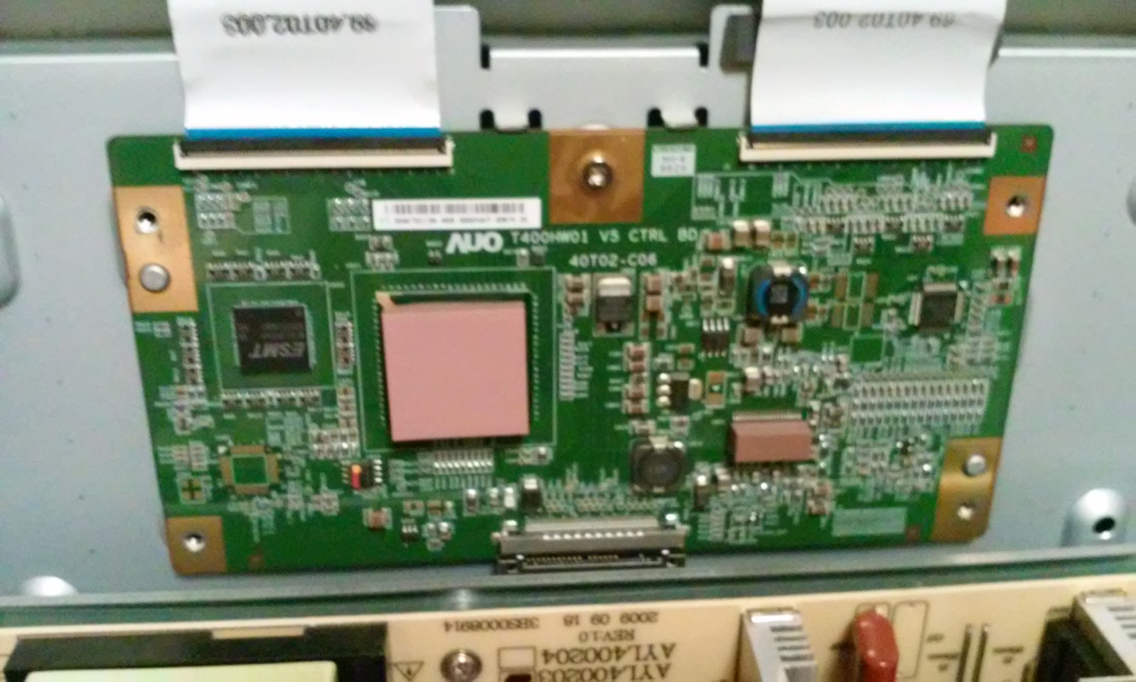

                further research on this tv tells me its actually a bad t-con i will update when i replace it

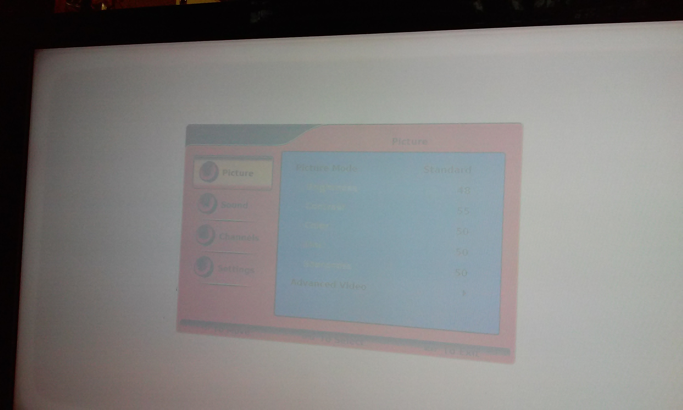

                  still working on this tv i finally broke down and bought a board from ebay since my brother procrastinated these past 3 months on it and the new board is worse than the original.. on the above pics it would show solorized imiges hinting on a bad t-con vs lcd panel right? now with the new board i got a white washed screen kinda like that samsung one i posted up a couple months back but if i unplug the tcon i got a normal lit black screen. does that mean the panel is ok? or what is a sure fire easy way to test for a noob with only a dvom as tools?
                    I recommend you post a picture of your T-con, it is possible you have a GAMMA chip fault (AS15 IC failure) it seems about 9/10 T-cons off eBay also have this fault.

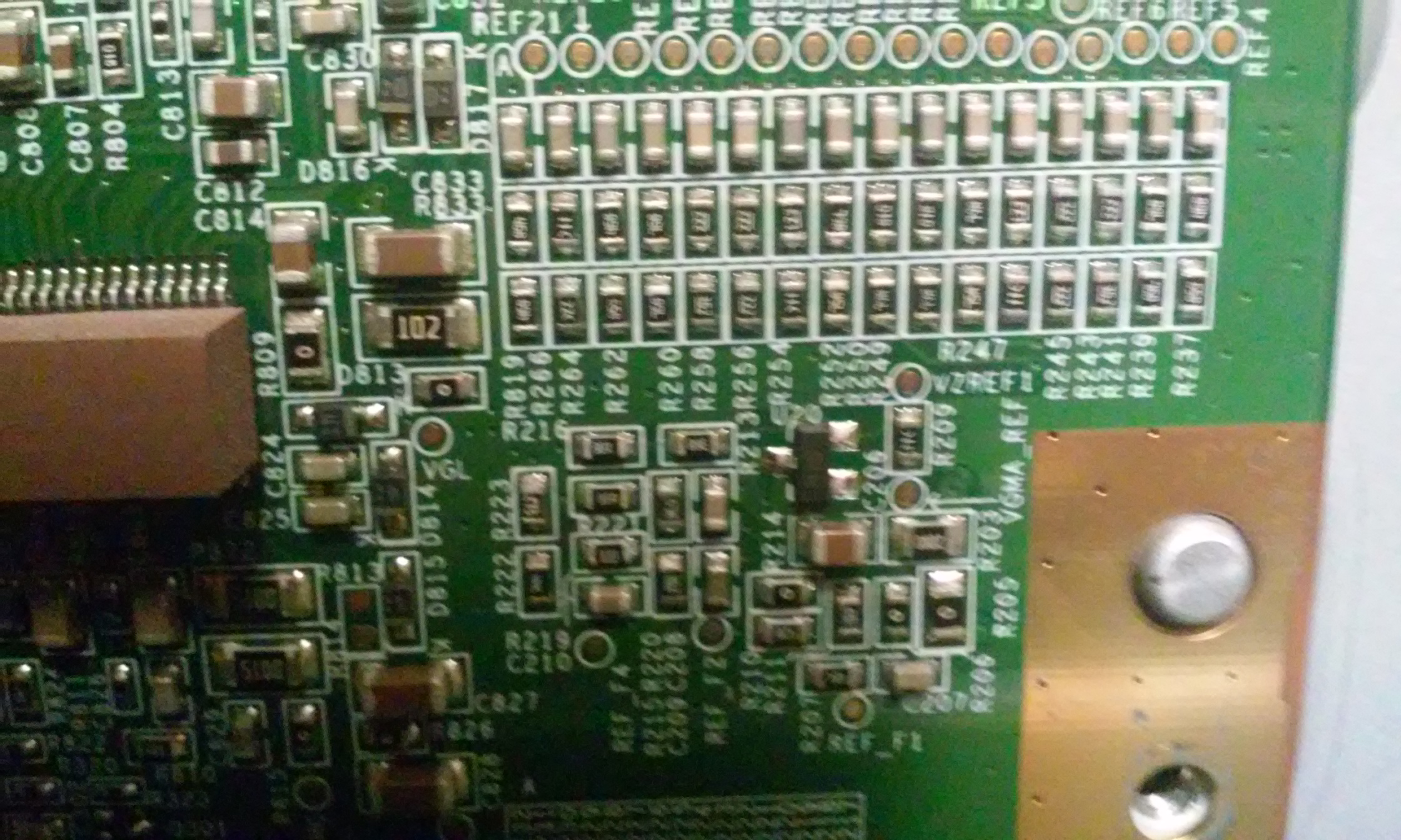

                          here are the pics

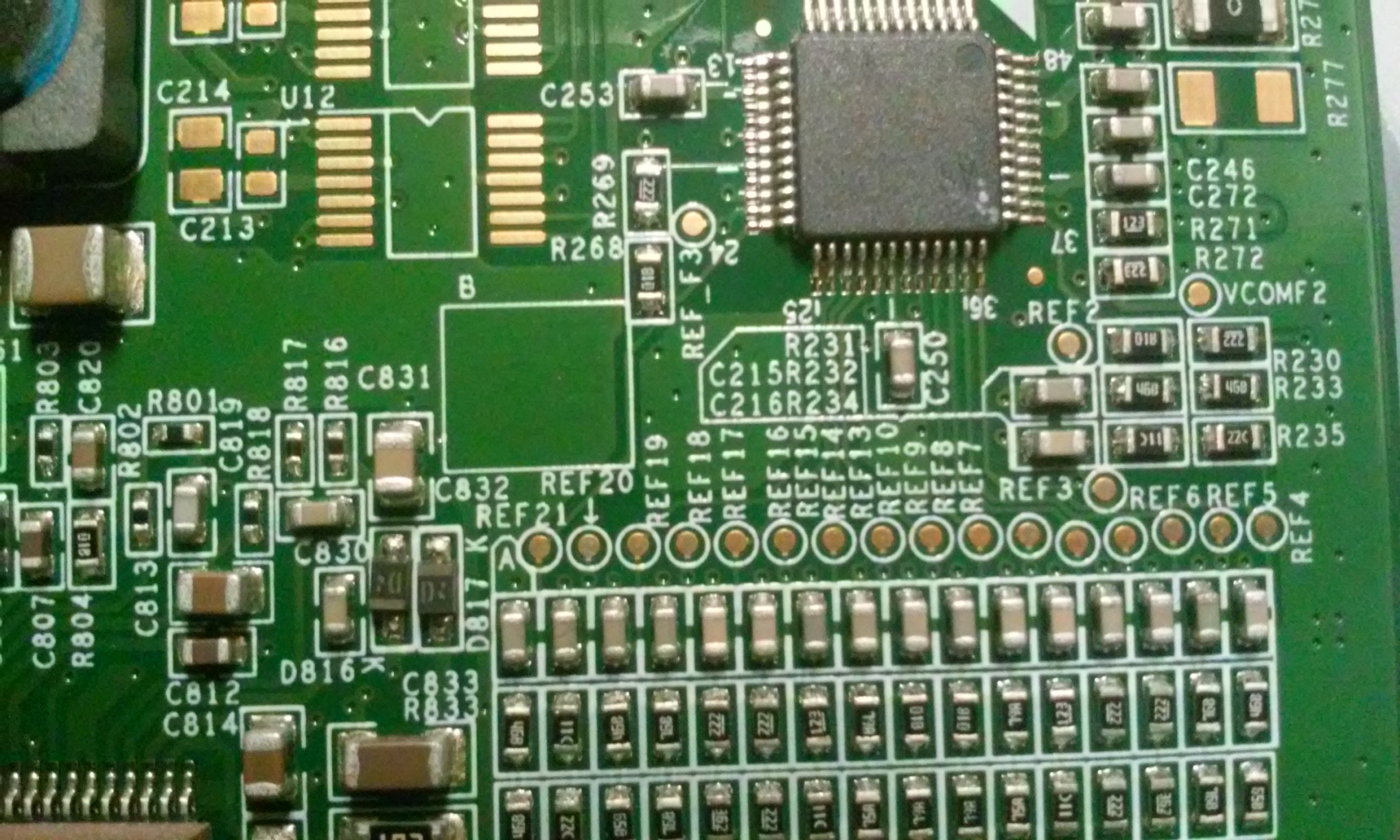

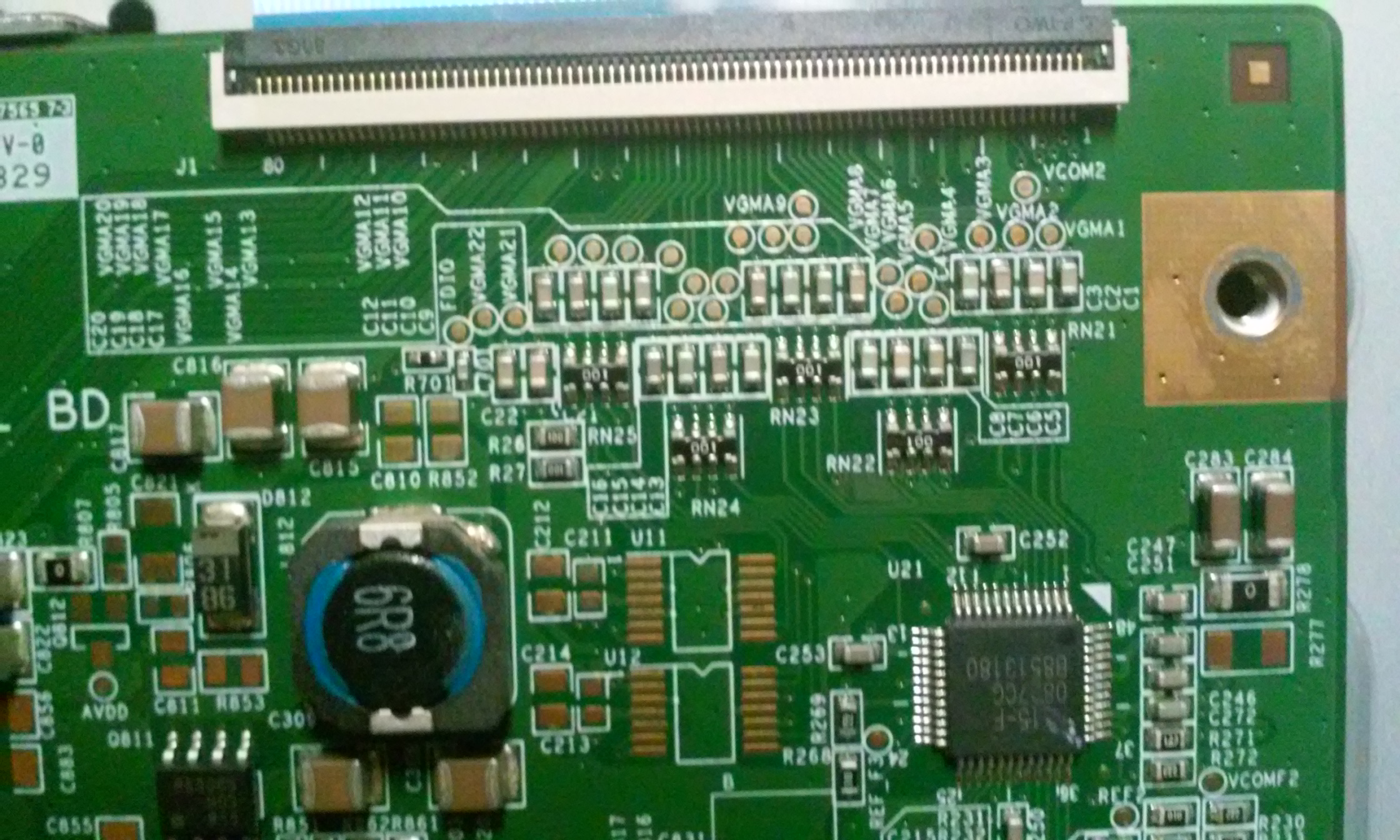

                            Fairly sure that's a gamma fault. To confirm there are some test points to measure.
                            But we need a clear, focused photo of the far right of the board. We need to be able to see the small text around components.
                            • whatusername
                              • Dec 2013
                              • 456
                              here you go
                                OK, you need to test on volts DC, the points marked VGAMA1 thru VGAMA22. The TV should be switched on, and the board should be installed,and red probe on the VGAMA point, black on the chassis.
                                    the ranges were all over the places ranging from right to left they went from 15v all the was down to 0.2 volts on the left side
                                      We need the exact voltages, a range of 15V to 0V is not unexpected but it is more important that they are in order and follow a curve.
