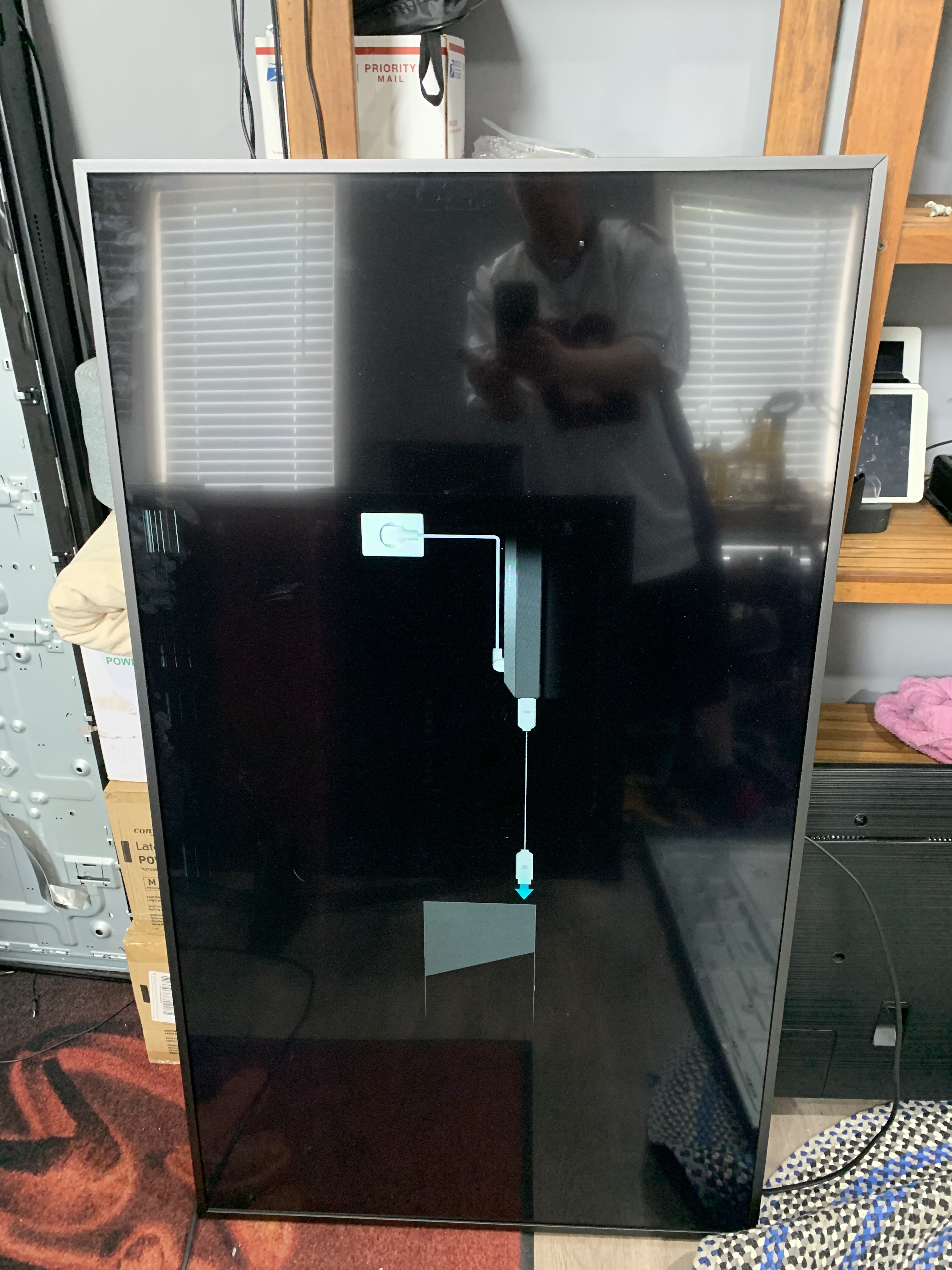

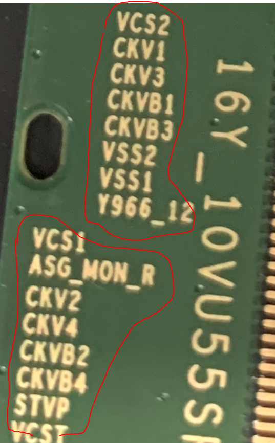

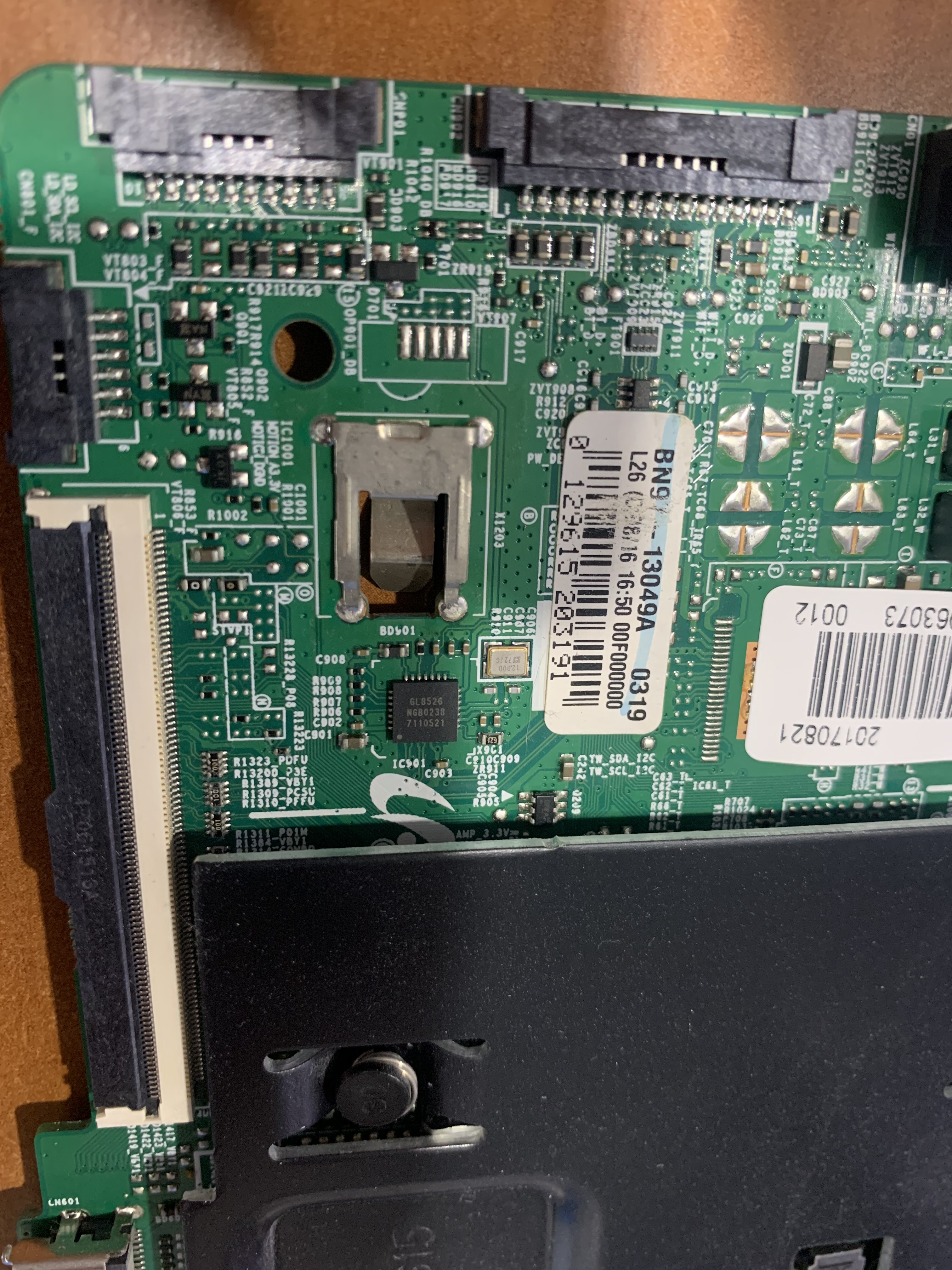

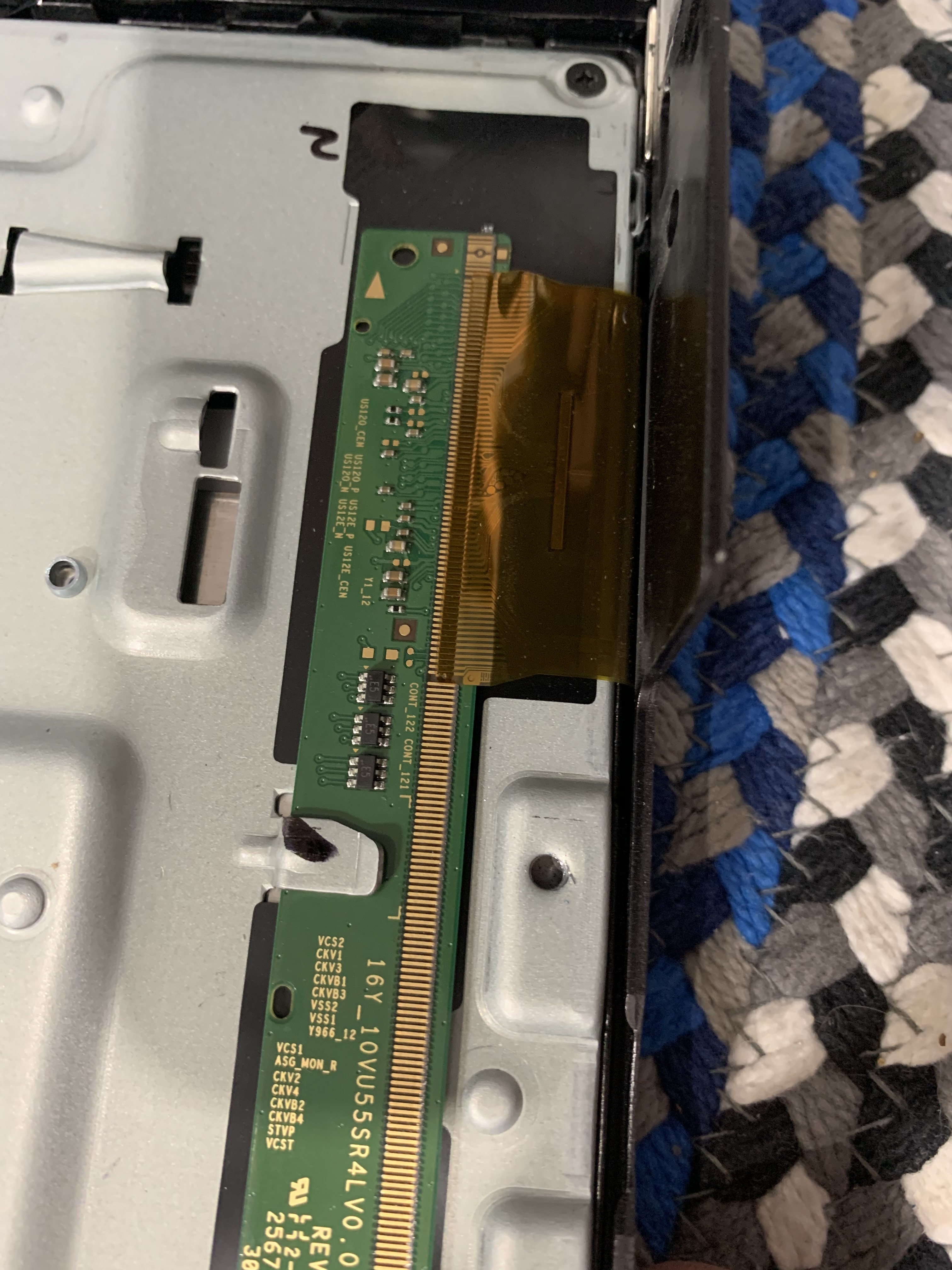

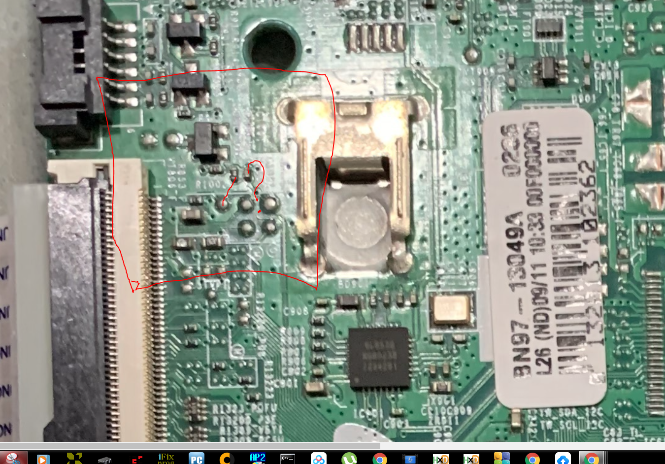

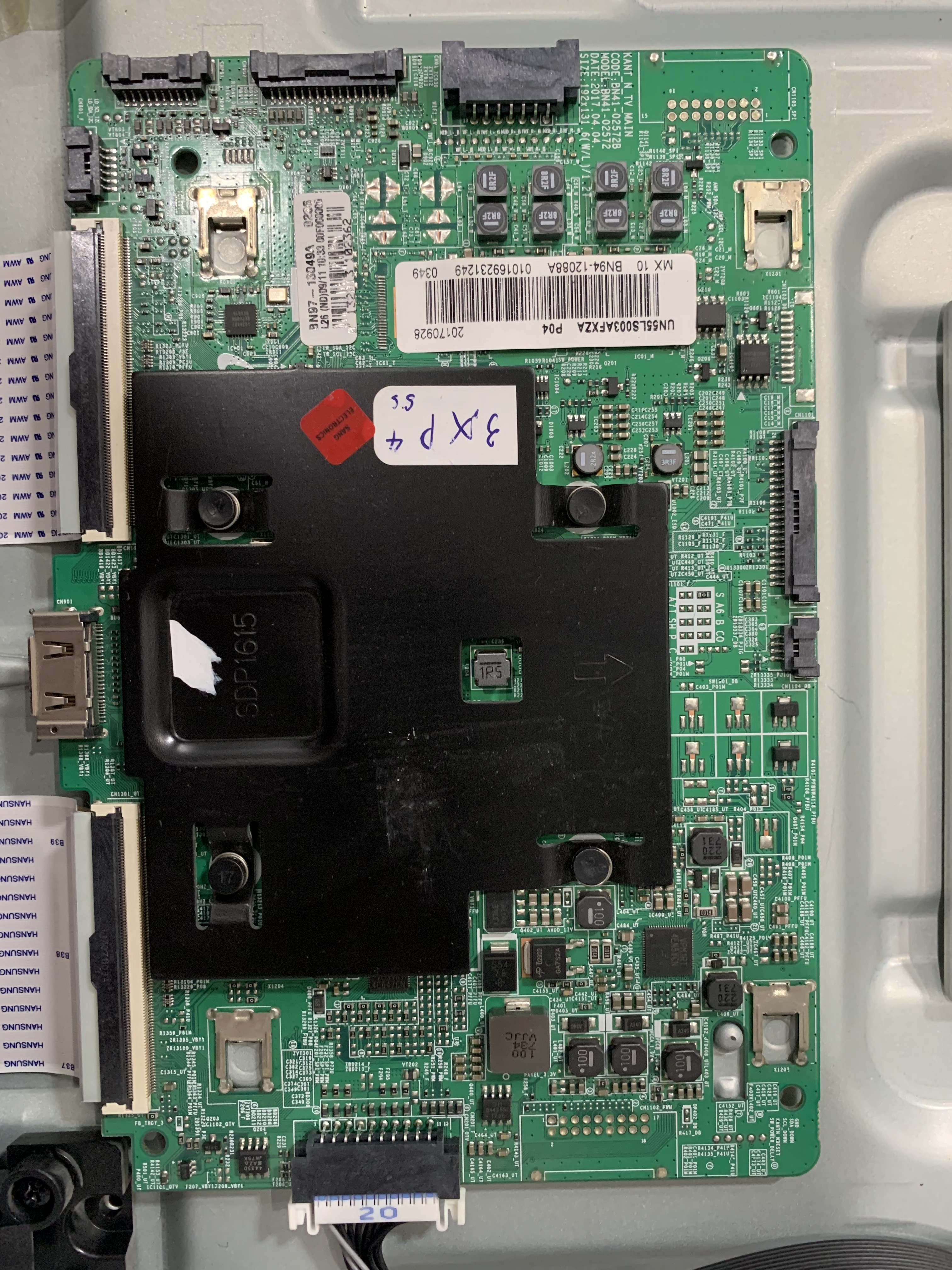

    I have this tv, actually I have 2 with same symptom. Turn tv on and it shows to connect one connect and then vertical lines and colors appear.

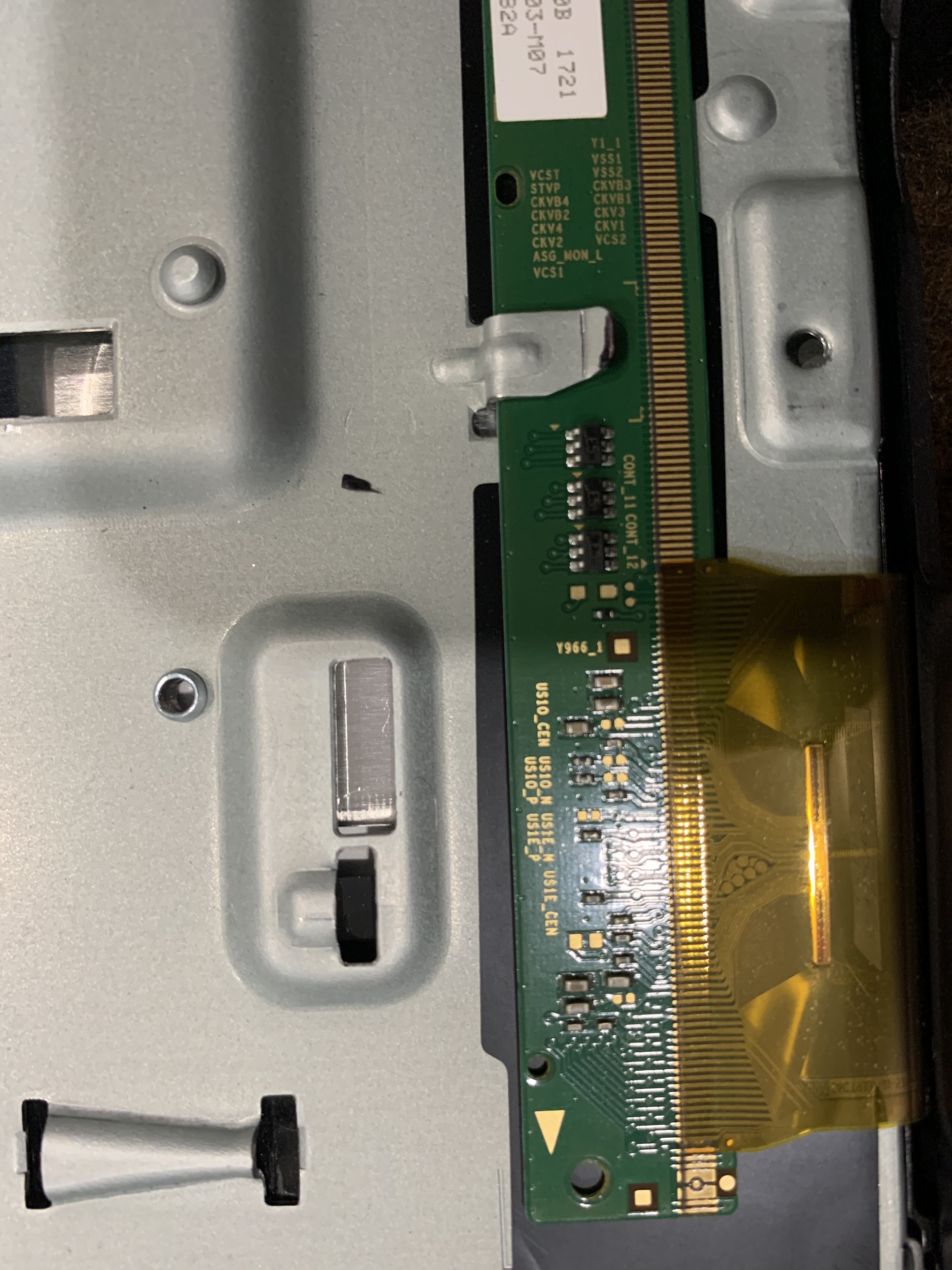

    pretty sure it’s the panel but don’t see the 2 points to jumper together to see which side of the panel it is to start with. . Anyone had this model and problem before. Any insight?

    I found one point, it’s not visible from the second photo (it’s a reflection), take a better photo without glare.

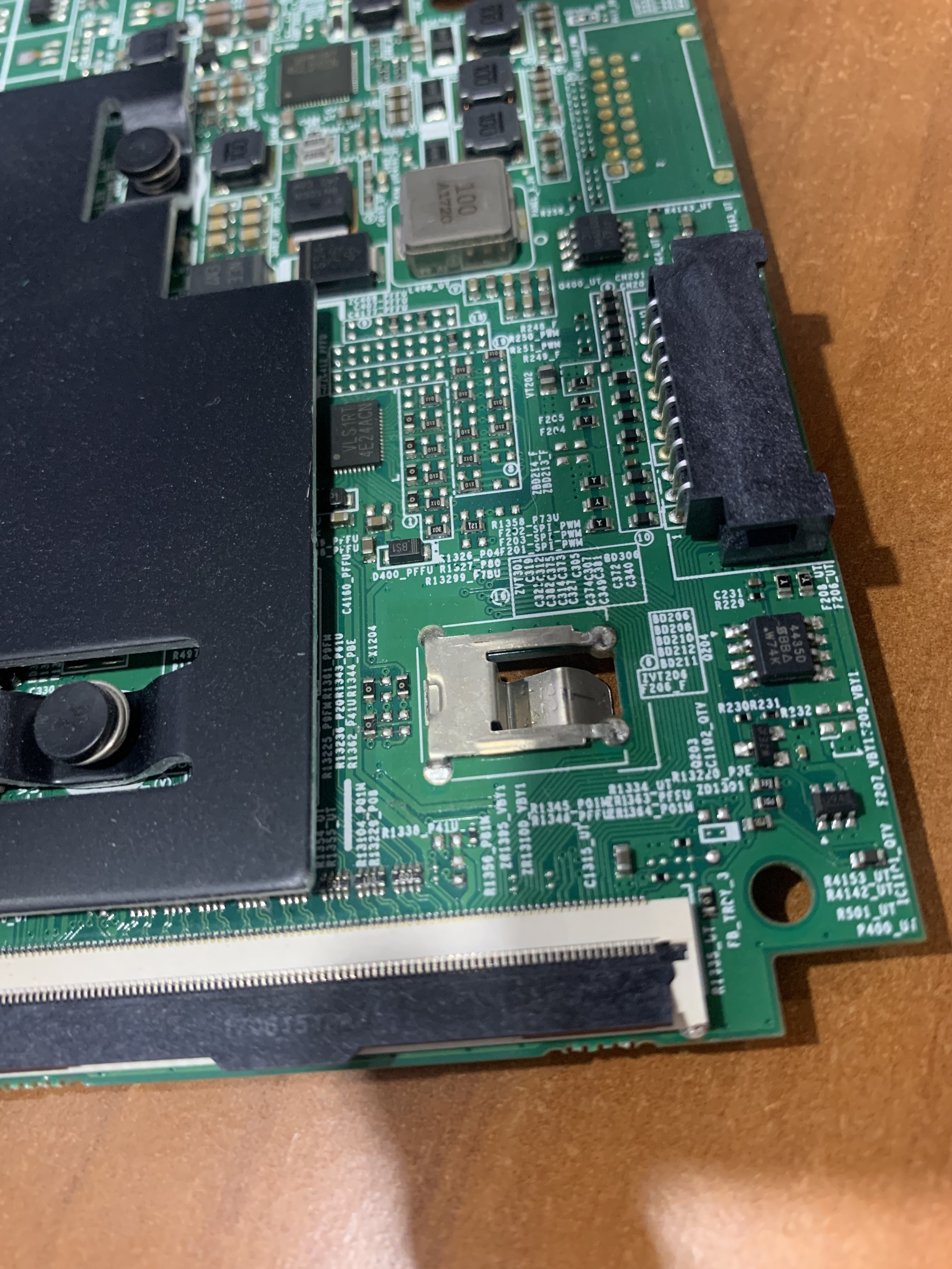

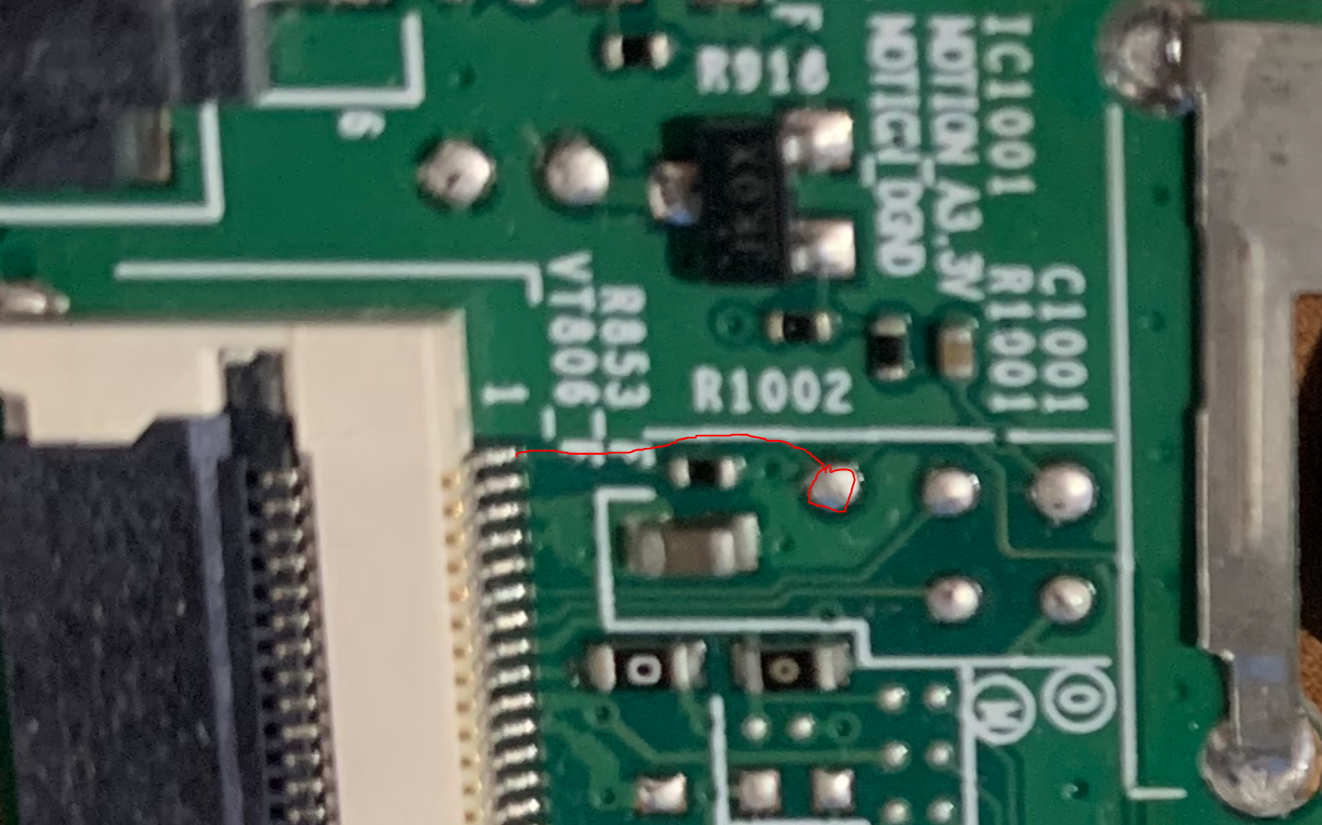

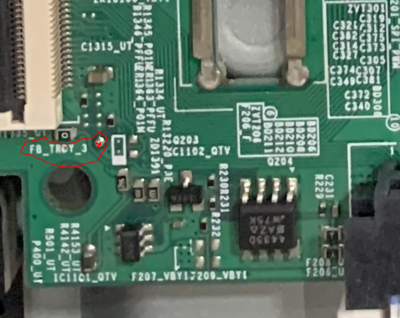

      Let me know if these work
      • lotas
        • Jan 2016
        • 4840
        • Russia

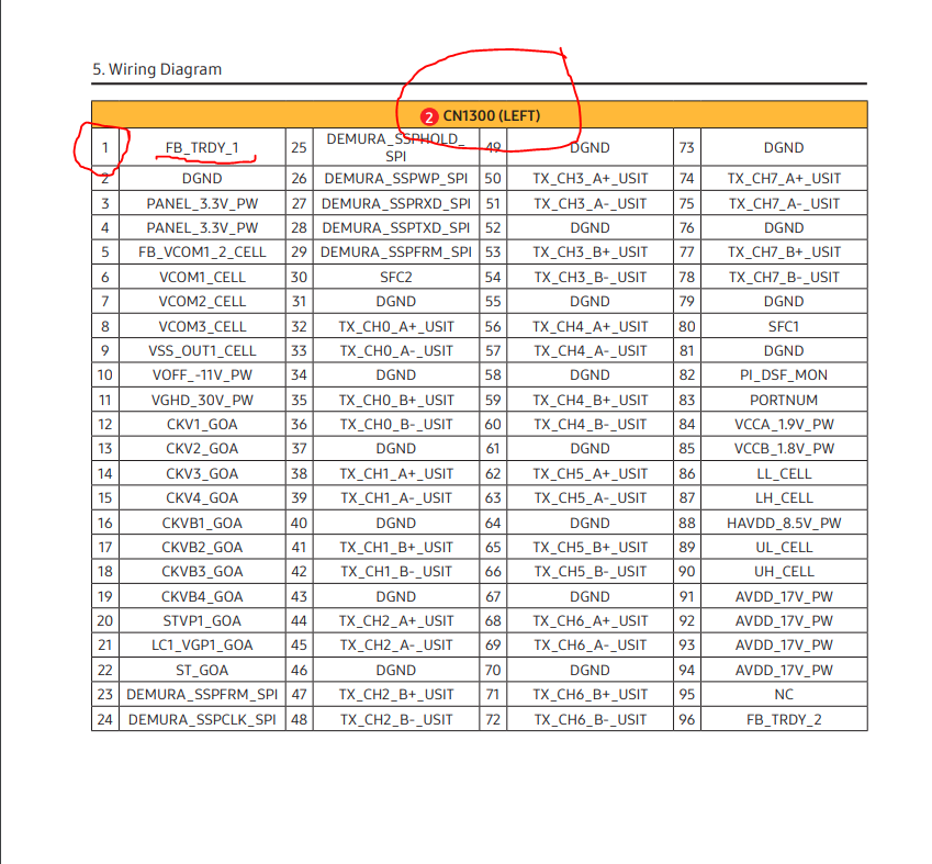

        FB_TRDY_1 and FB_TRDY_3 must be connected together.​

          Thank you. Now the troubleshooting begins

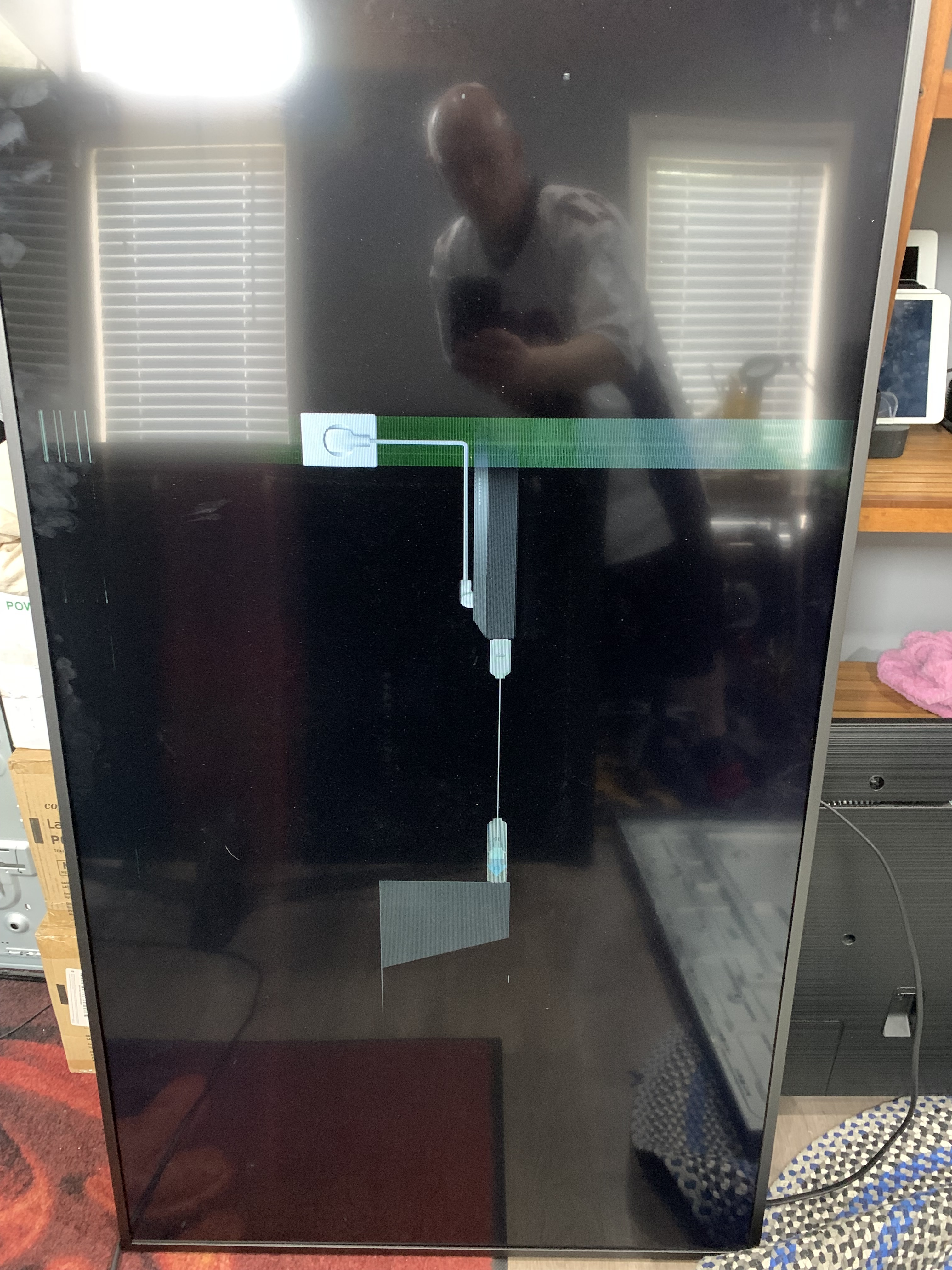

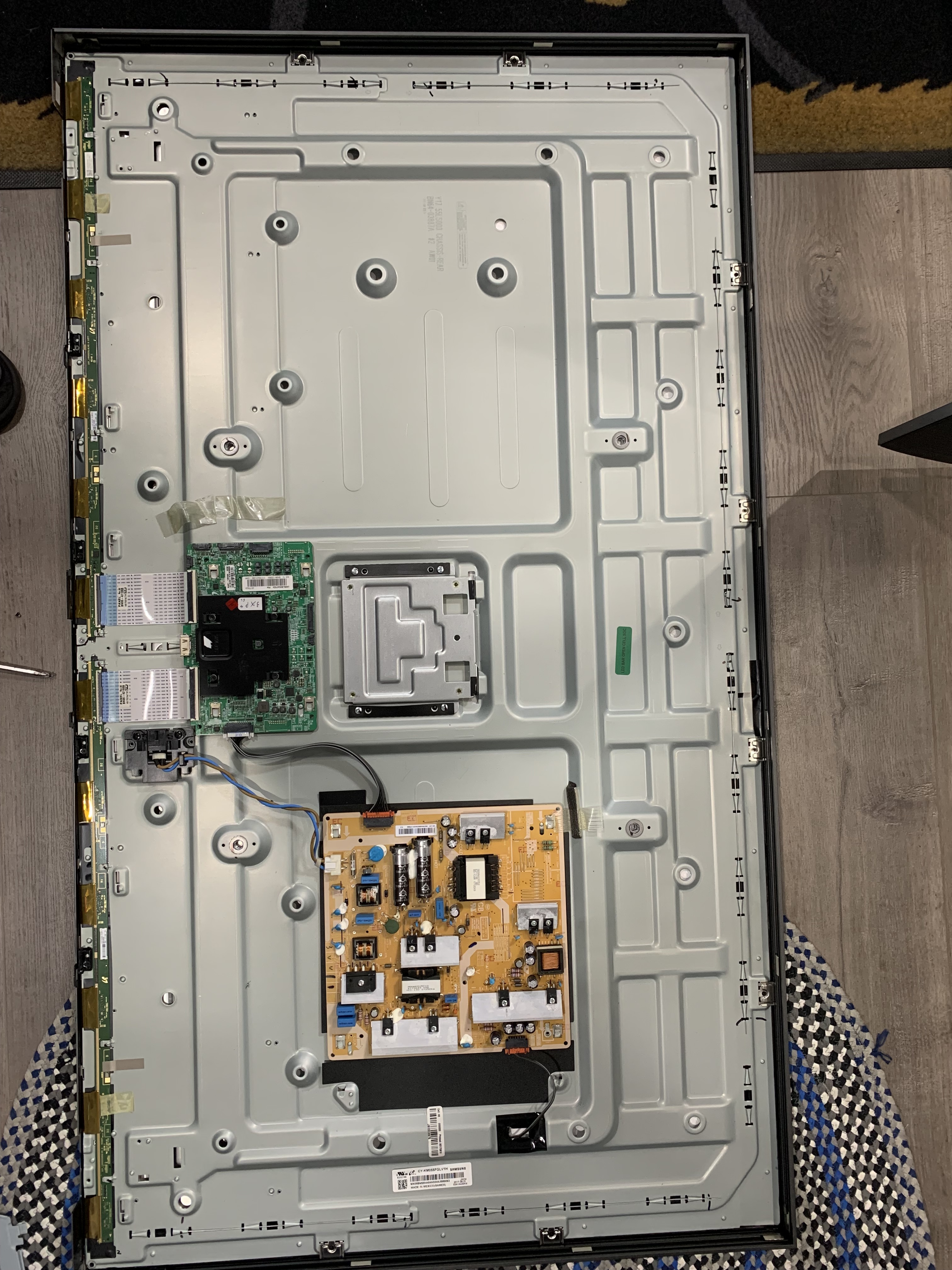

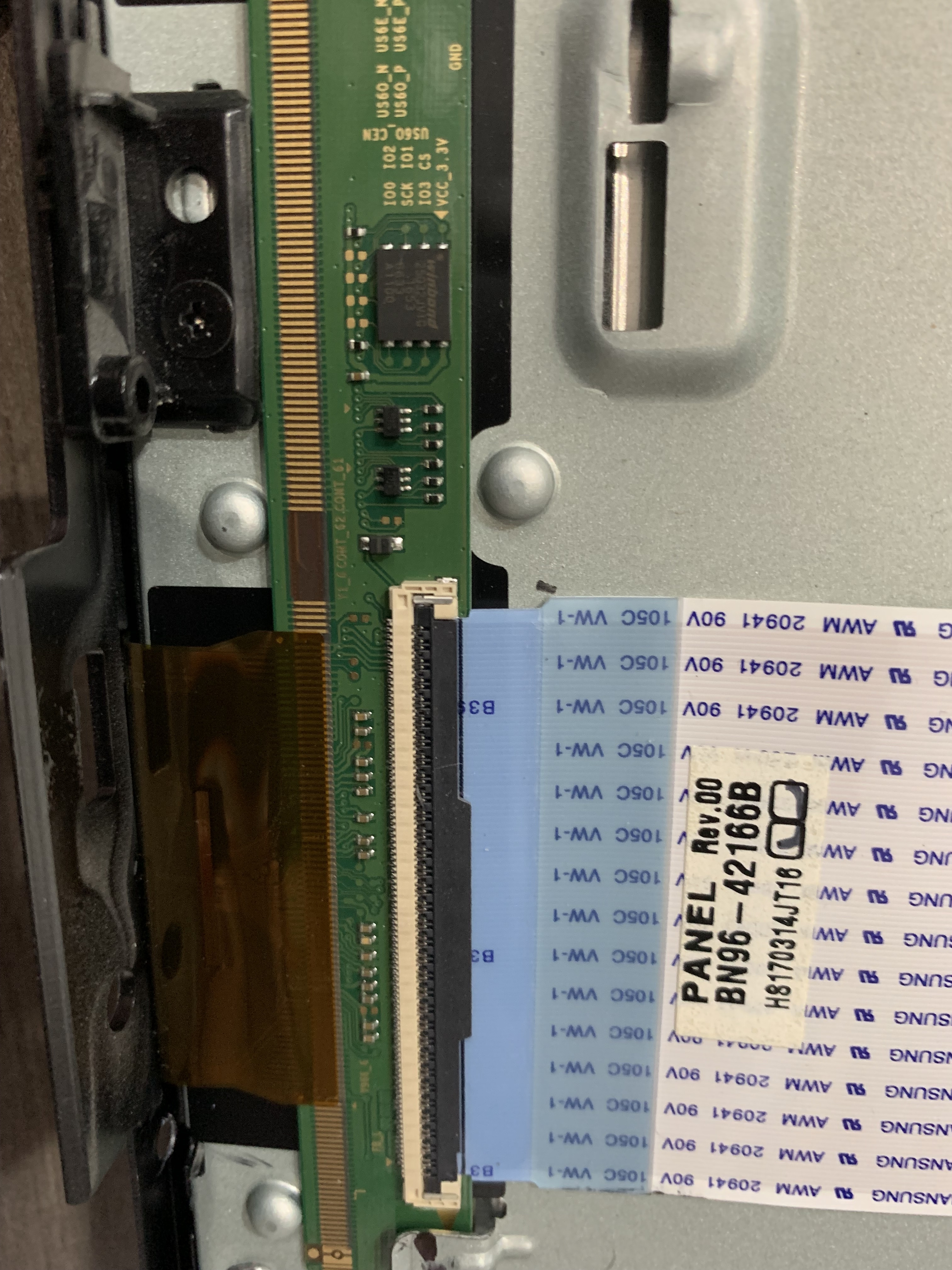

            With the test points connected I get no picture with either side of the lvds cables disconnected. Just some vertical lines and a green blob. Same for both TVs.
            Tried covering the ckv lines and same result also.
            any other ideas or suggestions before I scrap both

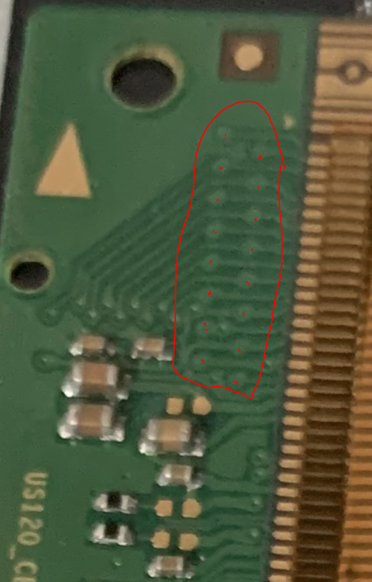

              Carefully strip these test points from the mask and check the resistance with a multimeter to the ground and between them (should not be low or short).

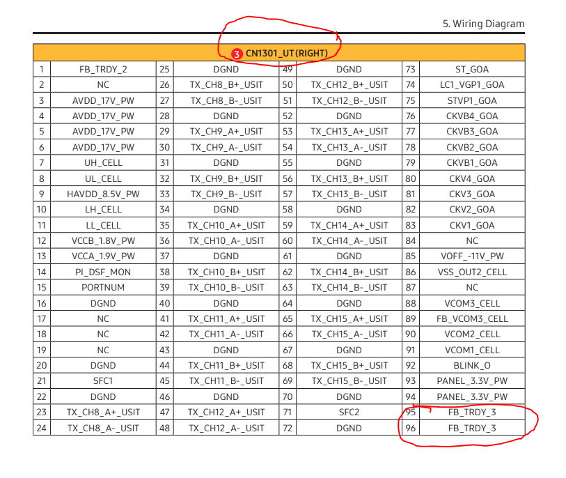

                • Jumpered FB_TRDY_1 (pin 1 CN1300 left. main tcon->left side buffer boards) and FB_TRDY_3 (pin 95 CN1301 right. main tcon->right side buffer boards) This allows testing individual T-Con (on main board) connection to panel on this Samsung. Found fault on left side (viewing from rear of TV)
                • Each side has 2 buffer boards, disconnected left side flex between 2 buffer boards. Fault is on the left most board.
                • Tape masking eventually isolated to CN1300 pin 15 (CKV4_GOA) Display
