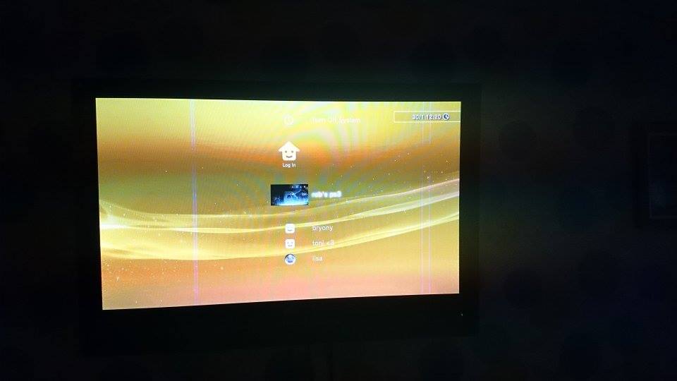

    I noticed when removing the back of the tv that two caps where bulged the tv was dead before this, upon changing the caps the tv now turns on.I have back light and the screen is on but just audio no picture
    Any help would be appreciated

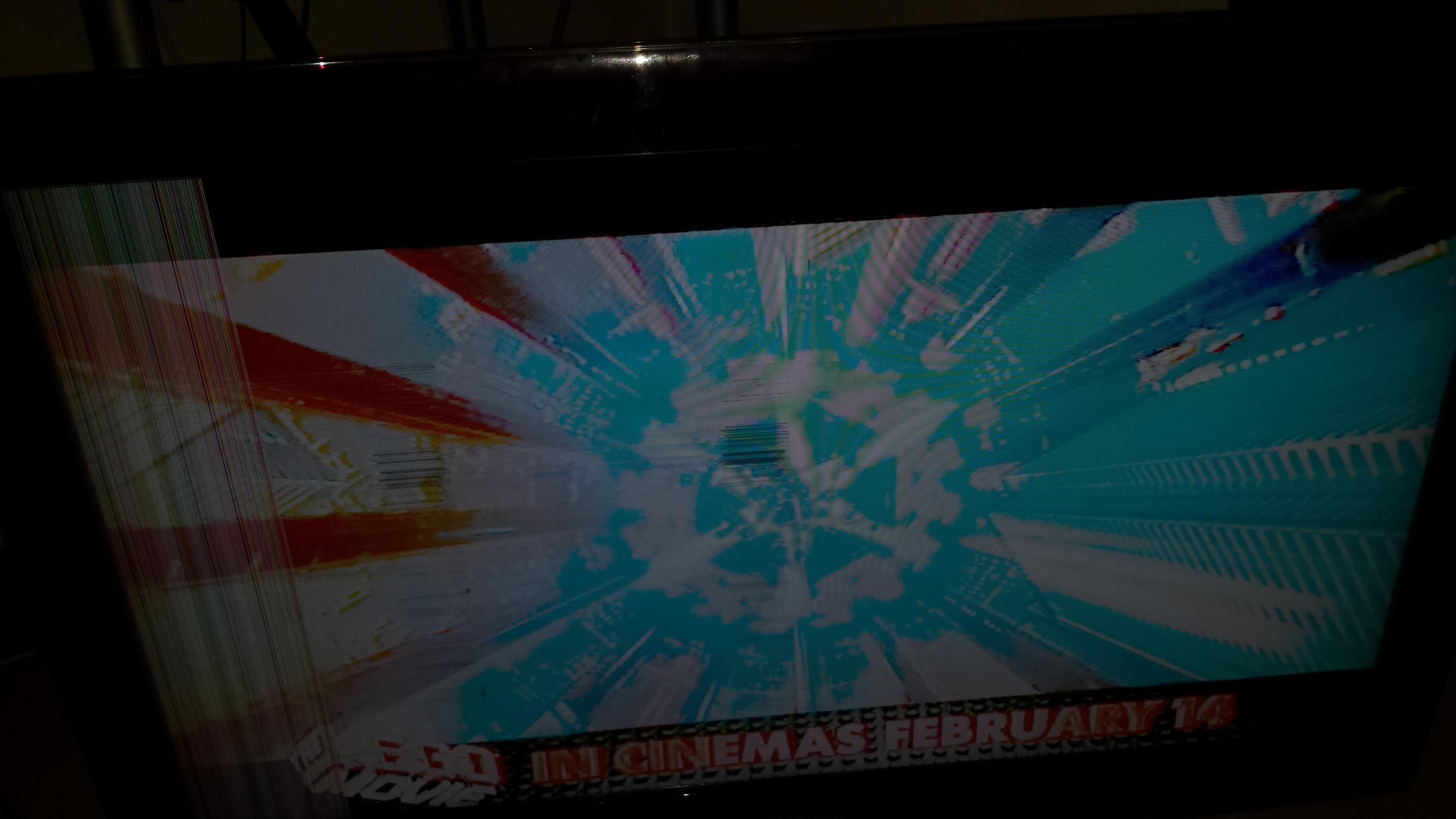

      Re: SAMSUNG le37a656
      Ok for some reason the tcon was disconnected upon connecting it the right side of the screen is fine but the left side has flashing colours
        Looks like a bad panel to me, sorry. Small chance T-con FRC is bad, or one LVDS to T-con is loose.
        FRC is that board in between main and t-con. It generates 100Hz video.
        I think someone could have ripped you off by pulling t-con cable out?

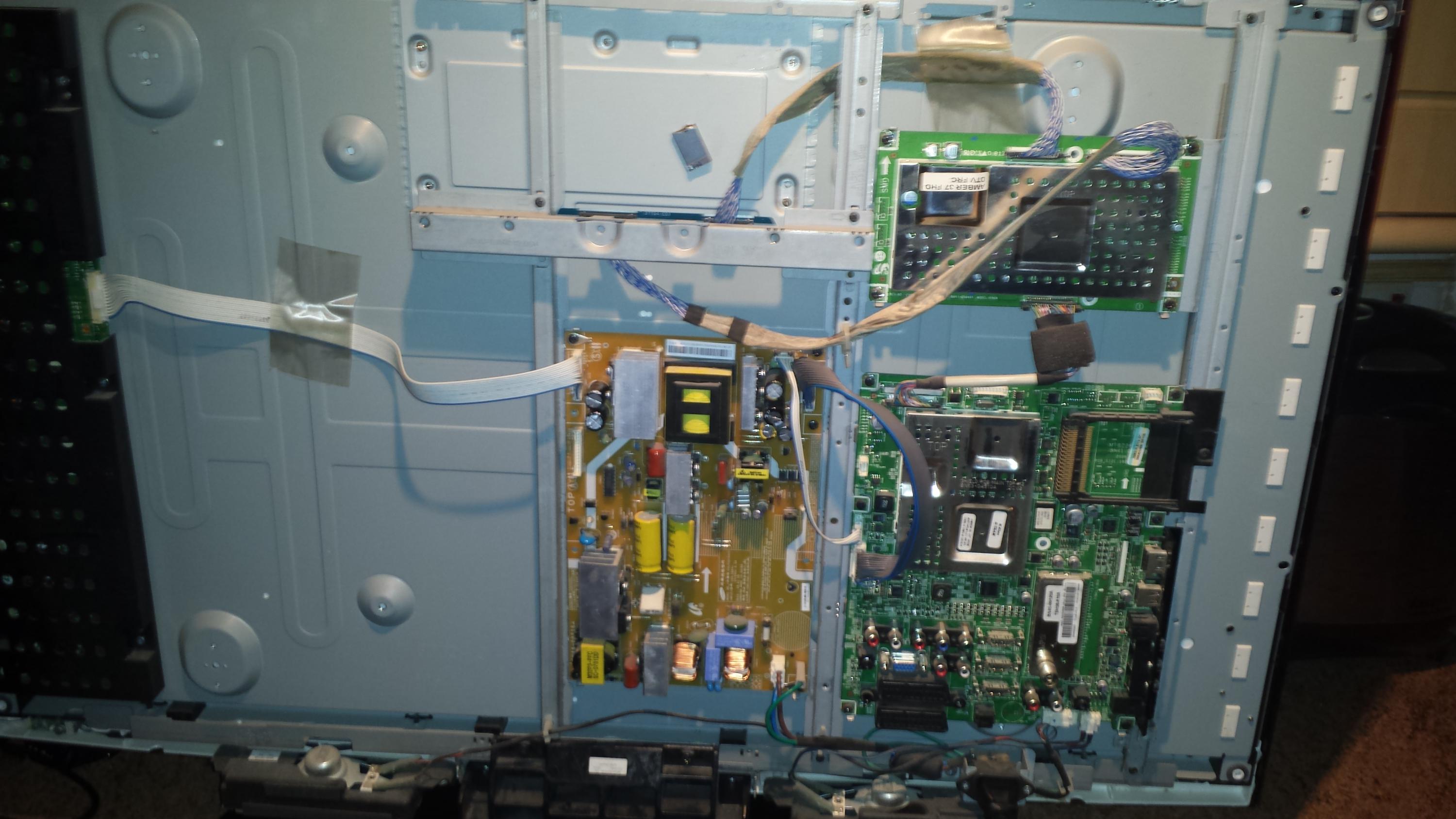

          nah m8 was given it so ill strip for parts cheers tom
            Don't strip it for parts immediately man; spend a few minutes diagnosing it! :P
            You can try cleaning all LVDS and T-con cables. Then check top t-con cables are seated properly. Check panel is not damaged (water/moisture) by taking frame off, as a last resort.
                Was looking forward to repairing this never mind
                  Is that how far you've got? Try checking for contamination on panel ribbon; check ribbon seated, see if it's getting too hot. But does look like another bad panel to me. Crazy, crazy.

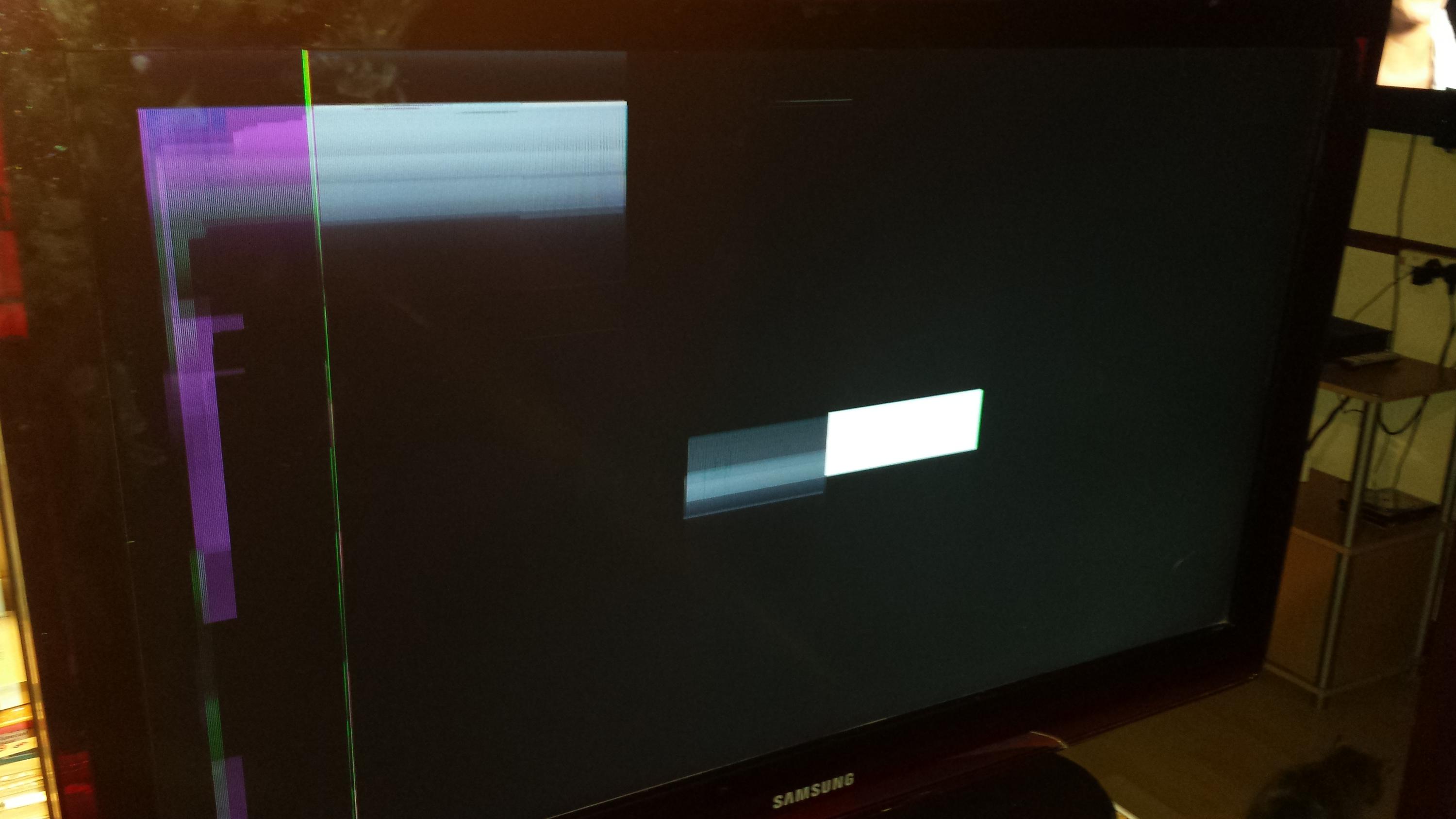

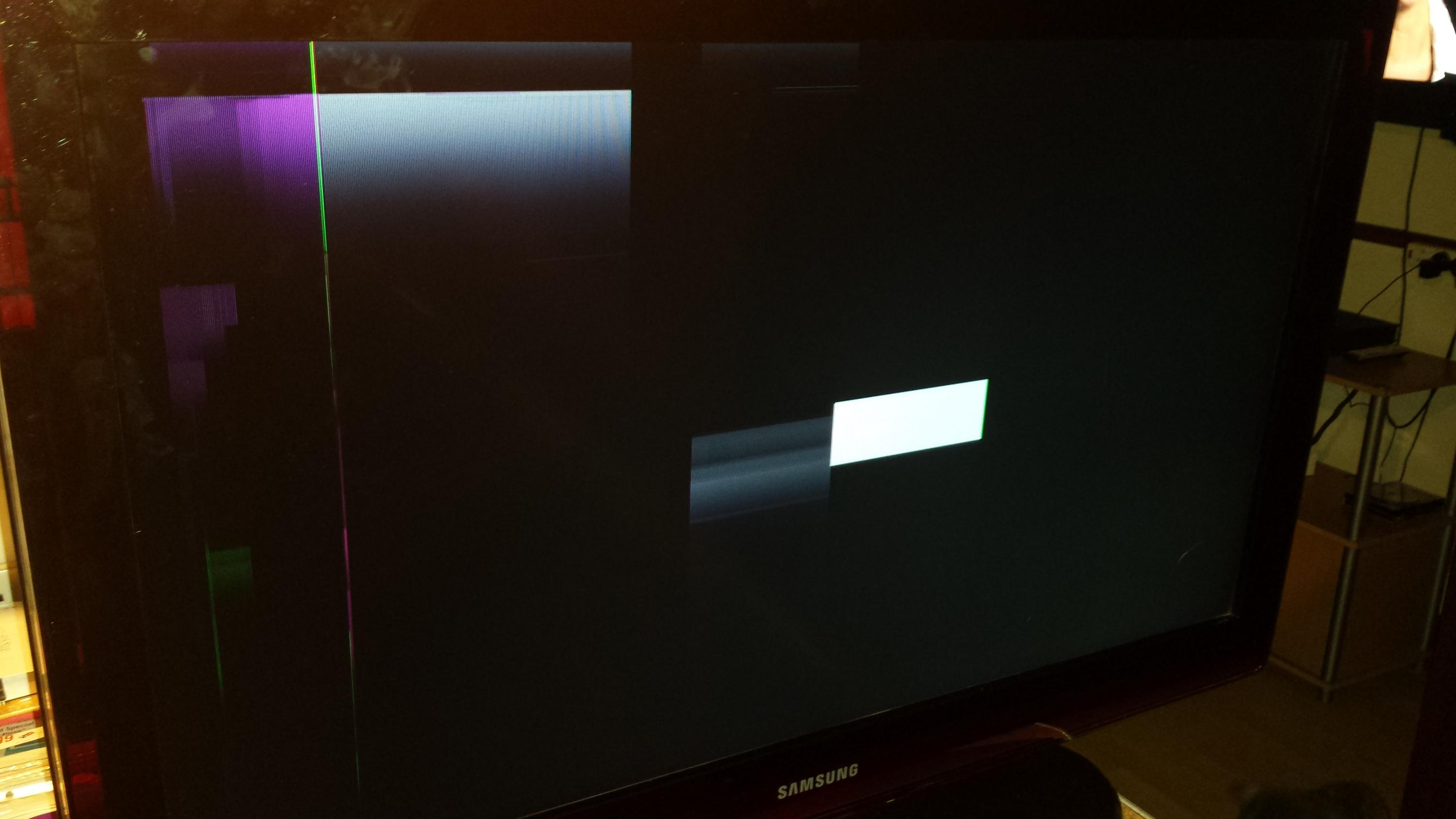

                    While we are on the subject of possible dodgy panels what you think of this one tom it's a LG 50pc56 4 lines showing
                      yep, dead panel...
