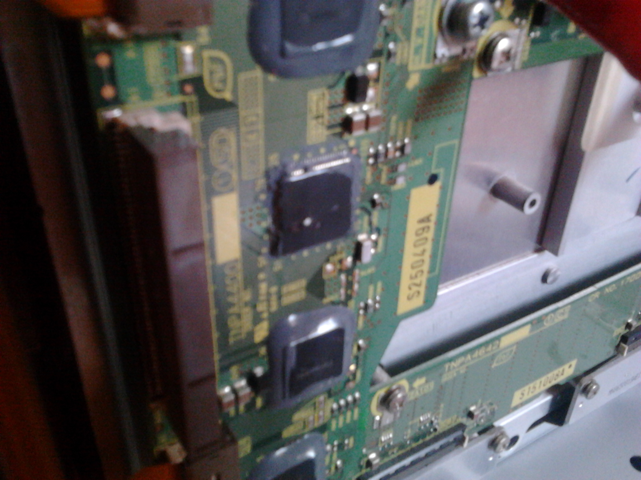

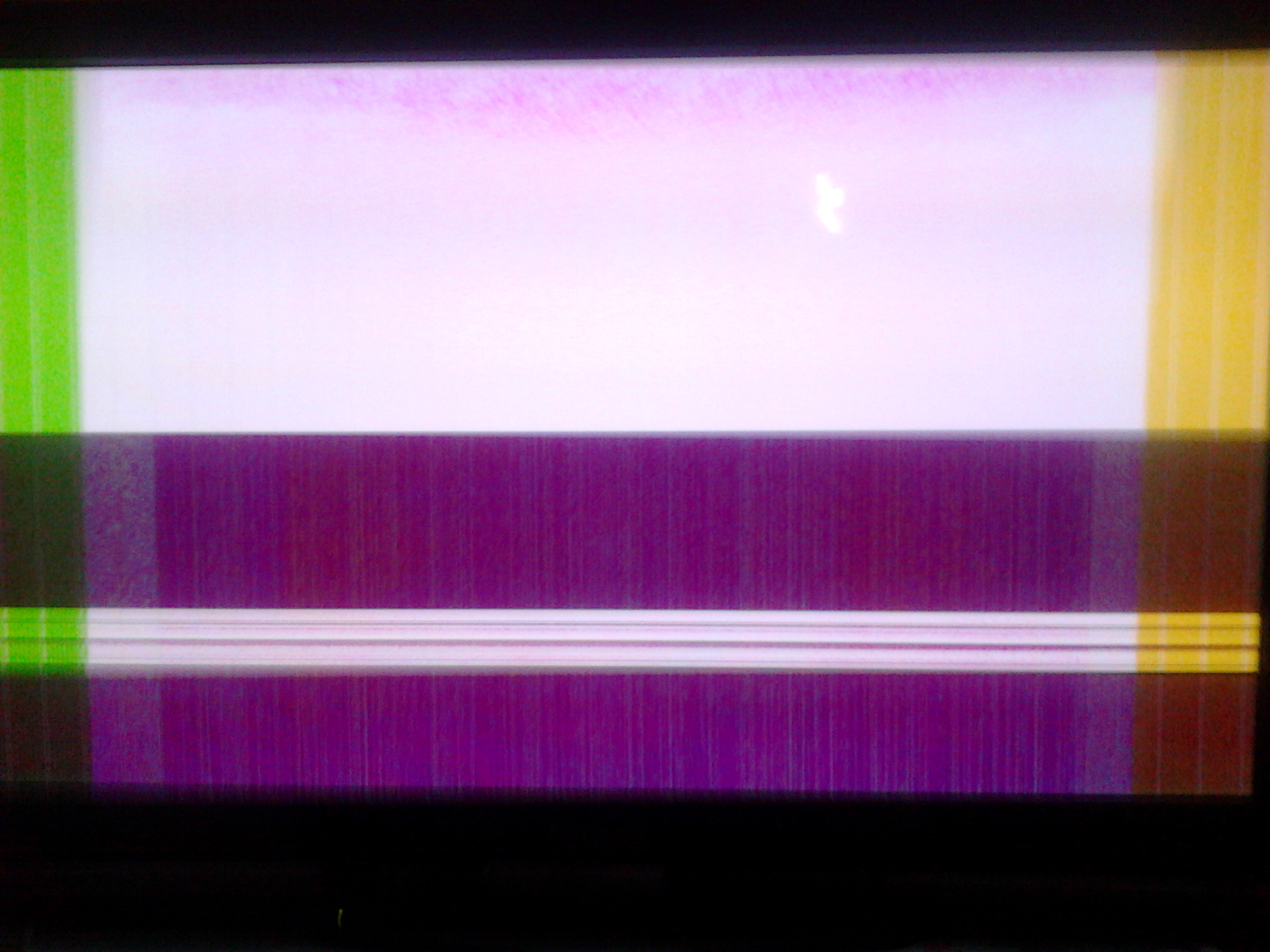

    So, I bought this TV at scrap value, with everything intact, boards and all. Previous owner said the TV was working and suddenly display became grainy/hazy, incorrect colors (magenta, pink, etc.) including the menu. He brought the TV to a local TV repair shop but was being charged USD500. So he just decided to sell it as scrap.
    At first when I powered up the TV, I got 7 blinks. Referring to the service manual which I downloaded from the internet, I tried isolating SU/SD boards to check if SC is defective.

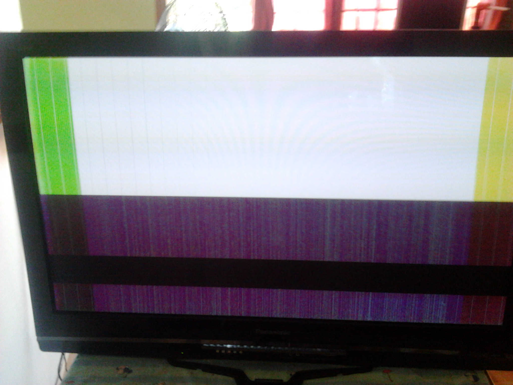

    I disconnected SCs 41,42 and 46 and jumper wired HV screw to L801. The TV powered, LED turned green, no error blinks, panel lights (Pic1).
    However, I smell something burning and found it to be coming from SD board's IC654 (AN16082A, Pic2, third chip from the bottom) and when I checked, it had burnt holes on top of it. Removed SD board from the TV and probed the connector for shorts in a zipper manner. Found shorts on that particular IC.
    If I power up the TV without the SD board (disconnected from the panel), I get top half of the panel lighting up. I can also let it light up for more than 10 seconds which is not possible for me to do if SD is connected to the panel (burning IC654).
    My questions are,
    Is my panel shorted in the lower half where the IC burns?
    Is it just a bad SD board where it is safe to just replace it and make it work?
    Does the SC board have something to do with the SD board chip failing?
    Can I disconnect panel ribbon where the defective chip is and safely power on the TV?
    These are the Part Numbers:
    SD TNPA4400
    SC TNPA4644
    SU TNPA4439
    Appreciate your inputs.

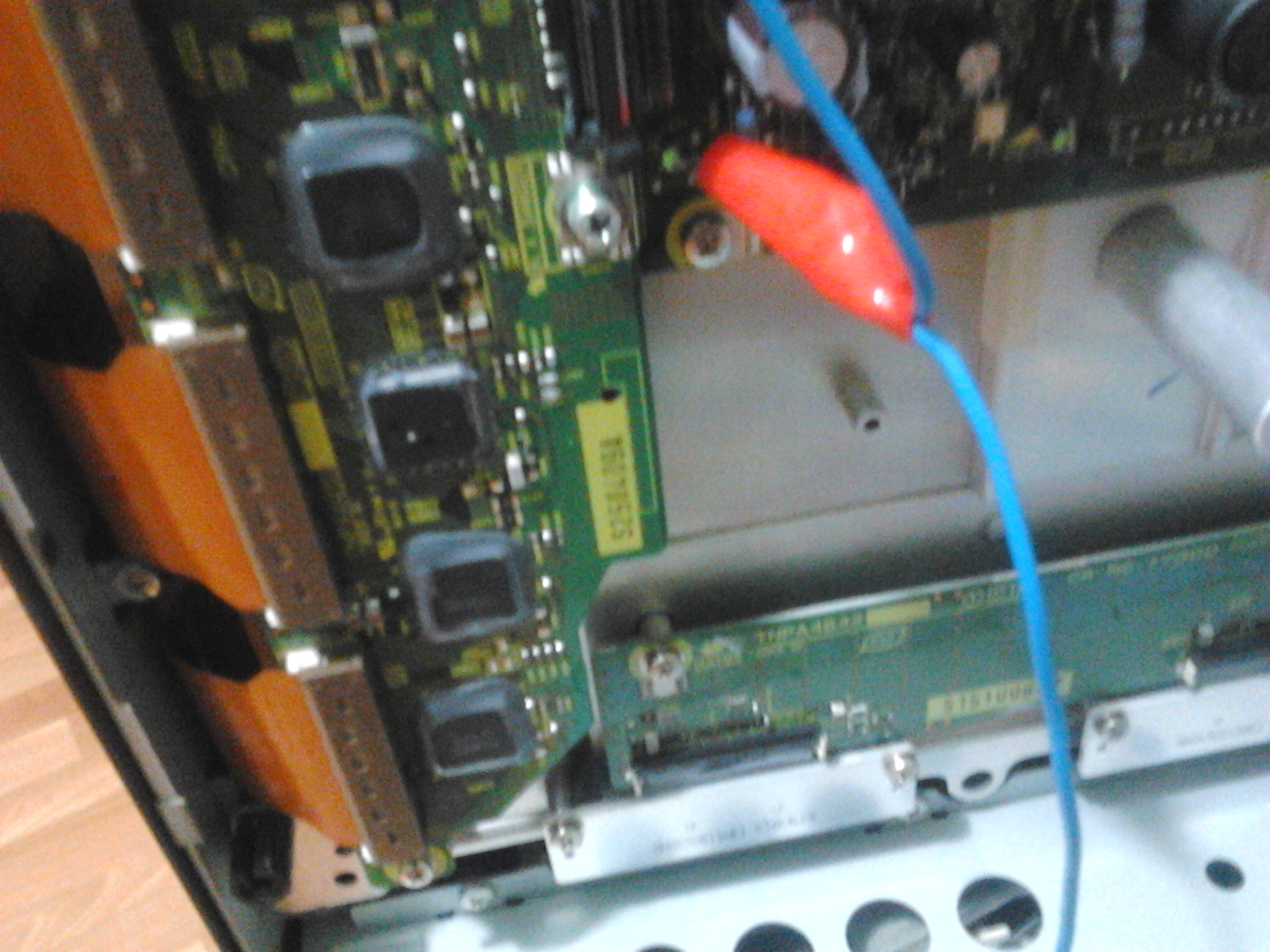

      Re: Panasonic Plasma TH-42PV80, 7 blinks
      Thanks tom66 for your inputs.
      Indeed, the 42PV80 is a well-built HDTV in its era, 2008. Actually, its is an HD G11 Panel (MC106H30T11A) released exclusively for South East Asia and I feel lucky to have one which up to this date is flawlessly working. I think the equivalent model in the UK or US is the 42PX80 which has almost the same boards except for the A-board. Mine has 3 HDMI inputs, VGA, composite, component and S-video, SD card reader and a very good AR filter. It had this rising black level but I was able to restore by tinkering the EEPROM using an Arduino programmer (found in this link http://panasonic.mironto.sk/).
      Anyway, back to the problematic TV,I disconnected the panel ribbon wire as shown and I still get the burning smell of IC654 (AN16082A) which led me to conclude that there are no shorts in that specific area of the panel. The panel lighted up but with a black horizontal stripe in the area where the ribbon was disconnected, which I think should be the case. Notice how IC654 is about to pop out like an acne pimple?
      Is that chip getting power somewhere even with SC42 disconnected? The SD board is basically isolated from the SC board and the only way it is physically connected to the SC is via the HV.
      I’ve been contemplating on getting the SD board from my working unit to test it in this TV, but something tells me that this is a bad idea

        What you can try doing is lifting that chip off. Sometimes, this will allow part of the panel to work, but it will cut off around that bar (the drive signals for the panel are chained.)
        You will probably find if you measure Vscn it is measuring low. On some of these sets -Vad circuit generates Vscn too so a low Vscn would cause low -Vad. Check service manual (see my signature) for Vscn and -Vad set points.

          I'd say a bad buffer dragging the display down especially if that buffer IC is burnt or bulging. I'm little reluctant with these older models due to lack of experience with them and wary because of the possibility of a bad panel taking the SD out.
          Now that you have shown us the SD, I think the only way forward would be replacing it.
          If the SD is not too expensive and easily obtainable and you have one on hand I don't see the difference between trying your other board or buying one to try.
          Either you'll solve it or blow it in which case you would have to had purchased one to try anyway. Just you'll be without the other TV until you get another board.
          I am a little surprised with Pic1 seeing such a bright display with the SD/Su disconnected and the bands still in the bottom.
          Sorry but not 100% sure with what I see.

            hi tom66. I'll try removing the chip first as per your suggestion and see how it goes.
            hi tw2005, thanks for your advice. It seems the logical way to deal with the buffer board. I decided not to mess up with the working TV anymore and just purchase the board somewhere.
