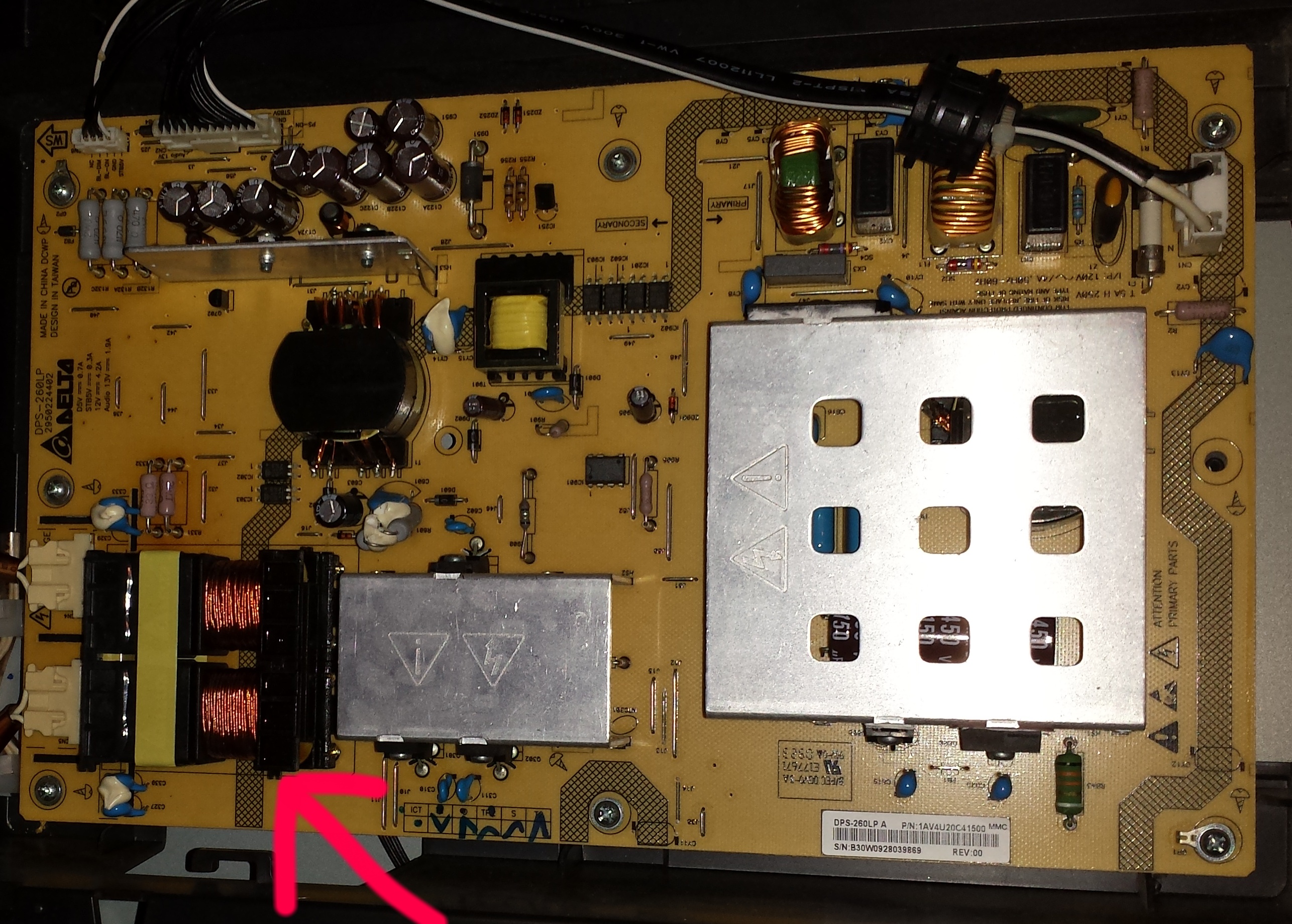

                                Re: Sanyo DP42849 - No Power At All
                                First had no standby, then replaced IC901, now have standby and green light when power button is pressed, but no picture, no sound, and no relay click.
                                So is it for sure the power board?
                                  Ok. So you are getting a turn on signal from the main. Have you checked the resistance on the big transformer?
                                  On the primary side check between pins 1 and 2 then between 3 and 4. Secondary side between 5 and 6 then 9 and 10. I have had bad transformers in 2 out of 3 boards I've encountered so far.
                                    Sorry, which part is the transformer?
                                          Originally posted by tw2005 View Post
                                          Does this lock out after 3 successive attempts to cycle power and the LED go out like the video.
                                          Yes. No relay click, tho.
                                          I don't know what that picture means.
