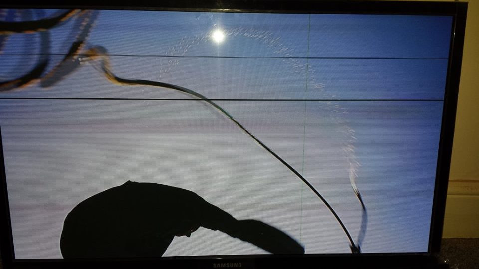

    hi guys
    my friends tv has developed these lines any ideas panel fault ?
    picture attached thanks

      Re: Samsung ps43e450a1w
      Top to bottom - Panel fault
      Left to right - Y buffer Fault
          Actually would have to say most likely both panel fault, not repairable. Samsung, that is ridiculous for a 2012 TV!!!
