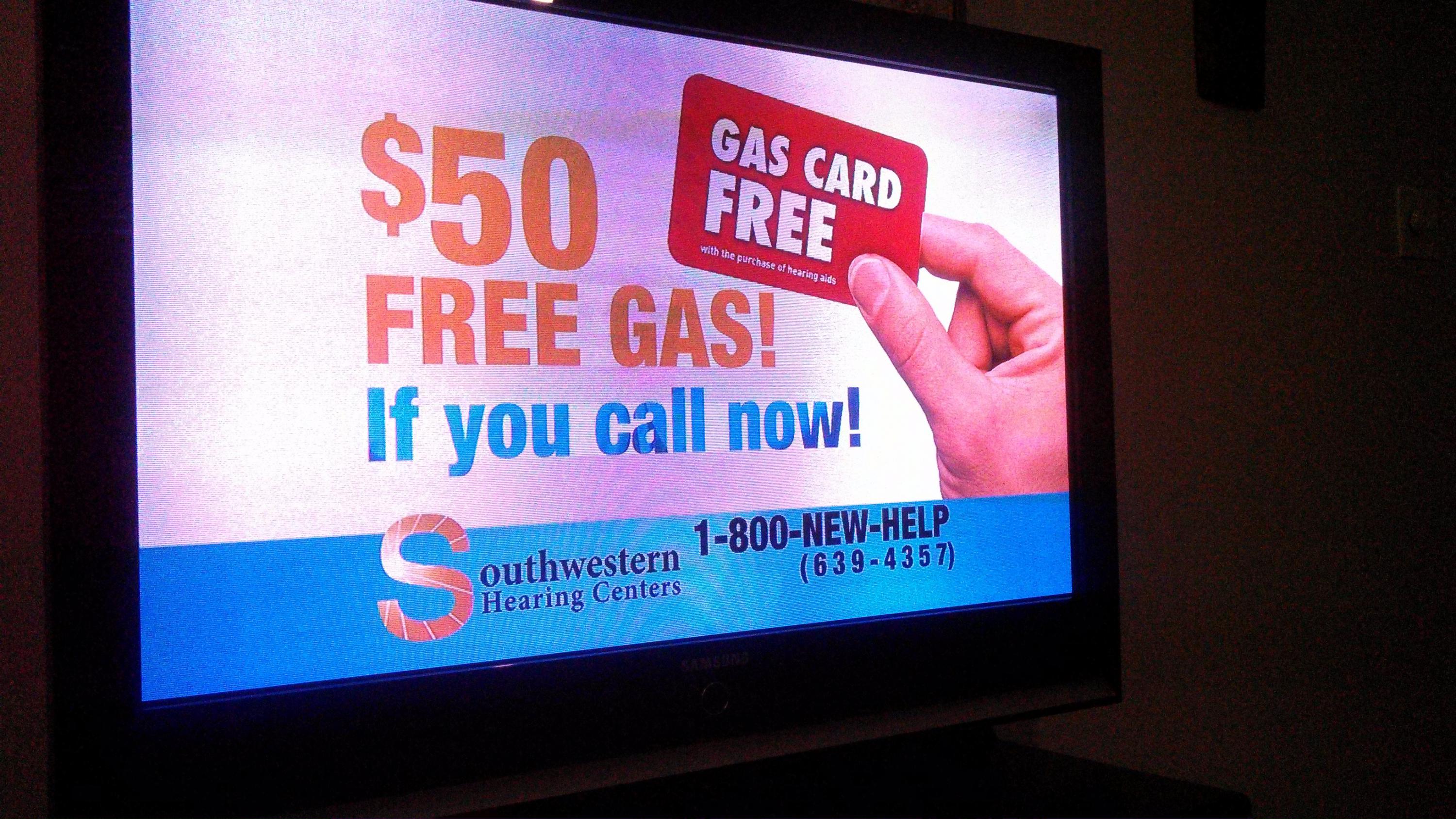

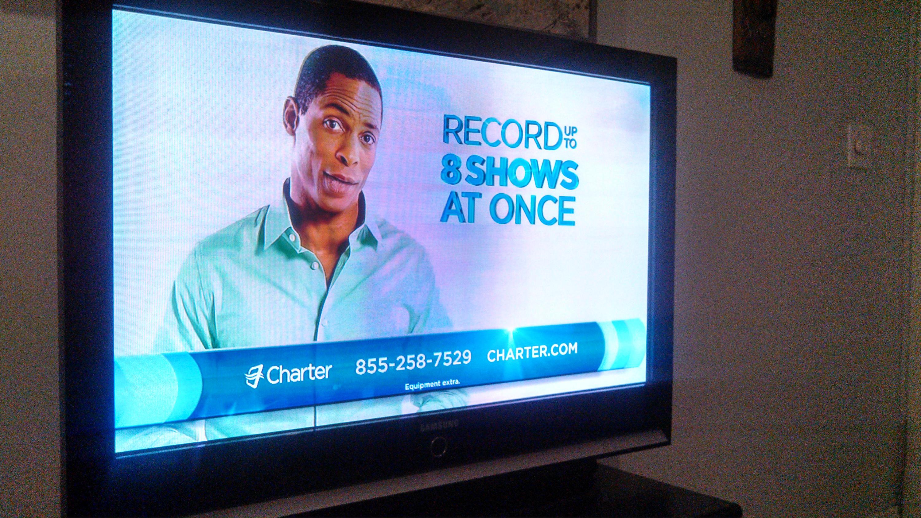

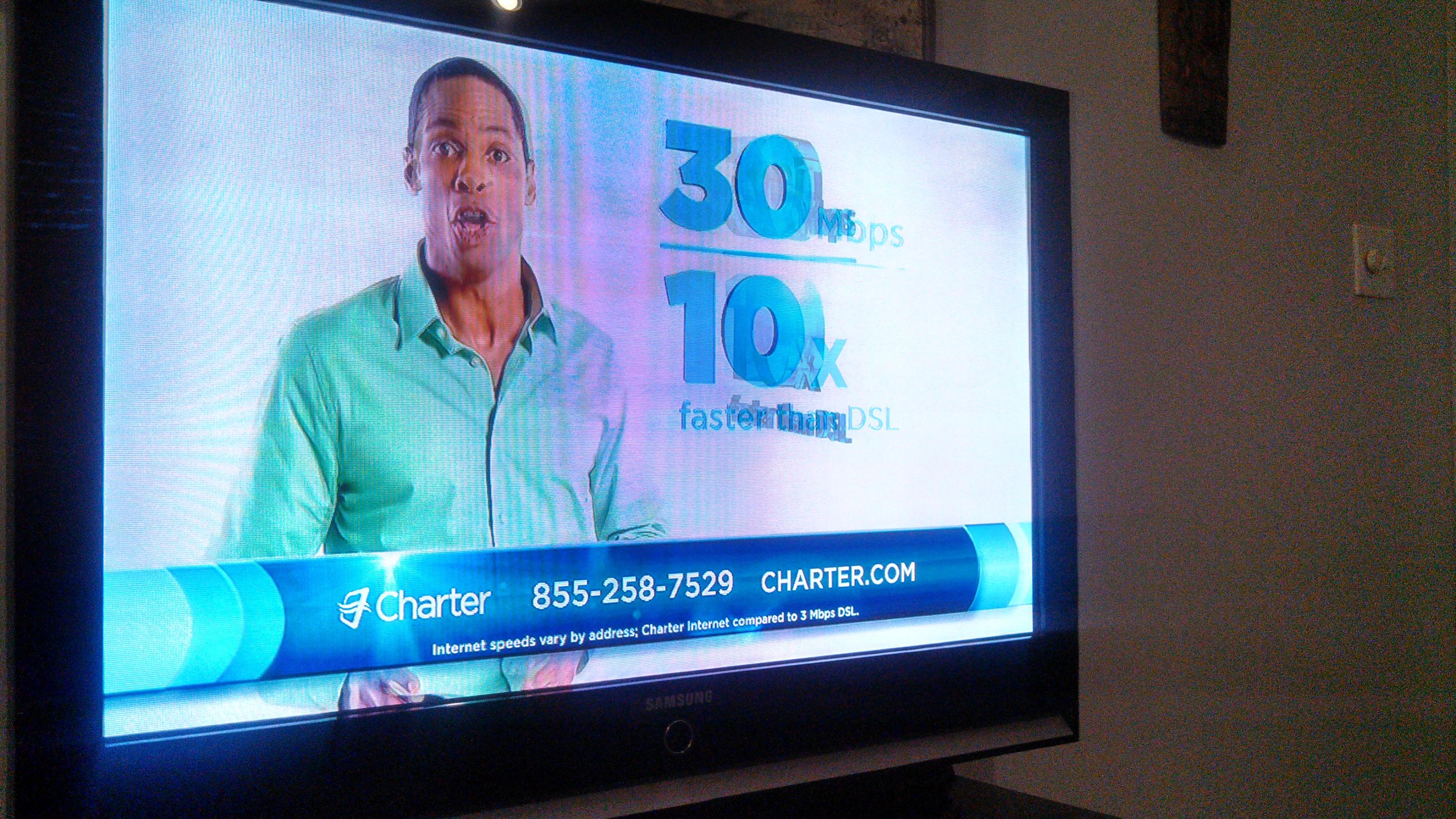

    I'd appreciate any advice : I have a pinkish band from top to bottom that covers approximately the center 1/3 of the screen. It is not straight lines of pixels but has almost fuzzy edges. In darker scenes it is not as noticeable but is very prevalent with a white screen.(see photos) I also notice residual "ghosting" of the guide or banners from other channels. Within the pink band picture tends to distort. I think it's getting darker as time goes on. This all started maybe 6 months ago. Inputs don't make a difference, factory reset seemed to help (for about 20 minutes), fuses all good, unplugged & re-plugged all ribbon connectors etc. No change. Is the panel shot ??
    Re: 42"SamsungHP-S4253PlasmaGhost
    Check all voltages coming out of power supply. Especially vs. Compare these results with the sticker on the panel.
