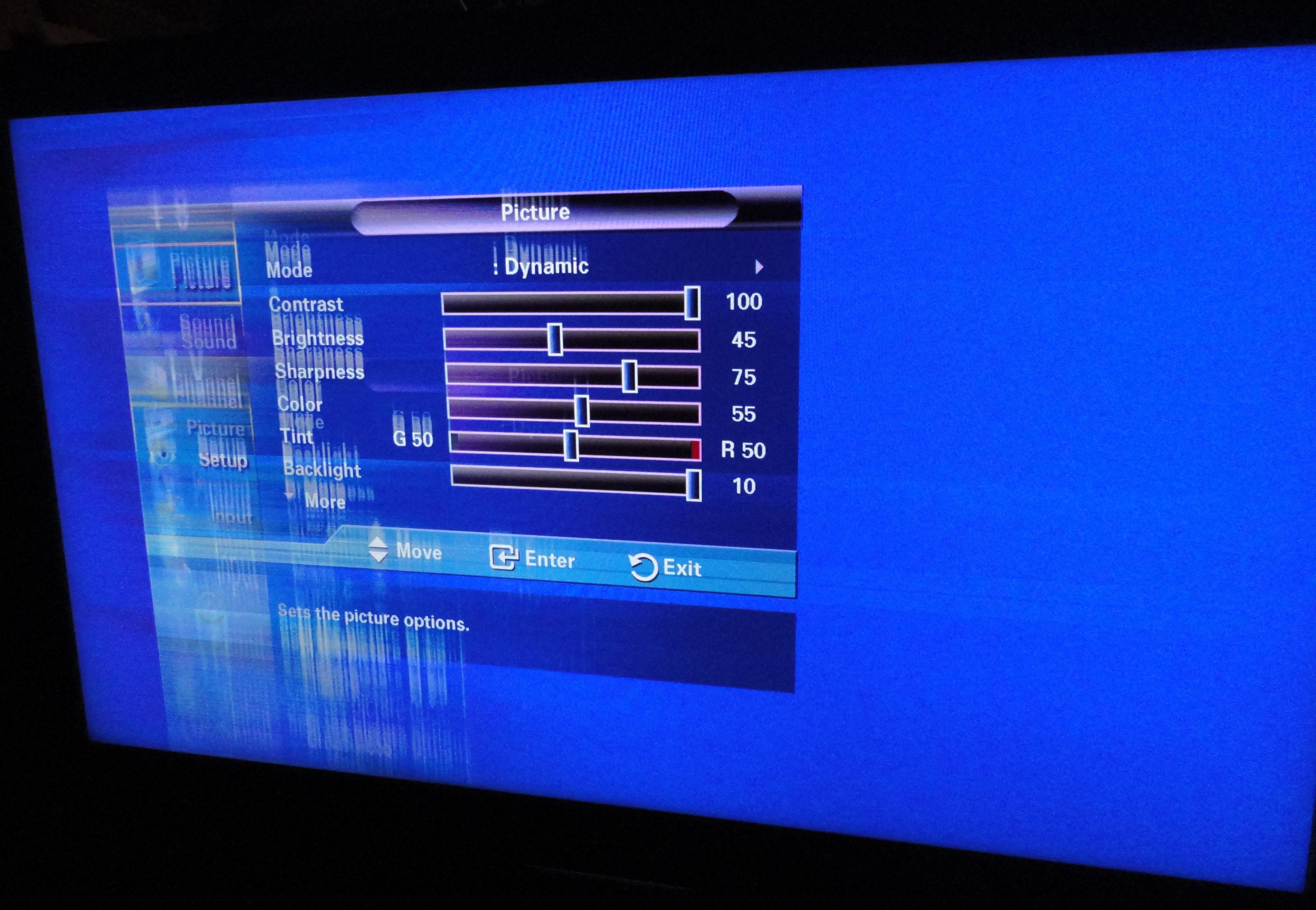

    Samsung LN-T4069F LCD with streaking
    I rescued this from the recycle center this afternoon, and haven't opened it up yet. What is your best guess for it's problem?
  • aaronwt6
    • Apr 2013
    • 855
    • US
    Re: Samsung LN-T4069F LCD with streaking
    Tab bonds would be my first guess. Possibly repairable.
      I would agree, generally repair success rate for these type of tab bonds is about 60% to 70%.
      • GoneGault
        • Sep 2013
        • 105
        Thanks for your help guys! I repaired the tab bond problem today and it is working great!
        • aaronwt6
          • Apr 2013
          • 855
          • US
          Wow. Nice work. And quick. Thanks for replying to let us know you got it going. Glad to hear it.
