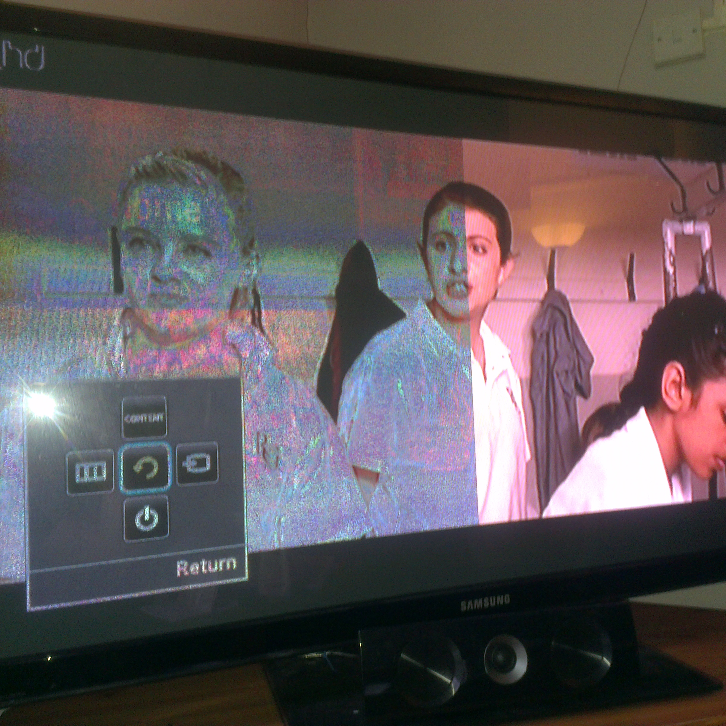

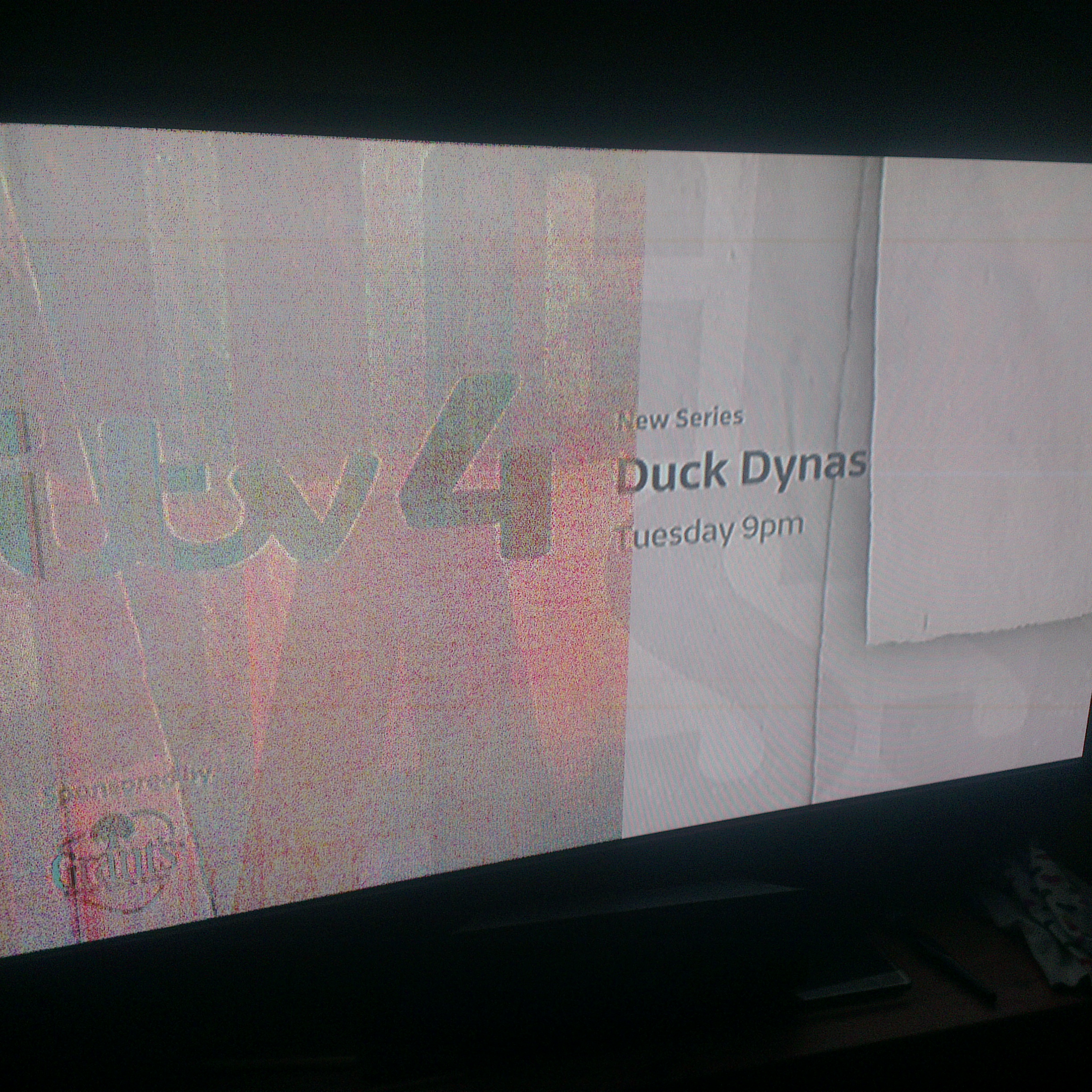

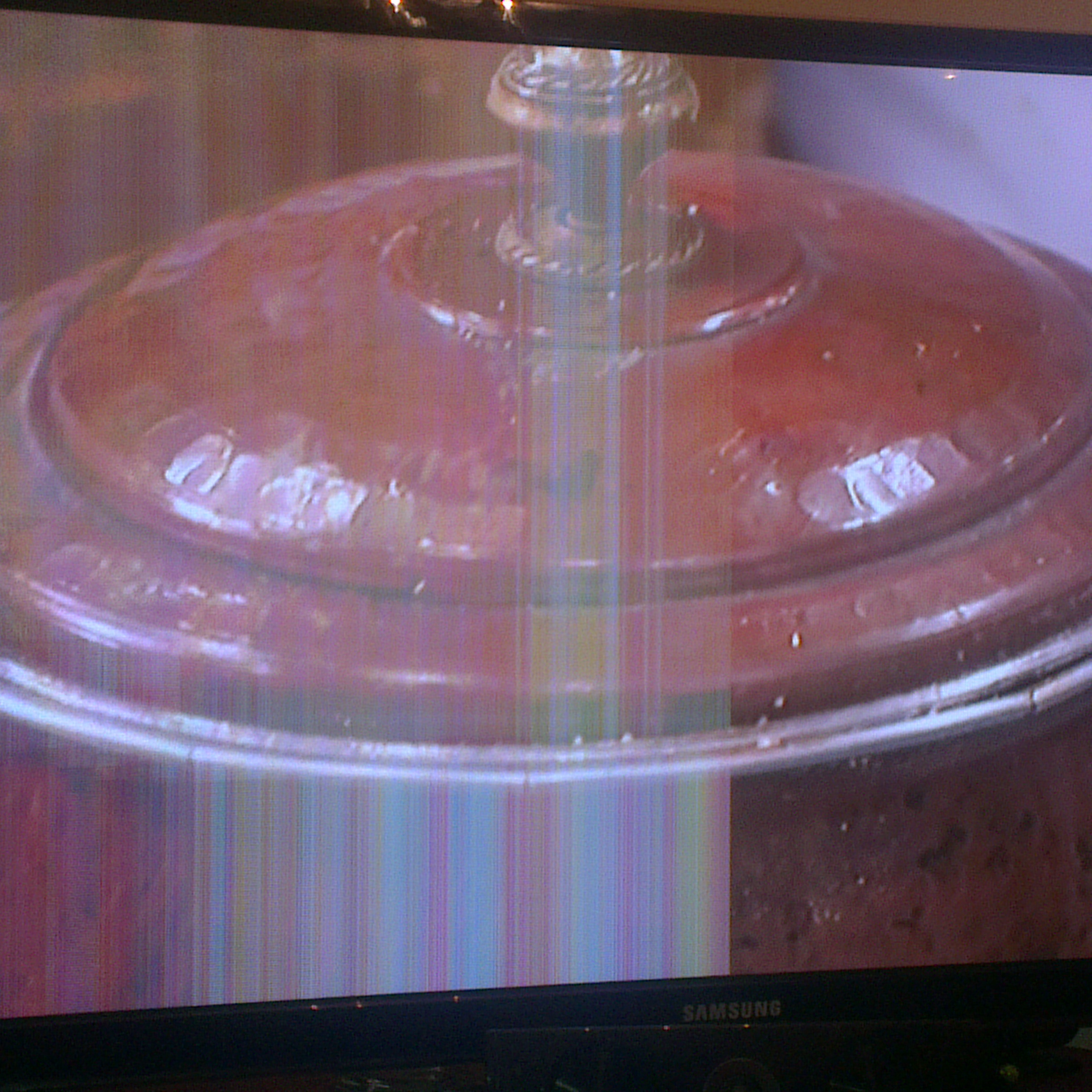

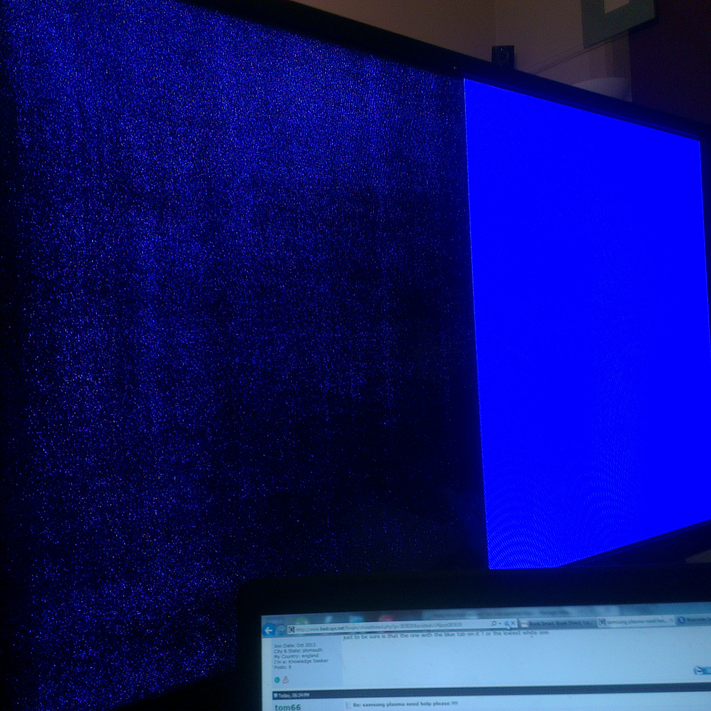

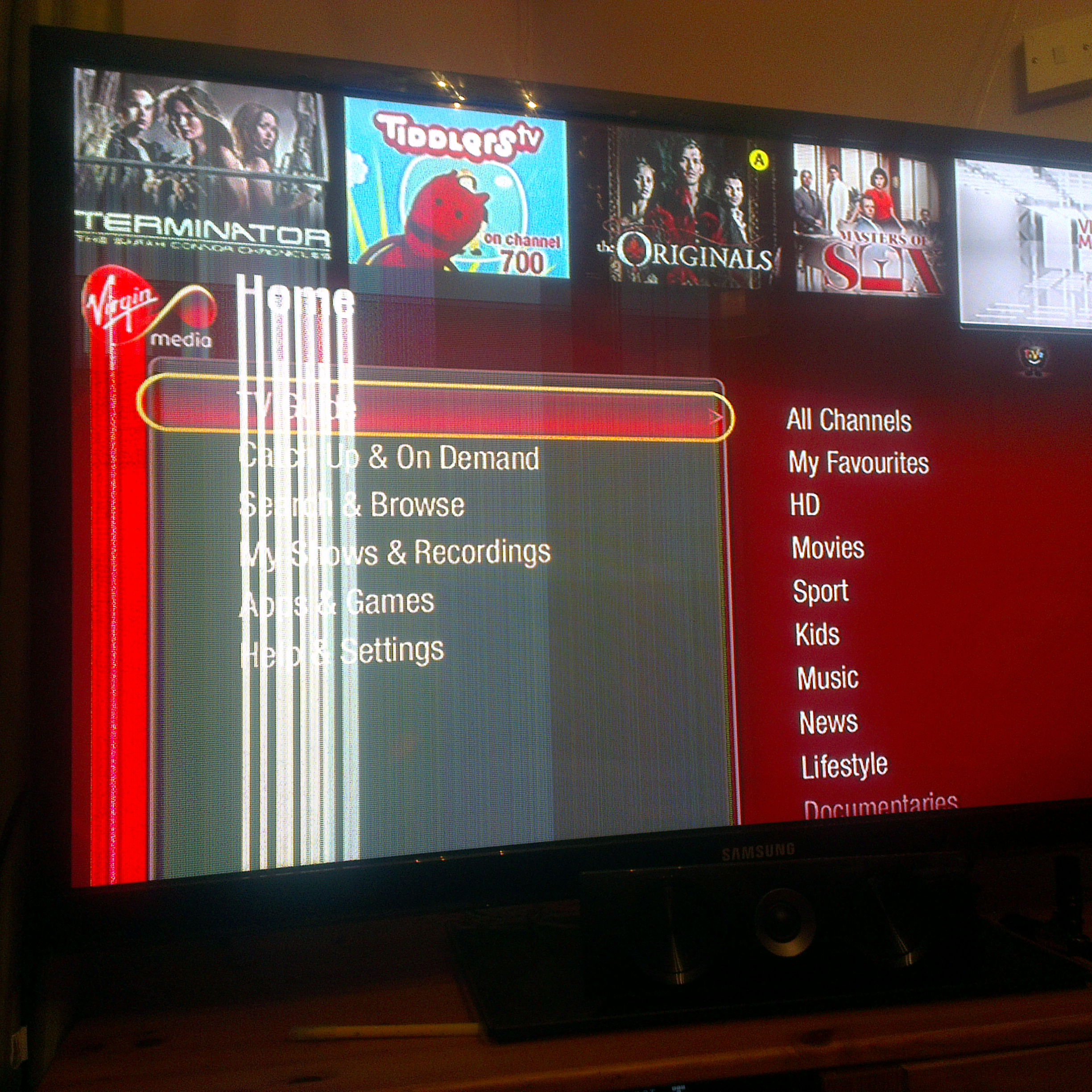

    samsung plasma need help please !!!!
    please help my samsung plasma ps50 has developed a problem that effects only the left side of the screen lots of fuzzing and lines which change according to the picture displayed and is on all inputs

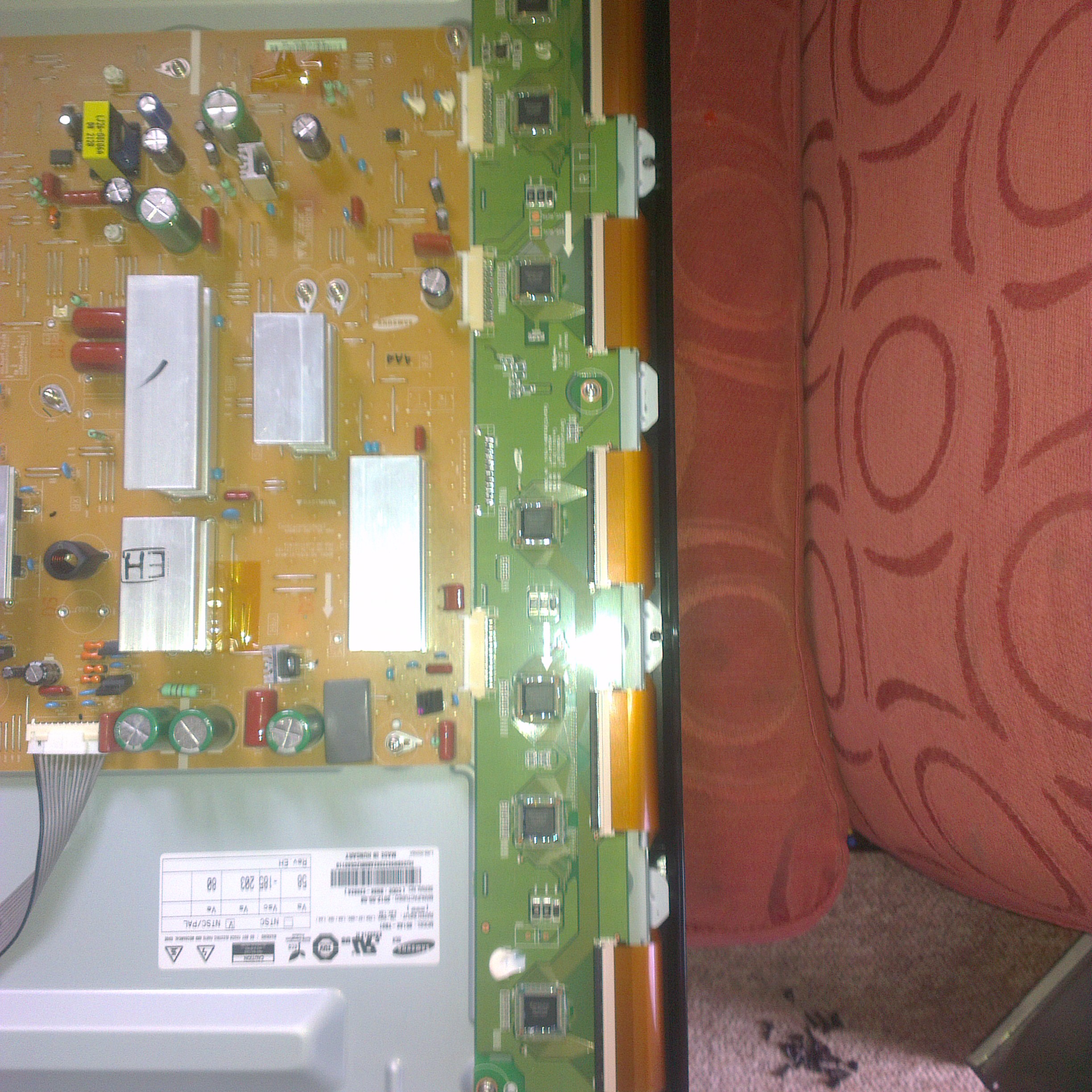

      Re: samsung plasma need help please !!!!
      had the back off today and gave it a good blast on the connectors but no change have taken pics of the boards to the left and right

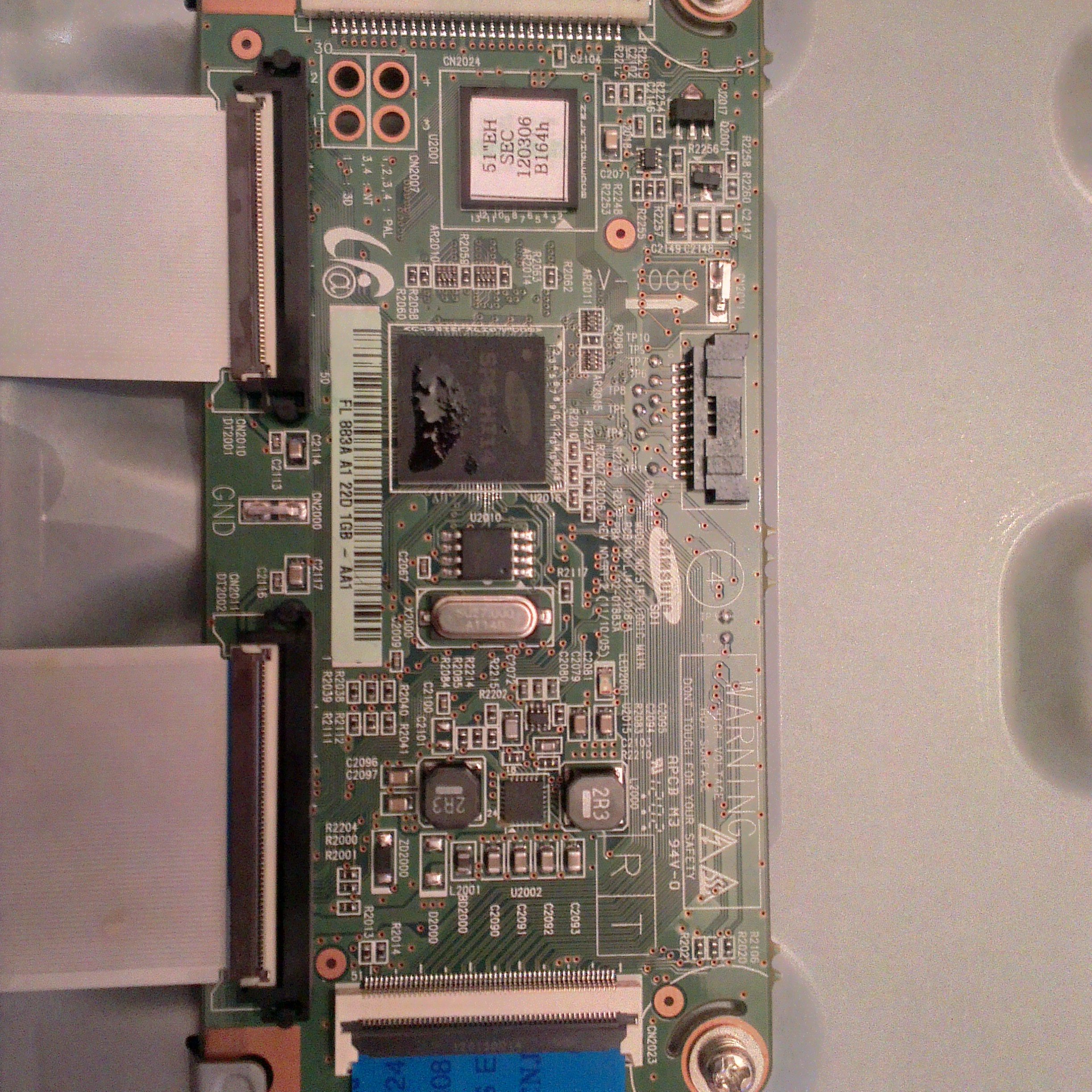

        Looks like an E5xx-series Samsung? That is only 2012 TV! Wow. Early failure...
        I need a look at the board to the left of this photo, where the white cable comes off the main board.
          i know just a month or two outside of warranty is this the board
            Yes, on the left. Need a closer picture of that.

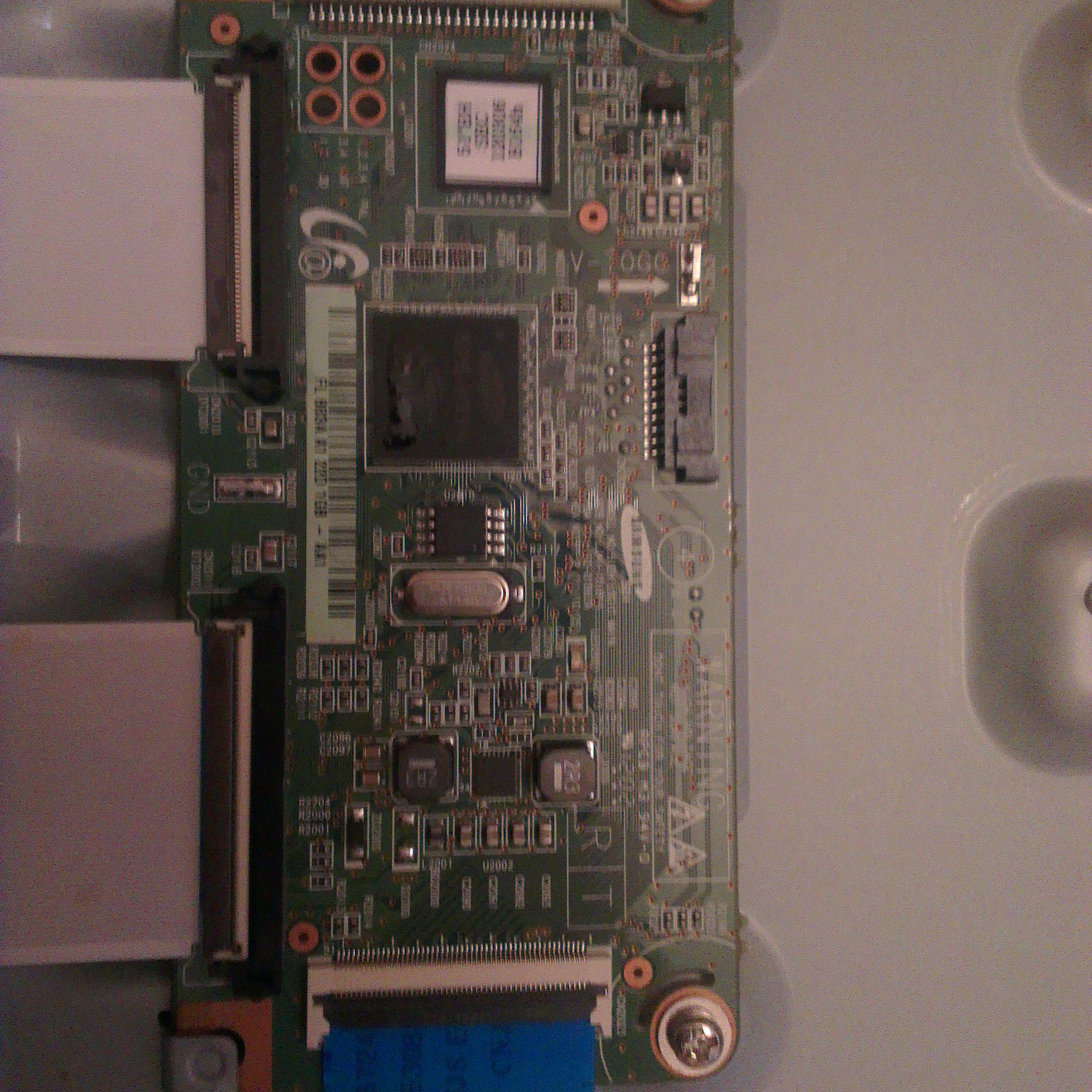

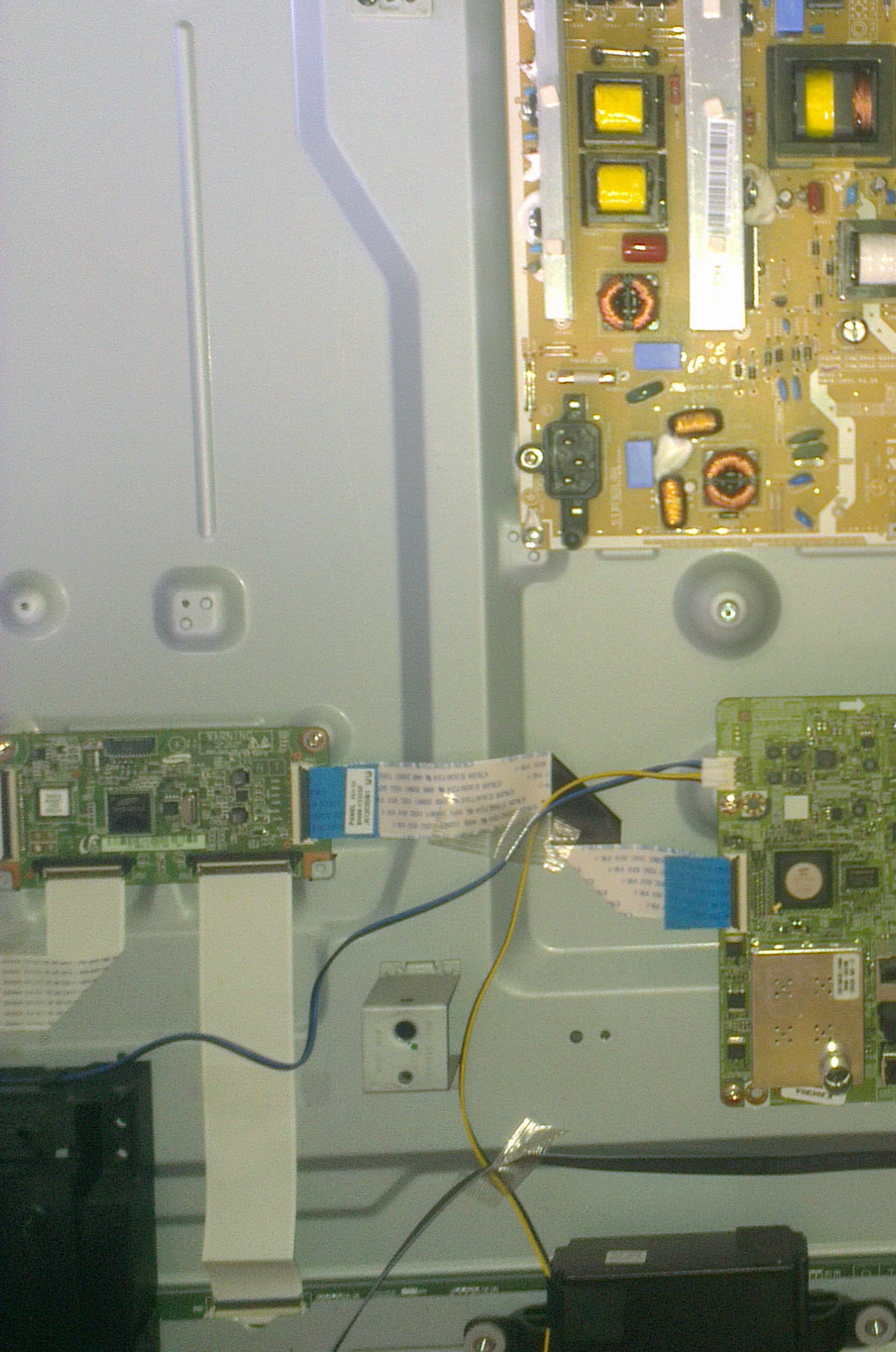

              hope these are ok. The stuff on the black square in the center is where my cat has sprayed the rear of the tv wait till i see him next
                Cat pee can cause a lot of problems for electronics, is that before the problem occurred or just now?
                Do you see those four copper plated holes top left corner of this image?
                https://www.badcaps.net/forum/attach...9&d=1382462412
                You need to take a piece of wire or a crocodile clip and connect the holes marked 3 and 4, then unplug the bottom most connector (on the same image.) Plug TV in and you should see test patterns, are they still distorted? (Note, make the connection changes while TV is unplugged then plug TV in to test.)
                  just to be sure is that the one with the blue tab on it ? or the lowest white one
                    Blue tab yes.

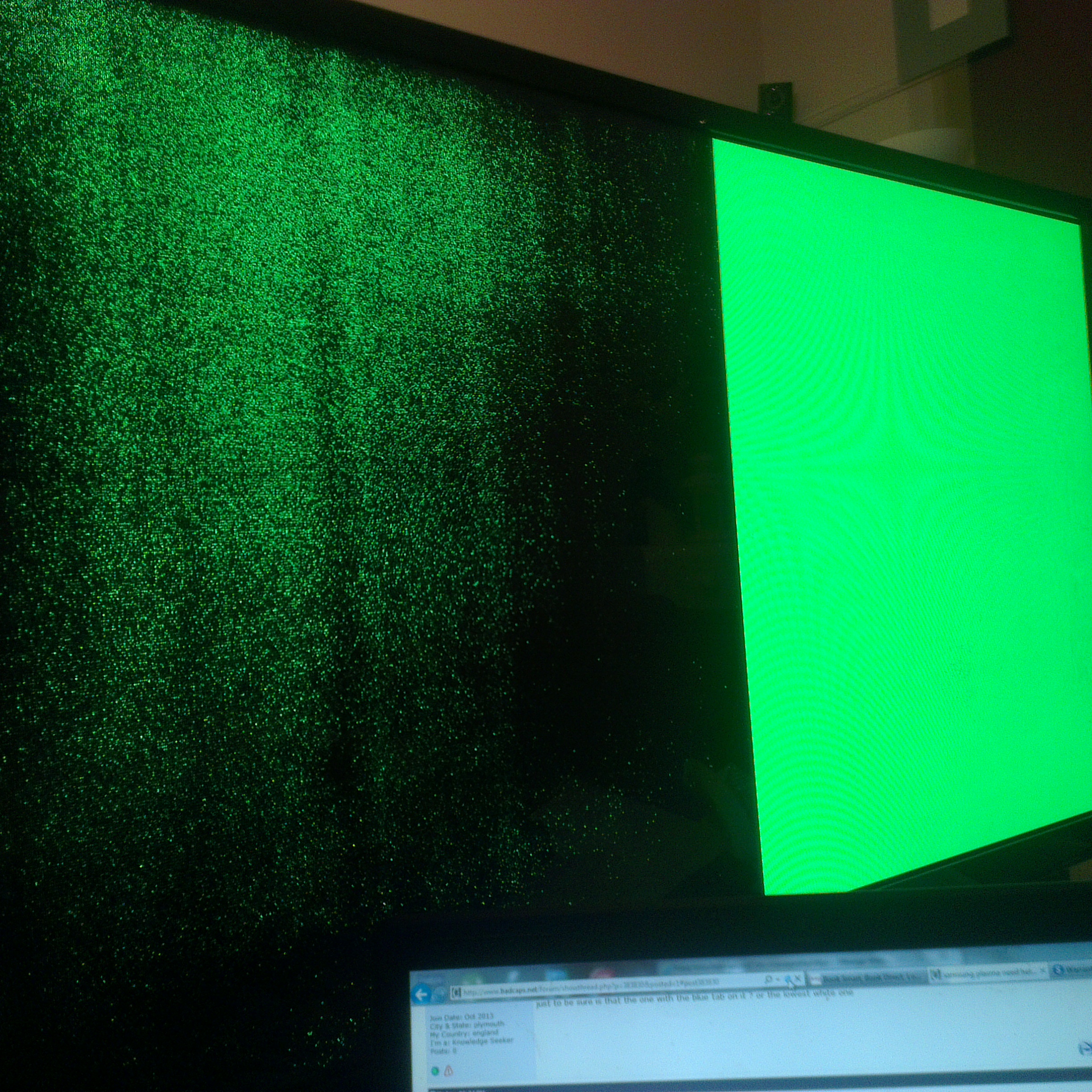

                      yes distorted on all colours cant see it on the first screen which is plain white
                        OK, this indicates a control board problem or bad C buffer board.
                        Unplug the power to the set.
                        Reseat (unplug and re-insert) the left two white connectors. Same image as before
                        Trace them to the other end -- the C board. Reseat them there too.
                        Same issue?

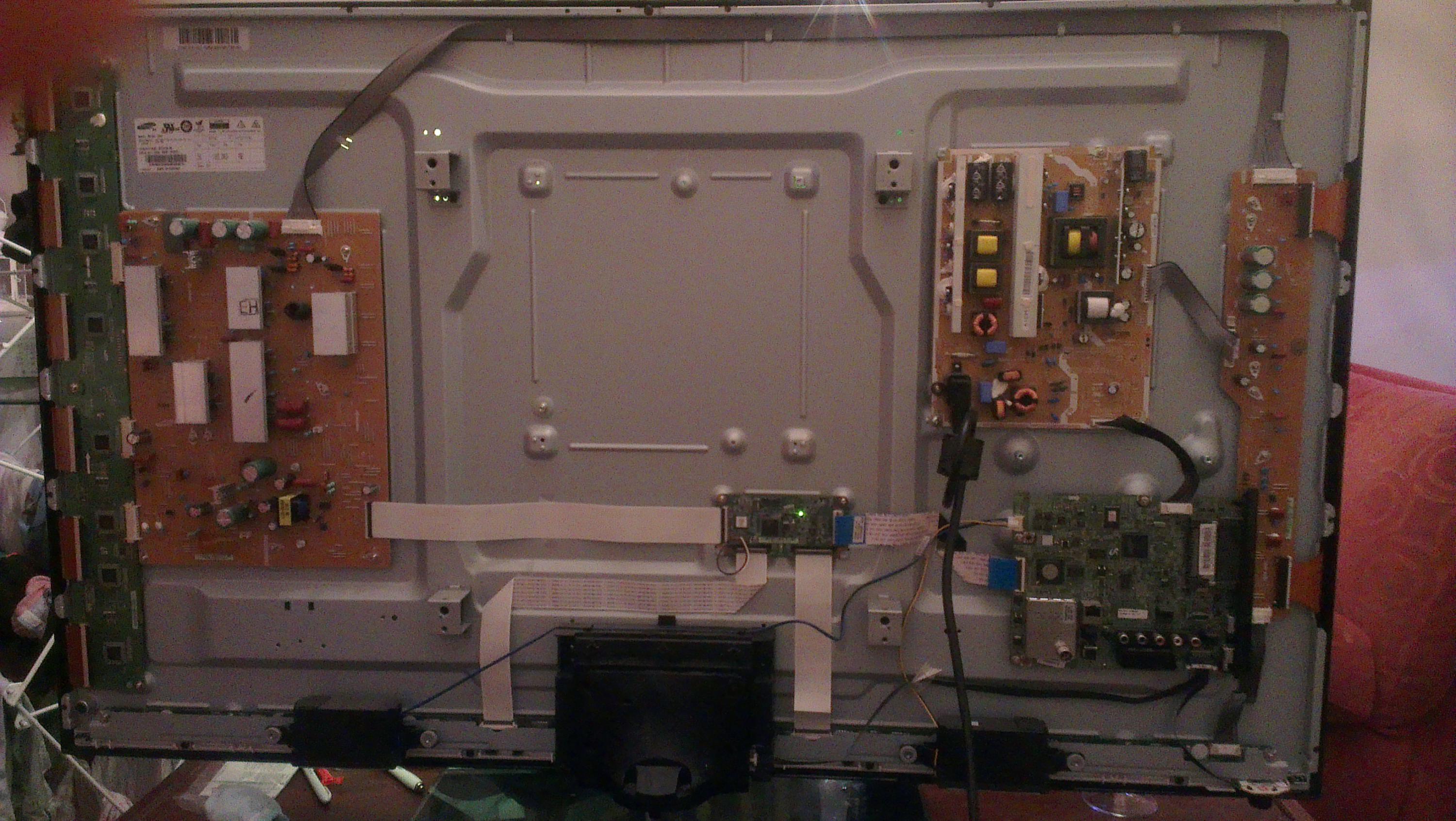

                            OK, can you post one large picture of the whole chassis? I have one last theory that it could be a loose Va (C-buffer power) connector. If not you will have to replace the C buffer board (this is NOT the same as the Y buffer board...)

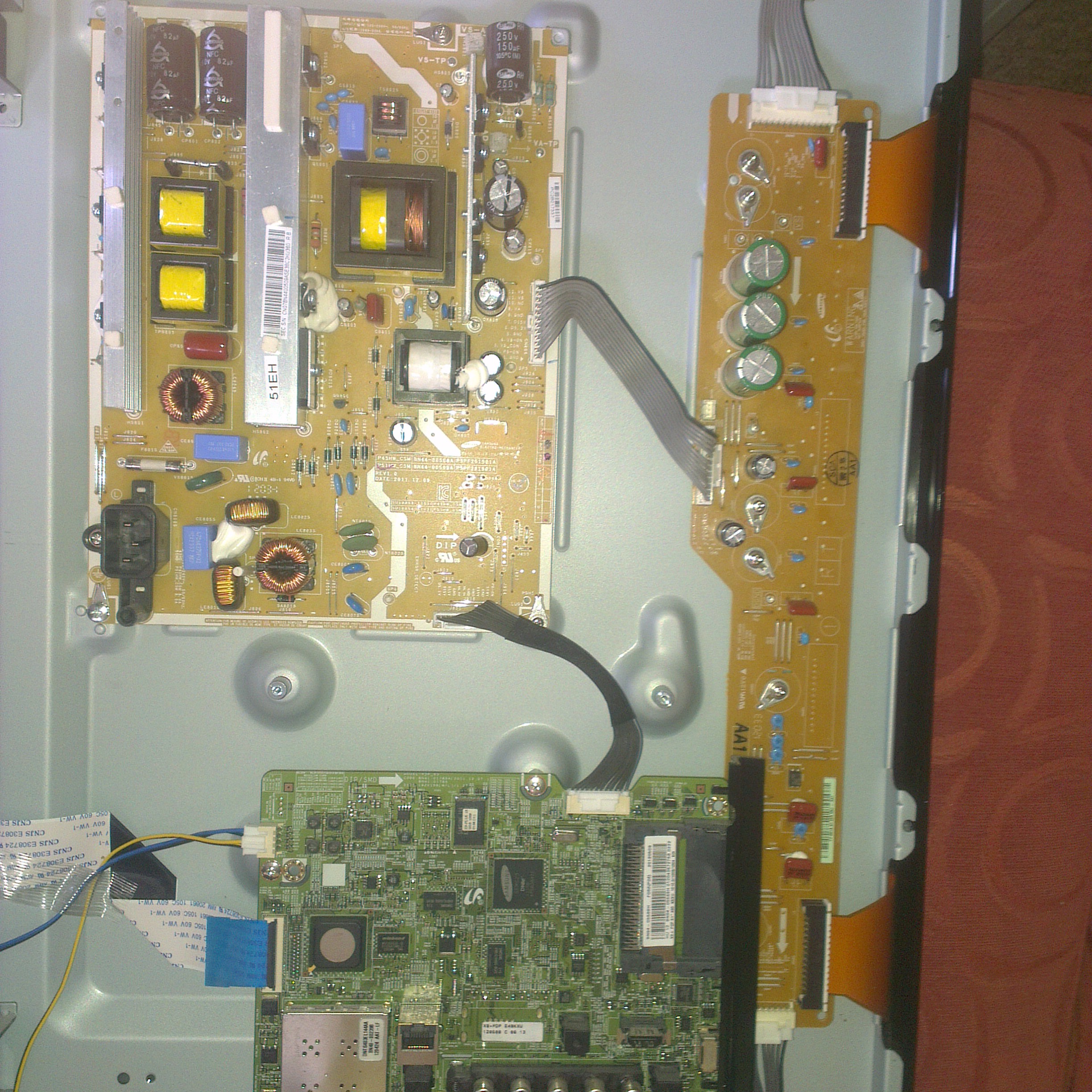

                                Looks like the power comes in to the right hand C board and goes to the other board. Had hoped this was like 2011 panel where it came in from the left. Anyway I think the only solution is to replace the right hand C board. This is also sometimes called the F buffer board. Shouldn't be too expensive to replace.
                                If you cat did pee on the control board, I would also suggest you replace that just in case.
                                What is the full model number of your set for example PS51F480.

                                    I just checked. The E & F buffer boards on your TV are bonded to the screen! They cannot be replaced. The only hope is maybe a control board would fix it... but if not, then the TV would have to have the E/F board directly repaired (at the component level) which may or may not be possible.
