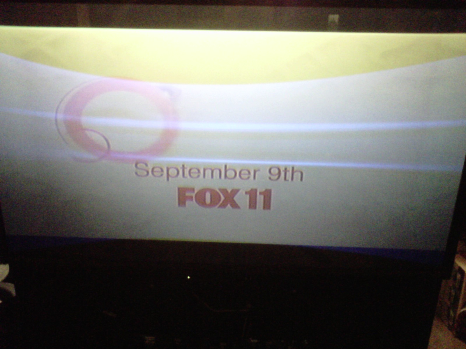

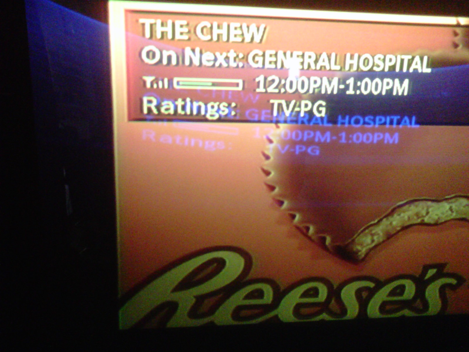

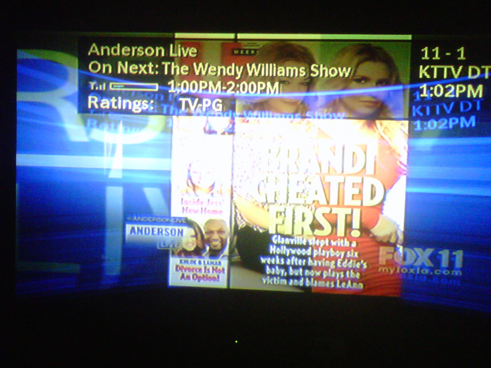

    hi guys my tv has bowed ... i recentlyreplaced the caps on the dm board after a neighborhood power-outage left my tv blinking....
    2 months later the blue light bowed ...
    i will try to include pictures

    Re: Mitsubishi WS-65611... has blue bulb bowed,,
    here are the pics
      Convergence amplifier for the blue channel has failed, it is replaceable (STK module.)
