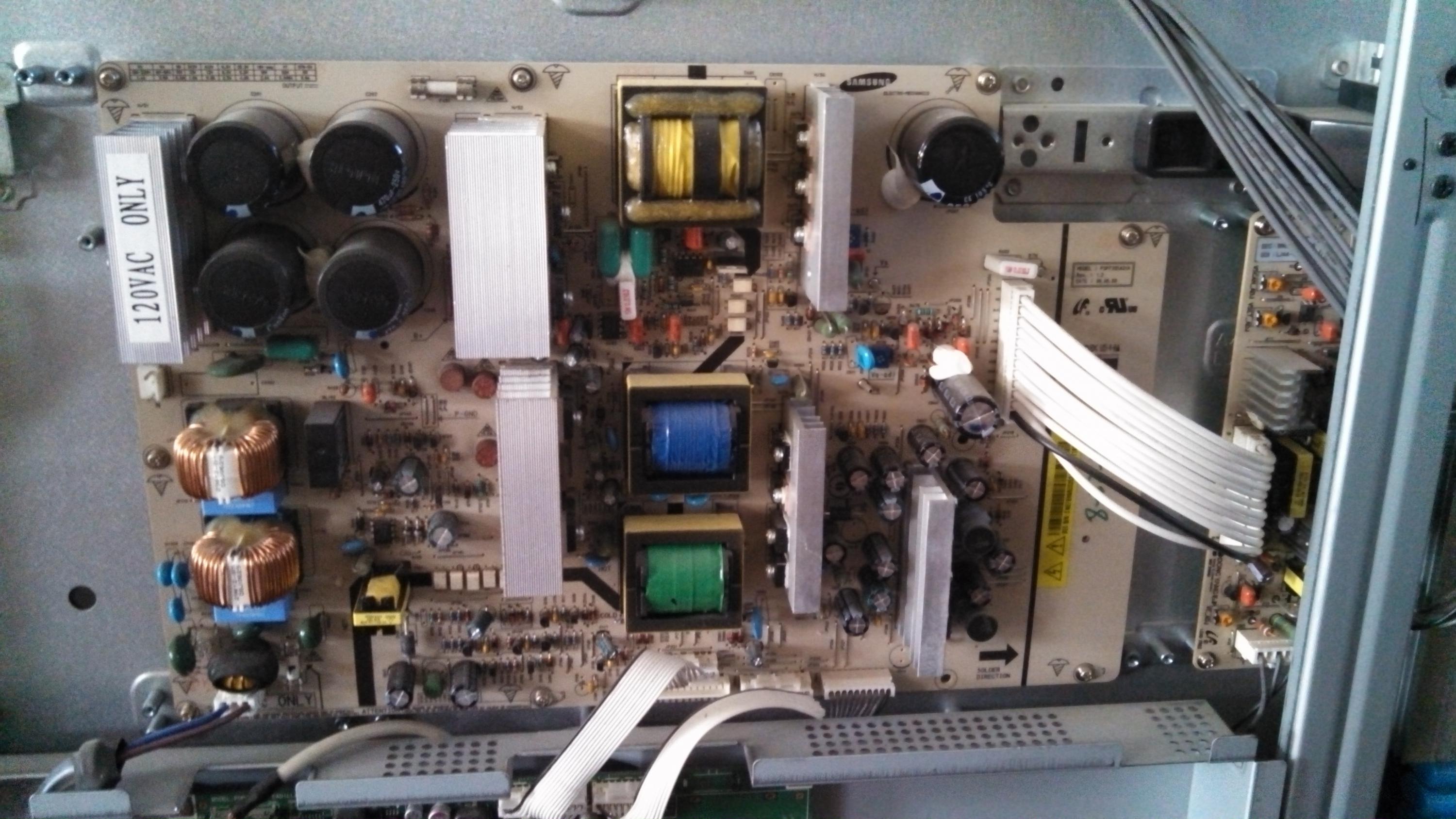

Samsung HPS4253 is having a Blue Sparkle problem I Think. When you first turn the TV on and there's no component currently on and it's the blue screen(no component Screen) there's static in the corners of the TV. When I Do turn the cable component on there's no noticeable static at al. After a while of use I start to get this blue sparkle (maybe blue snow) effect in In the corners of the TV. If I turn the TV off and turn it back on the Blue Sparkle is gone. It seems to only happen when the TV has heated up for awhile and has been used for awhile. The time period of use where this Blue Sparkle happens does vary. I've done some research and have heard that maybe this is a voltage problem. I was wondering if you could help me finding a solution
Samsung HPS4253 Blue Snow/Sparkle
Re: Samsung HPS4253 Blue Snow/Sparkle

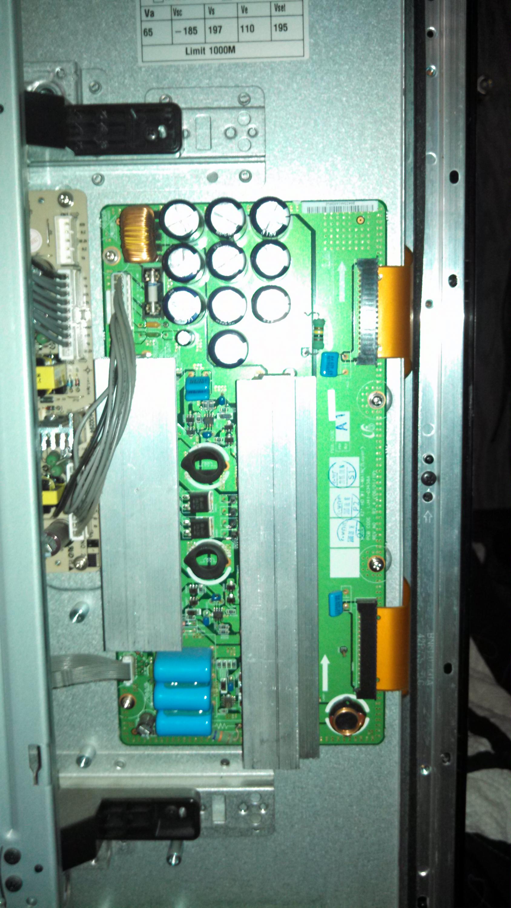

This is probably related to the Vs, Vset, Vscn voltages or the Yrr/Yfr timing adjustments. Pictures of the boards inside your TV would help. Do you own a digital multimeter?Please do not PM me with questions! Questions via PM will not be answered. Post on the forums instead!

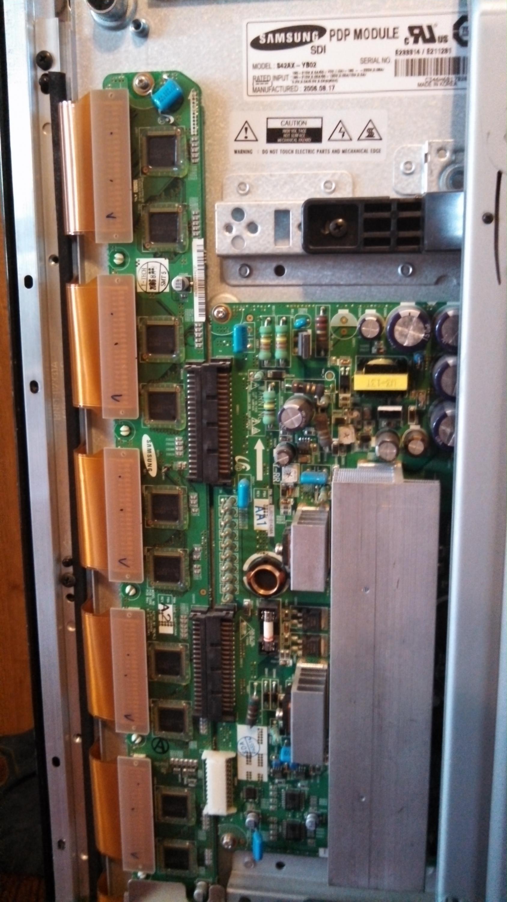

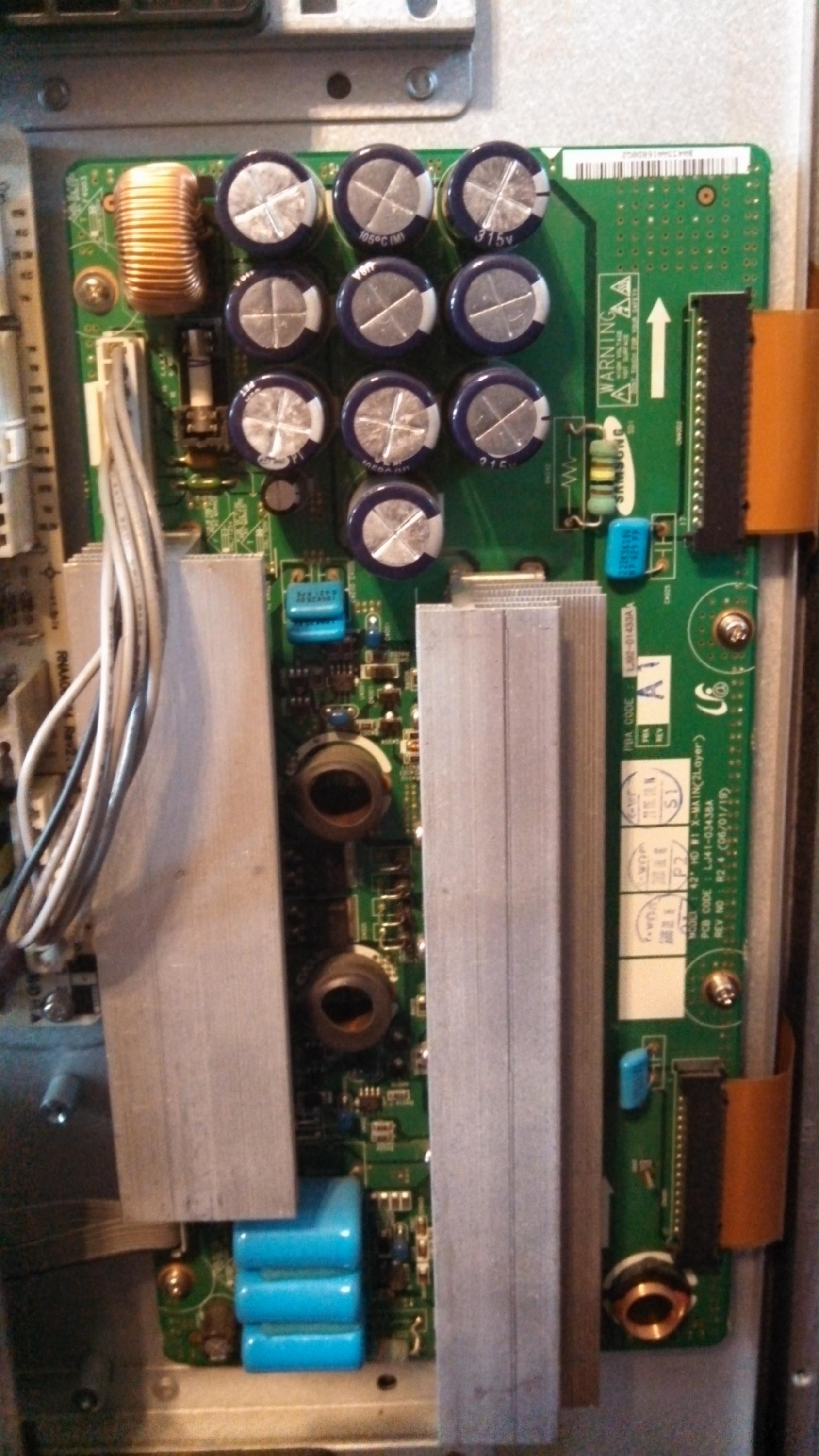

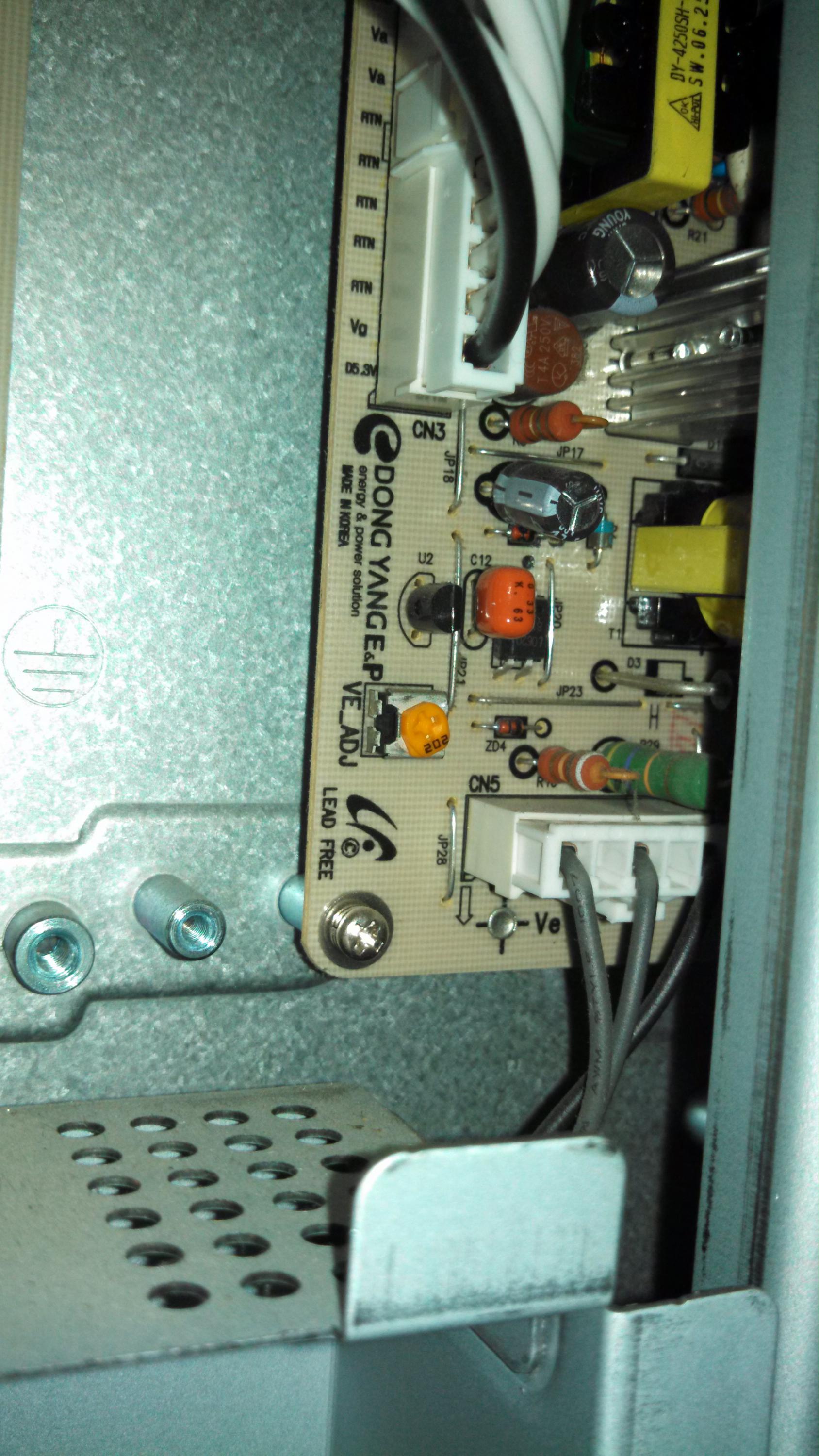

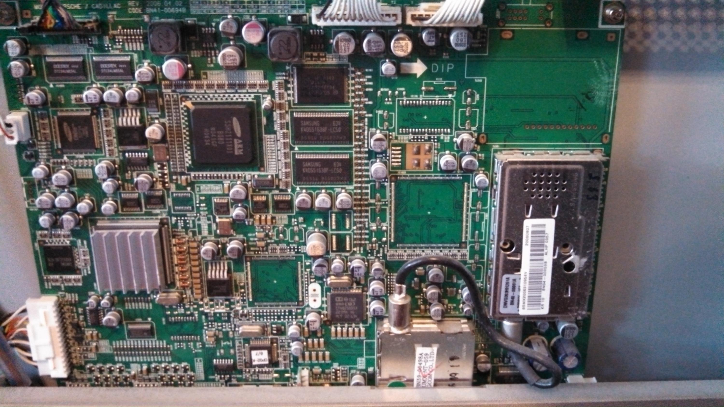

Can you take clear photos of the circuit boards inside your TV using a digital camera and upload them here?Please do not PM me with questions! Questions via PM will not be answered. Post on the forums instead!

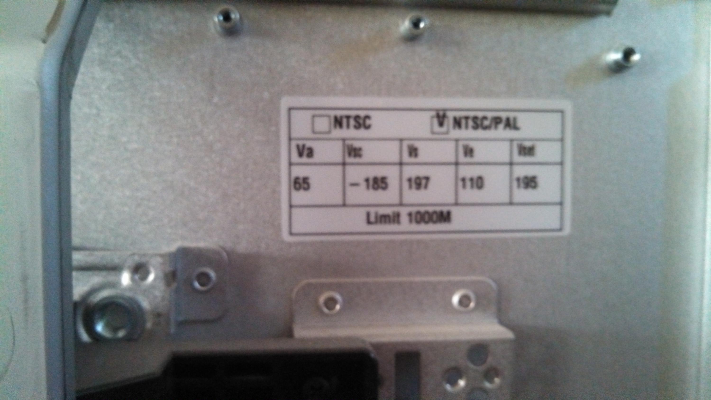

OK, do you see where to test the various voltages on this sticker?
https://www.badcaps.net/forum/attach...4&d=1380473793
The voltages are found on various connectors on the power boards. The red probe goes on a test point, black probe on chassis, and meter set to 600V/1000V DC (if manual ranging) or volts DC if autoranging.Please do not PM me with questions! Questions via PM will not be answered. Post on the forums instead!

It could be that. No guarantees. If it is though, then yes, usually a simple adjustment will fix it.Please do not PM me with questions! Questions via PM will not be answered. Post on the forums instead!

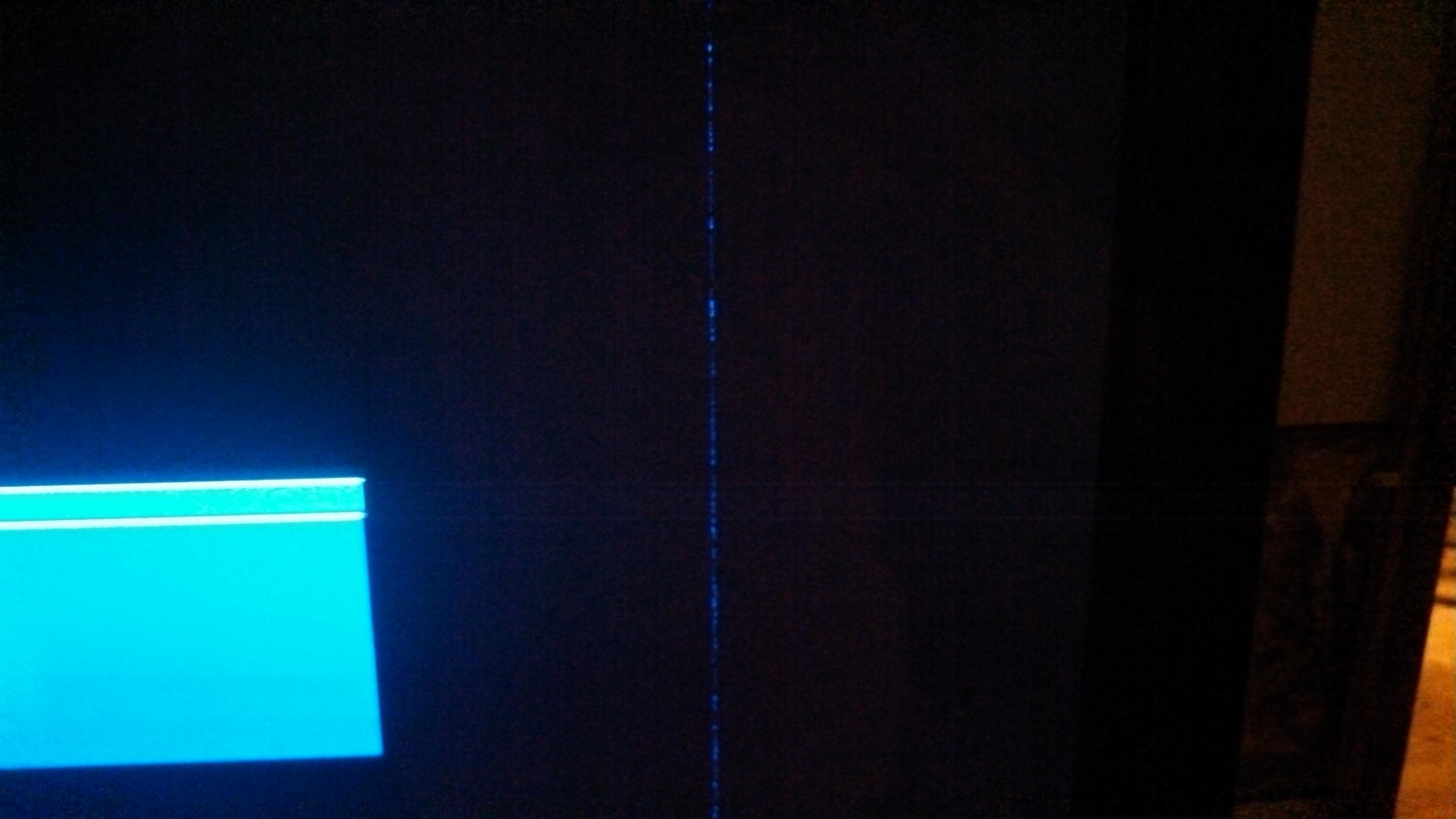

So Tom, You helped me out with this TV last year and would like to say that you were right. I was hoping that you could assist me again with my newest problem with this TV. I came back from a business trip to turn my TV on and found that there is a single thin blue line vertically going down the right hand side of the TV. From the little knowledge that I do have my gut is telling me that it is the Plasma Panel. I turned on the TV menu screen and the line goes over the menu screen. So I figured I would take it a step further and did a Signal pattern test and found that the single line is visible when the black goes over the line but hardly visible when the white part of the test goes over the line. I've heard that it could be the T-con board, But as I stated earlier my gut is telling me that the Plasma panel has finally started to show its age. I have attached a picture so that you can see what the line looks like. So if you could assist me I would be ever so grateful. Thanks Again.Attached Filesif you find these attachements useful please consider making a small donation to the site
