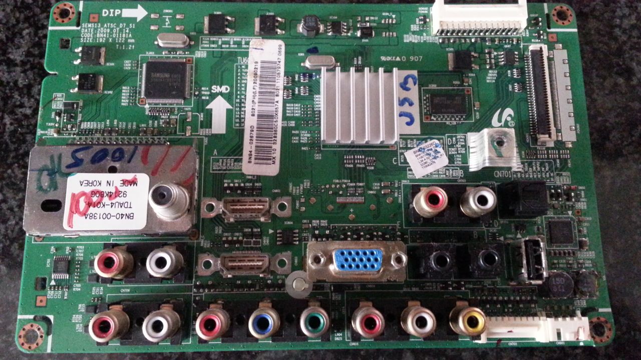

    Hey all. My first post. Please let me know if I've done the images wrong! First, I'd like to thank all the helpers here. I've been able to revive several machines with the information I've found here. I'm currently troubleshooting my brother in law's Samsung LN32B360C5D LCD flat screen. The story is that his small son was repeated pressing the power button on the TV when it decided not to start anymore. I have standby light, but no power up. I've tested the standby voltages on the PS and they all look good. Caps look good. I'm thinking EEPROM corruption now, but I can't find a schematic to help me find it on the board. There are several possible chips. Anyone have a schematic or know the location of the EEPROM on this board? Thanks!

      Have you check the control panel buttons? Since that was the root cause of the problem. Start by making sure there isn't any stuck buttons. Finding the EEPROM chip for your main board you will need to check part numbers on each smd IC chip and then identify them, but the second problem will be finding someone with a copy of your main-board EEPROM.

        Thanks. That's the first thing I did. Buttons are fine.
