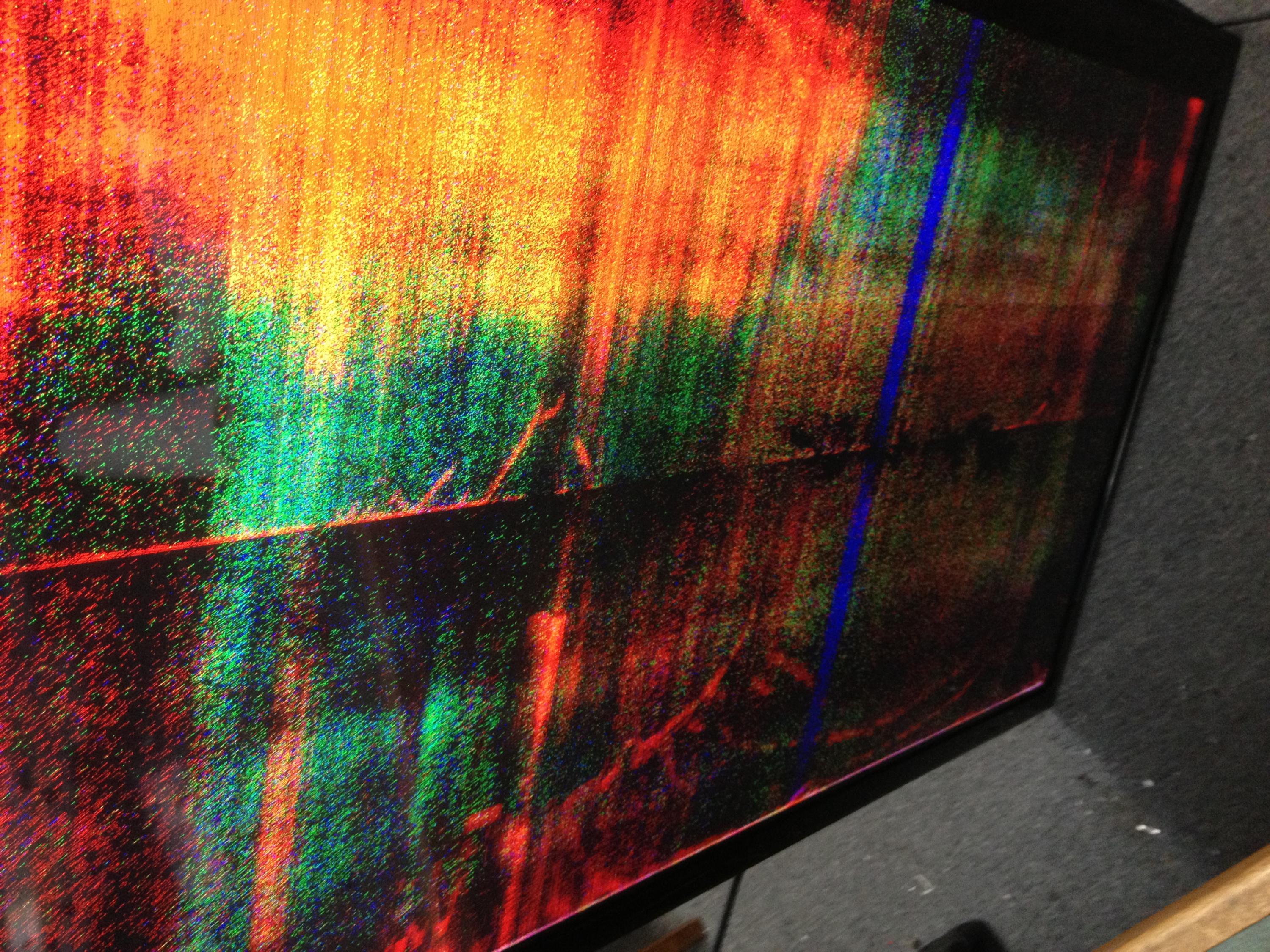

    Screen is Red and Black. You can see the source playing behind the red and black. Sound works. Picture attached.
    Re: LG Plasma 50PK540-UE
    Looks like a Y-sustain failure or Y-buffer failure to me. I'd try checking Vsc and -Vy voltages on Y-sus to see if they're good.

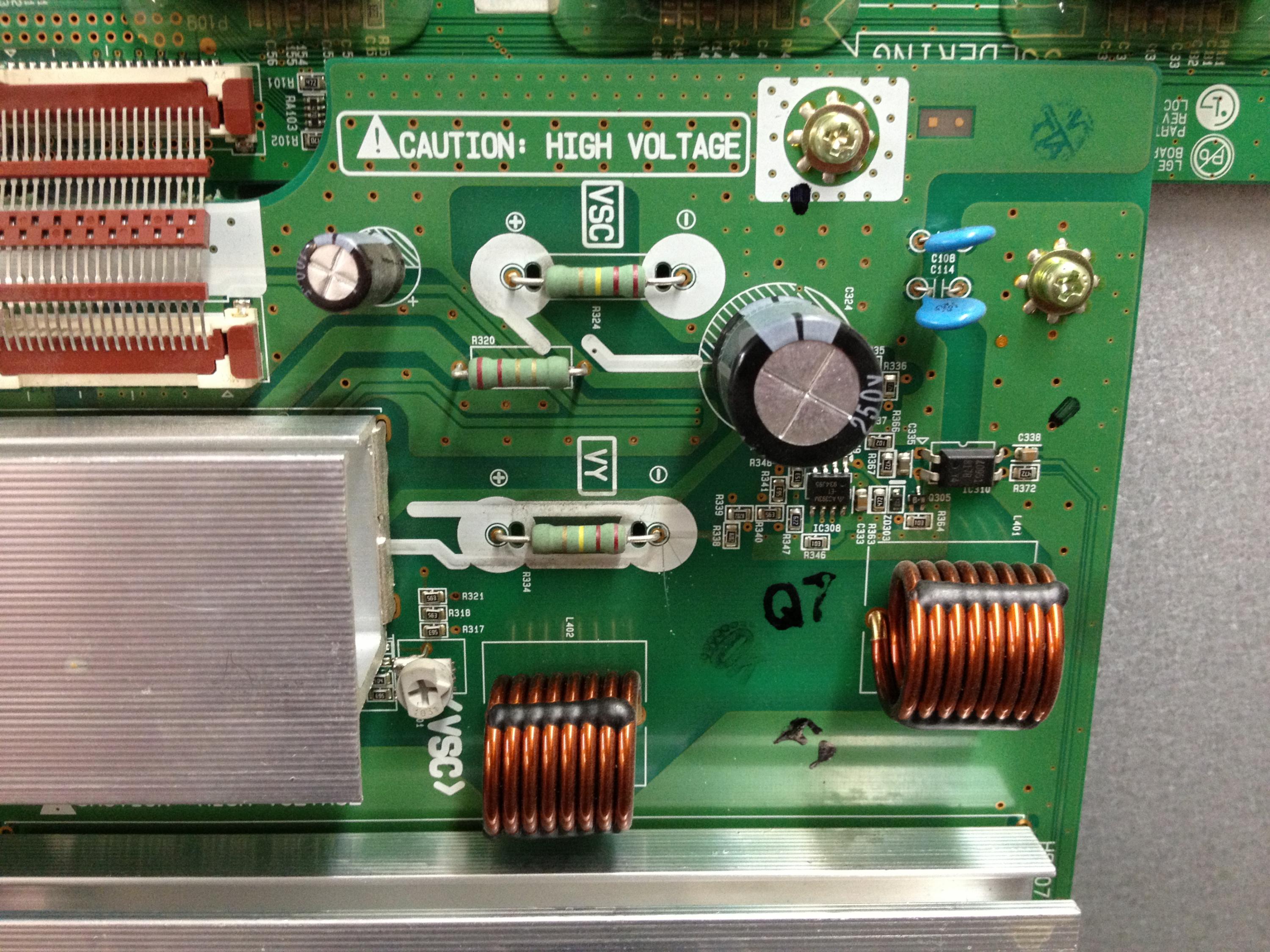

              Readings

              Ysus
              Vy : by the + marking 95.4v
              Vy : by the - marking 93.3v
              VSC : by the + marking 2.2v
              VSC : by the - marking 95.4v
              Zsus
              VZB 114v
              picture is attached to show the "+" and "-" markings I'm referring to.
                You should measure across the + and - not go to the chassis.
                  Ysus
                  Vy: -188.5v
                  VSC: 150.2v
                  Zsus
                  VZB: 113.9v
                    If those match the sticker, they look fine.

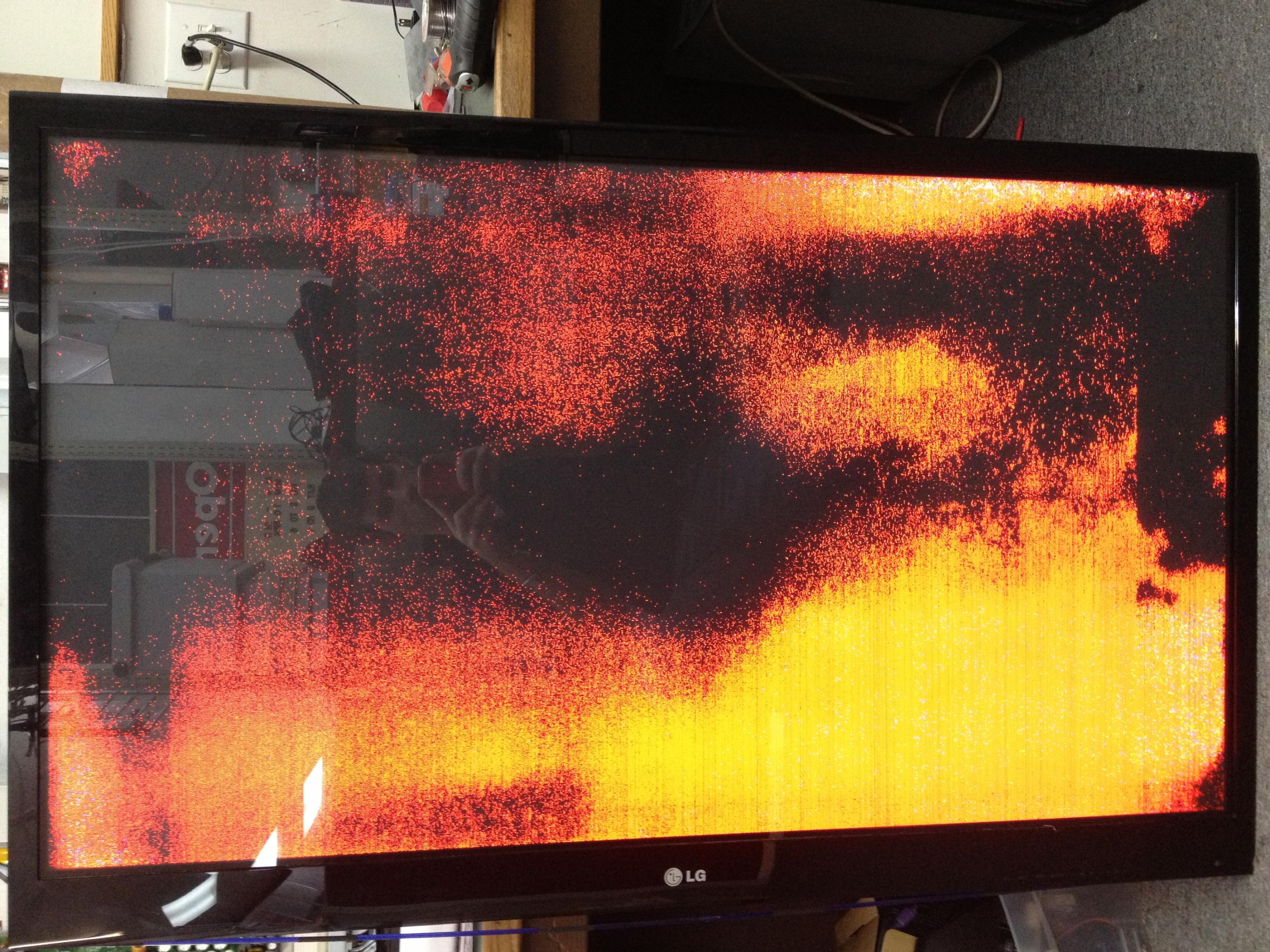

                      Adjusting the set_up & set_dn both affect the color/darkness of the picture, but neither help the clarity.
                      picture attached.
                        It is very hard to tell. I think it may be a Y-buffer or Y-sustain problem but I do not know. The only way to be sure is test the Y-sustain output using an oscilloscope.

                          Thanks tom66! I replaced the Ysus and the tv works beautiful.
