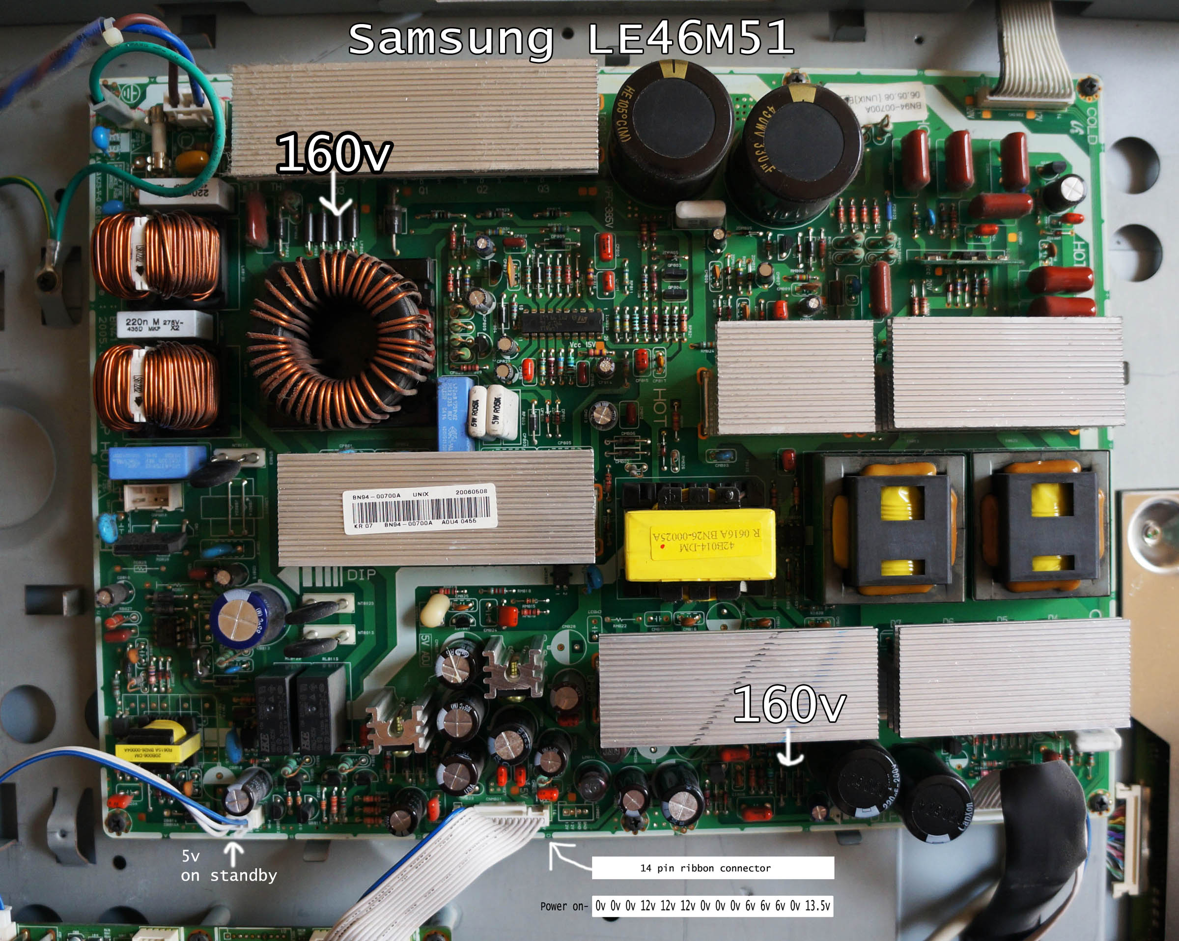

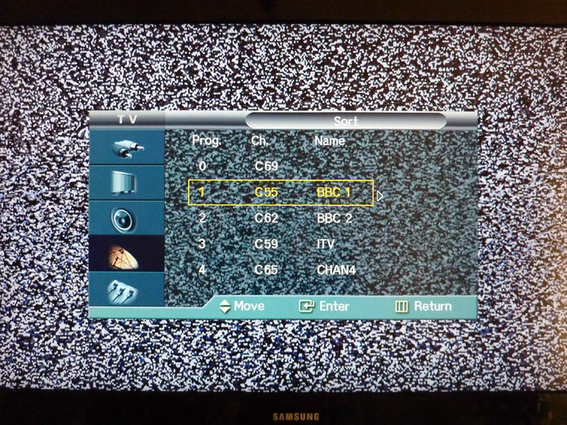

I have a Samsung LE46M51 LCD TV with no video display, just a white screen. It switches on and off ok.

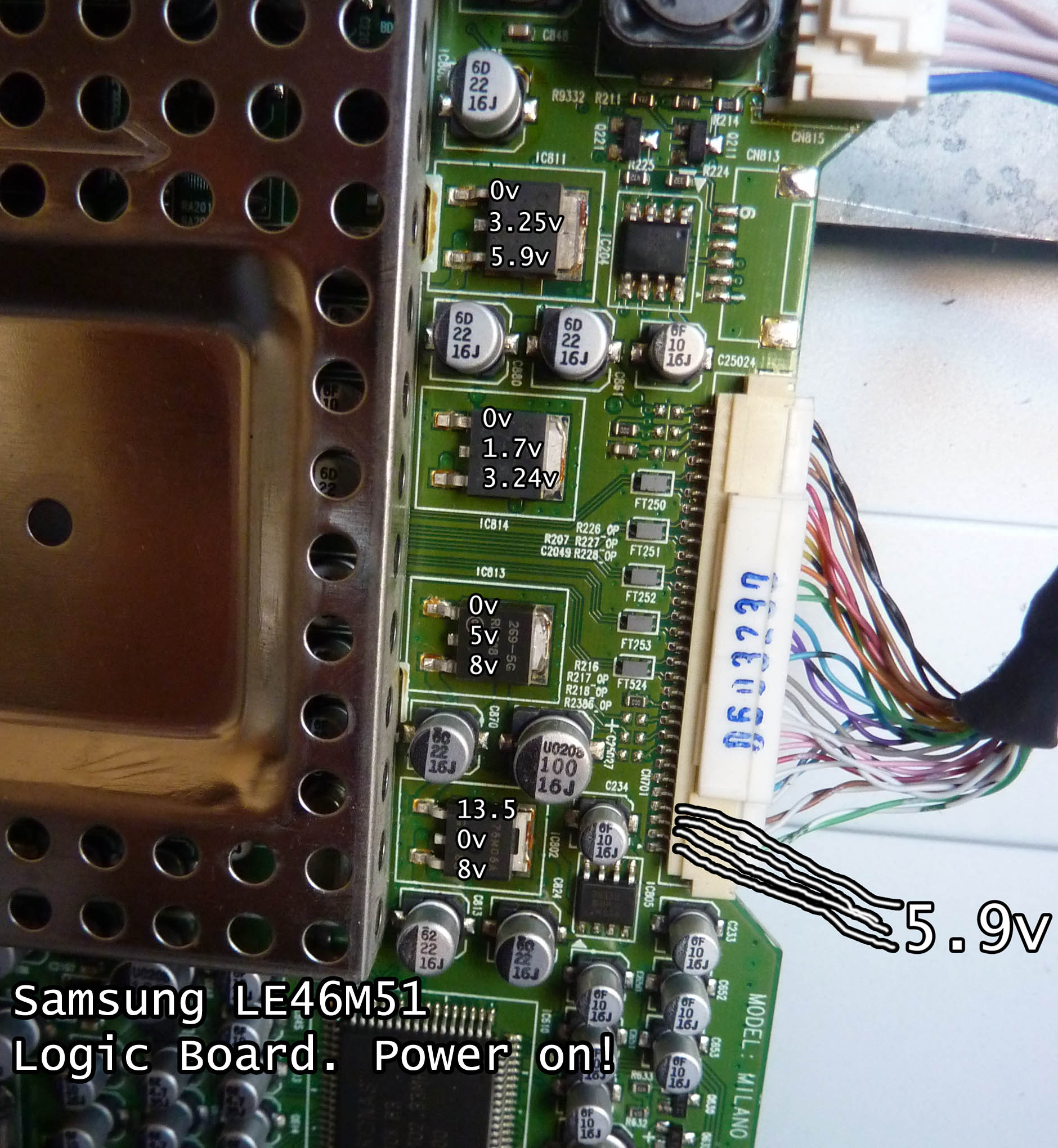

There are no visible badcaps and I have taken a few voltage readings. See pictures. Power is on!
Could anyone help a tv newbie??
