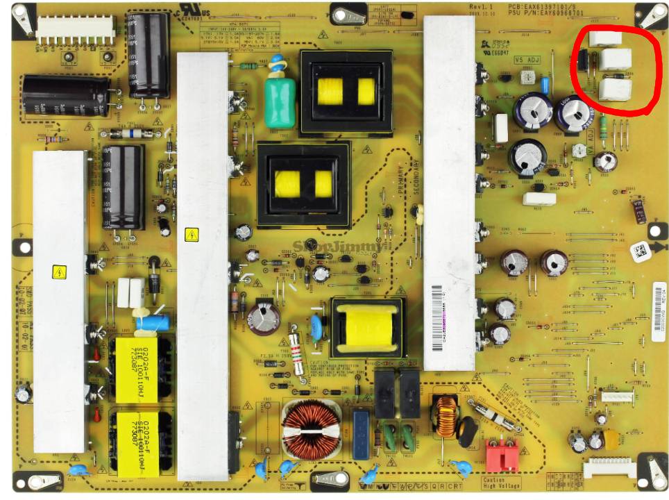

                        Check the 3 ceramic resistors for continuity AND ohms. One will probably be reading different from the other 2. Replace it and turn the set on. They are on the power supply.

                          Idisassembled the motherboard and checked the 3 resistors. Initially the values, with two different multimeters, changed continuously up and down.... starting from 100 and after a few seconds it progressively reached 200...
                          After a while I tried again, and this time they seem, unfortunately, all 3 ok.Between 11.5 and 11.6 ohm 😢

                            Does your meter beep when you touch the leads together? If so, check each one for continuity, they are resistors and a fuse in the same part.

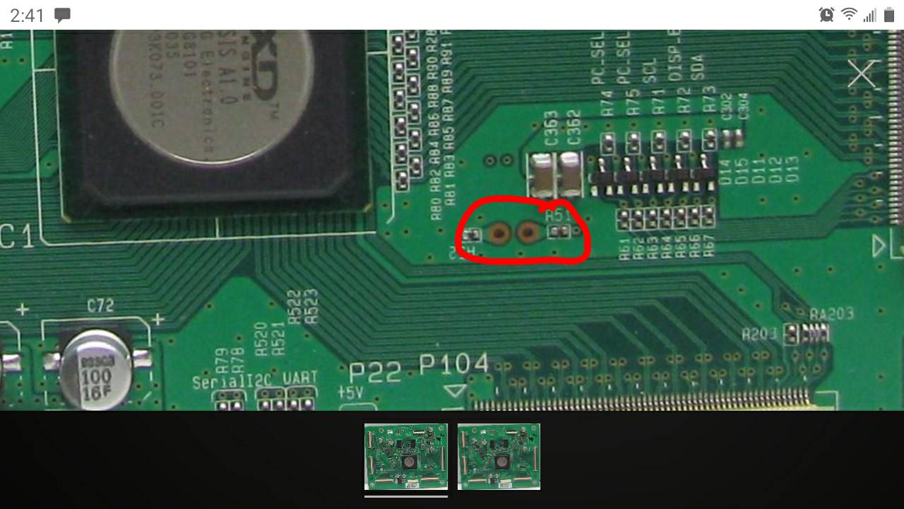

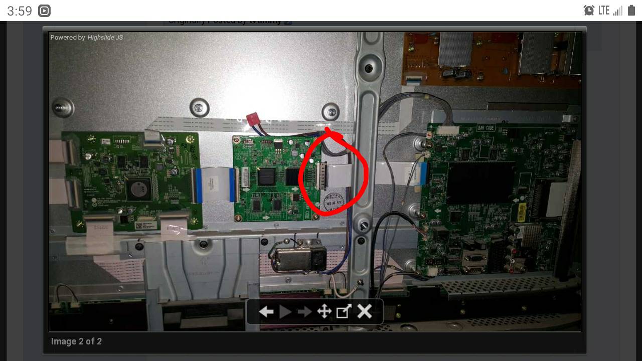

                              Now I'm thinking you mainboard is bad. Unplug the ribbon going to the control board from the mainboard and put a paperclip in the two holes circled. Plug the tv back in and see if you have test patterns on the screen.

                                Hi dear, i just tried and from all 3 resistance, i get beep

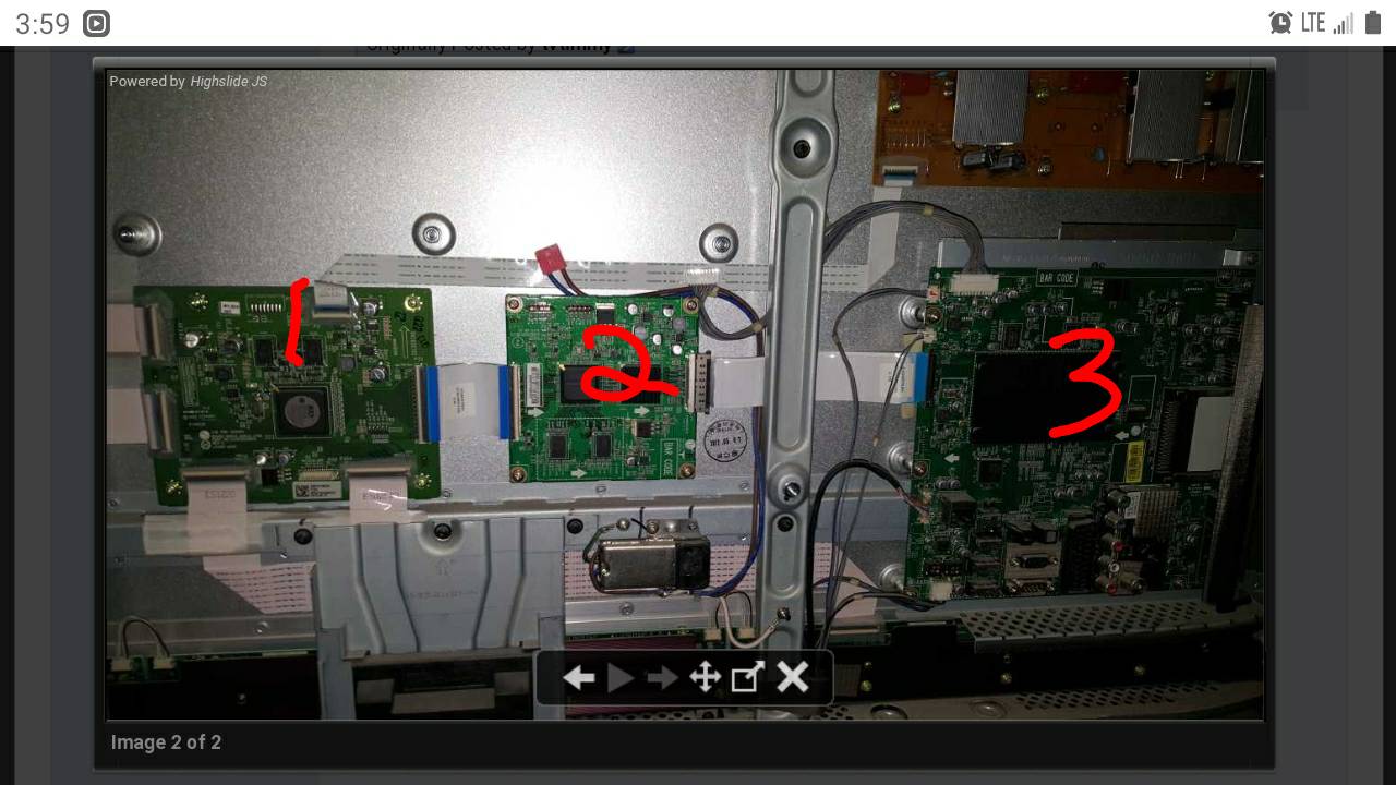

                                The control board, is the one on the right?

                                  1 is the control board
                                  2 is the PC board
                                  3 is the mainboard
                                  Unlatch the ldvs ribbon circled in red in picture 2.
                                  Put a paperclip in the 2 holes circled in red in picture 1
                                  Put your power supply back in and hook everything back up to it.
                                  Plug in tv and test patterns should come on the screen.

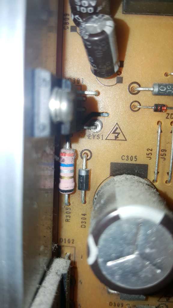

                                    I give you some more information.
                                    When I turn on the TV, the red light comes on. Then for several seconds the remote control is as if inhibited. I notice this because the red LED turns blue when it receives command from the remote control.
                                    In the center of the TV is a large blue LED that lights up at the beginning, and then goes off....
                                    I look at this video where it says to check the diode D304.
                                    I tried to verify and my tester beep, because there is continuity so it means is broken?
                                    https://youtu.be/DNot1A2ektI

                                      Re: LG 50PX950 Clicks, Turns off instantly
                                      When testing a diode you must put your meter in diode mode. You should read .400 to .700 one way, then reverse the meter leads and read OL, or nothing.

                                        Both side i get 005-006 in some moment 007.... broken?

                                          I have taken, for eventual replacement at the weekend, the diode and the transistor
                                          The Diode was to be SB140/SR140 and the Transistor 3BR 1565JF
                                          The Transistor has the correct code, even if the vertical code is different from the one they give in the kit on ebay.. I do not know if it is important.
                                          They gave me a 5A 100V diode... I noticed it and I went back to it.... and the girl told me that this is better and that if the technician says that it is not good to call her, she will explain it to him... ����
                                          What do you say? Is it really all the same, or not?
                                          The problem is that I think is too big
