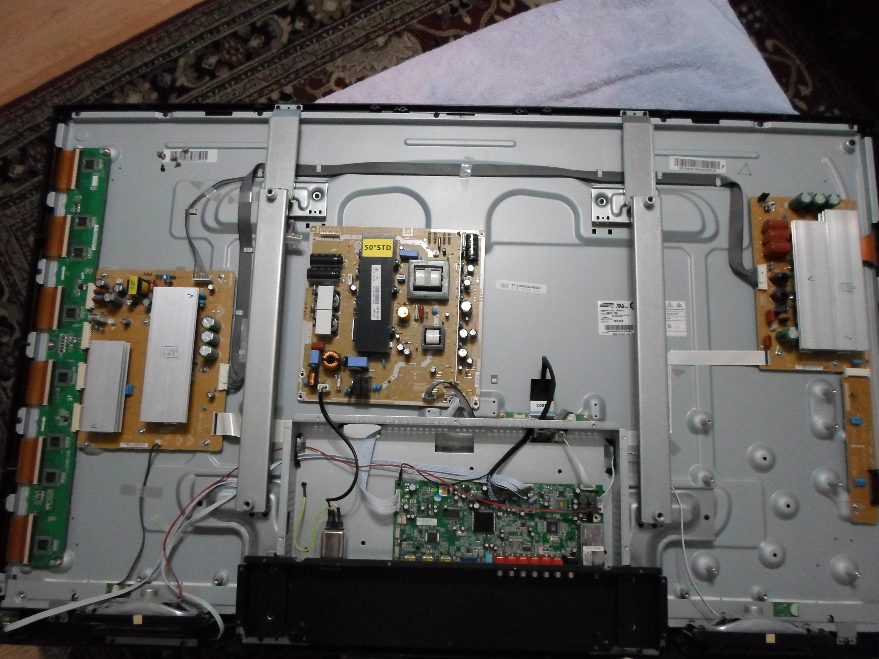

    Viore PD50VH80 50" Plasma`
    Label on back was removed, not sure of model # but think it's VIORE PD50VH80
    TV is dead. 120VAC to PS, but 0VAC at bridge rectifier. Fuse is good.
    Power Supply is a Samsung LJ44-00188A
    Panel # S50HW-YB05 (S50HW-YD13)
    What should I check? Thanks!

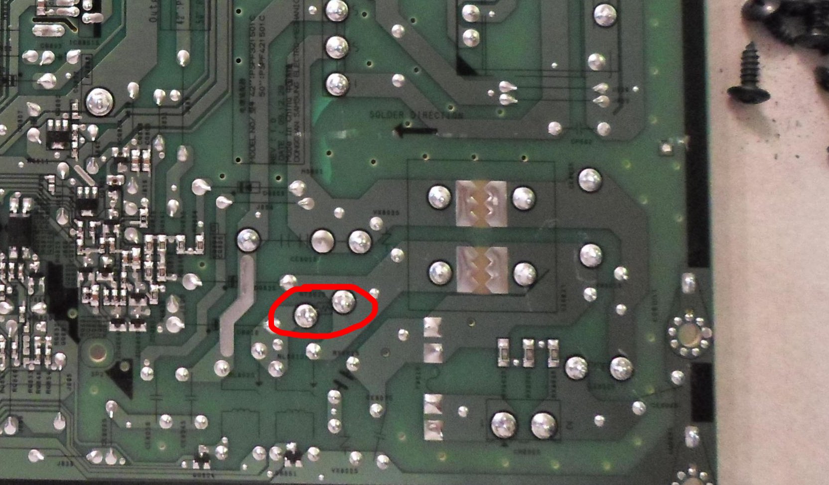

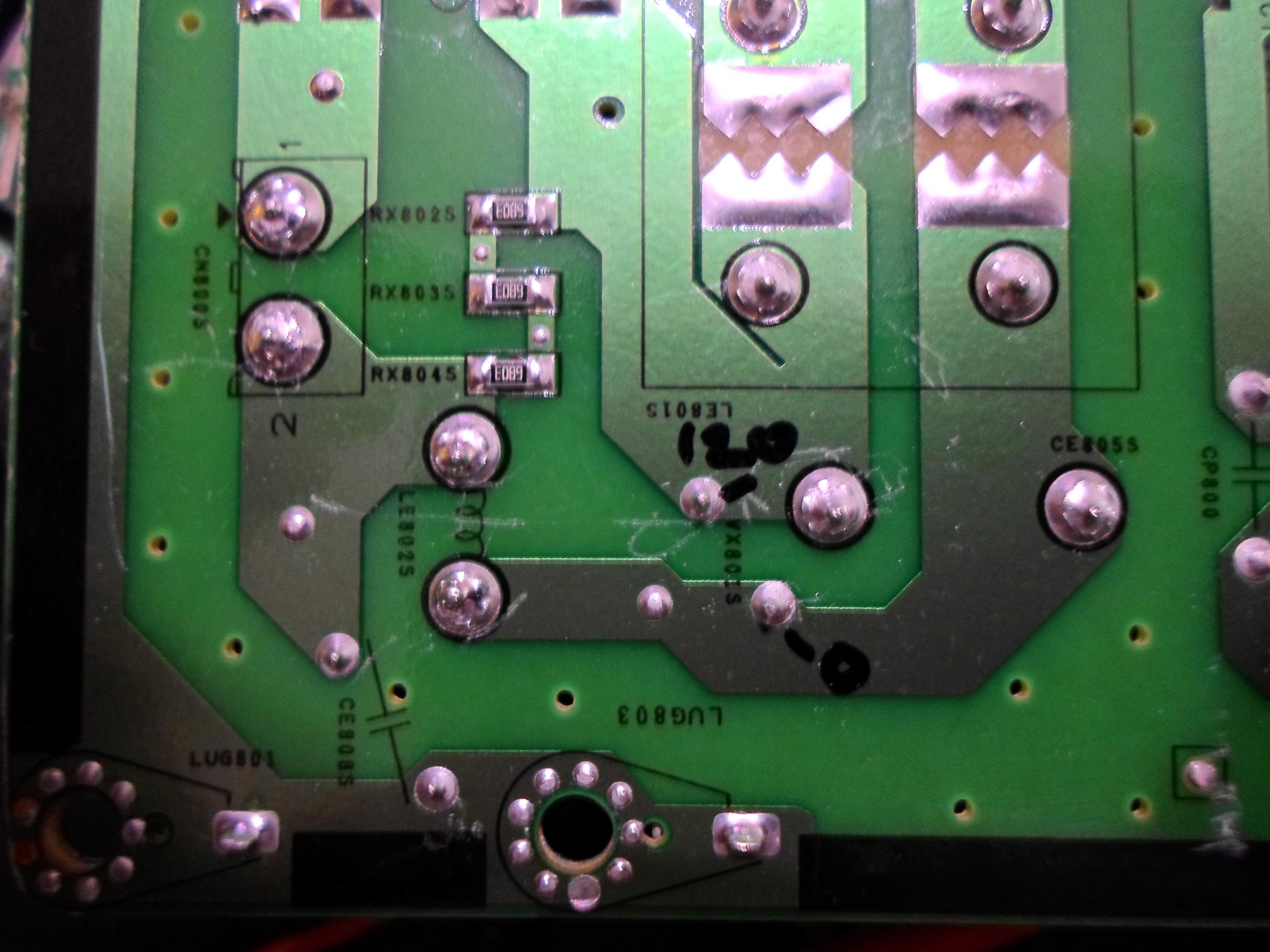

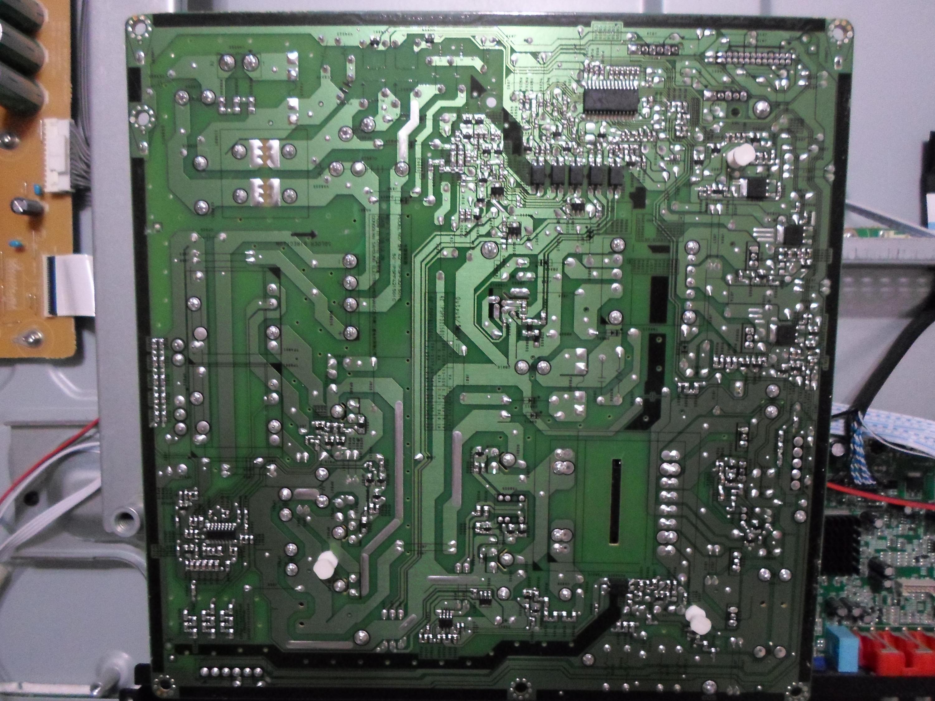

        Can you post a picture of what's under the 450V 22uF capacitor? (gold coloured)

            Re: Viore PD50VH80 50" Plasma`
            I just checked the nearby Q5801 and Q5802 (TK15A50D) and there is 22 ohms between gate and source on both of them.

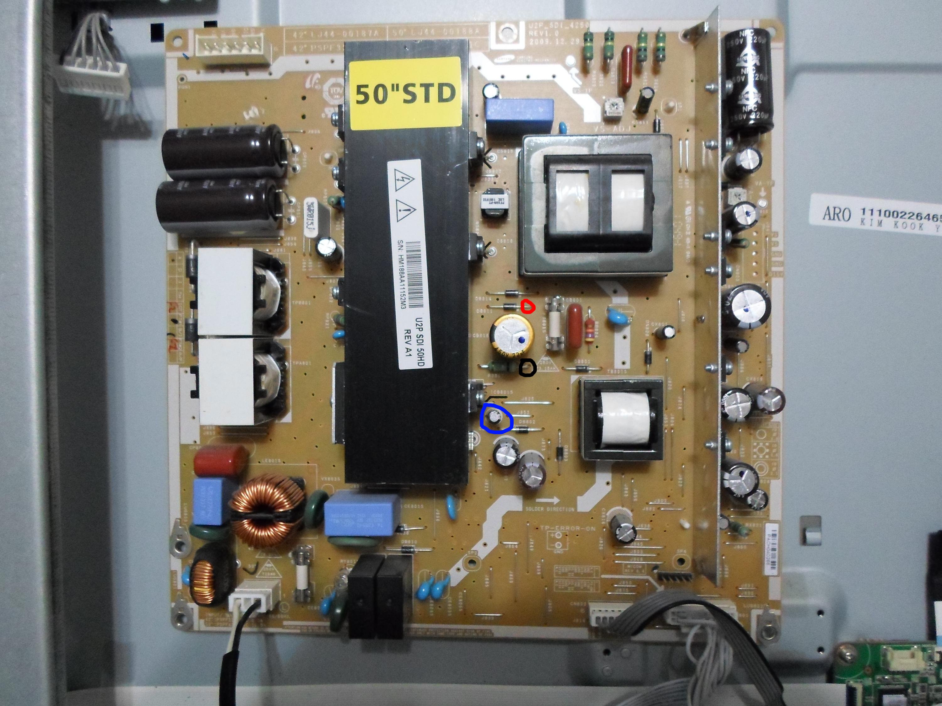

              Some test points.
              RED-BLACK: Check voltage between these points. Should be around 160V DC.
              BLUE: Measure voltage across this capacitor.
              • kevinm34232
                • May 2012
                • 1884
                0.7VDC between resistor and diode, 0V at that cap, remember I'm getting no AC at bridge rectifier does that mean a problem in the AC section?

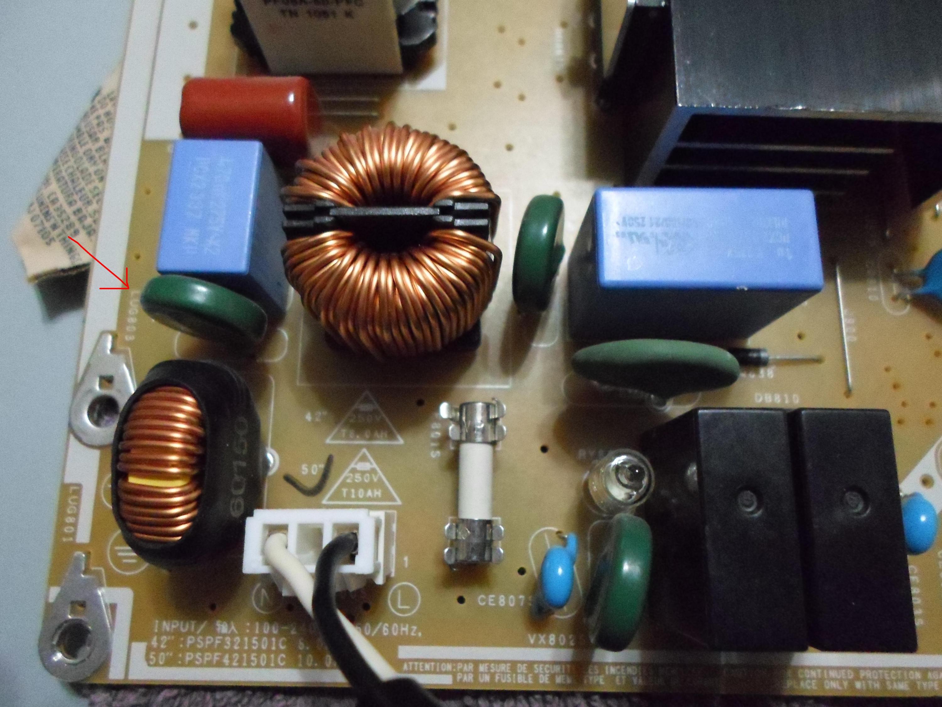

                      If you measure the AC at the left most terminal in the above picture (red probe) and black probe on the right most pin of the power connector from the AC plug (again as in photo), what do you measure? Somewhere the 120VAC is disappearing and it's probably in that filter section somewhere.
                      • kevinm34232
                        • May 2012
                        • 1884
                        I have 122VAC here between those pins.
