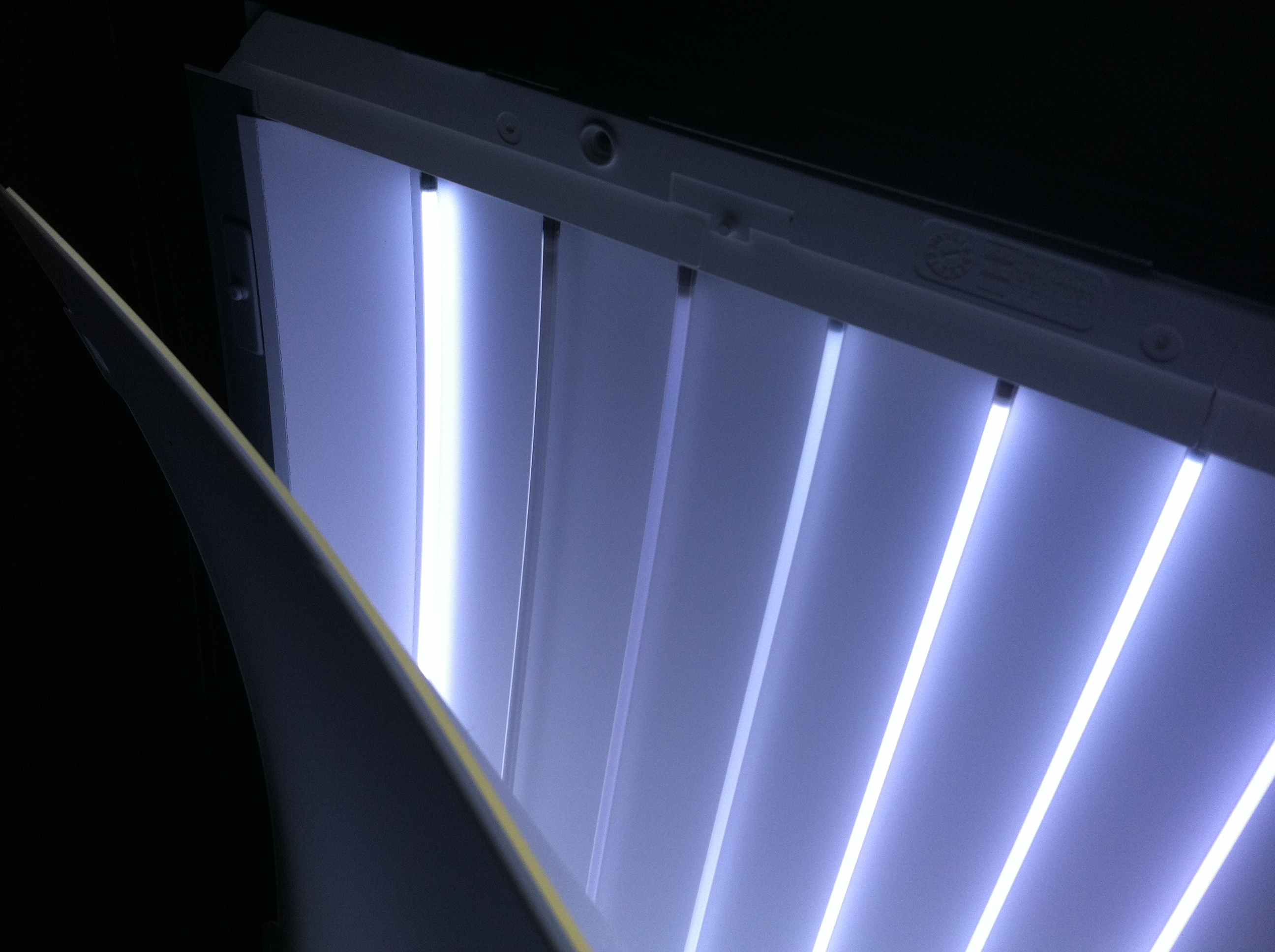

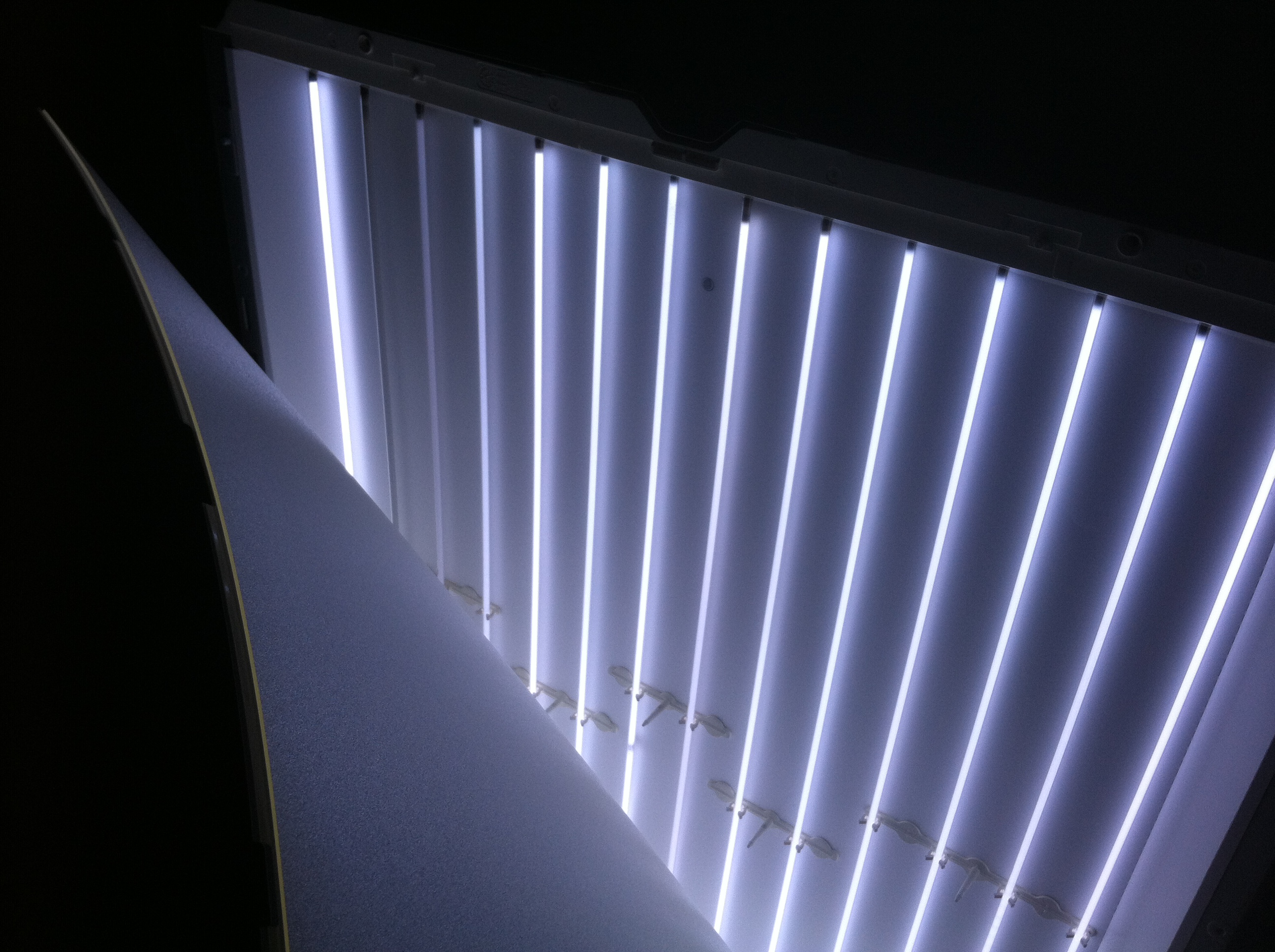

    When I got it opened, there was one bulb out, and two dim bulbs. I don't have any 900MM bulbs, so I soldered a lead on each end of a 840MM bulb for test purposes. I replaced the failed bulb with the new one and fired it up. They all lit. I pulled the jumper from CI806 and tried again. The lights still cut off after a second. At this point, I don't know if the modified bulb is still drawing too much current and sending the inverter section into protection or if there is another bulb causing the problem. I saw a youtube video where the maker of the video was able to determine which lamp was causing the problem on a differeent Samsung with a different configuration by probing something on the backside of the inverter. Looking at the IP board via the link to ShopJimmy that I posted earlier, do you see anywhere I could probe to look for an abnormality?

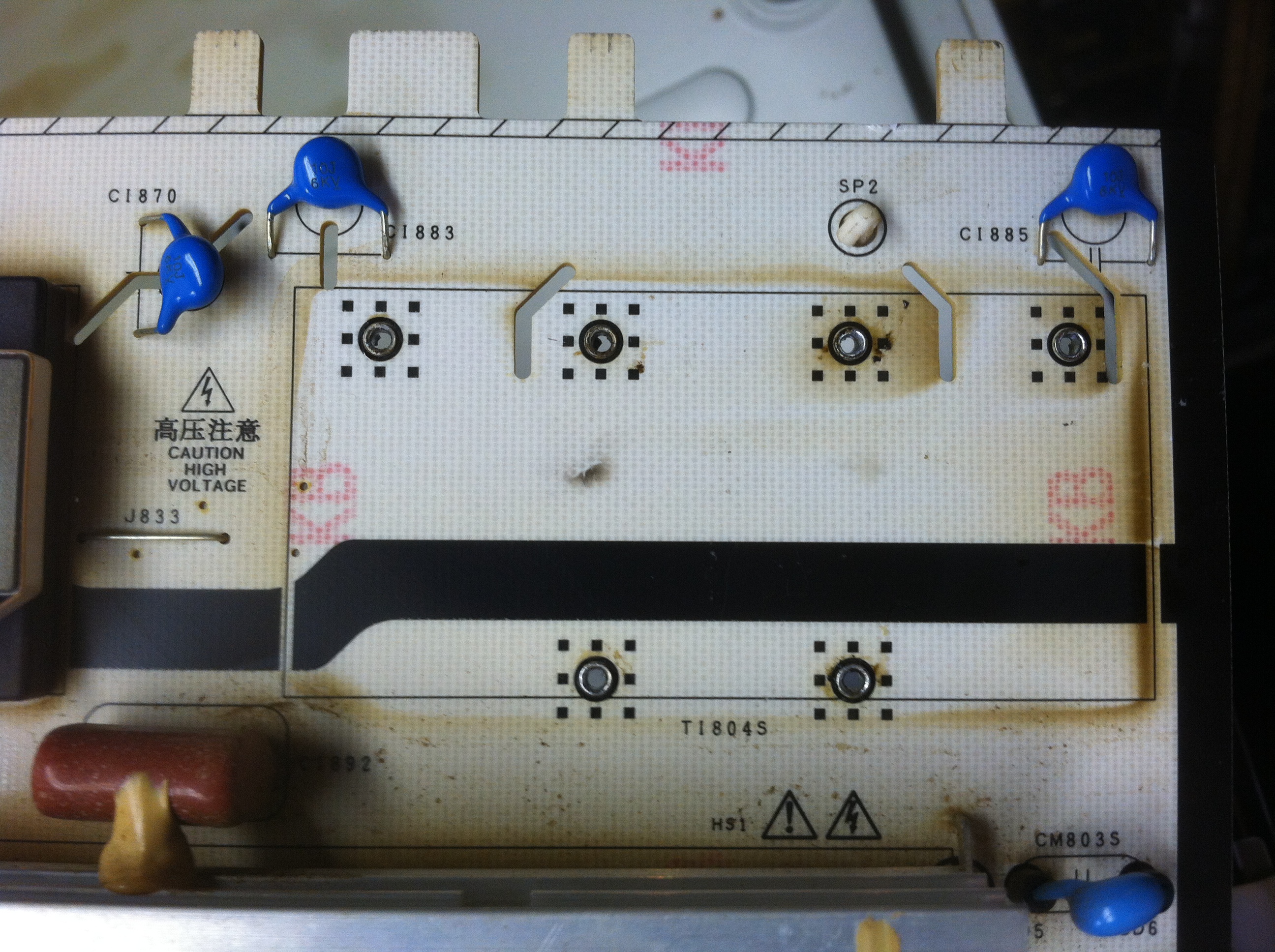

              There are four transformers on the IP board. The top three each power four lamps. The bottom one powers just two lamps with pins 2 and 3 jumpered. The top transformer was the questionable one. I swapped the top and bottom transformers this afternoon. All bulbs lit brightly but they still cut off after a second. I used this link to verify that the one transformer is definitely bad.

                    With the transformer removed, the backlights don't light at all. Can any of you tell from the pics if I can jumper somewhere to at least get the upper 12 bulbs to fire and stay lit? I'd like to at least see if there's anything else going on with this PSU.
                    http://www.shopjimmy.com/samsung-bn4...t-inverter.htm
                      #30
                      Re: Samsung LN40B630N1FXZA, brief backlight, power up chime, then nothing.
                      The transformers are wired in series (primary to primary), so it's not possible to run it with a missing transformer. If you jumpered the primary across it would probably be like christmas lights without fuse bulb (another transformer or the inverter circuit would fail.)

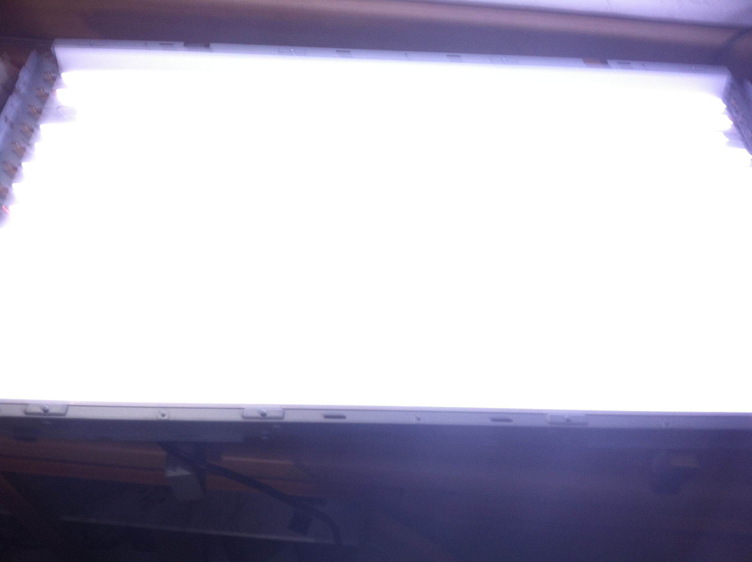

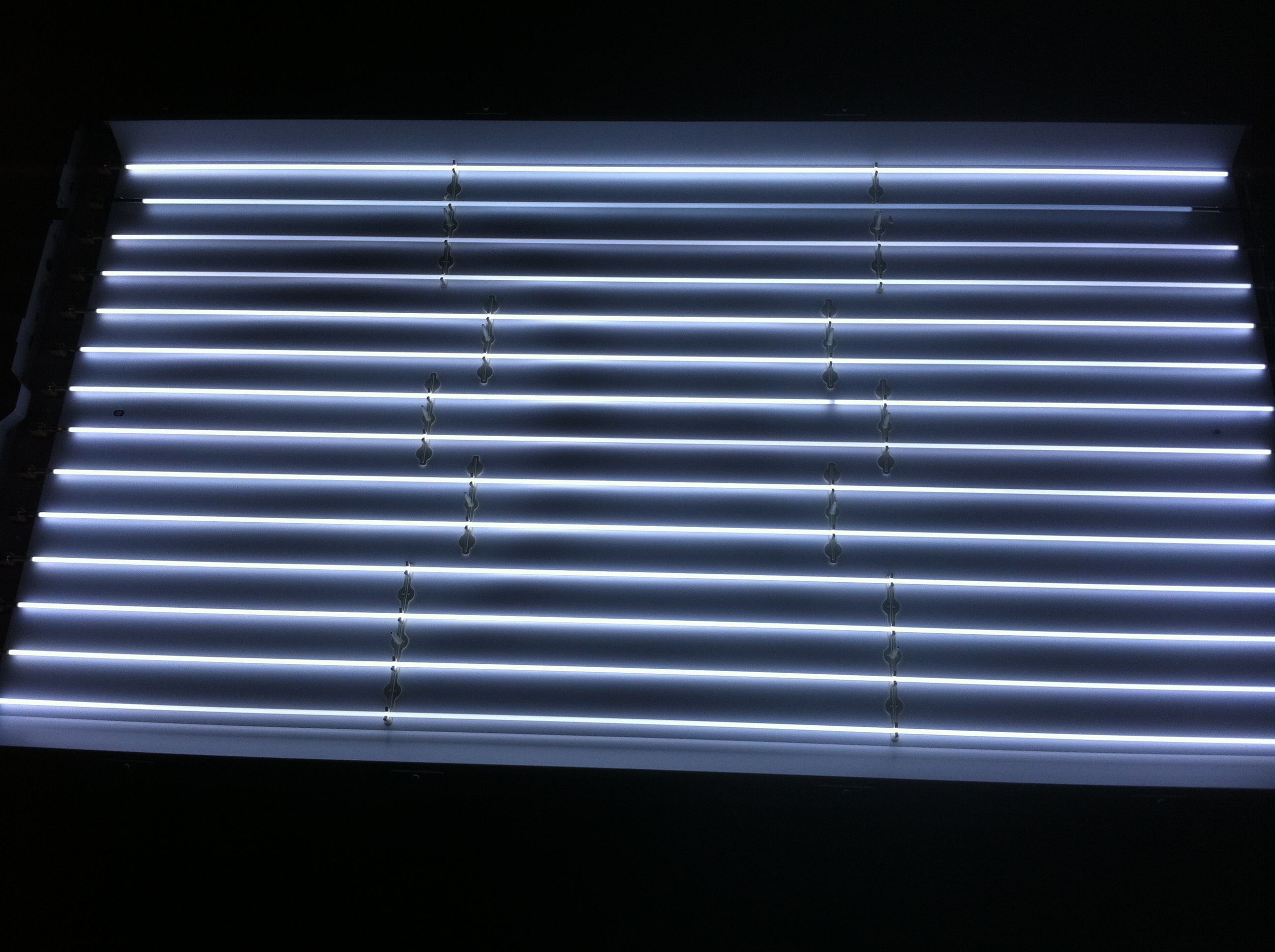

                                Here's a pic. I really don't want to bypass the protection circuit on this new IP board. This is the best pic I could get before the lights shut off.
                                  #36
                                  Looks very bright, is that normal?
                                  Also is one tube a little short?

                                    I think it's just that the camera didn't have time to adjust to the light. See post #21 regarding the length of the one bulb.
                                      #38
                                      It is possible the bulb is too short and this will stop it working properly.
