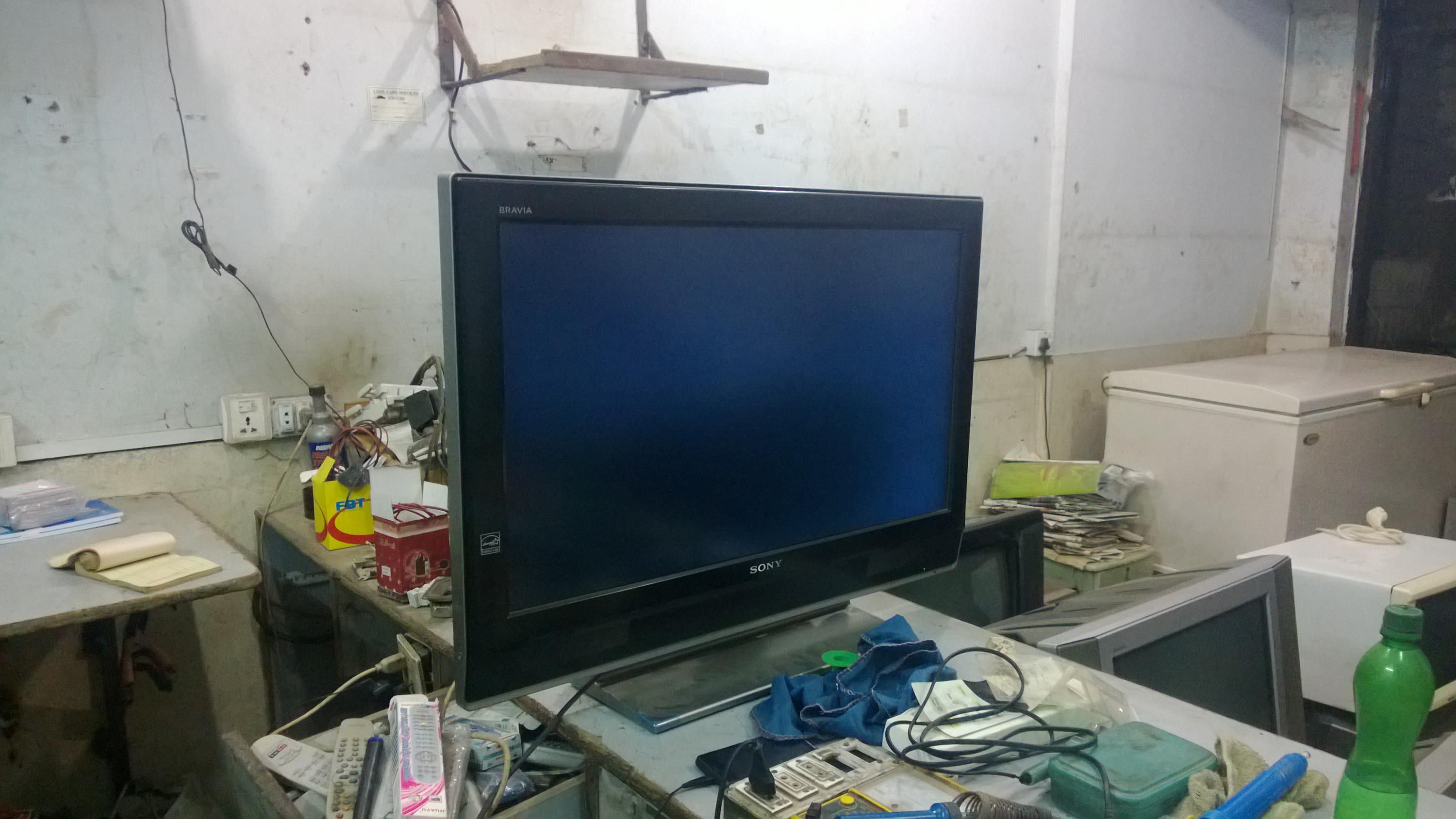

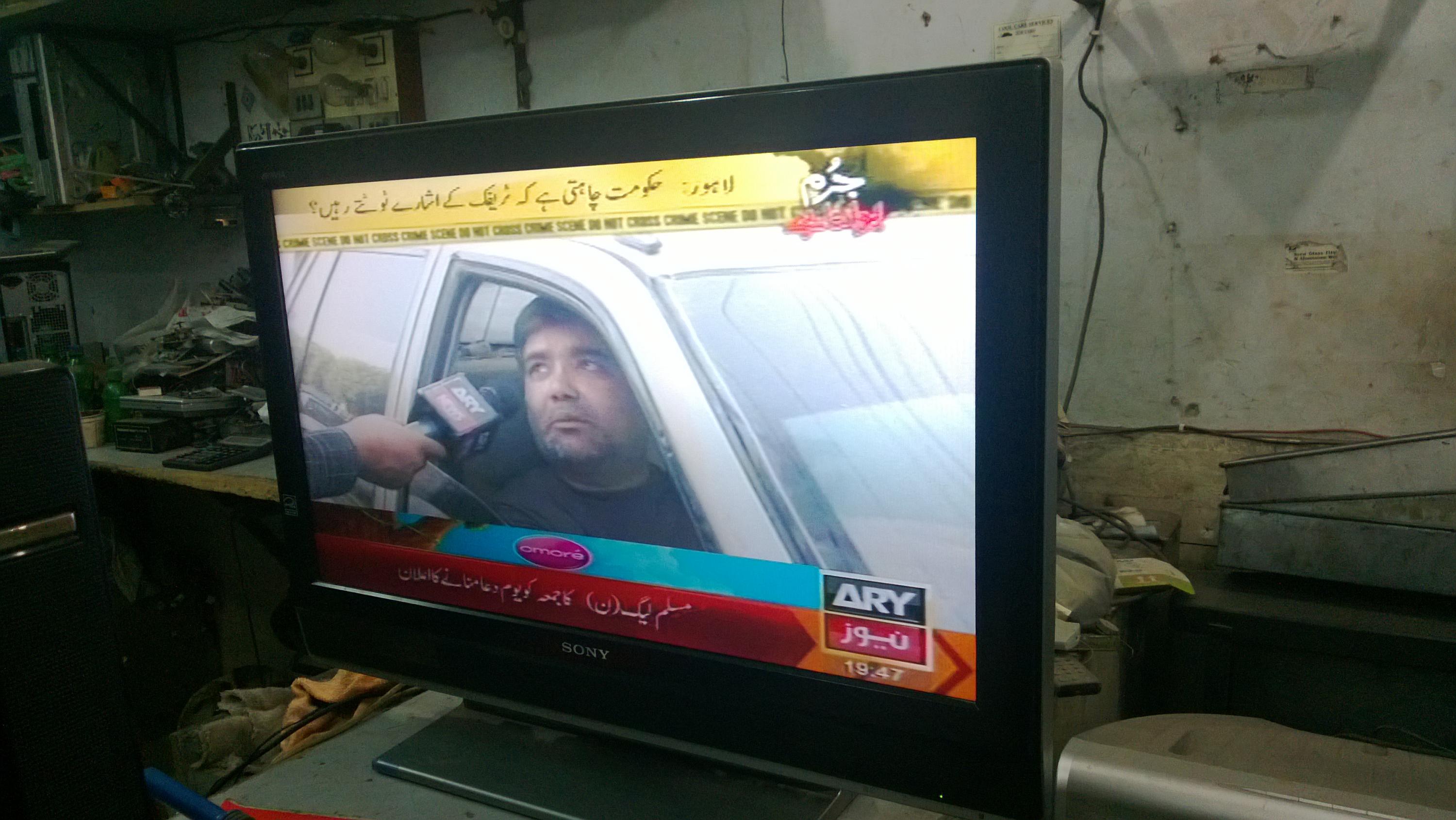

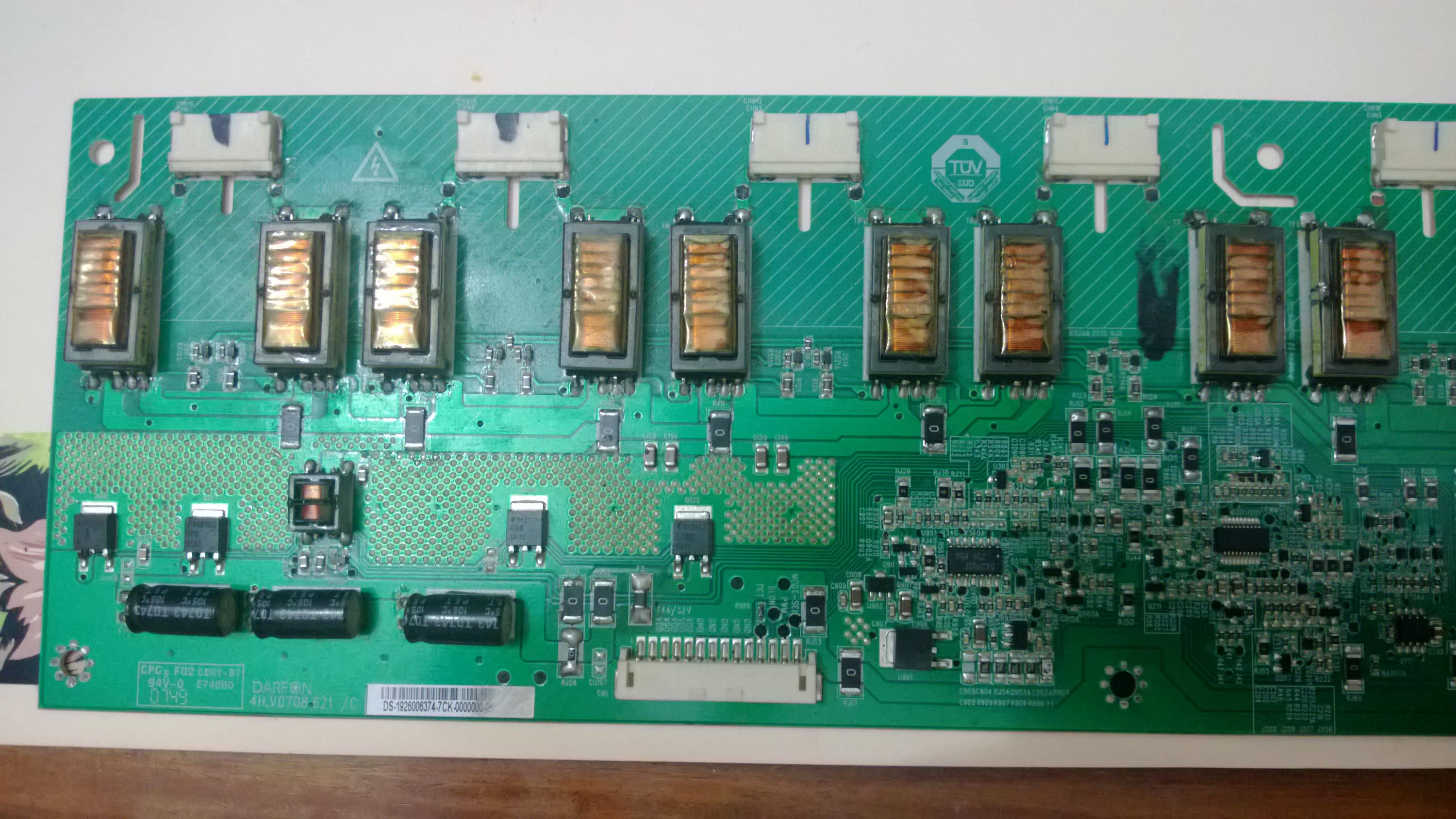

    I have problem with my above SONY LCD TV, as you can see in pix that its 1/3 lower portion is darker then rest of display. Can someone suggest,
    We swap 4 inverters transformer from lower portion to upper one but it makes no difference. How can I check if some of the CCFL tubes are weakened or blackened without opening the panel. Your help will be appreciated

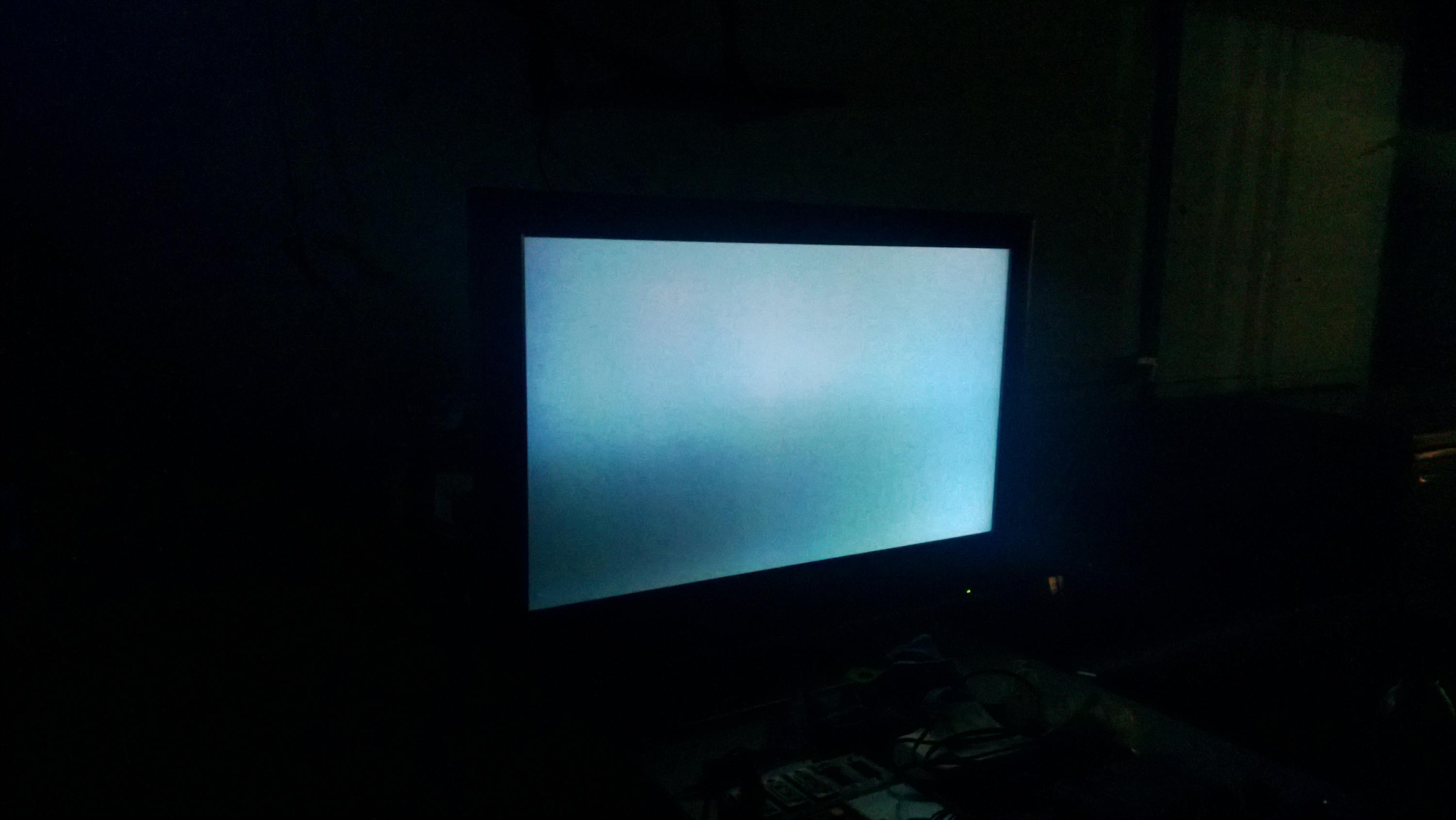

        ...Can you try with a solid white screen so we can see exactly how and where the picture is dim?

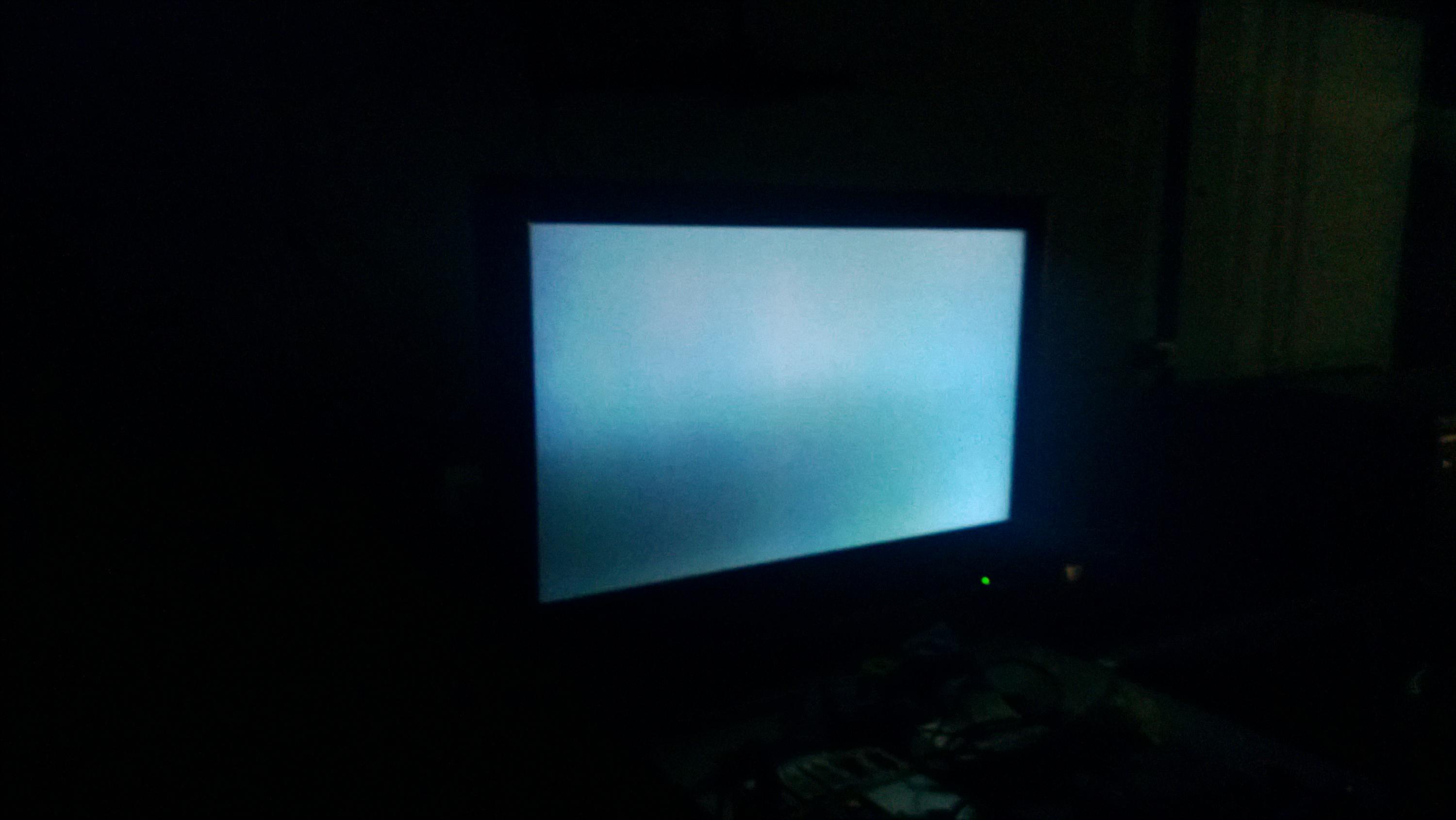

          Pictures are attached
          Pixs are taken with graphic card connection removed.
          brightness was set to maximum before removing card connection.
          I dont know how to get white background.
          Hope these pictures will serve the purpose
          Your further advice will be appreciated

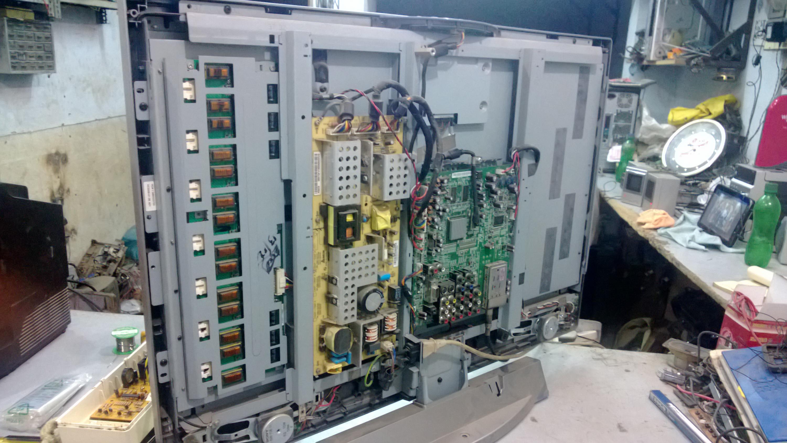

              Tom, set is with technician and although he is good with crt tvs and sound hands, he is not comfortable with LCD's. Can you please be more precise as what should I ask him? He may not be familiar with term twin inverter. He although show me a card with lot of (8 or 10 transformers soldered on it, and latter he swapped some of them)
                Re: Sony klv 32u300a display problem
                A picture of the back of the set would tell me if it uses twin inverters, also one of the PANEL STICKER (which has who made LCD panel, e.g. "AUO", "Chi-Mei", "S-LCD", "Samsung", "LG Display"...)

                  After replying to you I left for technician shack and got picture of back panel,It uses two transformers per tube, For Label I will visit tomorrow and will let you know.

                      Please also note three transformers at top
                      These are blackened at middle.
                      Actually they were soldered at bottom, but technician move them to top.
                      But it did not solve problem

                        I suspect some bad bulbs in the panel or the connectors are loose at the other end. You would need to take the LCD panel apart to get to the bulbs.

                            Would you call it twin inverter?

                                You won't be able to see if they are loose without having the panel apart but my personal opinion is that there are bad bulbs or a loose connection on the bulbs.
                                It does not appear to have two inverters (twin inverter or master/slave inverter.)

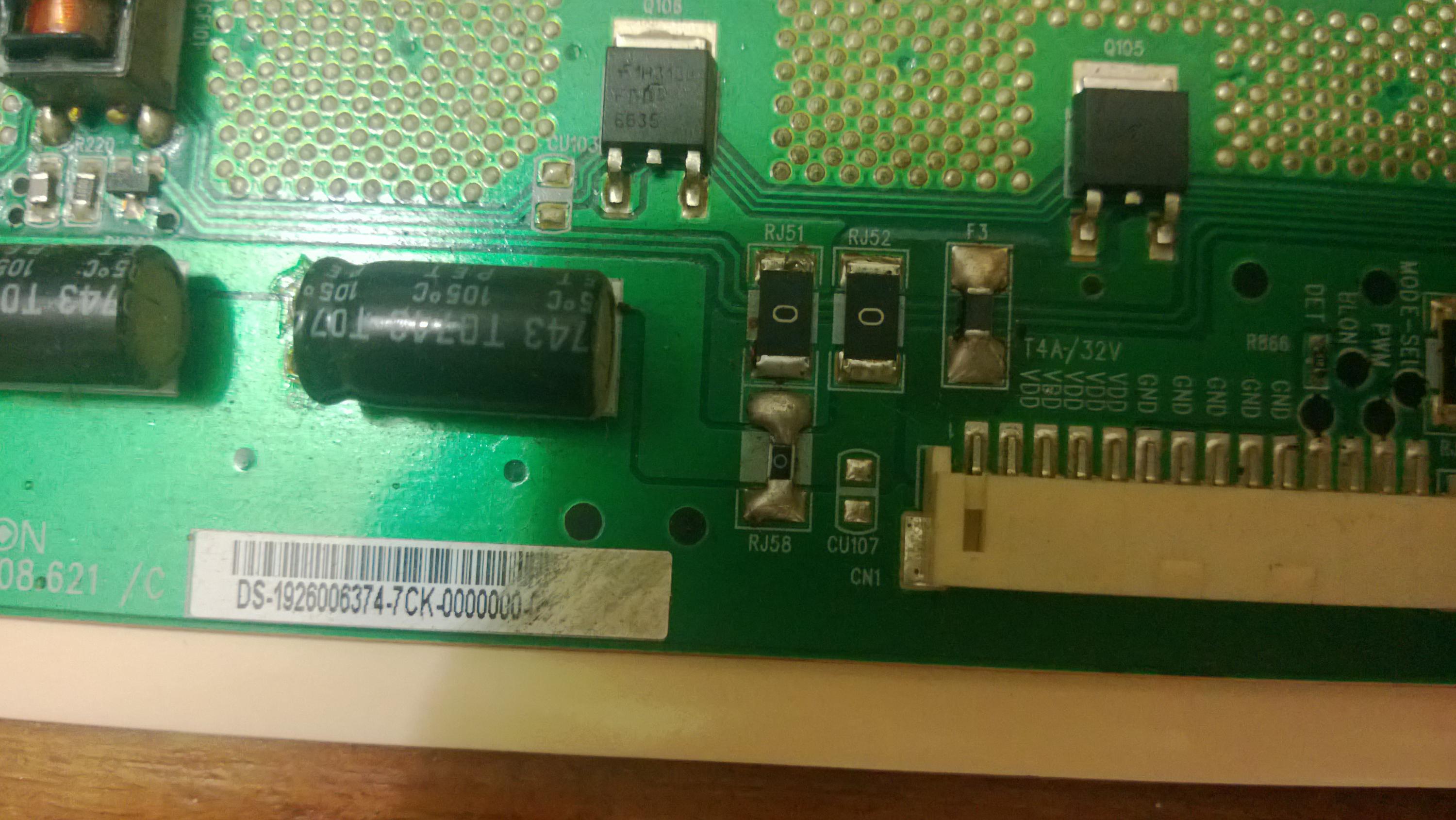

                                        Please advice what these RJ?? components are with "0" printed on top, are these resistors with 0 value and acting as jumpers?
                                        There are lot of these on inverter board and all showing continuity except RJ58
                                        Any advice?
