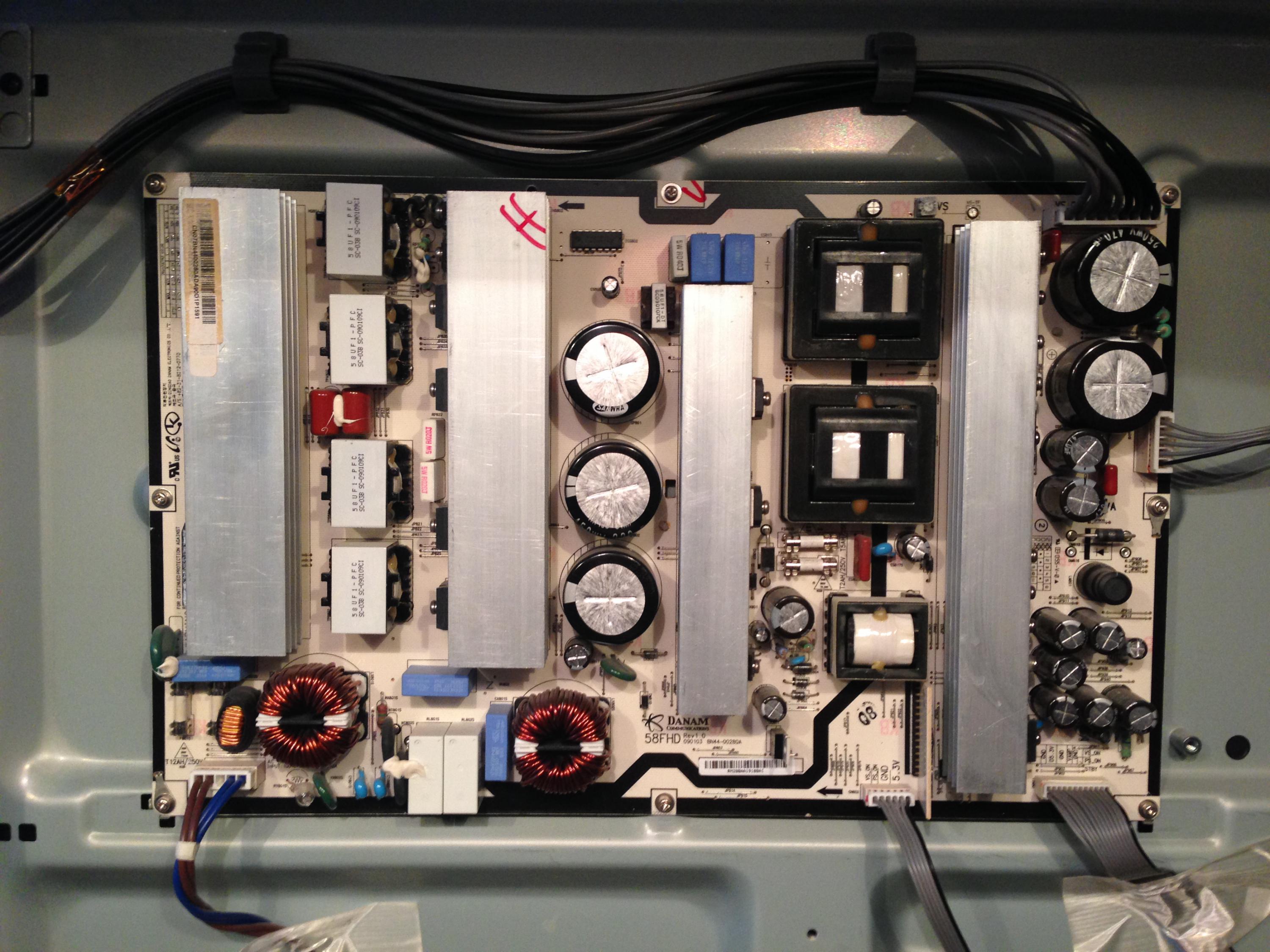

                  Re: Samsung plasma PN58B650S1F clicking relay no picture
                  Thank you for this awesome resource! I would really appreciate some additional help on this same issue.
                  I purchased my PN58B650S1F Plasma in 2009 and just yesterday (12/26/2014), the TV went into the clicking loop with no picture; exactly as described by MyEvolution in this thread. I performed all steps as advised in the forum thread, but for the sake of being thorough I am posting my exact steps below.
                  This is what I have tried but I'm still not 100% sure on what part(s) might be the culprit.
                  When I describe LEFT SIDE and RIGHT SIDE, these sides are related to the back of the TV or while I am facing the back.
                  Symtoms:
                  1. TV will immediately start clicking when I plug it into the wall. A series of 3 clicks 1-2..3 (5 second pause repeat).
                  2. There is no picture or change in the screen during the power cycle above.
                  3. The readiness light on the front bottom right hand corner stays on (red) during the above power cycling.
                  What I have tried and my results:
                  1. I disconnected each wire harness connected to the Power Supply one at a time, then plugged the TV back into the wall. If the TV continued to click power cycle, I would re-attach the wire harness I just unplugged and unplug the next and repeat.
                  - I found with the above test, the Main Board (tuner board) would stop the TV from clicking.
                  2. While leaving the power cable going to the main board (tuner) disconnected, I jumped PS-ON to GND, VS-ON to 5V with 100 ohm resistors and disconnected the LVDS flat ribbon cable that leaves the top of the tuner board and connects to the tcon (logic board). I plugged the TV to the wall.
                  - The normal power quick click would occur and the TV no longer power cycles as before.
                  - The green logic board light now blinks slow and steady.
                  *** IMPORTANT ***
                  With the above step, I noticed a melting plastic smell coming from the LEFT SIDE and saw a bit of smoke seeping out of the top left portion of the TV (behind the main metal shield and the plasma screen backing and directly above the left wall support. Although the smell seem to emanate from near the y-main board, I did not see smoke from the board itself. As soon as a smelled the plastic, I unplugged the TV. This definitely smelled like plastic and not electrical.
                  3. To prevent any damage to the Y-Main and X-Main, I disconnected the power cable going to both and plugged the TV back into the wall so I could measure the power supply voltages.
                  VS = 201 volts DC
                  VA = 55 volts DC
                  all other voltages check out, 15v, 5.3v etc.
                  4. With the TV unplugged, I plugged both the y-main and x-main back to the power supply board, added the jumper to pins 3 and 4 (left set of pins on logic board). Since I was concerned with the melting smell, I quickly plugged in the tv to look for a test pattern.
                  - Test pattern failed - no display or change.
                  NOTE: I notice the normal hum coming from both y-main and x-main, but only the bottom left heat sink on the y-main seemed to get warm - all other heat sinks were cold.
                  5. I unplugged the TV and the power cable going to the y-main and checked for continuity across the green inline fuse (upper right hand corner for the y-main - looks like a resistor).
                  - There is NO continuity (no tone) across the green fuse.
                  NOTE: Checking for continuity across the green fuse on the x-main checked out (tone).
                  Based on my testing, I would think the y-main is bad, however, I need to know if the green fuse should have continuity or if this is more like a diode, where I wouldn't hear a tone when testing with my meter.
                  Are there any other tests I can do on each component to be sure I order all the parts I need?
                  Thank you for your expertise. I look forward to getting my TV fixed.

                    #29
                    I wanted to add the images to my original post as attachments. Sorry for missing this request in the sticky.
                    I also wanted to note, I have checked all removable fuses for continuity and all have checked out.
                    Thanks again for your help. I really appreciate it!
