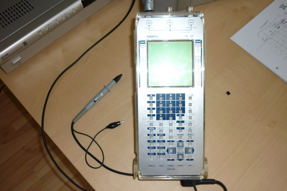

                                the scope and 10x probe is ready for testing...
                                Here's a picture of the scope.
                                Its a Createc SC 01, with only max. input voltage 220 VDC/VAC
                                Does this also fit?
                                Please give me a "call" when you have some time to get me through this...
                                  #36
                                  Re: Samsung Plasma PS50C7790 with black screen but sound
                                  I don't know if I would trust that scope. It might be damaged by the high voltage a plasma TV uses. Do you have the manual for that?
