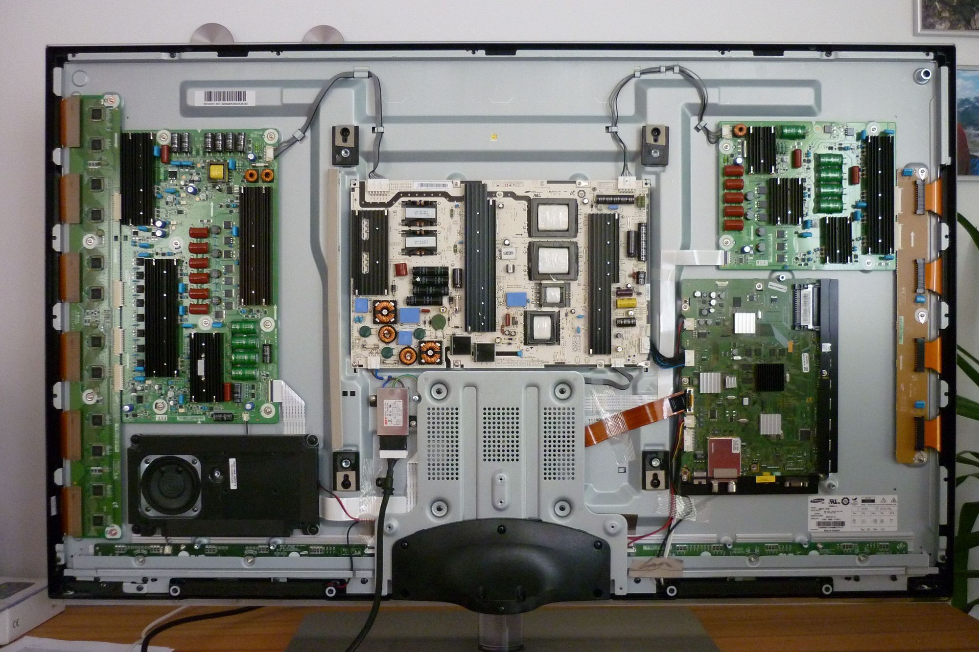

      Re: Samsung Plasma PS50C7790 with black screen but sound
      Hei Tom,
      thanks for your reply. Here's a picture of the chassis layout of my TV:
      From left to right, i think that should be:
      Y-Buffer, Y-Sustain, SMPS, Logic Board (below SMPS under the metal plate), Main Board, X-Sustain and X-Buffer
      Thanks for your help.
                  and here a complete overview of the whole schematic:
                  http://abload.de/image.php?img=completevzrx4.jpg

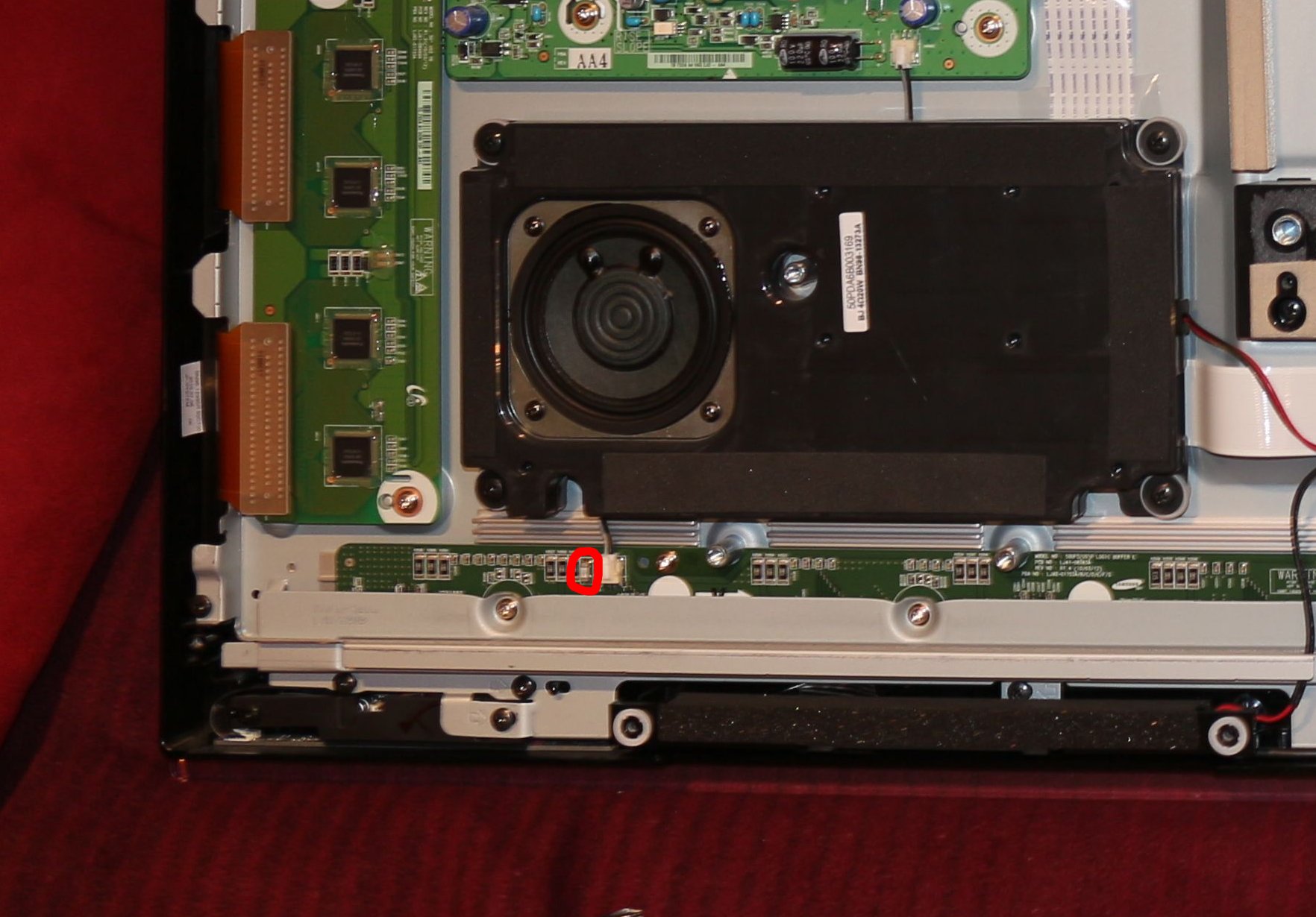

                          Oops. I did mean to upload a picture. Let's try again...
                          TV should be in original state (LVDS in place)
                              Sorry, I'm lost -- what does just the fuse I've highlighted read? Also, can you show me a picture of the range your meter is set on?
                              • Axesh
                                • Jun 2013
                                • 29
                                sorry for confusing you... i measured all the way long... :-)
                                For the marked fuse my meter shows 0.1v DC on both sides
                                It is set to 200 volts DC, like you requested.
                                If I switch it to 20 DC it show 0.14v for both sides of the marked fuse.

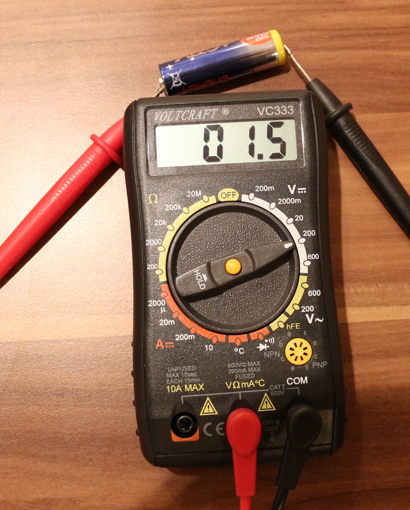

                                  OK, that's definitely bad -- but to be sure, can you quickly measure a fresh 1.5V battery and check the reading on your meter appears good?
                                  • Axesh
                                    • Jun 2013
                                    • 29
                                    damn it. So whats wrong with it?
                                    here the test with the battery..., with the same setting I used for the measurments above

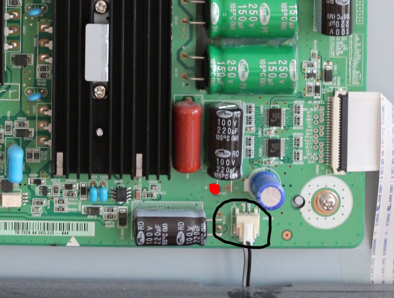

                                      Well, an important part of all diagnosis is to locate a fault, so in that way, it's good. It gives you information on where to look next to track down the final cause.
                                      I've highlighted a point in RED on a capacitor, please measure the voltage here in the same way as before. Please measure it with the connector in black connected, and then without. Careful: the TV power MUST be off when removing or inserting the connector. Power should be switched on during the test.
                                      • Axesh
                                        • Jun 2013
                                        • 29
                                        no difference on this capacitor with or without the highlighted connector:
                                        decreasing voltage from ~55 to nearly 0 volts in about 30-40 seconds
