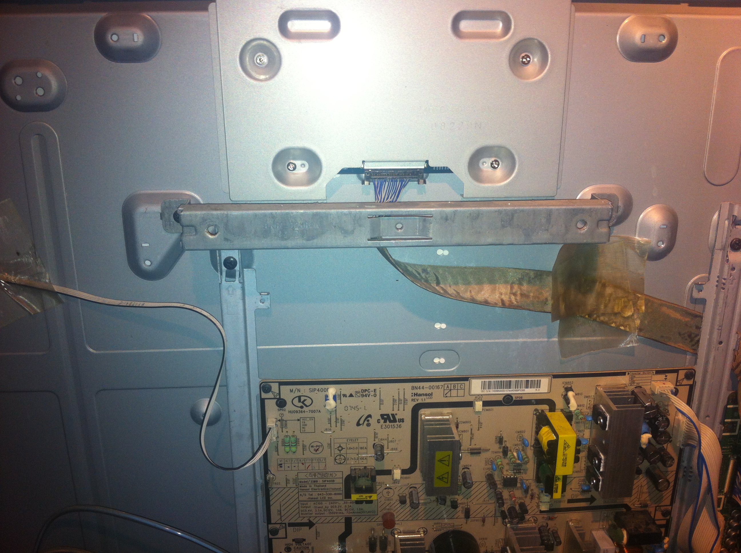

    hi guys
    trying to figure out this problem cant see much wrong with the power unit but i only have to plug in the tv and it blows the house main trip fuse
    any ideas ?

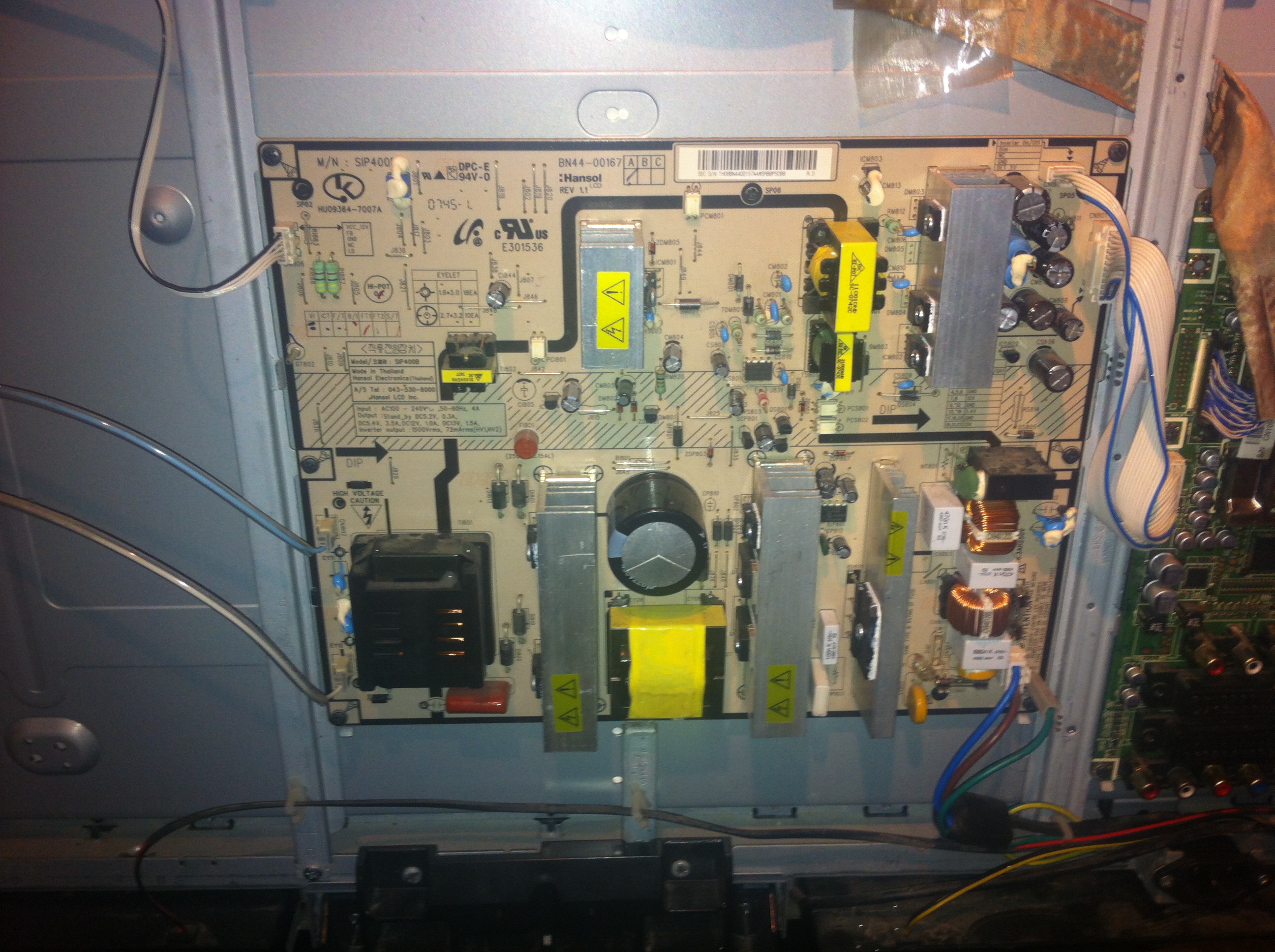

    Re: Samsung LE40M87BDX/XEU
    Bridge rectifier, PFC, main cap. Check all. If you want more help, you know the drill, we need pictures. Also get BN44 number off PSU and I will see if I have a schematic. I have quite a few.
      psu number is BN44-00167
        I have schematics

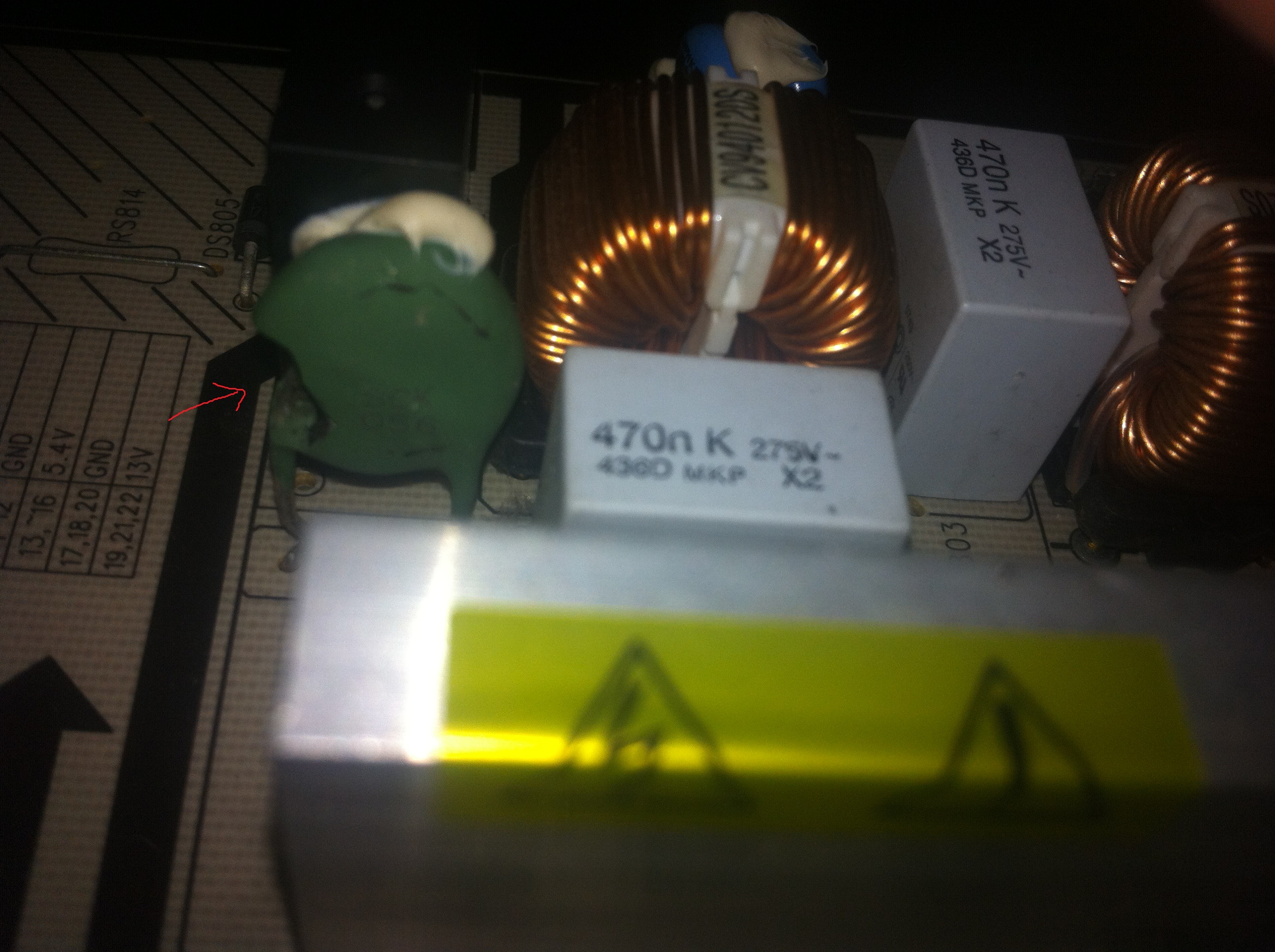

          thanks for that tom ill keep for future use but i think i found the problem maybe working 12 hours on shift made me miss this
            It's not the problem, just a symptom of the failure. Have you tested the bridge recitifer, PFC fet and main capacitor yet?
