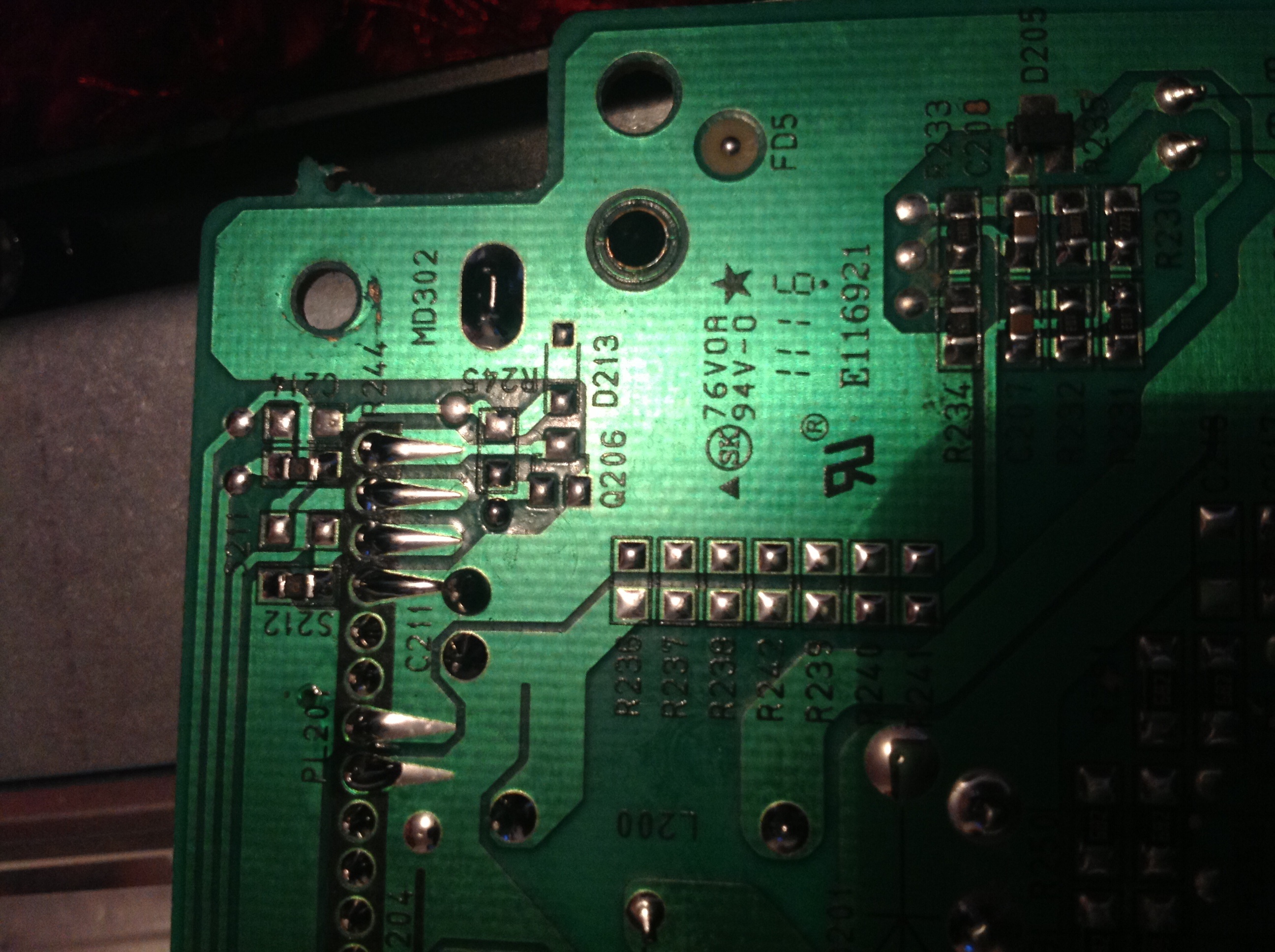

    Show me a high resolution image then, I need to see exactly what is there.

      ok give me a min and ill fire up the ipad

              Re: Jmb jtc012600102b
              This help
                OK, those components aren't there then.
                Check R244 has a solid connection. (It should read zero ohms.)
                  Yes zero ohms
                    #29
                    This is getting very strange. At one end, you have 3V, the other end, you don't. Can you check for continuity from pin 7 of PL200 to pin 12 of PL201?
                      no continuity between the pins
                        what about a jumper between the pins maybe.
                          #32
                          You probably have a break in the trace or a cold joint somewhere. Follow that line from R244 very carefully and look for breaks. You could easily run a jumper to the main board connector (long piece of insulated wire would do) and this should sort the issue out. Very strange problem!
                            tried the jumper and it works, well the screen is lighting up anyway
                                no thats the thing ive tried the ps3 in it and nothing. the buttons beep on the front but no menus come up etc
                                  #36
                                  I think you need to check where the break in the traces occurred or where the cold joints are. If it broke more than the backlight traces the main board may not be receiving all the supply rails. Also reseat all connectors etc. Maybe TV was dropped and this cracked the PCB? Should still be repairable, just need to trace down where it occurred. Common places are around screws as there is a lot of tension there.
