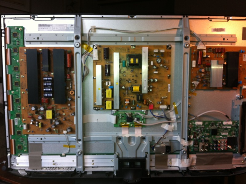

    Can you share some pictures of the TV's chassis?

        Re: LG 42PJ550 Plasma Problem
        Are these pics ok?
          Try uploading them using the Manage Attachments feature. Yours have come out too small.
            See if this works

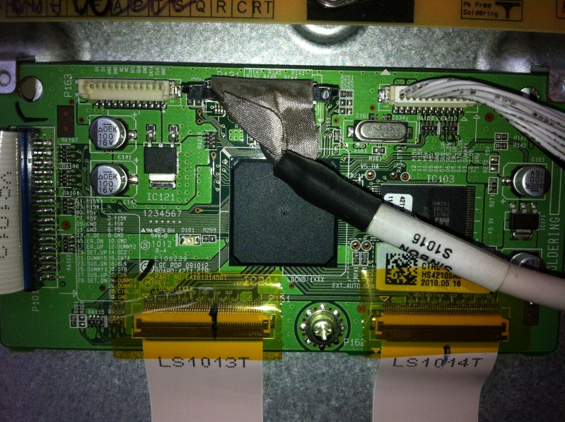

              Can you upload bigger images or go closer to this board:
              https://www.badcaps.net/forum/attach...3&d=1369869069
              I need to see if there is a test mode jumper on it.

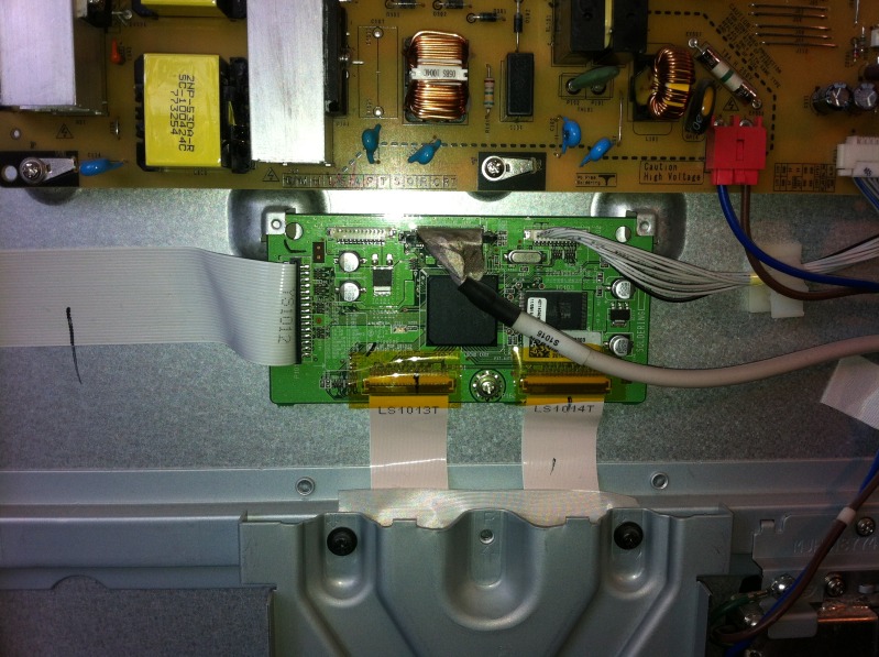

                How's this?
                  Great -- see the points marked EXT AUTO GEN?
                  Unplug the TV.
                  Take a piece of wire and connect the two holes.
                  Unplug the top middle cable in this image.
                  https://www.badcaps.net/forum/attach...4&d=1369870445
                  Turn the TV on. You should see test patterns, do you?
                    Yes, the test patterns are showing.
                      OK, the fault is on the main board. Someone else had this problem a few weeks ago after a power surge too, on the same model. (Zenith brand but same TV.)
